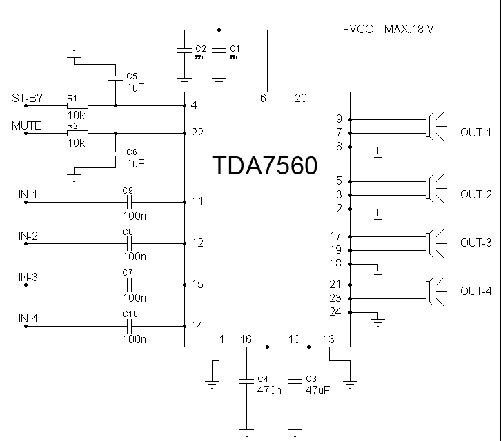

Hello, i have problem, i have made amplifier on breadboard using this schematic:
The problem is that, amplifier is not turning on when supply voltage is under 14V.
Pin 4 and 22 is connected to power supply pins. When supply voltage is 12V its not turning on, i can slowly increase voltage and when its reached about 14,2V its turned on. When its turned on, i can decrease supply voltage even under 12V and its staying on.
