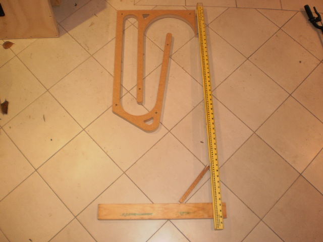

They are a copy of plans found on T'internet but to the same dims as a friends with golds and made of 18mm ply throughout (which I've heard).
Here is the cutting sheet plan.
Idea was to make the round front panel cut compatible for both 3828's and Golds / Reds.
A friend kindly put the data into a horn calc prog:) and things came out very much the same as for his 15" Monitor Golds (see below).

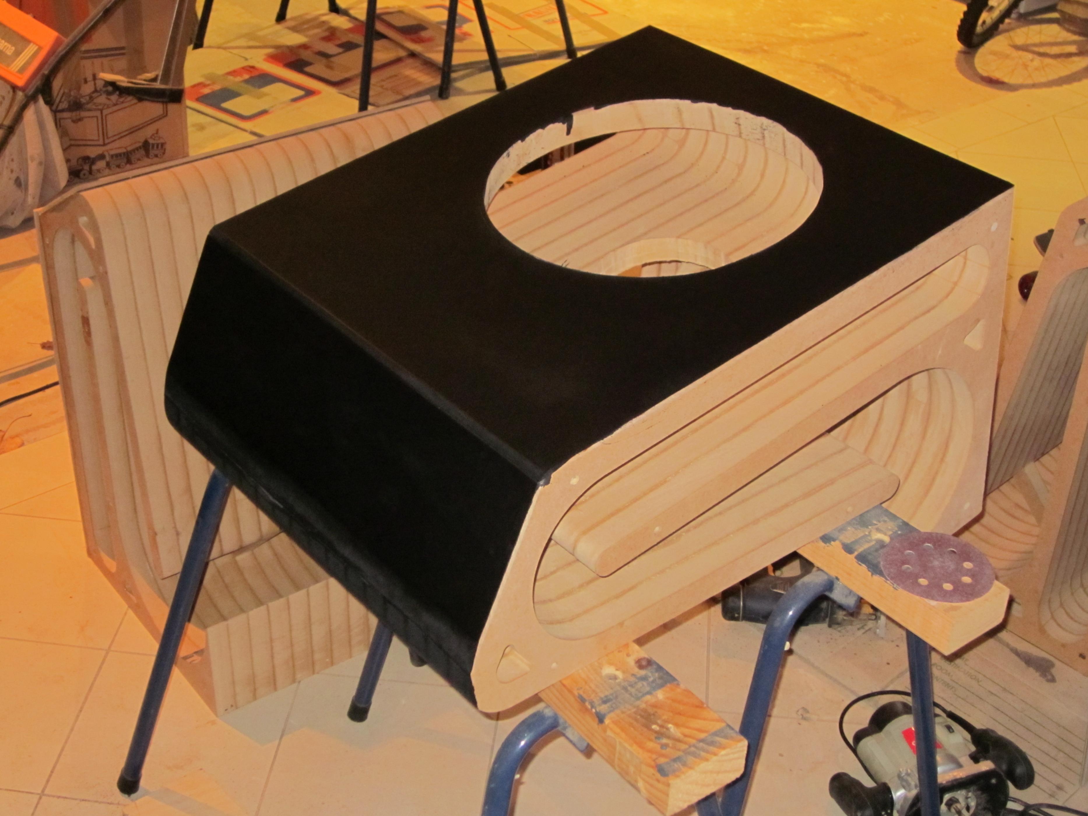

So the build started
Lining it up
Driver mounting plate
Front panel in
next 10 pics
Castors from wardrode base that had been in the loft for 11 years
A few more evenings and the first one was almost ready
Here's how it would have looked using the Berkeley grilles
Boy the castors were a good idea!
The one on the right is rubbed down and two thin coats of polyurethane
They are now named Bertha & Big Bob by the family?!
The felt took a few says to arrive so I had time to cut the slots for the crossover panels and put the terminal posts on the backs.
Just 3 internal horn baffle and 2 reflector pieces in each speaker to go and transplanting the drivers etc over.

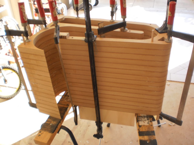

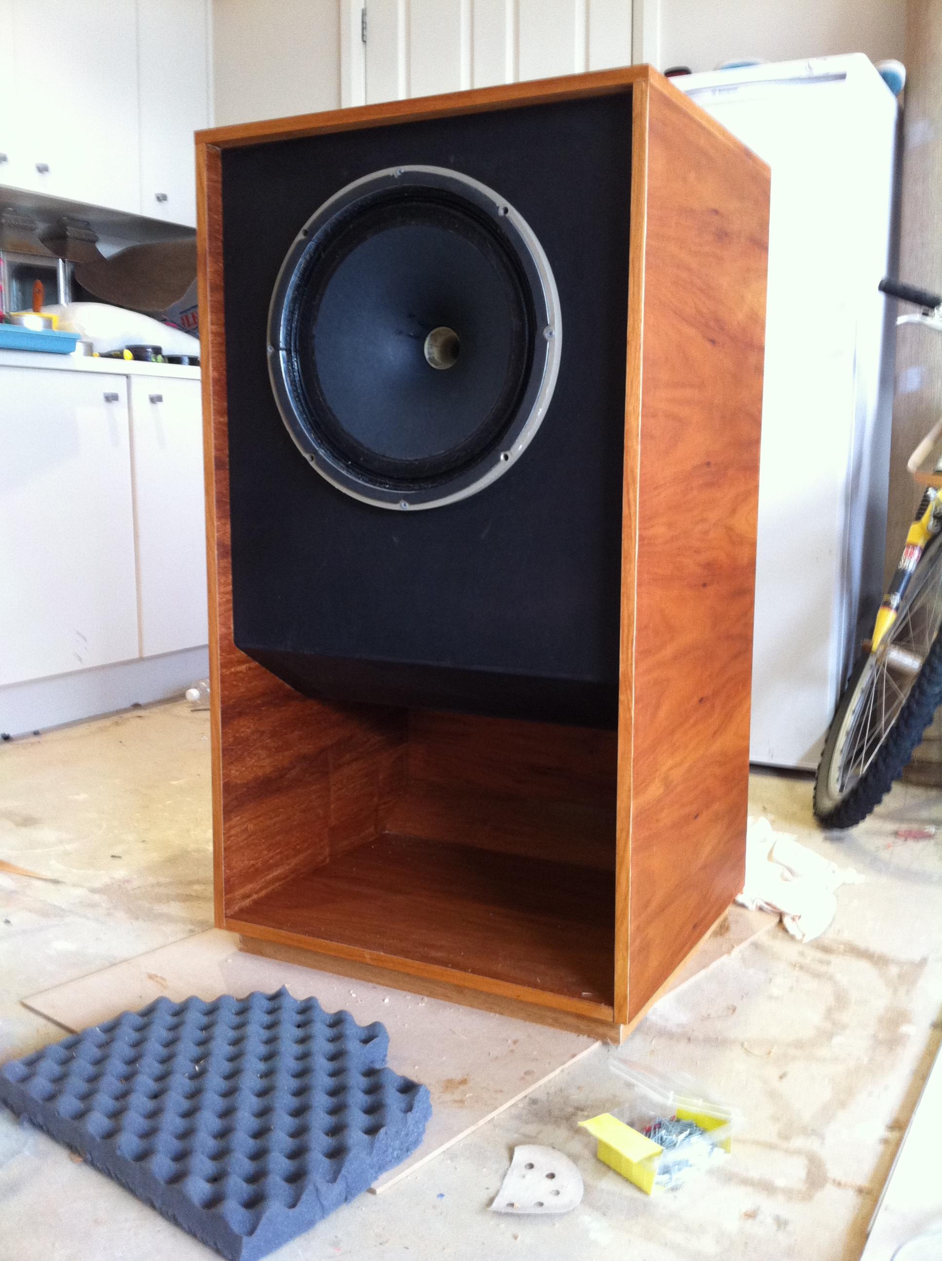

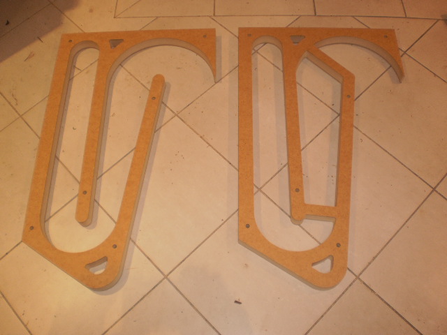

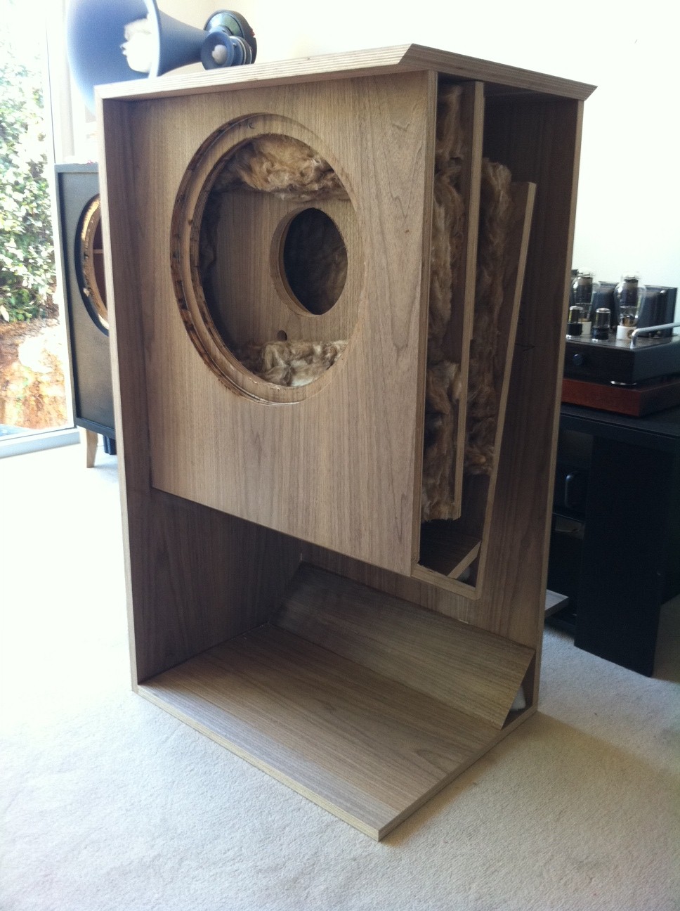

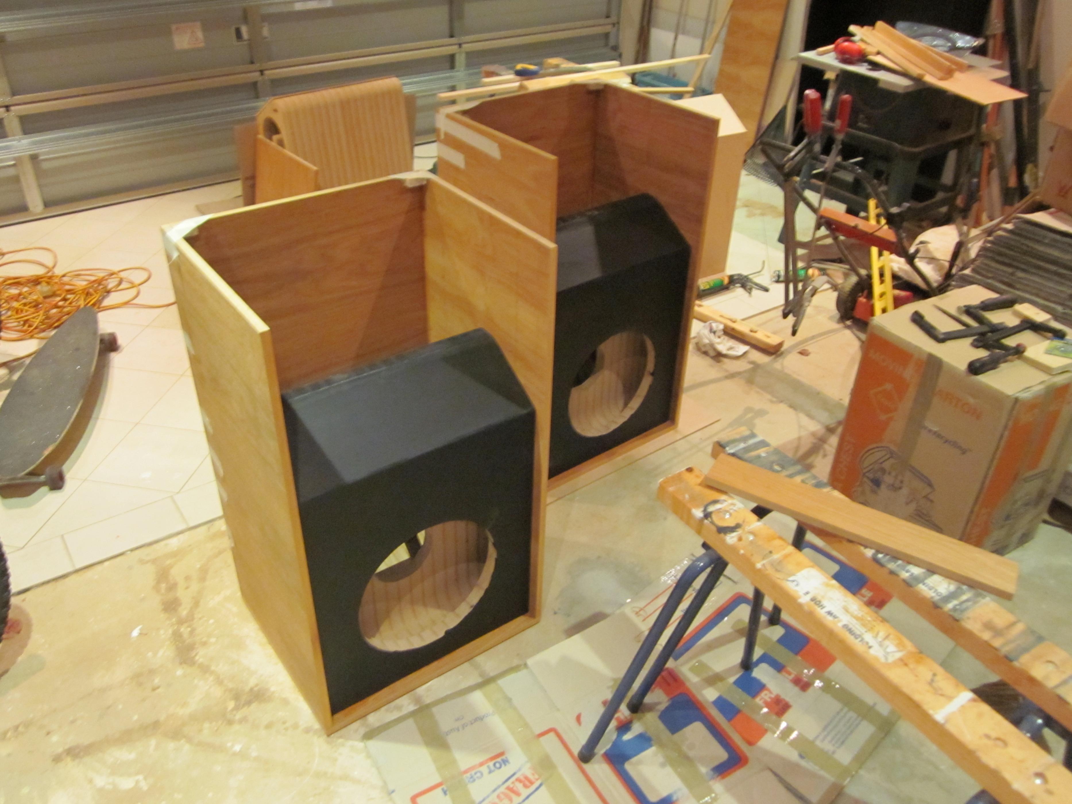

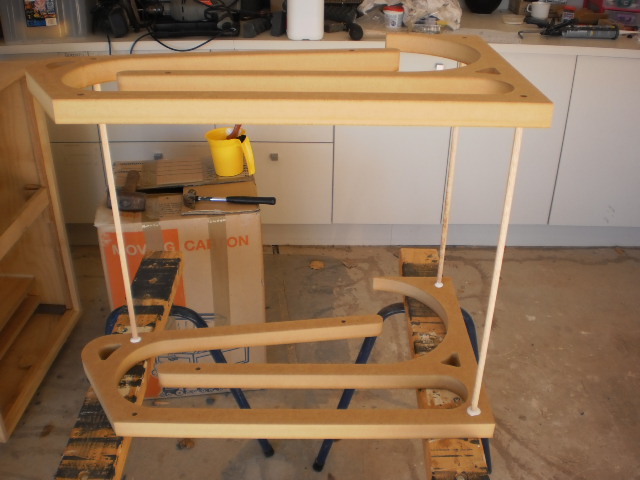

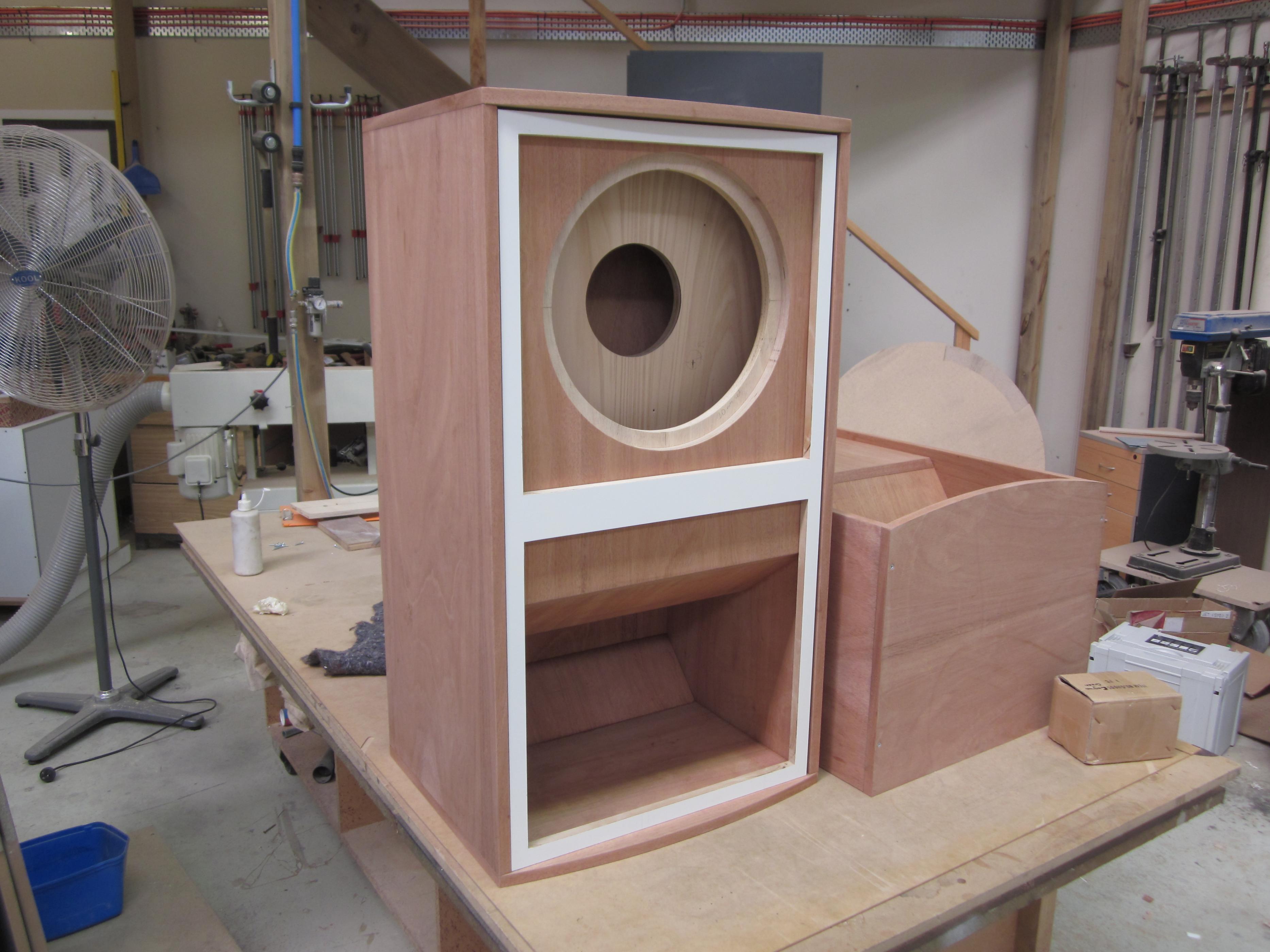

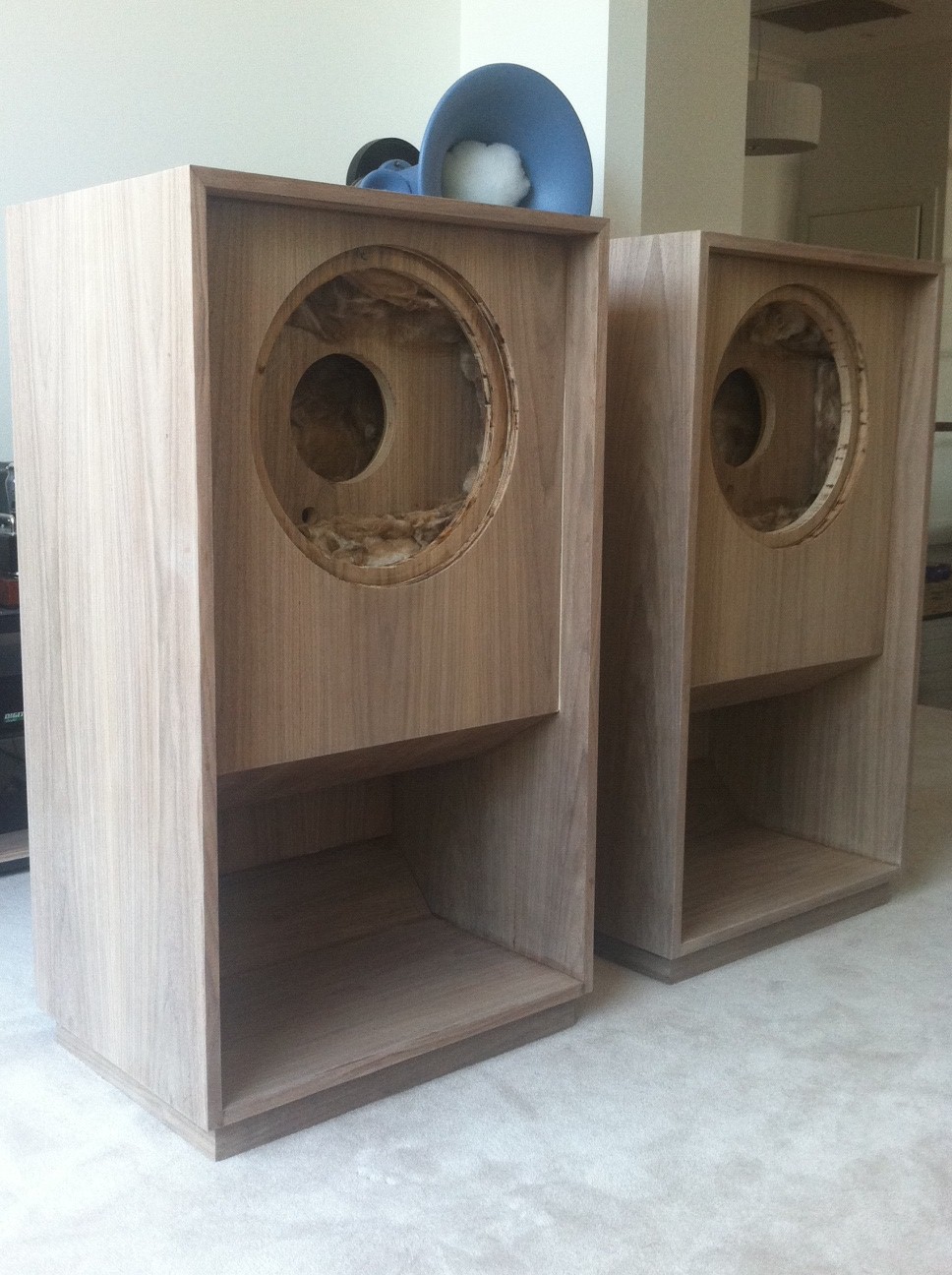

Well done, Steve...I've built a few GRF's, including CNC'ing the upper horn block, as well as traditional approach. The latter with 19mm Euro Birch ply in American Walnut ply.

Good idea to go for a GRF style back loaded horn design. You will get about 6dB more bass output. Ive not found this a problem or needed to up the level output on the HF horn to compensate.

I went on to build several different incarnations of Rect GRFs - curved top and base.
narrow ones that I modelled in Hornresp to get the back loaded horn as close to the original as possible.
