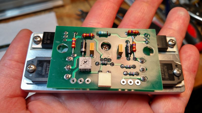

DIY STK-0050 module.
Dear compatriot:

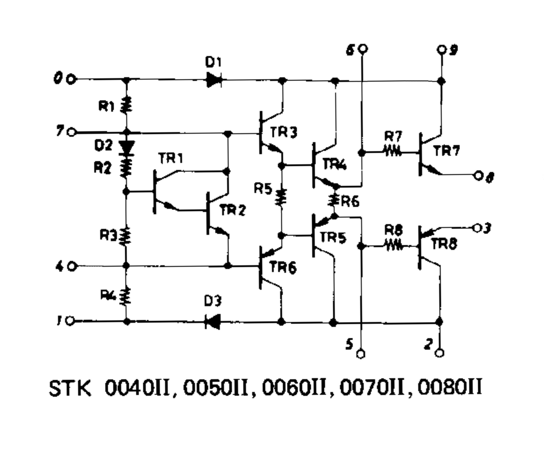

I searched a lot, there's enough info on the web but I have not compiled almost nothing. I found a schematic and someone who manufacture a replacement very well done, attached photo, but I did not find the drawings of the PCB.
Really disappointed me a little and leave the subject, but I still interested.
If anyone has more info is welcome and refloats the post.
Regards!

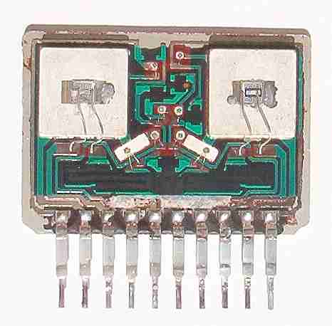

I have STK datasheets and a pic of one I took apart.
The old ones in the 1980's did sound quite good, but bonding wires always breaking off.
