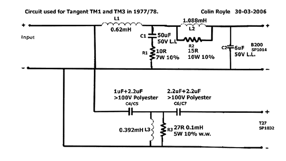

have two spare KEF B200's SP 1014 and T27's and I intend to give life to a Tangent TM 1 or TM 3 clone.If anyone can contribute with any information or schematics regarding these speakers would be most welcome.(cabinet internal and external dimensions,baffle dimensions and cutouts,bracing,type of wood,battens,deadening resonances,stuffing,crossovers,suitable type of inductors,etc)

Sreten has a point. I know the local hifi emporium often break up TM1/TM3 because they can get more for the tweeters when repairing a set of Linns than they can get for the whole Tangent box -- even thou the Tangents are probably better than the Linns.
If you go ahead you want to nuke the KEF XO, it is not near as good as the Tangent. I don't have the box specifics, but i'd start over anyway, the boxes were too small (based on sims). The TM3 was sealed, the TM1 vented. Put them in 60-120 litre sealed boxes.
XOver scema attached.
dave

DearPlanet10,I totally agree with you that the Tangent xover is far superior to the KEF one.Kef suggested a closed cabinet of 20-30lt for B200 SP 1014.The KEF Chorale implementation has 20,4lt.
