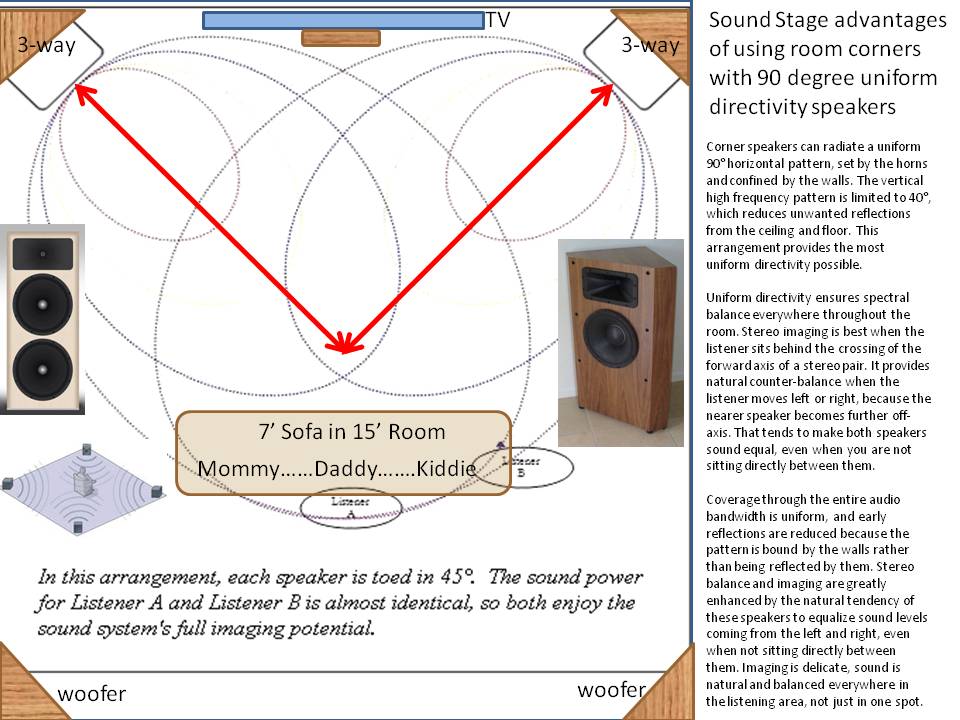

--You can model your listening room with different speaker placement options with the intutive tool:
Room Response Calculator v0.6d by Yavuz Aksan
--You can understand how corner speakers generate controlled directivity down to bass by reading papers like PiSpeakers:
http://www.pispeakers.com/Pi_Speakers_Info.pdf

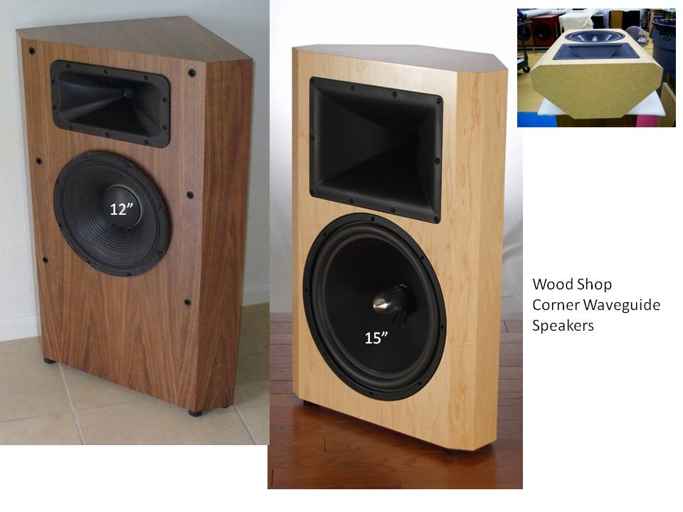

--Your wife might favor corner speakers in order to keep the window lighting area open, and your wife might accept a slightly larger corner speaker so she can put art objects on top. diysoundgroup offers SEOS horn kits with a CNC cut front baffles...still need to build side panels.

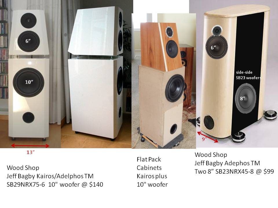

There are a few recommendations for the Kairos 2-way speaker. BEST with a sealed TM box, plus a ported 10" woofer.
Jeff Bagby has a document for SB29NRX75-6 10" woofer extension cabinet (26" H x 12" W x 14" D) for the Kairos/Adelphos.
You may not have friends with wood shops, but you should be able to find a local cabinet shop that will cut CNC boards at a reasonable cost.... no shipping charges. Using Baltic Birch plywood with clever CNC cuts will simplify finishing.

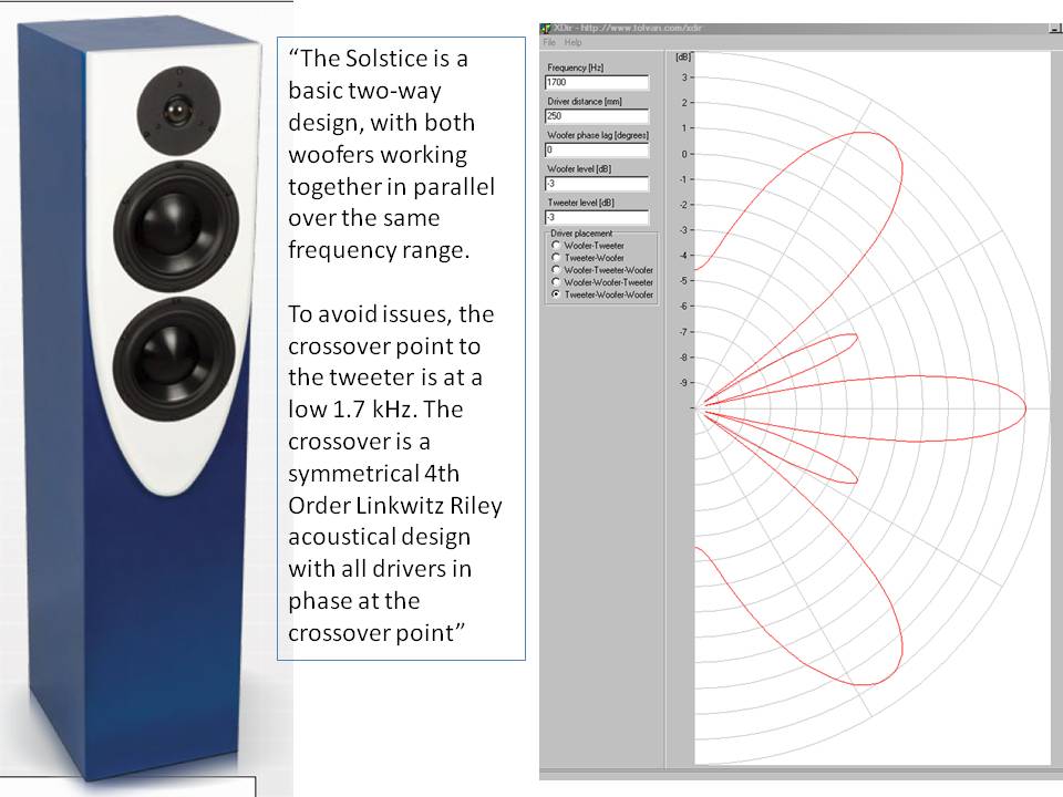

The Solstice uses a TMM topology where both 6" midrange drivers are connected to one crossover circuit with a 1700Hz acoustic LR4 slope. The Center of the tweeter -to the- Center of the lower midrange is over 10" (250mm). Simple "xdir" simulation of the polar interference patterns around the crossover frequency due to this large C-to-C suggest that an experienced listener would notice a change in the soundstage, both from "location queues" and "variations in SPL" as sound energy oddly spreads over a wider room volume. Seating position becomes more critical.
A more traditional TM-W three way would put the top 6" midrange in a small sealed volume for optimum transient response, and use the lower 6" midbass as a ported bass reflex woofer. This would require a 3-way crossover, although a 2.5-way circuit has been used in several successful designs == a separate inductor adjusted for a lower frequency is connected from the top midrange crossover circuit directly to the bottom midbass.
Folks on this thread might have Xover simulations for 3-way and 2.5-way options for the Solstice Morel drivers+box you can study.
