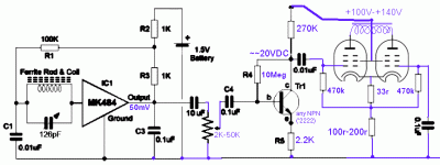

I recently started experimenting with a 2N2222 transistor to amplify the output of a MK-484 kit in hopes of driving an Edcor WSM15K/15K transformer to drive a push pull 60FX5 amp.
That didn't work so well so I looked for other transistors I could use and experimented with the 2N6301 which is a darlington power transistor.
Got a basic circuit worked up with one transistor then thought why not try push pull.
Through experimentation I came up with this circuit at the bottom of the post.
This is to drive a high impedance 1920's speaker.
I adjusted bias until I got a good clean sinewave then as the transistors warmed up I kept adjusting bias until I got the maximum possible voltage with a clean sinewave which is 60Vrms (169.68Vpp) on the output transformer secondary using a 5K load, but because the transformer is only rated to 50Vrms (141.4Vpp) I did all my tests at that output voltage.
I tested the amp using a 5K to 8 ohm transformer and an Automatic Radio speaker I modded to be three way using a dome tweeter and the amp itself does sound quite good.
Driving the antique speaker the amp sounds quite decent as well and drives the speaker quite nicely.
I used a 15 volt zener pressed against the small chassis between where the two transistors are mounted to serve as temperature compensation, but even though it works some it doesn't work well enough.
When I have everything set up so that I get a good clean sinewave of 50Vrms out of the amp I can remove B+ then let the amp cool and when I power it up again the output voltage starts at 35Vrms and as the amp warms up goes to 50Vrms.
The capacitor is only there to eliminate a bit of instability when bias was set to a certain point.
Any idea what I can do to have the bias properly compensate for temperature so that the amp will always have maximum gain regardless of the temperature of the transistors?
The transistors themselves don't get much above warm to the touch.
I find it amazing that with only two transistors and two transformers I can get a 50Vrms output for an input of only 40.55mVrms.
The Zener is NOT temperature correcting, it has very low temperature coefficient.
It also is not setting the Base ("grid") voltage relative to Emitter (cathode), it is feeding a fraction of B+ through a high value pot.
Since the transistors are not simple (Darlingtons, and also have BE resistors of unknown tempco), analysis is screwy. It resembles the old-old-old scheme of leaking a constant current into Base, and hoping that hFE doesn't change (it does). That is so 1953.
One transistor's Vbe varies 0.5V-0.8V, use 0.6V for rough guesses. It varies with current and with temperature, so you can't give (or work to) an exact figure. What to do? Add an emitter resistor (you got that) which will drop a voltage "large" in comparison to the uncertainty of Vbe. A 0.6V drop in emitter resistor is usually safe, since the actual variation of Vbe in a specific device is rarely over 0.1V and we rarely need better than 20% accuracy of Ie. (Your no-feedback circuit's gain will vary about as Ie, and while 20% is not good enough for recording consoles it is fine for a radio.)
But what current should we want? Look at the supply and load. 24V supply, 600r CT load. Assume class A. Each side reflects 300 Ohms. Assume much of the 24V is to be applied to the winding as peak audio. 21V peak seems a nice number. Especially since the RMS of 21V sine is 15V. Or 30Vrms across the whole 600 Ohm winding. 30V^2/600 is 1.5 Watts output. This seems a lot, but would make sense for a line driver.
The 21V peak in 300r is 70mA peak. In class A we would idle at 35mA, each side. 70mA idle for both sides.
We want a emitter resistor to drop ~~0.6V at 70mA. Comes out "10 Ohms" on my thumbs. Interesting that this is the value you picked.
We want the Bases to sit 0.6V+0.6V= 1.2V higher than the ~~0.7V at emitter. We want this ~~1.8V to be steady with small supply changes (no resistor divider) and with base current change (no large resistance), and preferably drop with temperature. Well, Vbe does that naturally. If we only want a Vbe, we don't need the whole transistor, a diode is a transistor without the third leg. To get ~~1.8V we need three diodes.
The diode current must be enough to get the diode voltage up, plus enough to feed the base currents, plus any other stuff we may steal.
The base current of a 2N6301 at 35mA or 0.035A..... well, it is a 8 AMP part with no low-current specs. We might wonder if it is even "alive" at 1% of its marketed current rating. (Old Ge might not. Modern Si usually will. Your tests show it ain't dead at lower current.)
We don't know the hFE of a '6301 at 35mA. However some poking shows that the 8K resistor across the first Vbe will suck at least 0.070mA. And if the hFE of each transistor is as low as 20(!), the base current will be no large. Pencil "0.1mA?" as base current. Times two is 0.2mA.
Take 1mA as a minimum current to bring super-cheap reliable 1N400x diodes up to the 0.6V zone. (Note that this is only 0.1% of '400x rating! I know from other work that it will be a decent bias source.)
And since the expected 1.8V is remarkably close to that that MK484 eats, and it only sips 0.3mA, figure on that.
0.2mA+1mA+0.3mA is 1.5mA. We need a resistor for (24V-1.8V)/1.5mA, which is like 15K. No harm in using 10K.
The internal dynamic resistance of a Si diode at 1mA is 26 Ohms (Shockley's Law). Three stacked is 78 Ohms. This may be a low-low impedance for the bases. In fact it is likely far lower than transformer winding resistance.
DC design is done.

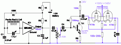

me> it seems over-kill
I've been at this too long. I hate to see so many parts and so much power when the job can be done so much cheaper.
60FX5 needs 3V peak or 2Vrms of G1 drive to go wild. Super-small for a power tube. 30V 1.2K drive seems absurd.
Push-pull output does not require push-pull input. A long-tail can take one in and give two outs. A disadvantage is you need twice the drive signal. But at only 2Vrms drive, that seems do-able.
This is also called "self-split push-pull". Purists will argue that it tends to PUSH-pull, unbalanced. Large tail resistor improves balance but reduces voltage available to make power output. There is an analysis around. The proposed 100-200r will be good enough. The "optimum" value is whatever is handy in that range.
The input impedance is over 470K due to bootstrapping. We want the previous stage plate (I mean Collector) resistor to be 1/2 to 1/10th that value for good gain and output. I slapped 100K in there.
The bias system looks like the "old-old-old" scheme but isn't. Taking base resistor from collector DC resistor is a form of auto-bias. If the collector sucks down, the base resistor passes less current, so collector doesn't suck so much. A fairly workable Rb for "any" modern small transistor may be 10Meg.
Gain required is 4Vrms/50mVrms or 80. The 1K under the emitter has no DC function, but sets the AC gain near the required value. This can be reduced to zero for more gain, but at 4Vrms out the 2nd harmonic approaches 13%, which isn't why you went push-pull in the final. 1K makes it under 5% 2nd which is probably fine. Trim to taste.
I have not addressed how you are going to get the several supply voltages. Actually you could change the 100K at Tr1 to near 30K, change 1K to 3.3K, feed this with +120V, and still have a safe voltage on Tr1. Now Tr1 output and THD will be even better.

> one side is slightly lower than the other
Yes, I realized that you have NO scheme to force balance between the two transistors. They never match exactly, and this is a HIGH gain circuit, so small difference of Vbe between transistors will be a large difference in idle current.
Put 1 Ohm in series with each emitter. This will drop 35mV-50mV, which is probably larger than the Vbe difference of two Darlingtons from the same lot. Check that the voltage drop is similar over each 1 Ohm resistor, say within 20%.
Do you have any heatsink on the transistors? At 1.2 Watts each you are running very hot for a naked TO-66. Obviously if you put it on a pound of alloy in a cold lake there would be "no" temperature rise. A couple square inches of fairly thick flat Aluminum may be a good size.
The diodes should be on the heatsink. Diode tracking is inexact and I would not be too concerned about how many are on the loop.
If your power output is ample and your real problem is current stability for gain stability, throw-away much of your supply voltage in a large emitter resistor. While a regulator "aint right", if we hold the Bases up at say +5V then the Vbe variation is only 25% of the total bias. Common emitter resistor could be 50 or 55 Ohms to get ~~70mA idle current.

Here's the updated schematic as things are currently with the amp.
I got the amp home and I discovered an interesting problem.
With the speaker connected and the volume control either full CCW or full CW I get an oscillation. I have no real clue what is causing it unless the capacitor that is across the input of the speaker is the problem.
