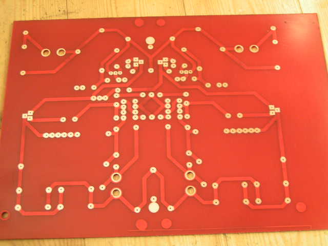

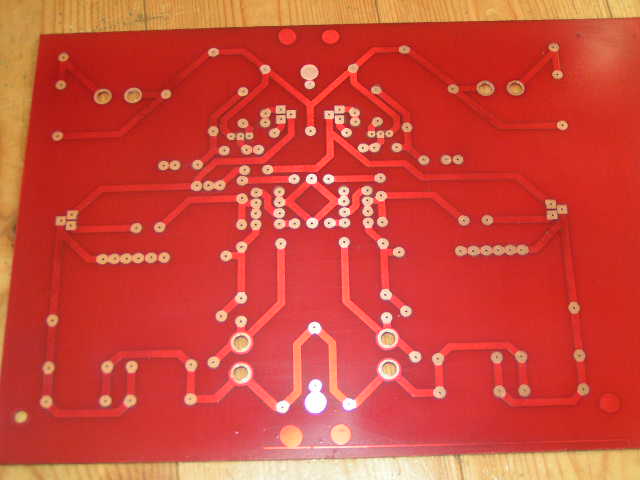

Thanks Magura (and Elkaid too for the original suggestion) for the pics. Looks really nice. Doesn't look homemade at all once the vitrea is on there doesn't it?
I can't wait to try it on my boards. I've got three different colours as I couldn't make up my mind what to use (I've got Pepper Red, Lacquer Blue, and Crimson).

Which method have you used to make your solder pads "shiny" ? I'm using liquid tin (like MG Chemical cat #421) before applying solder mask and that gives superb results.

Elkaid said:Congratulations !
They're incredible ! Which method have you used to make your solder pads "shiny" ? I'm using liquid tin (like MG Chemical cat #421) before applying solder mask and that gives superb results.
great work !
Emmanuel
I have come to the conclusion that chemical tin plating is not offering the best adhesion to the copper. To get the best adhesion I use either tin bath and hot air to level it, or my preferred method for few boards, simply removing the oxide layer on the pads with a fine grind compound. The grind compound leaves the pads shiny as you see them on the photos. This should be done within a couple of hours before soldering, as the oxide will form will reform relatively quick.

Metod used to protect the pads of Vitrea
Please Magura, can you tell me how to protect the pad zones of coating with Vitrea?
You use a manual metot, positioning little pieces of rubber.... hand-placed?
and can you tell me the name of vitrea colour the corrispond with the classical green used in industrial PCB's?"
(Sorry for my poor english)
thanks a lot.

Re: Metod used to protect the pads of Vitrea
I made a few tools, to stamp self adhesive pads of the respective shapes and sizes. Yes they're placed manually.
As for the number of the green color, sorry no clue. I am about as colorblind as they come.
