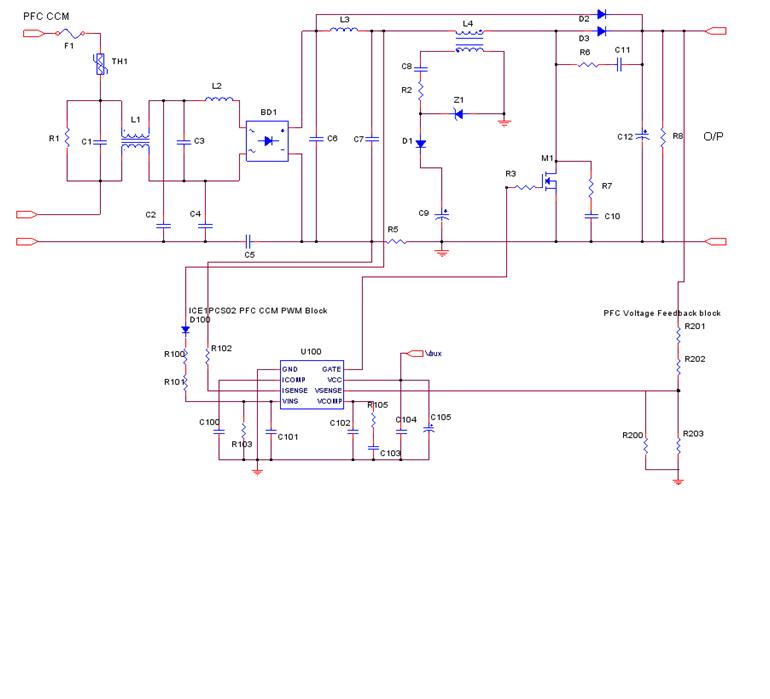

Attached is the schematic
Freq 85 KHz
L1 - 1.76 mH (EE55 7 turns)

I was playing with the design software and higher switching frequency drasticly changed L4.
I was looking at the app notes for the Controller IC there is a sample circuit and schematic. The typical Frequency is 133Khz. So Luca you are correct with not needing to be up in the 200 range. The IC will support running at 250KHz but isnt necessary.
Here is the sample datasheet.
http://www.sacg.com.tw/sacweb/marcom/ad/ad/IFX_PowerSolution/Datasheet/AC-DC/PFC%20IC/AN-EVAL-ICE1PCS01-1.pdf
Can someone explain to me why the datasheets only use 1 inductor and the poweresim design software uses 2. I dont understand why the L4 section is present in the schematic that I posted.
from the number of turns you make me believe that you gonna use an ungaped core ????? the switching transistor will blow-up instantly, due to the inductor saturation. however, 7 turns on ungaped EE55 cannot give you more than 300-400uH. Al=6-8uH/ts2.
consider using a kool-mu toroid, at least one 0077083A7 for this power level.
