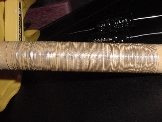

This is winding one of a 1.8 ohm resistor. This shows the second wire removed and clear lacquer applied.
It's not as perfect as I hoped but it is a lot better than the last winding method. The second layer will go in the voids between the winds.

It occurs to me that a lathe set on low speed w/ one of these spindles would make an ideal winding machine. Either hand-feed the wire slowly and carefully along its length or find some way to regulate moving the wire along, either way, you'll wind the whole thing in under a minute. (This is assuming you drop the 'between the wire' placement thing, but I don't understand why it's used).
Are you sure there's no shorts in the above spindle? A short, if I understand the principle correctly, would both lower the resistance very slightly and increase the inductance by making the direction the magnetic field is being pushed nonsymmetric. Without an LC meter or a very, very sensitive ohmeter, you wouldn't necessarily know it, either.

Tom1356...winding tips...
Hi tom..
Although I've never tried silver, here is a nice way to wind..
Take the length of wire you need...fold it in half..
Take the folded end, and start winding with that...put a second, any guage wire (say, a yellow wire) between the two silver ones (in the middle of the fold), and one to the outside right of it (say, blue)..in other words, wrap four wires on the tube at a time..with the silver alternating with the others..you should see silver, yellow, silver, blue, silver, yellow, and so on...
The yellow and blue wires are just spacers to hold the silver wire an exact, even distance...this method allows you to use any guage yellow and blue wires to maintain even spacing..as long as you wrap tightly, with the folded end held well, then you can remove the yellow/blue wires..Or, you can use fishing line as spacers, and leave them in place..
Hope this helps..
Cheers, John

Re: Tom1356...winding tips...
I agree with your thoughts but in practise these are very good sounding.
See here for more info.
http://www.audio-consulting.ch/silver_speaker_resistor.htm
Thanks for the advice. I will give it a try.
Magura said:hmm...as far as im concerned, silver is used to reduce resistance.....now making resistors of silver dosnt sound right...does it???
Magura
sully said:Hi tom..
Hope this helps..
Cheers, John
