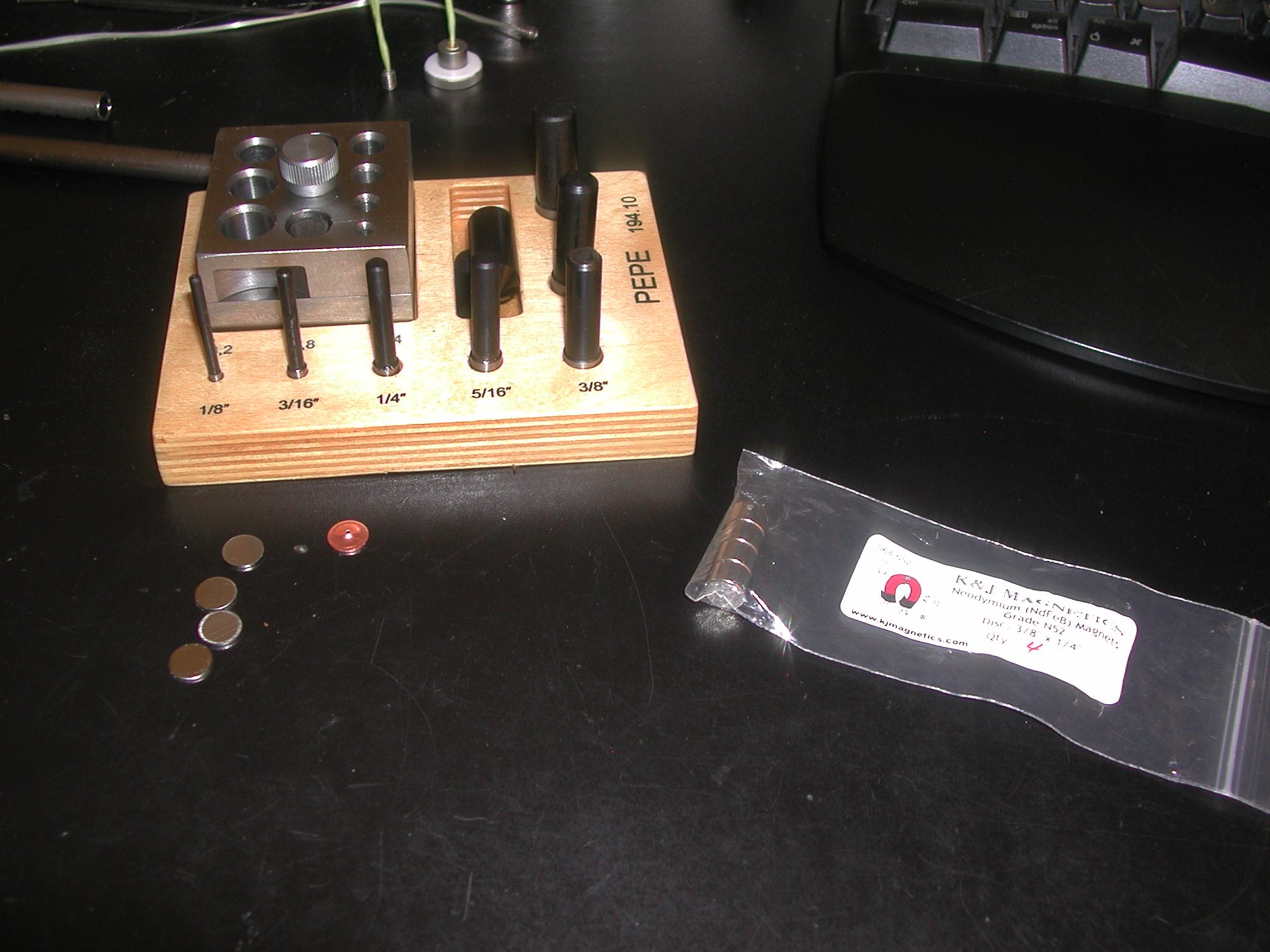

Just found some soft iron rods 13mm dia. I can have it sliced and machined to yield a "pot" for the bottom magnet. No need to worry about cold working this material. THis should give me a wall thickness of about .0684"
Maybe just center drilling and cutting a piece the height of the magnet and using my mu-metal disc for the bottom.... ah but thinking aloud.... leakage...
probably best to just make the "pot" entirely out of the soft iron and machine a hole with a flat bottom to recieve the magnet leaving only the face of the magnet (facing the armtube magnet) the only exposed surface.
Then I'll design the bottom aluminum pice to accomadate the "pot assembly"
that's the ticket.......

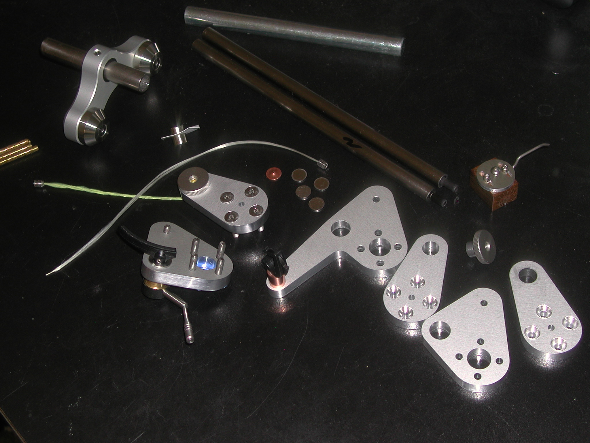

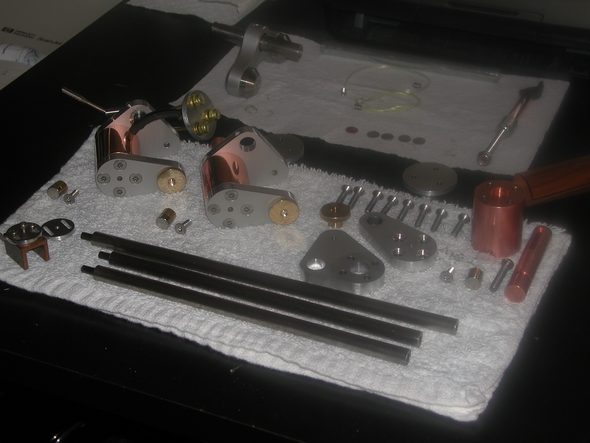

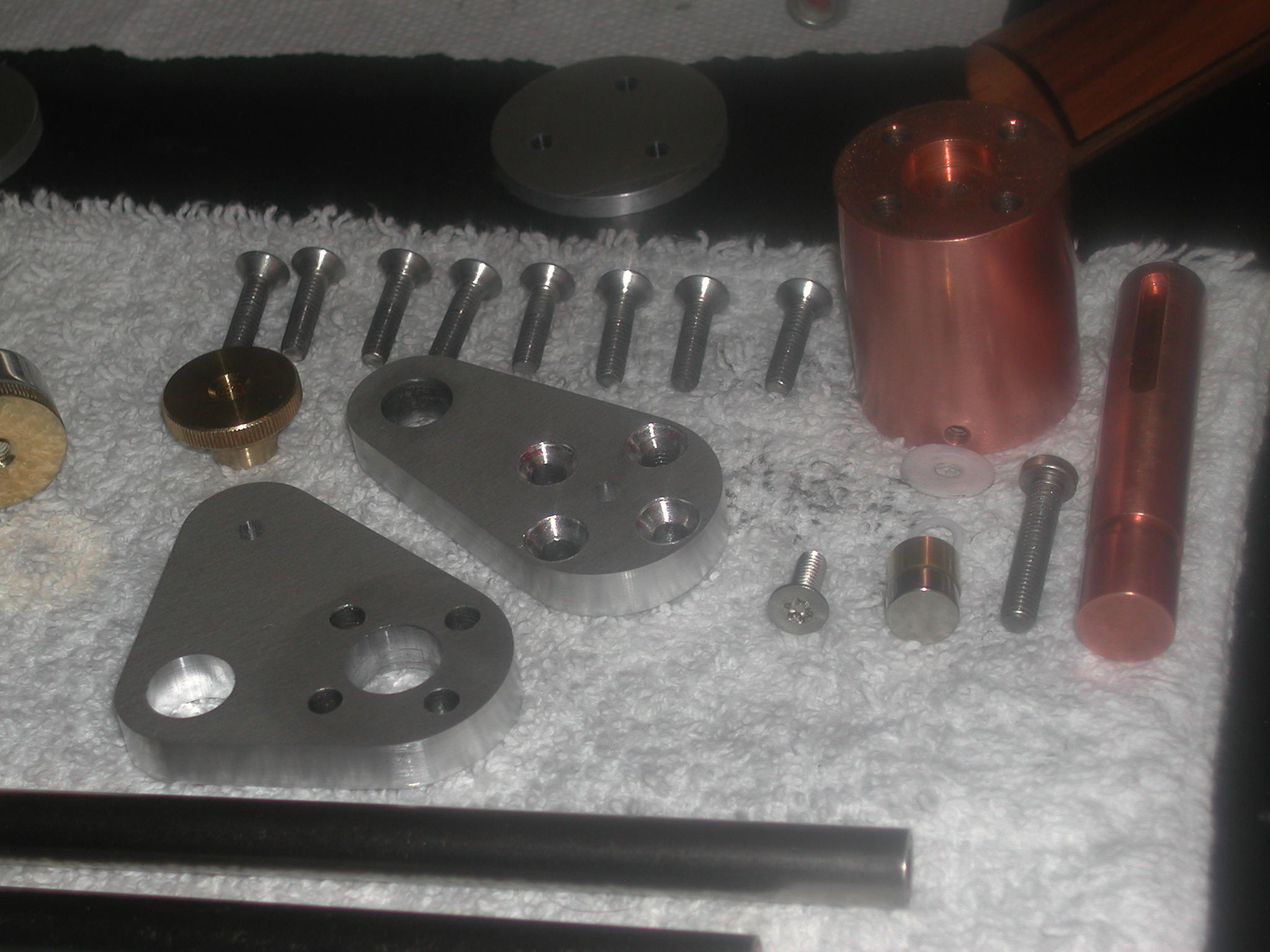

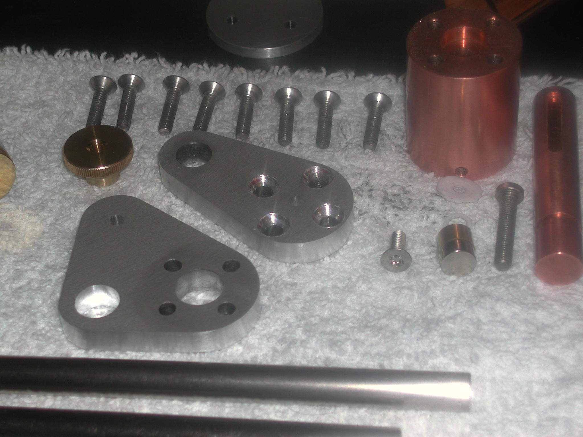

Parts are coming in a little at a time. Some parts have as much as 30 working days lead time. Here's a pic of the accumulation so far. Notice one of the lower support has a built in arm rest.
As I mentioned in an earlier post, farming the pieces out was a bit pricey for one-offs, so for about $50 more I can build 3 complete arms....
Jeff Davison

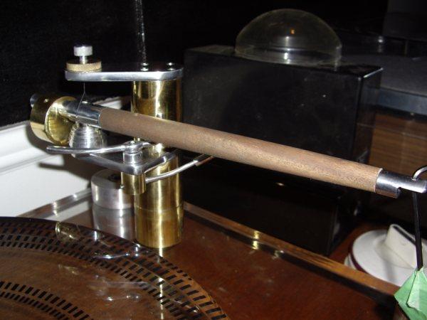

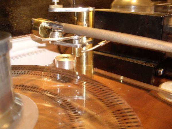

my schroeder wannabe... well almost, still some teaking to do.
had some time the past couple weeks so I decided to make my first tonearm. Still needs a bit of work but its a good start and it seems that it should work at the very least. Now I just need to finish my turntable
cheers
matthew
cheers
matthew

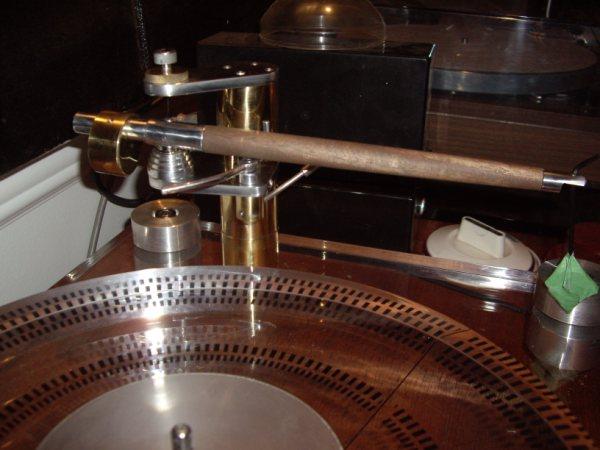

its just a nine inch arm. The wire is gonna be cardas wire as soon as it arrives in the mail.
I still have some issues i need to sort out. the rear aluminium arm tube must of moved when I milled it cause the magnet base is a little tilted. So i will remake that piece. at least that was one of the easiest pieces.
other then that i am pleased so far, and cant wait to have up and playing!

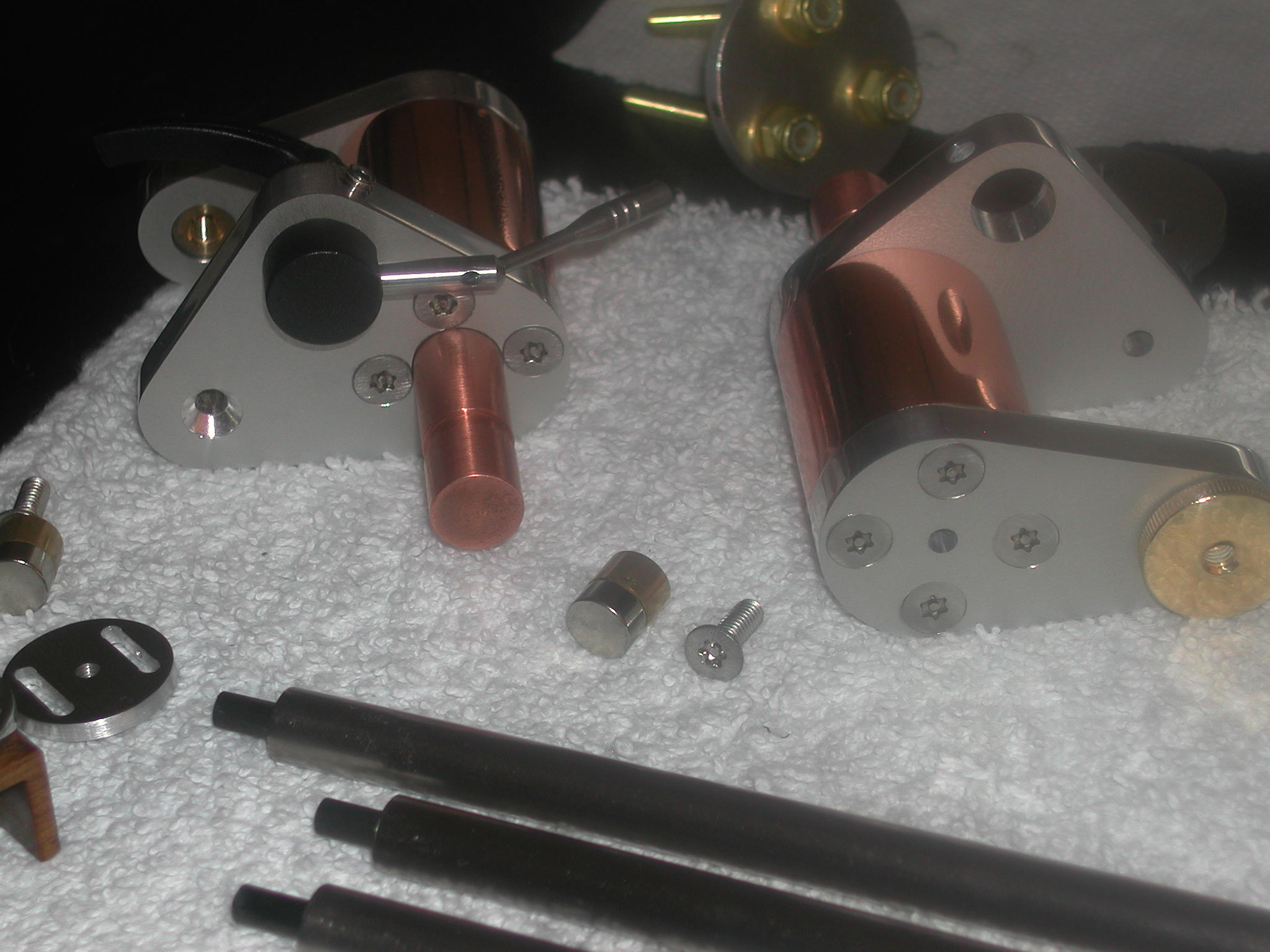

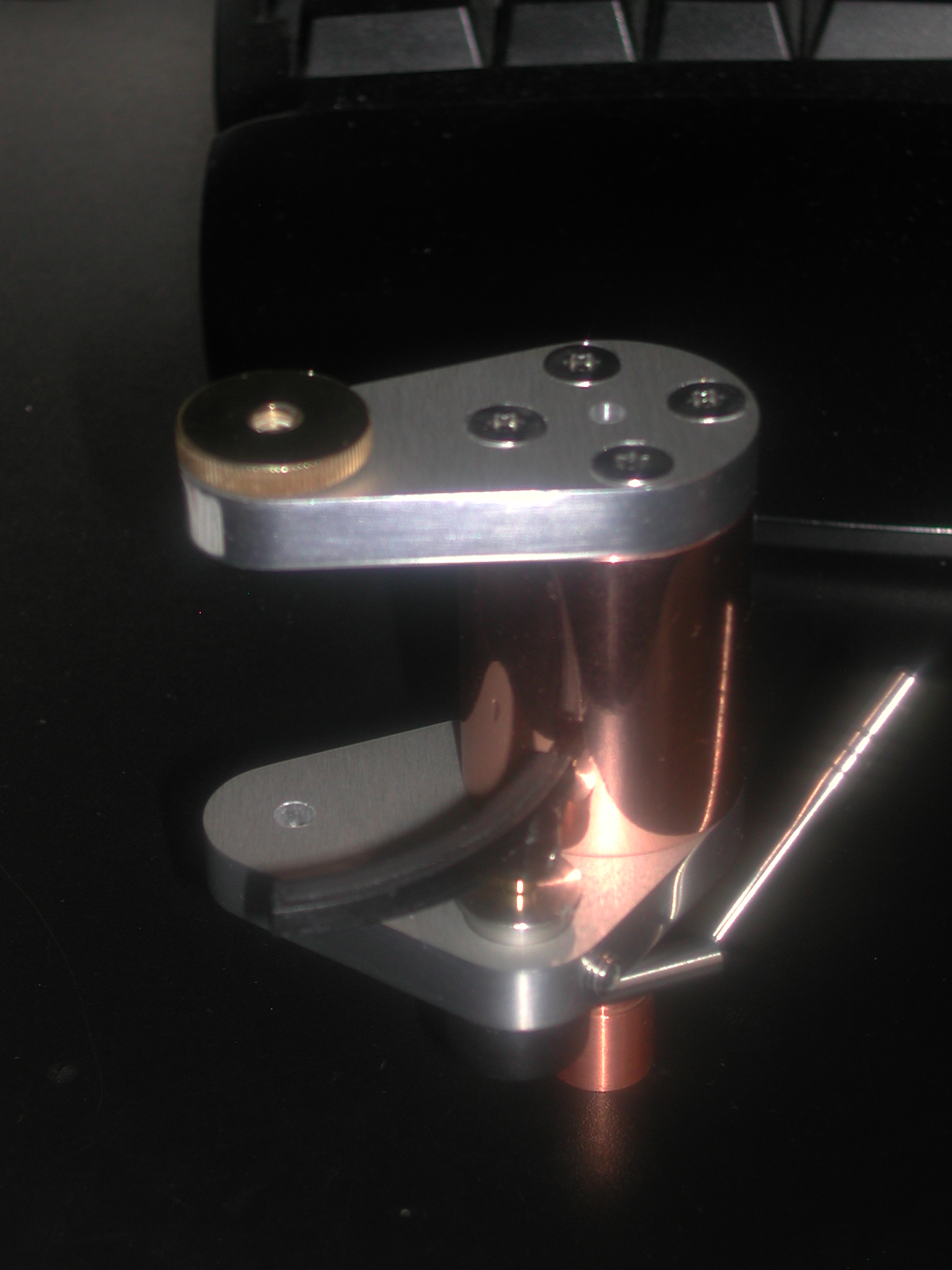

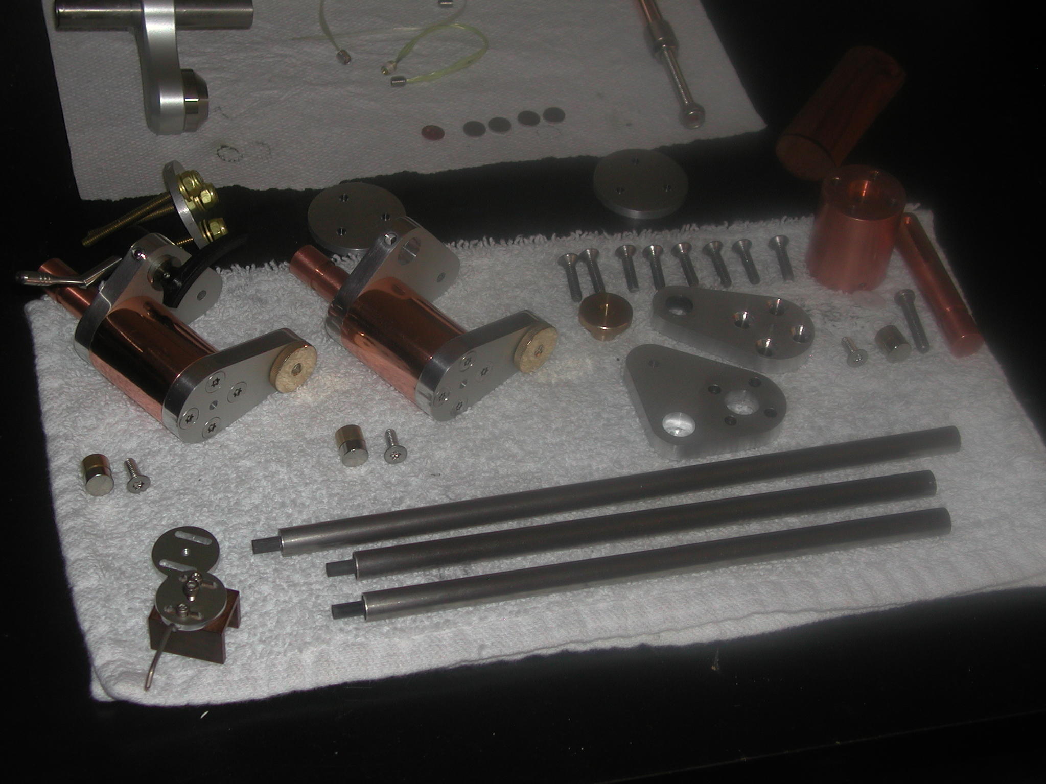

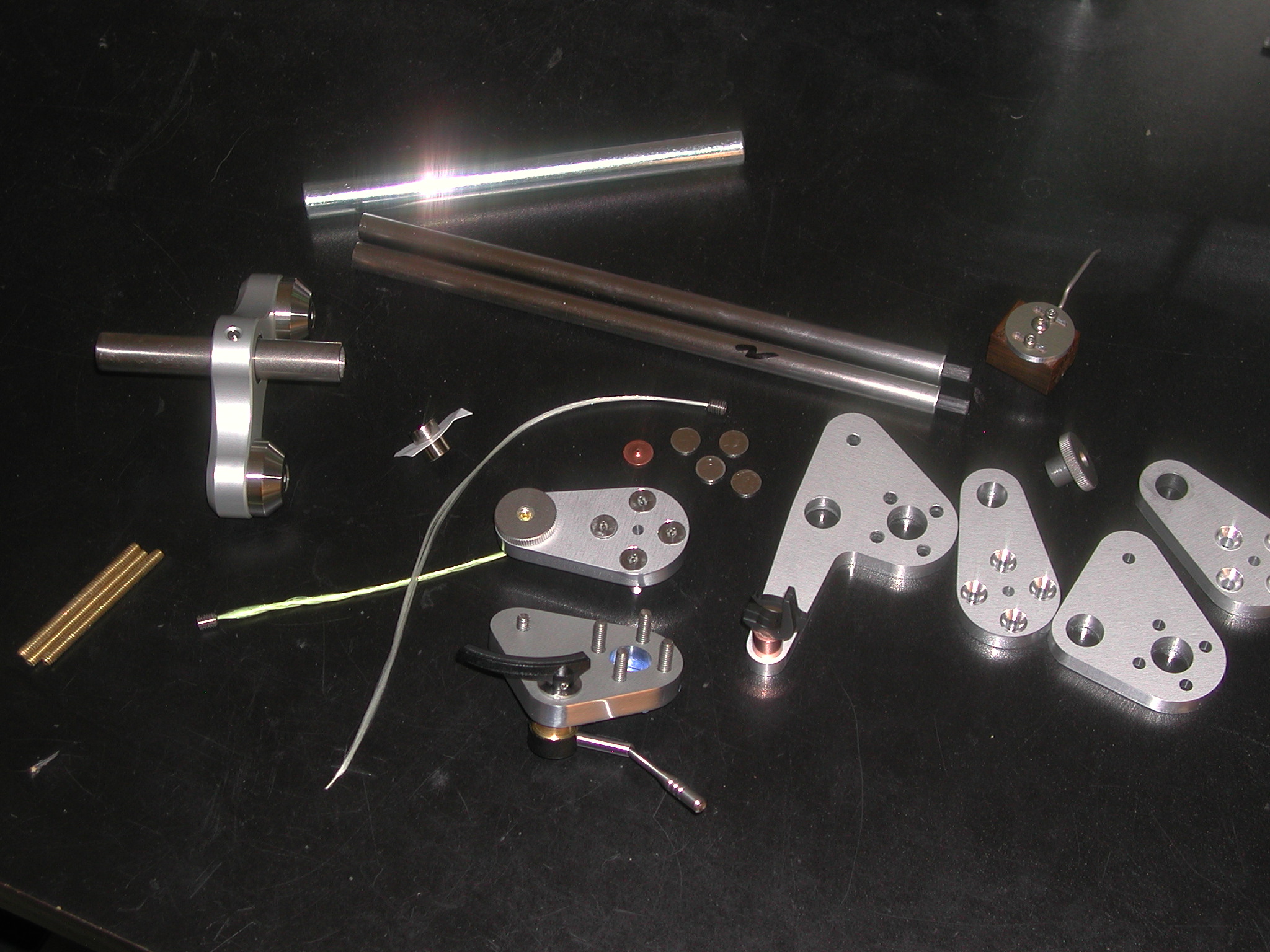

More parts coming in and enough to build up, fit and finish / polish the partial assemblies. One is disasembled for viewing.
I'm building these 3 for myself. One for a Garrarard 401 project and the other 2 for future tables. It was an incremental cost for 3 over 1. Biggest cost was the setup charges for the parts, the piece part price was fairly low. Two of the arms will have a 10.5 inch spindle to pivot distance and the other is a 12 inch.. And NO, they are not for sale, so please don't ask. The drawings are definately not available either.
Jeff Davison
Jeff Davison

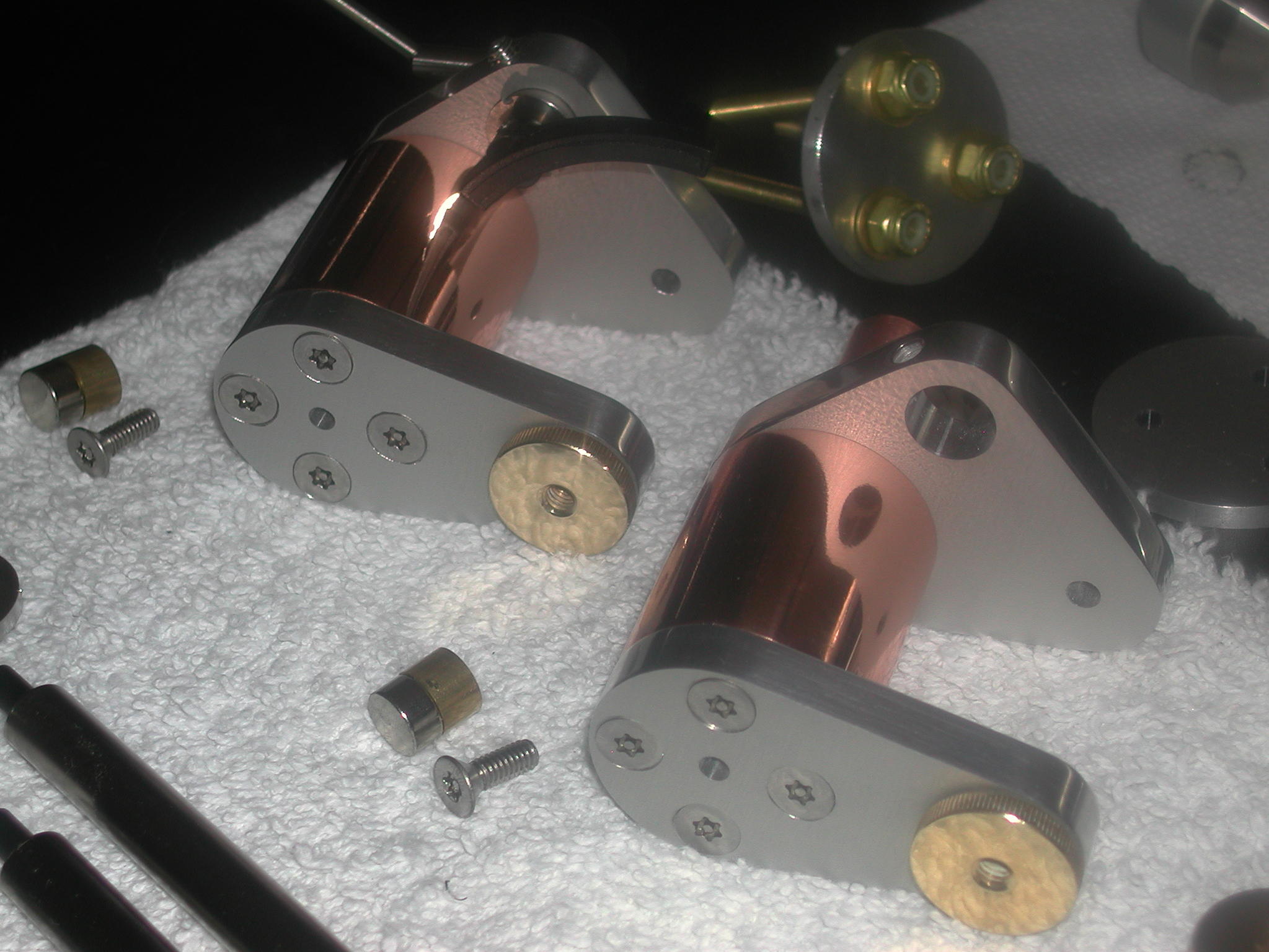

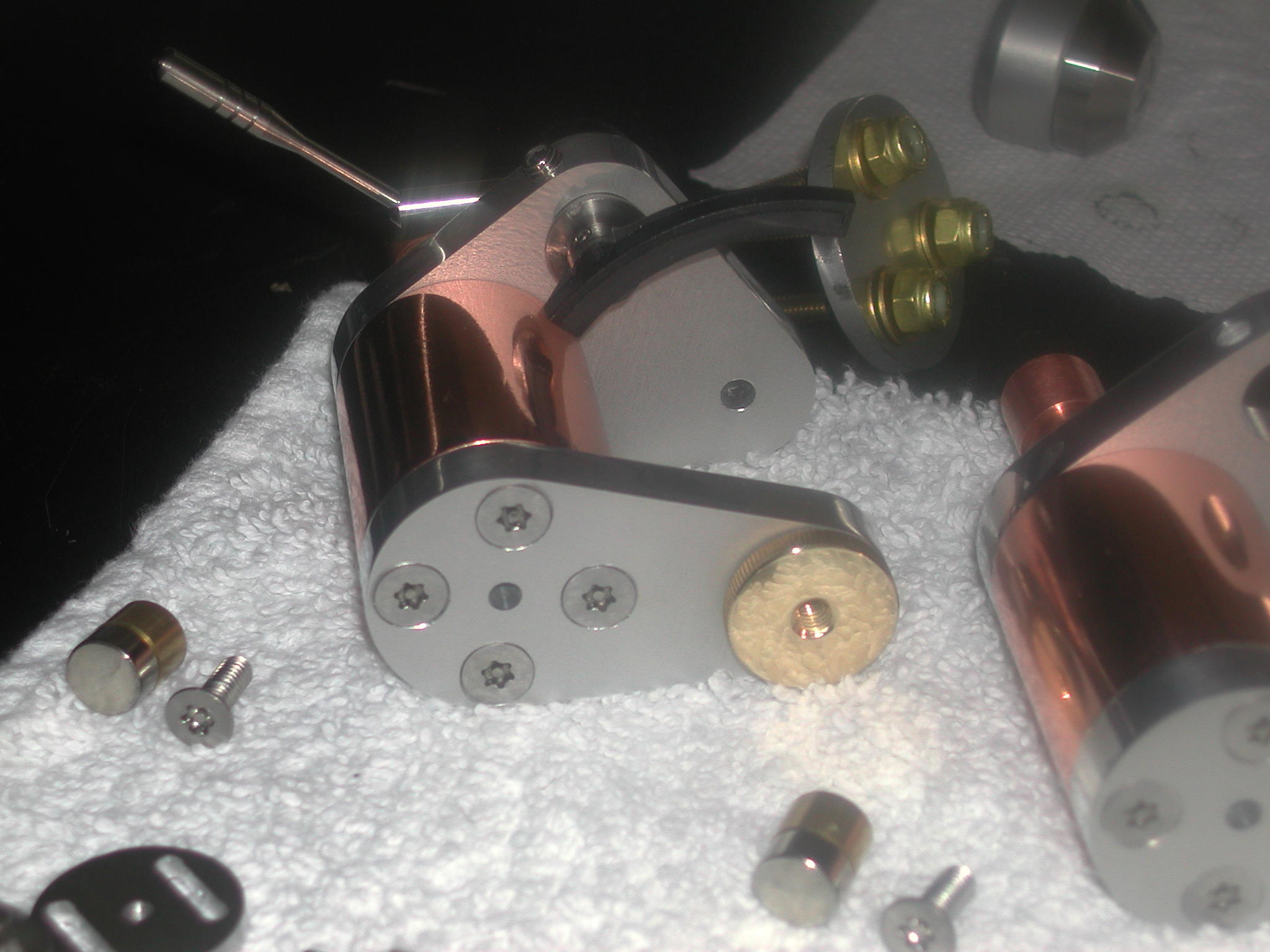

a couple more shots. THe main body is copper, and the armtubes are titanium with an inner tube of carbon fiber suspended / damped with about 10 evenly spaced buna-n "o"rings.
Still waiting for the armtube parts, base, and for the bottom magnet housing.
Jeff Davison
Jeff Davison
