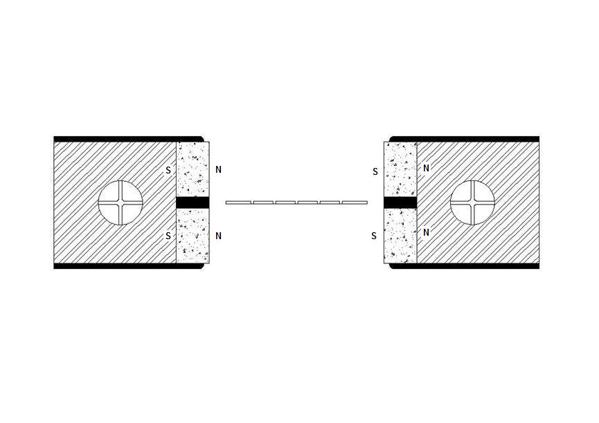

1-Do I have to use a side by side magnet assembly as he did or can I use a single row of really strong magnets on each side? Can I use a 3 x 1 x 1/2 instead of side by side 3 x 1/2 x 1/4 essentially combining the side by side magnets?
2-Will the use of thicker magnets make it more efficient? For example, Will a 3 x 1 x 1 increase efficiency over a 3 x 1 x 1/2?
3-Can someone explain the orientation of the magnets by poles...IE pos to pos and neg to neg with the magnets pushing away from each other?
4-On this site:
Applied Magnets & WindMax Wind Turbines
most magnets are described as 'magnetized through thickness'. Is this what I need?
from two construction pictures, I would say yes, magged through thickness
it will be more efficient, yes
Dahlberg's magnets looks like 2" x 1/2" x 1/4"
so the only magnets you should use are 2" x 1/2" x 1/2"
ofcourse they can be longer
but may get so strong they are difficult to handle

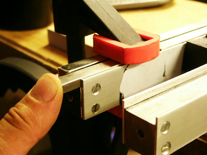

note that each side of the magnet system should be assembled to one unit before placing the magnets
though Dahlberg seem to use a neat trick, so that he can rotate each side, to ease the mounting of magnets
but I can tell, be very very careful here
they will clash together at any chance given, and with exstreme force
but could be a very dangerous trick
make no mistake, or your fingers could be crushed, completely beyond saving
it is a very dangerous thing
and even if using very thick and strong iron, the force of the magnets will bend it
hence notice the small brass tubes Dahlberg is using
I will estimate that the combined magnet force could lift a small car

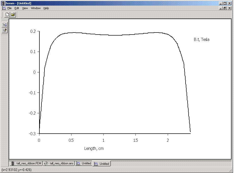

Thanks for the measurements. I reproduced the FEMM simulation.
See attached file.
The picture below shows the predicted magnetic field strength in the gap (range is -0.27 to 0.19).
There might be some differences with the simulation shown on the website since I don't have all the details (e.g magnet strength).
Something to keep in mind: the FEMM simulation is only 2D. In the third dimension, we have a long magnetic system. When the magnetic system gets longer, then the field strength decreases. In my ribbon system, with only one magnet pair (Length = 4 cm), the measured B in the middle of the gap is 0.51, with 3 magnets (3x4cm = 12 cm), the measured B is 0.48 and with 5 magnets (5 x 4cm = 20 cm), the measured B is 0.42. Note that I wrote "measured" not "computed".

Hi, brunob, do you know why that is?
I don't have a an explanation but I have an observation. When assembling one side of a long magnetic system, placing the first magnet is easy. The second one has be pushed against the first because there is a strong repulsion. I think that this repulsion could be connected to the magnetic field decrease in the ribbon gap for longer ribbon systems.
For a small 20 cm ribbon system, I measured already a 21% decrease of the magnetic field when compared to 4 cm long one. I wonder what the decrease would be for a 1 meter tall ribbon?
Does FEMM calculate the field strength for infinite length in the 3rd dimension?
I don't know.
Bruno

So far the magnets4less folks have the best price. If you find a better price please post it on your site. Remember when you glue several dozen strong magnets with opposite polarity and are going to join them with a small gap the combined pull is TREMENDOUS. Be very careful.
