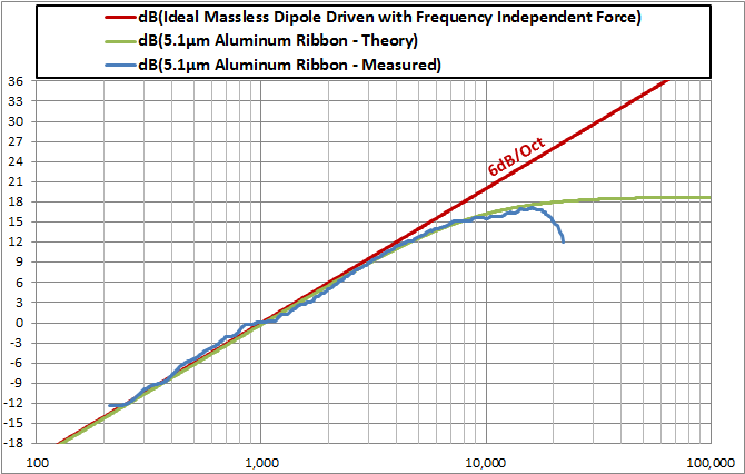

Concerning dipole ribbon response:
An ideal weightless ribbon, with minimal baffle frame, and driven with constant current .vs. frequency will have an on-axis, far-field response that increases 6db/octave. This on-axis response trend will be the same no matter what the size or shape of the ribbon is, as long as you are in the far-field. Taking into account the mass of the ribbon, the response will flatten out at higher frequencies when the reactance of the ribbon mass per unit area becomes greater than the radiation resistance(ie acoustic load) the ribbon is pushing against.
Attachment #1 illustrates this principle, compared to your measured response from post #2

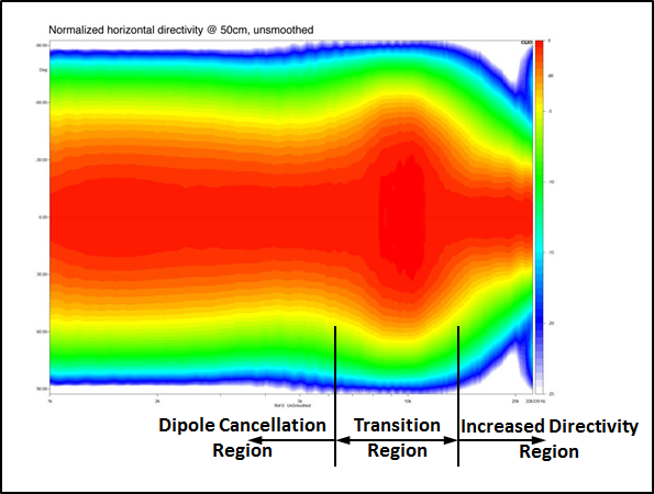

Although the on-axis response trend is the same, the polar response will change with different ribbon size/shapes. This is because when the wavelength is larger than the ribbon width, the 6db/octave slope is due to “dipole cancellation” where the acoustic radiation from the rear side of the ribbon diffracts around the frame partially cancelling the acoustic output from the front side. In this frequency range, the polar response will be nearly constant = cos(angle). When the wavelength gets smaller than the ribbon width, the 6dB/octave slope is due to “beaming” or directivity increase. Because of this directivity very little acoustic output reaches the edge of the frame to be diffracted around to the other side. There is a transition region between the two with a bloom in the off-axis response, but the net result is a smooth 6dB/octave slope on-axis with no indication where the transition region is for different size/shape ribbons.
Attachment #2 illustrates this principle, compared to your measured response from post #3

Thank you very much for providing some theoretical background. If it's not too much work to dig them up I would very much like to see your measurement results.
I definitely have to rebuild my test amplifier and do some more measurements to see if the exact cause of the drop can be determined.

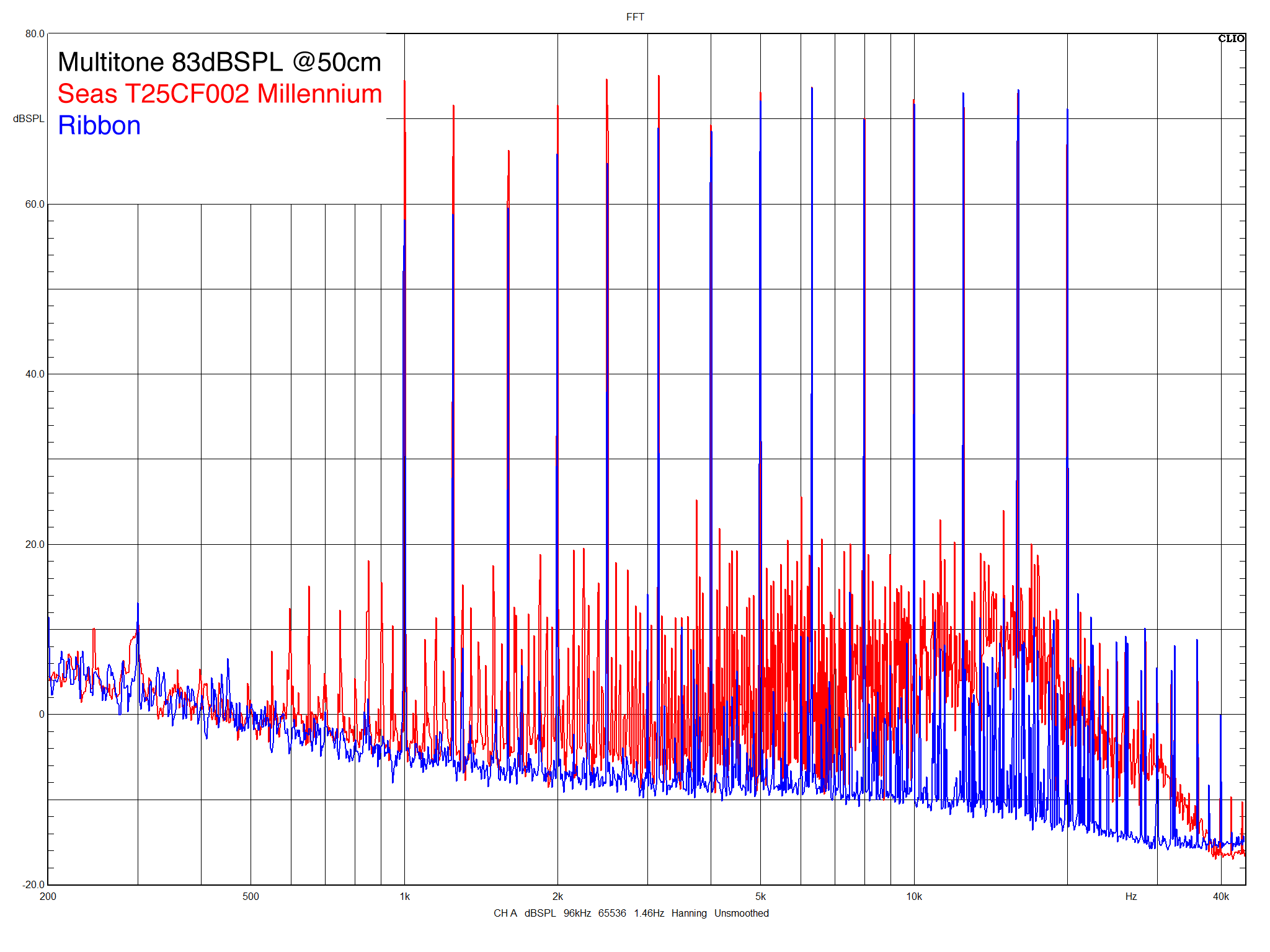

Another kind of measurement:
Although the levels are not the same (the average level for the Seas millennium dome is 85dBSPL) this multi tone comparison clearly shows that the ribbon has much less distortion.
The difference in harmonic levels is too large to be caused by the difference in overall SPL. This to show that the 'sparkle' and 'air' of the ribbon is not due to higher harmonics or intermodulation products. When I have the time I will repeat this comparison with matched levels.
I think that a multi tone spectrum is very useful because it clearly shows any intermodulation products and although it is a steady state signal it is more representative of a musical signal than a stepped sine sweep using a single tone.

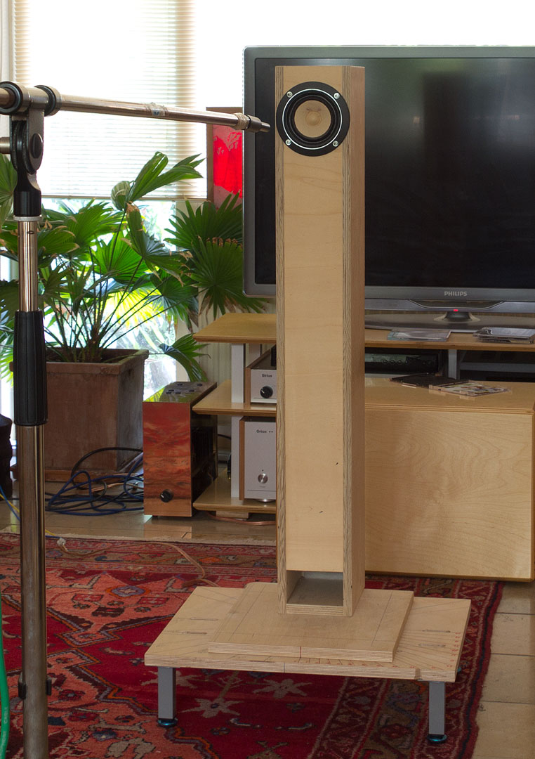

I just replaced a $500 pair of Aurum Cantus ribbons for a pair of $100 fostex 103's, so much better sound. I'm not a fan of ribbons.
Without knowing the type of loudspeaker and applied filters I cannot comment on that.

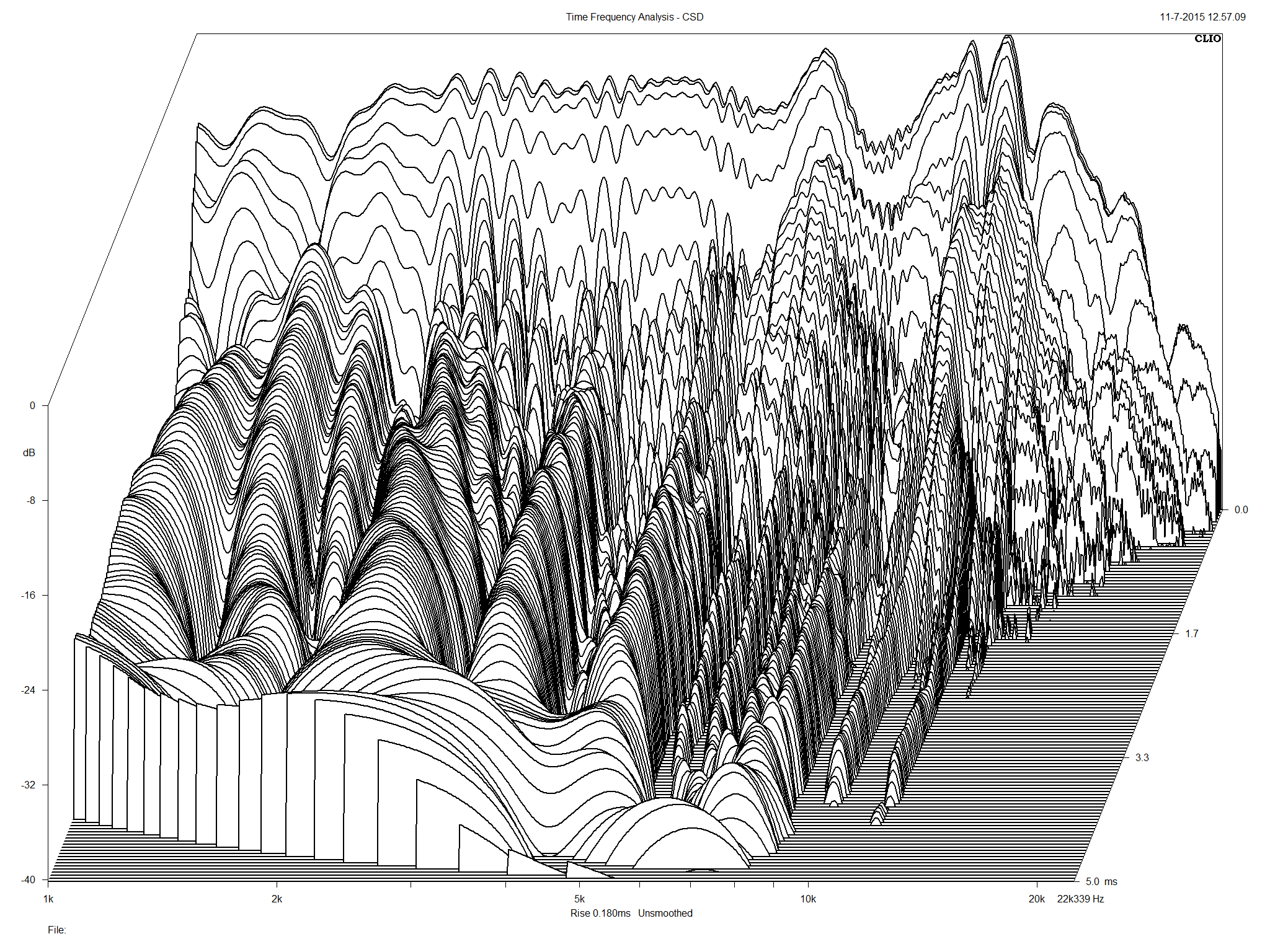

I don't know those drivers and haven't heard or measured them but here's the CSD for the Fostex FE108∑ in a Voigt pipe:
The measurement conditions were the same as for my ribbon, the scale is also the same as for the CSD of the ribbon. The frequency response is highly irregular and the overall picture looks like an artistic rendering of Bryce Canyon.

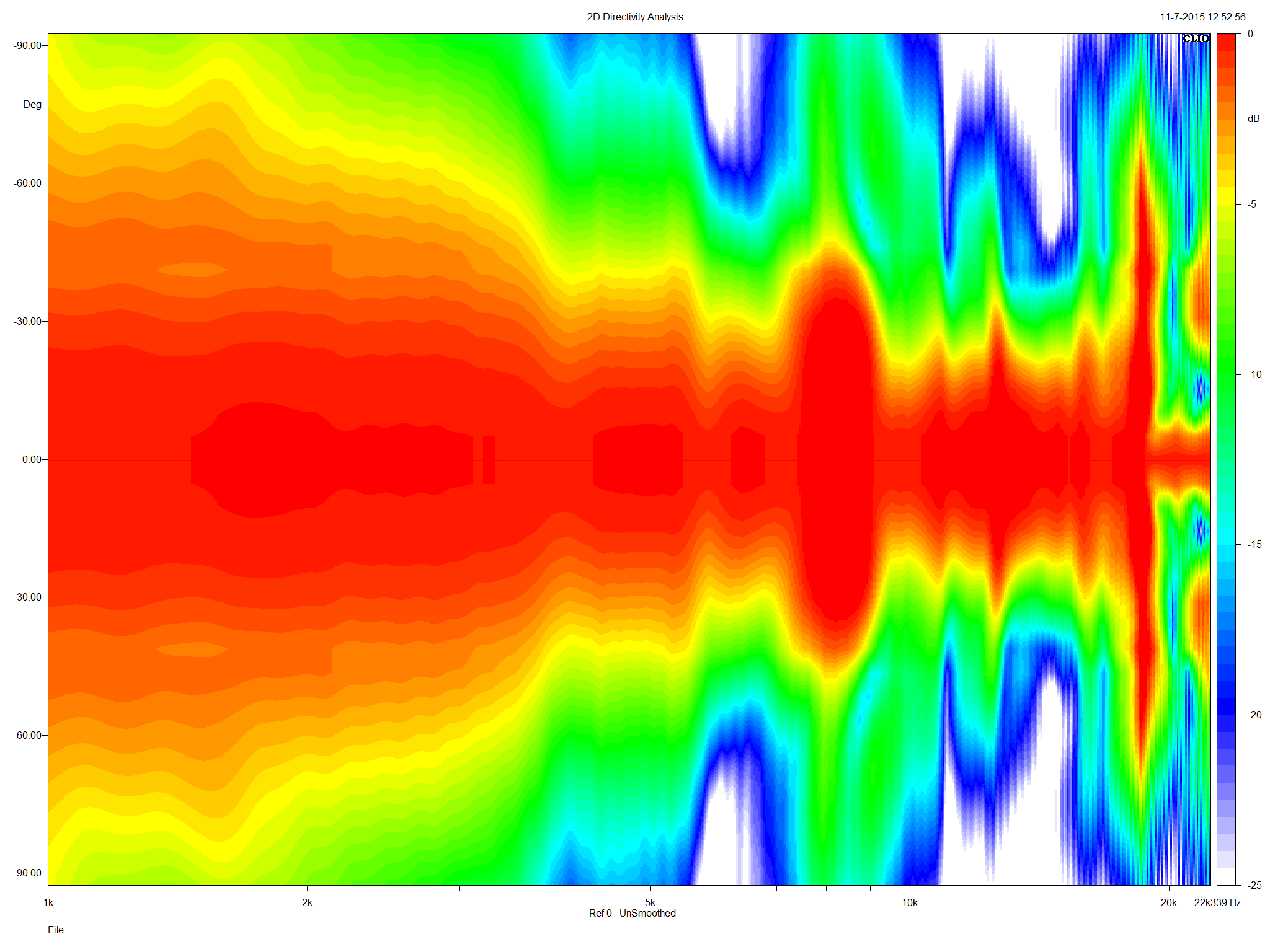

The normalised horizontal directivity of the Fostex FE108∑:
Just as the frequency response the directivity is all over the place. I don't think the Fostex FE103 will do any better and as such it is no match for my ribbon.
Some say that measurements don't tell the whole story when it comes to loudspeakers, that may be true for single measurements but if one driver outperforms another in nearly every measurement (except sensitivity) I think it is safe to say that that is the better driver.

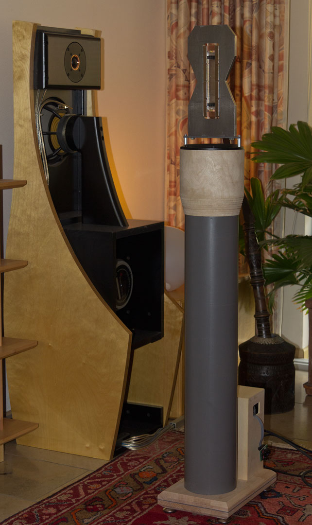

I used the Fostex in the Voigt pipe as surround loudspeakers.
They've been replaced by my 'Pluto' clone (this was before the LX mini)
I call it ODi, short for Omnipole-dipole. My own design is so much better (measurements and sound) that I gave the Fostex away. Compared to the Linkwitz Orion they have a more open presentation and more focused imaging.
My 'Totem of Tone' design with the minimal ribbon takes this to the next level with an even more open presentation (the loudspeakers completely disappear) and focused imaging.

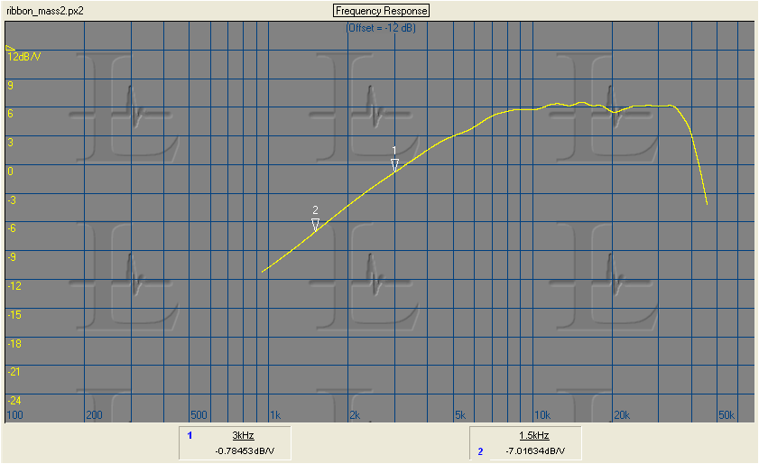

Tangent story...lost many years of measurements when hard drive failed on test computer.
Note to self, make regular backups.
However, I did manage to locate a screenshot I had emailed a friend.
Ribbon size was 3/4" x 3.5" (19mm x 90mm) with minimal frame similar to yours.
Measurement was taken 1m on-axis, with 1/24oct smoothing applied.
I just remembered one other thing I experimented with that you may be interested in was using a curved piece of 60% open area perforated sheet metal as a magnetic return path on the back side. It had minimal effect on the response and bumped up the sensitivity by +3dB. Hopefully I can locate a screen shot comparing the response.

Very nice result indeed!
My next experiment will be to try to turn the ribbon into a cardioid by applying damping at the back. This should result in much more output and also makes it possible to place the ribbons close to the back wall.
What did you use to drive the ribbon?
regards,
Gerrit
Ribbon was driven with ATI 1202 amplifier thru a 3 ohm series resistor.
I used the reference probe input from PRAXIS to measure voltage across the 3 ohm resistor which would be proportional to current thru the ribbon. By using the reference probe signal PRAXIS automatically adjusts for any variation in amplifier response, so the frequency response shown is truly for constant current drive signal.

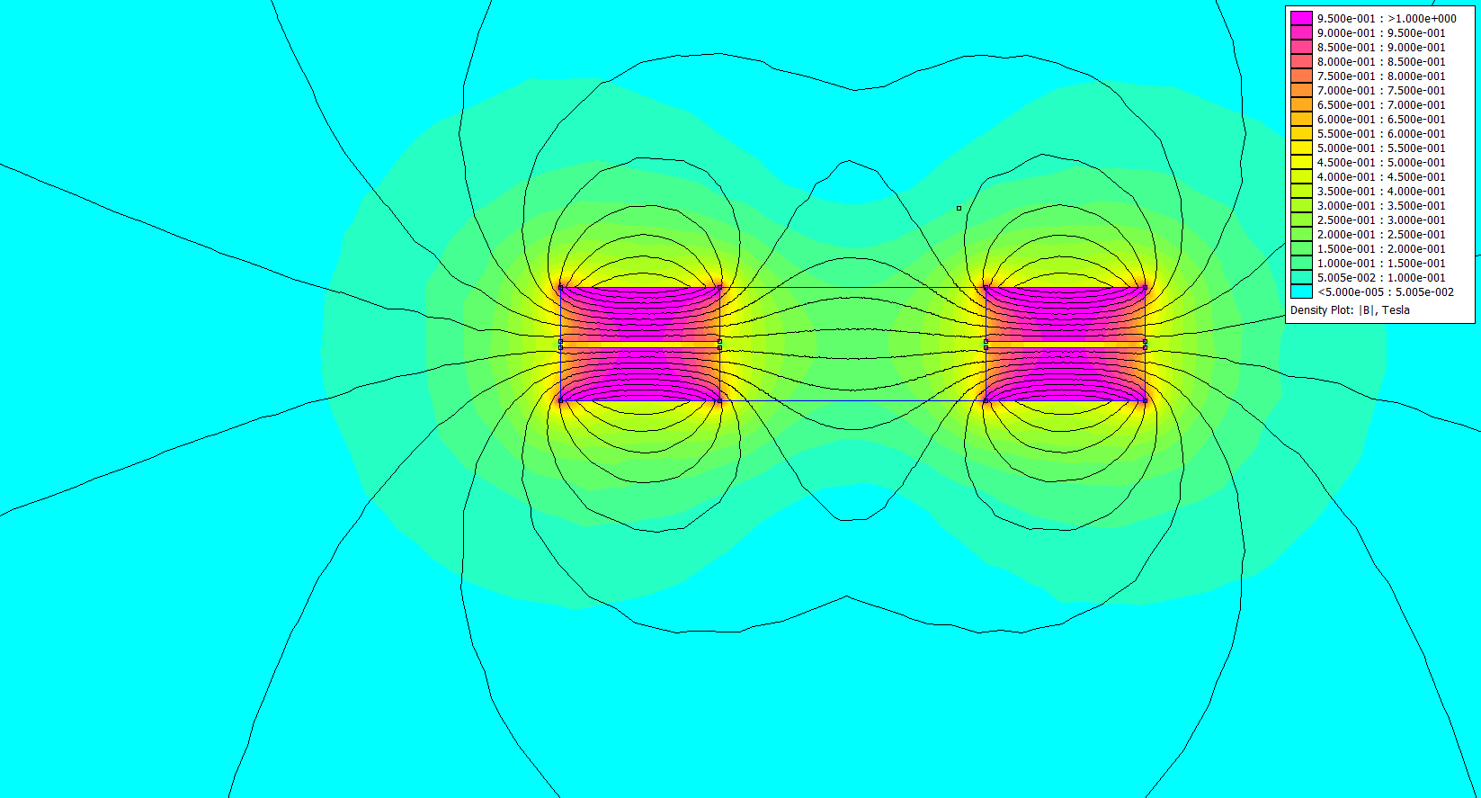

The double magnet construction results in a significant reduction of the distortion. Here's a comparison of my minimal ribbon and Neo10 (response in blue, THD in orange) and my earlier steel frame ribbon with single magnets (response in red, THD in green). The dimensions of the ribbon are the same.
The scale for the distortion is in % on the right side of the graph. The THD is about the same but the level of the minimal ribbon is higher and the minimal ribbon has a 12dB boost at 2kHz to compensate the dipole loss. The response for the earlier design also shows a severe resonance problem at 7kHz. This is a result of the applied corrugation, the new method with the ribbon cable corrugation does not have this problem.
