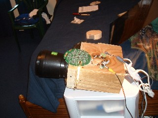

I build the projector that goes inside case, but I don't think its bright enough. I can barely watch it on the wall. Looks like I might have to find a new light source. If anyone has any ideas post them.
In the picture its basically the design as my first one. I used the Figinon lens form surplus shed, Sony Psone LCD, a fan and a light source. The light source is a 150 watt halogen bulb, which is not bright enough. I might try one of those MH bulbs other people are using and see what happens.

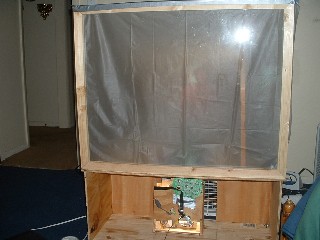

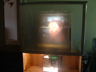

Here is the start of my new rear projection tv. Its basically the same as the first one, but I figured out how to make the screen more viewable. The first one I build the screen was lower which caused me to look down on the screen to see it. The new screen will be 6 to 12 inches higher which should make it eye level. I also solved the brightness problem by making something that keeps alot of the light in. All it is three pieces of wood, two of them has a circle cut out the center the diameter of my Figinon lense. The other has a rectangle cut out of it to hold the screen. Now no light is leaked out when it is turned.
The picture I post does not have the right sized mirror thats why the projected picture is so small. A mirror the size of screen is better because increased brightness and makes the tv thinner in it's depth. A glass mirror the size of my screen will be heavy and expensive thats why I'm going for a acrylic mirror from www.usplastics.com 48X24 only $26.00.
Later this week I will post some pictures to show my progress.

heya rmccoll,
nice job.
there's a mod for that psone-lcd makes the picter brighter. see here .. http://diyaudio.com/forums/showthread.php?postid=400154#post400154
i'm usin a 70 W hqi from osram in my pj. that's bright enough to see already in the dawn. for a rear-pro it'll be enough.
hope that helps abit.

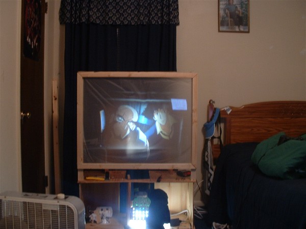

Here are_my latest result from my project. I figured out that I don’t need to use a mirror the size of my screen to get a brighter picture. The mirror I’m using now is only 20X16, the gold trim around the mirror is causing a reflection on the screen. As you can see in the picture my projected image is smaller, but only by 4 inches. Once I get the whole thing build and paint the inside black the image will be much brighter.

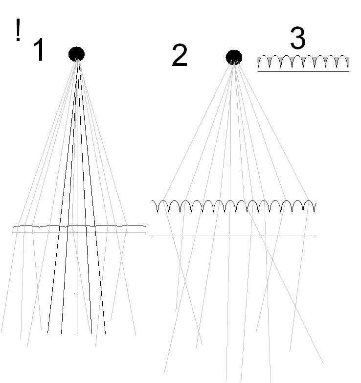

Hot-Spotting and the right screen to use
Hot spotting should not be a problem, if it is here are two of the reasons:
1) Too much direct light is getting through the screen,e.g. the screen is not diffracting the light. Sorry a shower curtain will never work! As it is not diffracting enough light. Hot spotting is ocouring because too many of the rays of light are able to pass straight through the screen in comparison to the number that are being diffracted. Hopefully the following diagram will help you
***Hopefully the diagram I am now going to refer to will upload ok with this post!***
In diagram 1 the black lines are the light that passes straight through the screen, the grey lines are the lines that are are being diffracted by the pitts in the glass. By the way the only way to go is a screen made out of glass!! Basically what is hanening is you are seeing too many rays of light coming straight from the blub e.g. the black lines!!!
In diagram 2 the screen is far more pitted on the back so all of the light is diffracted. Imagine millions more light lines of course, the result is a dimmer screen but with no noticeable hot spotting. Very little light just goes straight through the screen, un-diffracted, now that is the secret to success.
By the way, anyone wondering why the glass is thicker on picture 2, it’s not intended to be, when I was drawing it in Paint I forgot to move the straight line, and started to put in the light lines, then I realized and couldn’t be bothered to start agin!
To anyone wondering if this works, back in the 1980’s I did presentations using 16mm film projectors with screens sometimes greater than 6 feet in diameter, with no hot spotting problems. Some “serious film amateurs” (very serious in my mind!!!) had small cimemas in their houses and used rear projection because you can hide some of the sound of the projectors, and again no hot spot problems. The surface of the glass is not smooth, it is very very very pitted, so the light is diffracted in all directions.
2) Reason two, is down to incorrect optics, e.g. focal length of light condenser lenses, sorry I cant give any more info here but it is really a case by case scenario.
As for making a screen, they are called ground glass, but having talked to some of my ex-colleagues recently, it would appear that the name is a little deceptive; a better description is ‘severely sand blasted glass’, where the glass is really white and ruff on the projection surface (any one who has done any sand blasting of glass will recognise what I mean by that), not just a little white, but really white. Easy to make if you have a compressor and sand blasting gun. The firm I used to work for made our own screens in our workshop, so it can be done, we didn’t have any special tools ect. Now a very interesting idea I have been told about is that once the screen was sand blasted severely, it was often given a coat of black paint, then using sand paper or steel wool it was scraped back to reveal the top “humps” as it were of glass, leaving a slight back coating, it would improve viewing a wide angles as only diffracted light went through and bright ambient room light was reflected. Diagram 3 shows this idea. It would be interesting for someone to try this again! This was done before the days of easily available anti-reflective coatings. This is also basically the same idea as glass impregnated black plastic screens!
Just one more thing, please stop using / recommending shower curtains, I hope from what I have written above you will all see why they will never work, though I guess they are good just to test your ideas!
