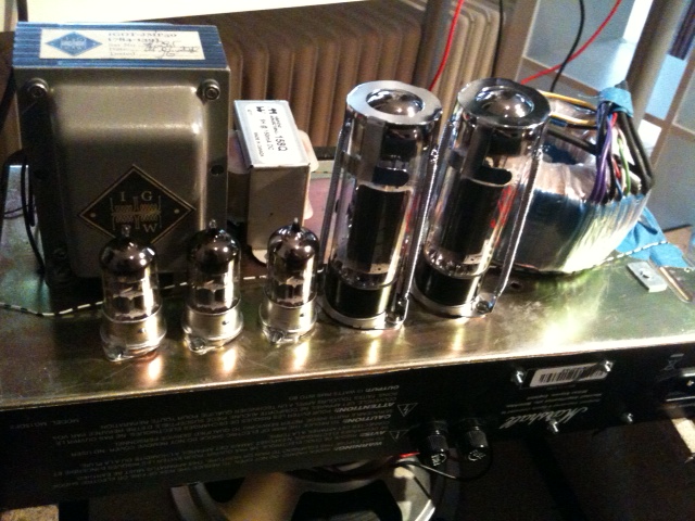

I'm new to this board. The main reason is because I encountered a noise problem with my DIY JCM 800 2204.
It plays well on low master levels. If I turn up the gain or play the strings very hard, I get a buzzing sound out of it. However, the main volume does not cause a noise.
Now I'm wondering, where the problem may lie. I'm sure you experts can help me out. Is it wiring, the tubes or caps? I don't know.
I've attached a sound file where you can hear the noise. I'm turning the master knob up and down.

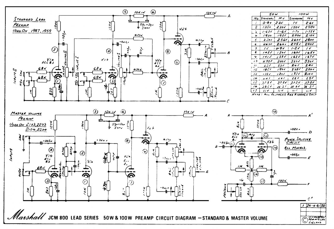

Maybe share a bit of your progress now, at least the schematic for those not familiar with the JCM.

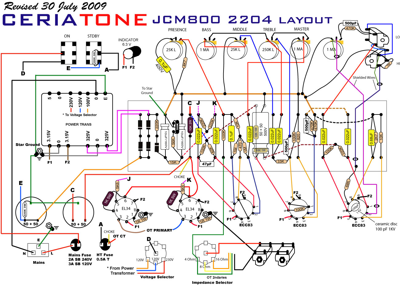

Is it like one of these layouts?
Have you compromised or omitted any parts?

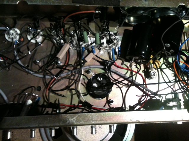

I used the layout you posted - Ceriatone. I exactly rebuild the amp, using only the best parts on a turret board. Only difference for me: no resistors on big cap & standby. And no voltage selector & impedance selector, but instead hardwiring to 230v and 8ohm. 4ohm line is connected to board directly.

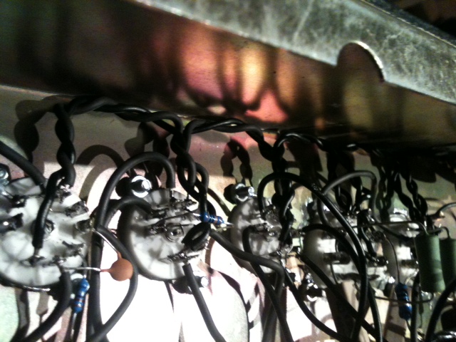

I realised my poor heater wiring and completly redid it the proper way - twisting, angles, etc. The amp sounds different, but anything from normal. I still get a high pitched noise when strumming hard or turning off. Even if gain goes up more now, its a similiar effect then before. If I turn up volume and gain as much as it is possible without getting buzz, the guitar still plays pretty silent. It's supposed to blow me away on that level.
Biasing tubes is not really possible, as I don't have any voltage on the 1ohm resistors on standby. Turning standby off sometimes gives me a voltage and sometimes its zero. Weird.
I'm really frustrated and I'm beginning to think that I should have invested the 300 bucks in a real amp... Well, but now as someone answered, I dont wanna lose hope.

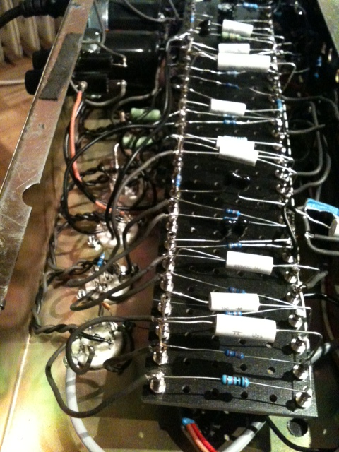

You need to post some clearer pictures. Turn on more lights or usse a flash.
In the second picture it looks like the input jacks are right across from the output tubes. Is this correct? That doesn't match the layout. The schematic above is wrong, it's for the 1987 and 1959 models. The 2204 has just two input jacks like the layout and the two triodes of the first tube are cascaded. Where are the 5.6K resistors located? Are they on the output tube sockets like the layout?

@loudthud: sorry for the pics. I finished work at 12 pm and didnt have a light. Ill post new ones tomorrow. I have rewired the amp so that input jacks match schematics. 5,6k resistors are the wooden looking ones- they are 5 watts each and are soldered to the output tubes. Cascaded tubes means they are linked to the board together right?! Should be the case.

There are a lot of wires that are not twisted with another wire. Any "enclosed loop area" of a pair that's not twisted together will act as an antenna for every time-varying electromagnetic field.
There should at least be an "input signal" and "input signal ground" wire pair, and that pair should be twisted tightly together, ALL the way from the jack to wherever they connect (maybe across a resistor to ground, at a grid input?). Ditto for the output pair. Ditto for all DC power/gnd pairs. Ditto for the AC input pair and for the rectified AC pair.
The layout mostly doesn't lend itself too well (for me at least) to figuring out what pairs go together, and the wiring scheme looks like it just mixes a lot of the grounds together, which might mean that (unless you break up the ground buss and implement real star grounding) a lot of the low-voltage wiring might be better if it closely followed the ground buss, to minimize the enclosed loop areas.
Anyway, for now I'd try sorting out the input signal/ground pair and make sure they don't encompass any area between them. And I'd also look at the ground reference voltages' connections to the star ground. For example, where the input pair connects across a resistor between a grid input and gnd, there should be a connection to the ground end of that resistor, that goes to, um, ground. Anyway, if that connection SHARES lengths of conductor with other ground-returns, before it gets to the star ground, that could be a problem. I'd try running a dedicated wire from there all the way to the star ground point (and disconnecting the original connection that went from that point to the rest of the grounding system). Actually, I'd do the same thing for every small-signal input ground reference voltage, for all tube inputs where it's applicable.

Your correct with your shielded input wire. (No twist)
Generally speaking, you ground this input lead directly at the first tube socket. If it works at the star point, OK I guess.
Make sure the 68K gridstopper on the first tube is short and connected directly to the socket.
I can't gain much from your pictures from all the black wires, sorry.
