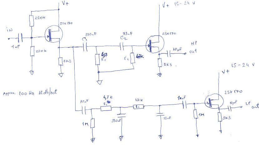

Since it's going to be a while Nelson publishes the crossover schematics that he use for his Open baffle Woofer+ fullrange combination, I wanted to experiment with this little circuit and see if it will work...
The idea is that it is basically a 2nd order line level crossover, trapped between two minimalistic Jfet buffers...
