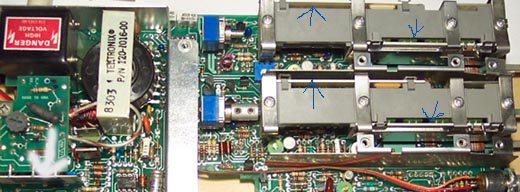

Many of the TEk scopes use hybrid modules which take many forms. Some are deposited film resistor networks with opamps built on to them. This is used in many of the portable TEK scopes. These hybrids not only allow the scopes to be small but they also allow incredible specifications to be met on production units. These critical parts are all adjusted when they are deposited on the ceramic substrates thay are usually found on. Many TEK scopes also use ALOT of custom I.C.'s that are NLA. Thay can only be gotten fomr scrapping another scope. Having these hybrids and I.C.'s is not really such a bad thing because it allows exceptional performance in these units. The only drawback is their non-availability.
The photo below shows the vert/HV board of an SC80 which is an 80 meg dual trace TM500 series scope. The 4 blue arrows on the gray switch modules point to the input hybrids, and to the attenuator hybrids all of which are actually located on the input range switches. The gold switch contacts are also on these ceramic plug in hybrids!! The white arrow towards the rear points to a thick film hybrid that is in the HV divider circuit. This hybrid divider supplys a few of the many operating voltages needed by the CRT. These scopes are works of art inside and not many companies can claim that. Hope some of this this helps......
Mark

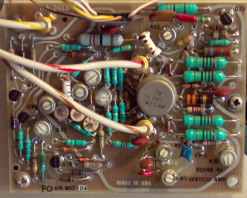

Here is another example of hybrid custom stuff in TEK scopes. This one is the Verticle. amp in my 7704A. The round part to the right of middle is a hybrid I.C. custom made by Tetronix. It is essentally the entire vert. output amplifier. If this IC fails one has to track down another one fomr one of the several TEK parts sources out there, or get one from another scope. These I.C.'s are found in LOTS of TEK scopes. Indeed you will have trouble with the 24XX scopes for parts as TEK stopped supporting CRT based stuff, and most of the TM-500 stuff about 4 to 5 years ago. Most of the parts stock that was left went to surplus houses. The older 4XX series and earlier also have far better CRT's with much sharper traces. This CRT sharpness problem was a big deal for alot of TEK users and is why the 465 still pretty much remains the most widly used service scope today.
Mark

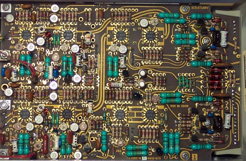

Yet another example of what there can be lurking under the covers......
The 8 black round things are more custom I.C.s. These are in a 7A26 vert input module being used in the 7704A. This module has a bandwidth thats good to 250 mhz! These run hot! not like Pass Labs stuff, but they do get hot...
Hardly trying to discourage anyone from buying a used TEK scope....am only making those aware that there are special things under the hood. This is perhaps also another reason that certain tube TEK scopes still have such a huge following. Seems like tubes will always be around.
Mark
