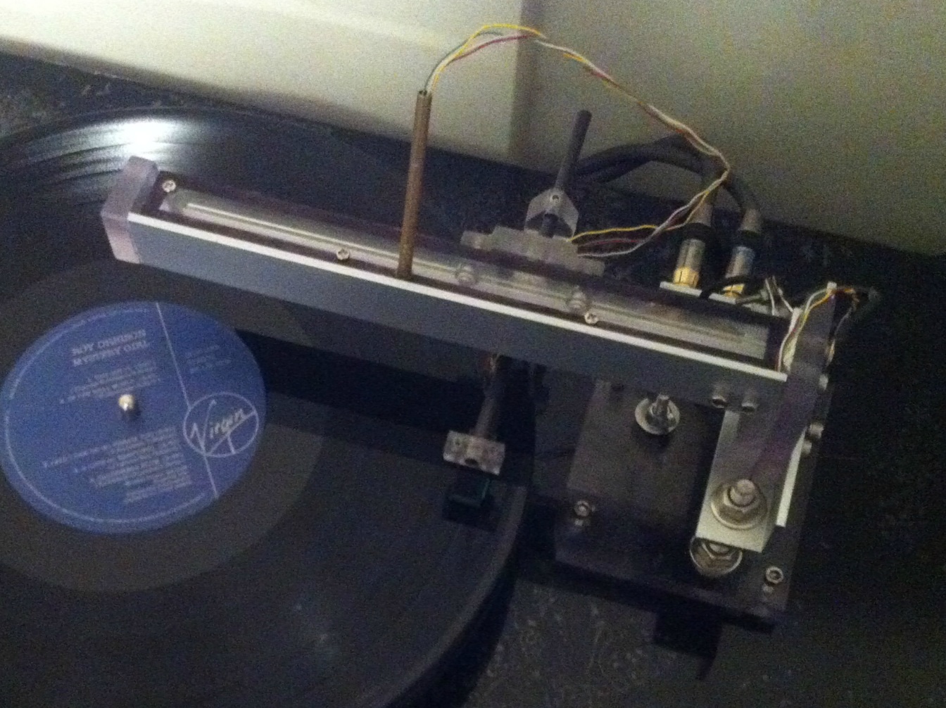

And voila, two tube, two bearing working and non falling off arm with a dust cover, only arm lift left to go, PDR, thanks for the inspiration, this is what its all about :). Seems all in all I needed to do some more work with the two tube design I tried out a couple moons back, thanks for proving it can work and needed further investigation.

Yes it tracks phenomenal!, but!, I've utterly solved any ringing tone with my last iteration inspired by PDR!. My knock up with the aluminum angle and polycarbonate dust cover does not ring at all, even at low frequencies!. I've tapped it with a still record, no ring just a dull thud. There is no damping added to the arm at all!. This is great, this is getting refined.

Colin
Can you post more pictures from different angle please?
Thank you very much
Greetings Gabor
Another pic, glass tube sizes are 6mm side by side at the back of the 1x1x1/8" alu L. Polycarbonate top is bolted with circuit board standoffs.

That looks great Colin.
Just so I get it.....the tubes sit directly on top of the alum. angle?
Are they epoxied or glued? Do they sit on a membrane? Would a
membrane be beneficial for isolation?
This is cool as the angle becomes the connection point to the
rest of the arm and the tube assembly can easily be swung out of the way
to place an album, or detached quickly if needed.

I haven't spent enough time with it yet to really assess differences, at first though it seems a tad lighter in the Bass. Laterally it tracks better, as in feels smoother laterally and any ringing from tapping the track is non existent.
pdr,
The glass tubes are glued to the aluminum, works just fine this way with no added noise
Thank you for the kind words, I spent a good day dreaming up the simplest most effective way to do this, this version makes my single tube look busy but the dust cover has two benefits, dirt protection and along the back out of sight underneath ithas a small strip of split carbon fiber tube which prevents the carriage from falling off during mishaps and cueing :)

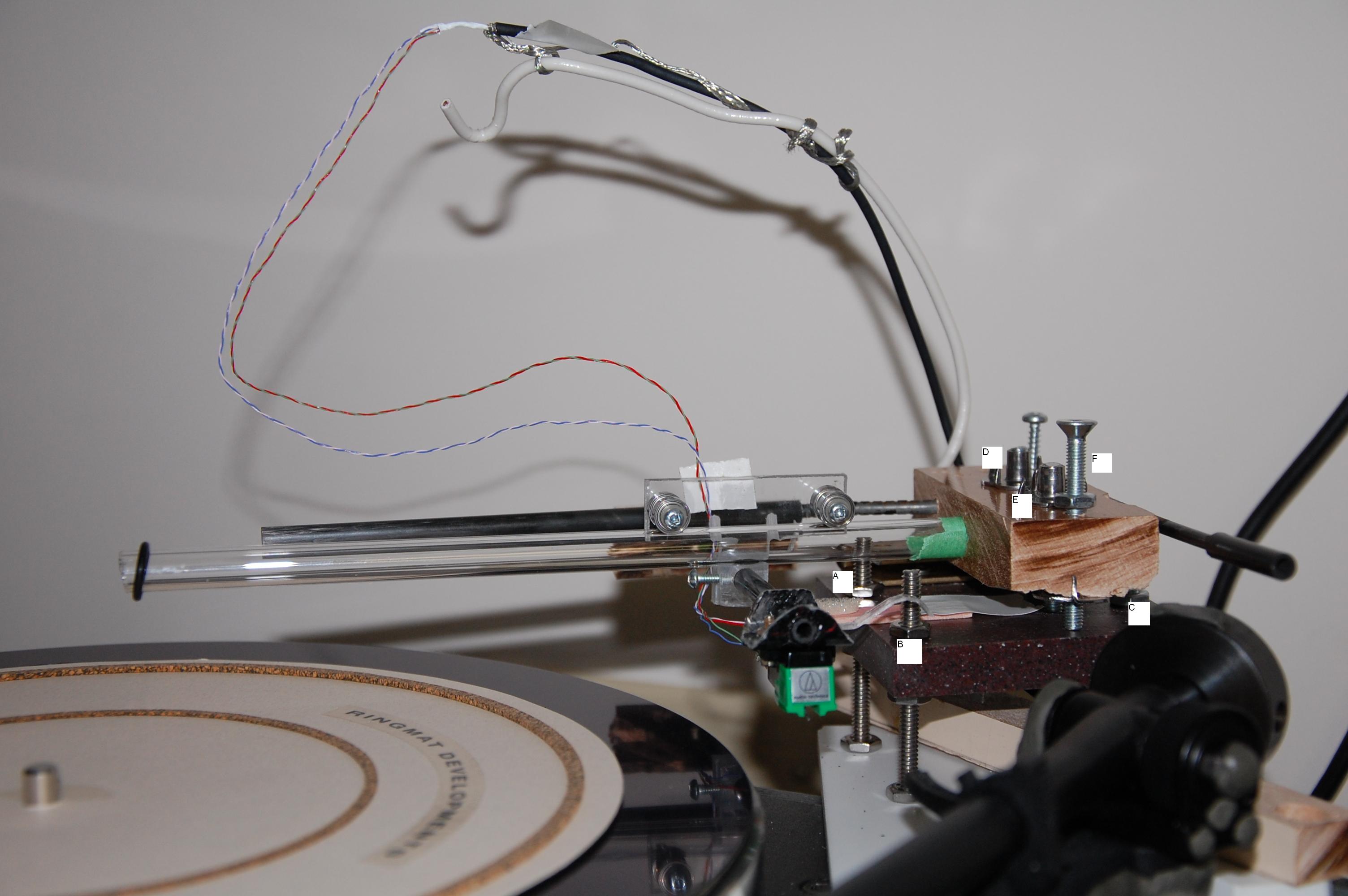

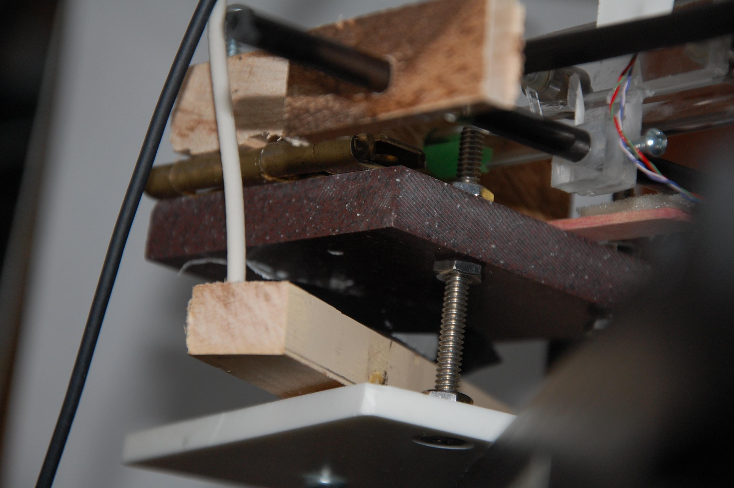

Hope these pictures show up. First attempt at adding photos.
Colin,
Nice workmanship on your double tube version. It's in stark contrast to the "Prototype" photos I'm attempting to attach.
PDR and others,
You hinted at VTA adjustment. I think that's even more important with this shorter arm because a change in LP thickness makes a bigger change in the rake angle.
On mine, the 3 bolts labelled A,B,C are used to set the nominal height of the dark brown base and set the glass tube parallel to the platter. I loosen the T nuts D and E, then use bolt F to lower or raise the maple block. Afterwards, the T nuts are made thumb tight.
In the second photo you can (maybe) see the hinge at the back that allows the maple block to swivel.
This is very quick. Works like a charm on the single tube version. I'm not sure if it will do so well on a double tube version. Tossing it into the ring anyway. Hope this sparks some better ideas.
I also want to mention the cartridge is attached to a piece of material that should be familiar to all the Canadians on this site. Any guesses?
Hugh

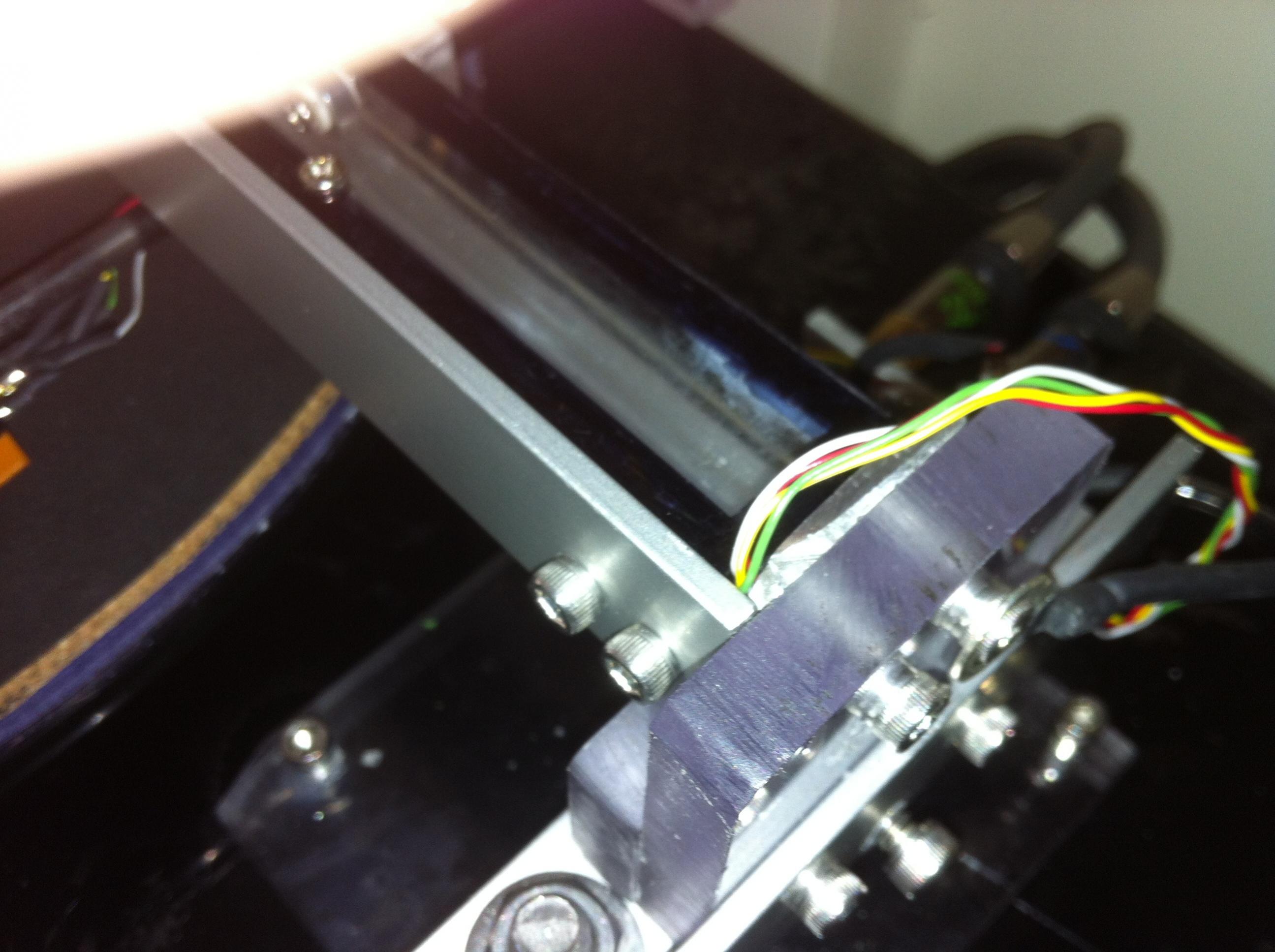

Colin,
You got my curiosity way up on how the resonance is eliminated in the new model. Needless to say I'm building something along those lines. A question though. How is the horizontal L angle mounted to the vertical member? Is there any lossy material between the two? Also, is the glue joint between the tubes and the "L" continuous along the tube length or just in places, like the middle and 2 ends?
Rgds,
BillG
Hello hjam
Having resided in Canada for five years, I'll make a guess.
It looks like one of those sheet metal "squeeze to release" spring clips. But I don't know what it is called.
If that's what it is, it actually is a very clever idea. It would allow instant adjustment for effective length and azimuth.

Bill,
The two tubes are tacked in 5 points along the aluminum L. The L pieces is attached to the 10mm polycarbonate on the arm base via an aluminum L piece bolted to the inside on the track. Here is a photo of the connection.
Thanks. I have pieces of glass coming in a few days and some scrap aluminum for the L. It won't be long before there is a test piece made up. looks like we are evolving back to the Cantus albeit an inside out one. I have long felt that the bearing free play available with the 2 bearing design was a highly/most effective way of dealing with typical small warps. I nhave a couple of records with smallish warps and was clearly hearing a touch of warp wow with the single tube design. Was listening critically last night to those 2 records and not hearing even the faintest trace of warp at all. Will have to keep listening.
