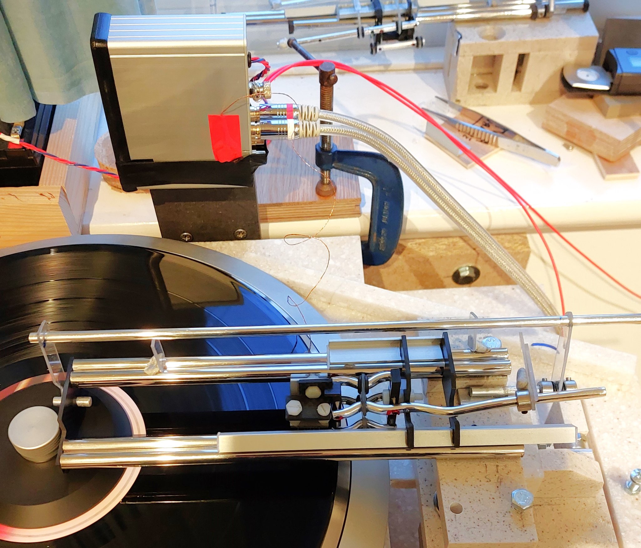

For some of you who may not have enough to do, please have a look below at my latest iteration.
It has a new lighter carriage, carbon crossmembers and lighter rear carriage rail, shortened also to remove unnecessary rail length.
It is now playing with the cartridge wires directly into my phono pre, neatly taped to its stand!
I always admire other posters construction standards!
It played its first side while i typed this up, all went well.
Auto suggestion kicks in here and tells me it sounds better.
Anything that takes a few days to make must sound better, mustn't it?
Sether may notice this has allowed removal of the front ballast weight, because of the lighter back end.
Horizontal and total mass are over 5gms lighter.
I cannot pretend i expected an audible difference, but very clean bass lines and tunefulness, clear top end are noticeable to me.
I will do some measurements at some point.
This will also allow me (eventually!) to lower the CW arm which will remove a small rising VTF in warp, a couple of 10ths in 5mm of warp, totally irrelevant (imho) in real life but i will do it anyway!

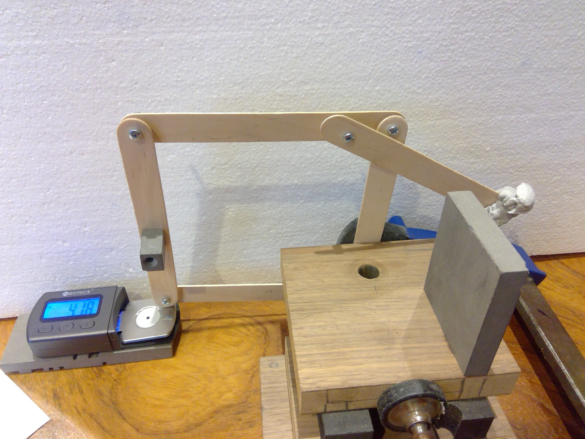

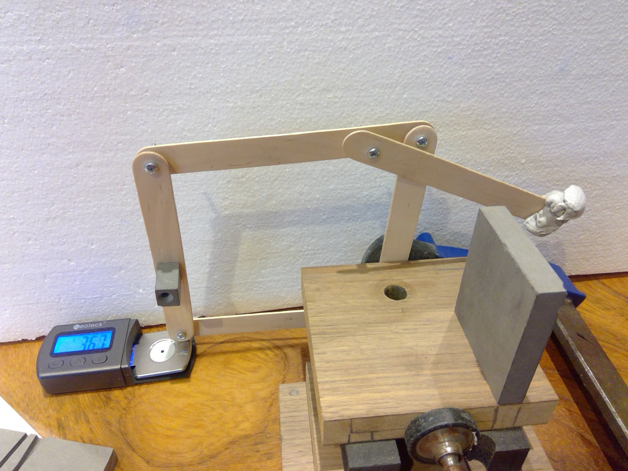

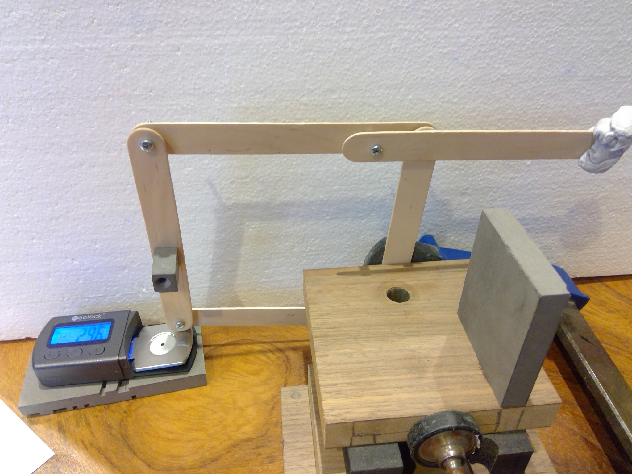

Mike be careful altering the COG from where it is, a few 10ths of VTF increase in 5mm means the COG is slightly under the virtual pivot. If you raise COG too far and have VTF going low as the stylus rides up then it means the COG is above the virtual pivot, this will destabilize the cartridge.
Thanks Warren,
Prompted me to think more clearly.

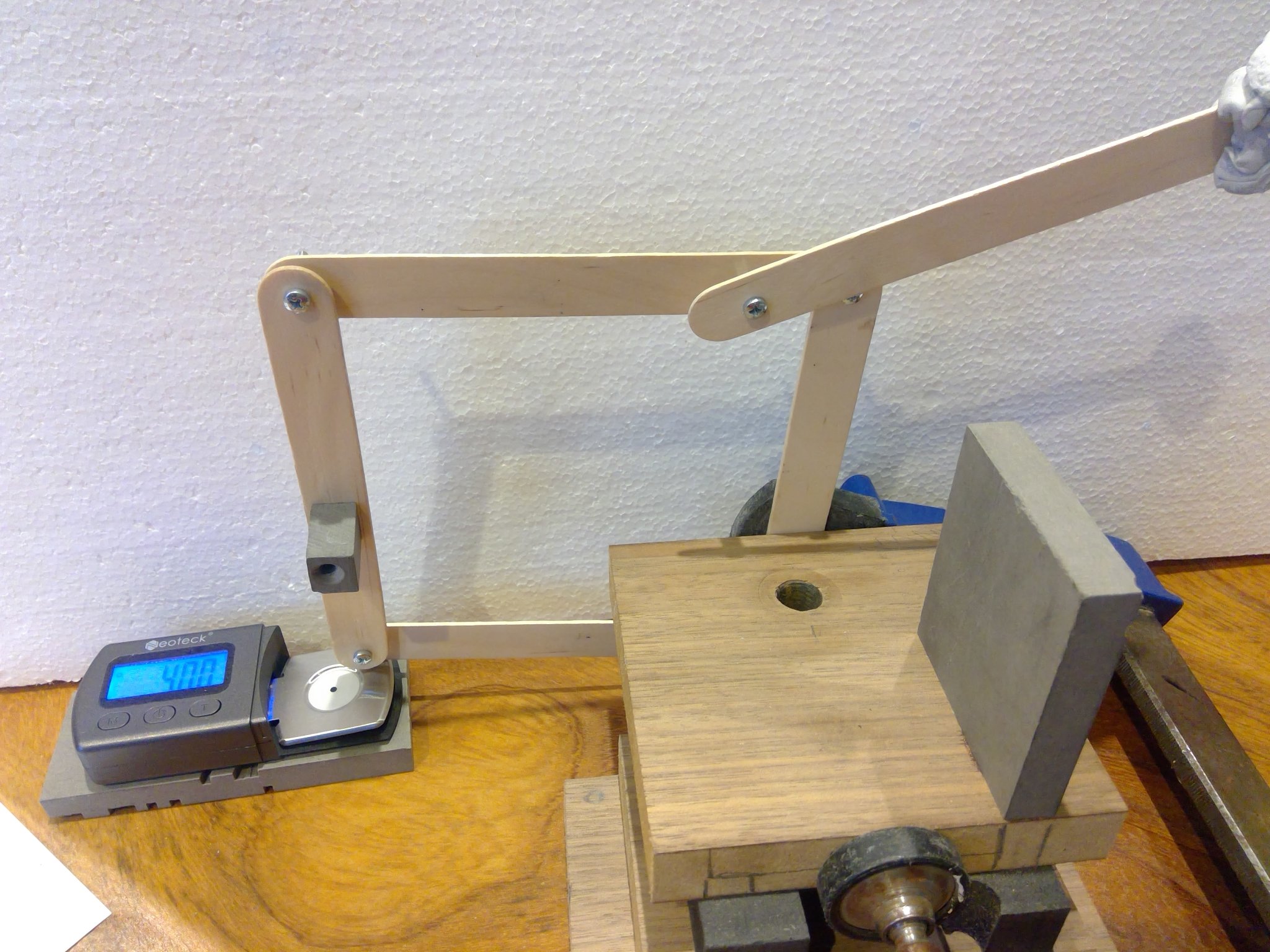

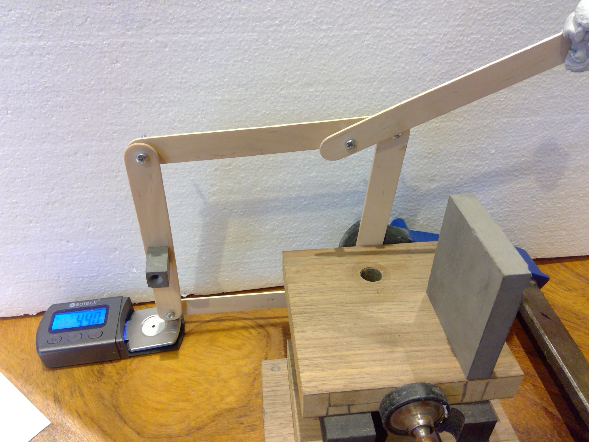

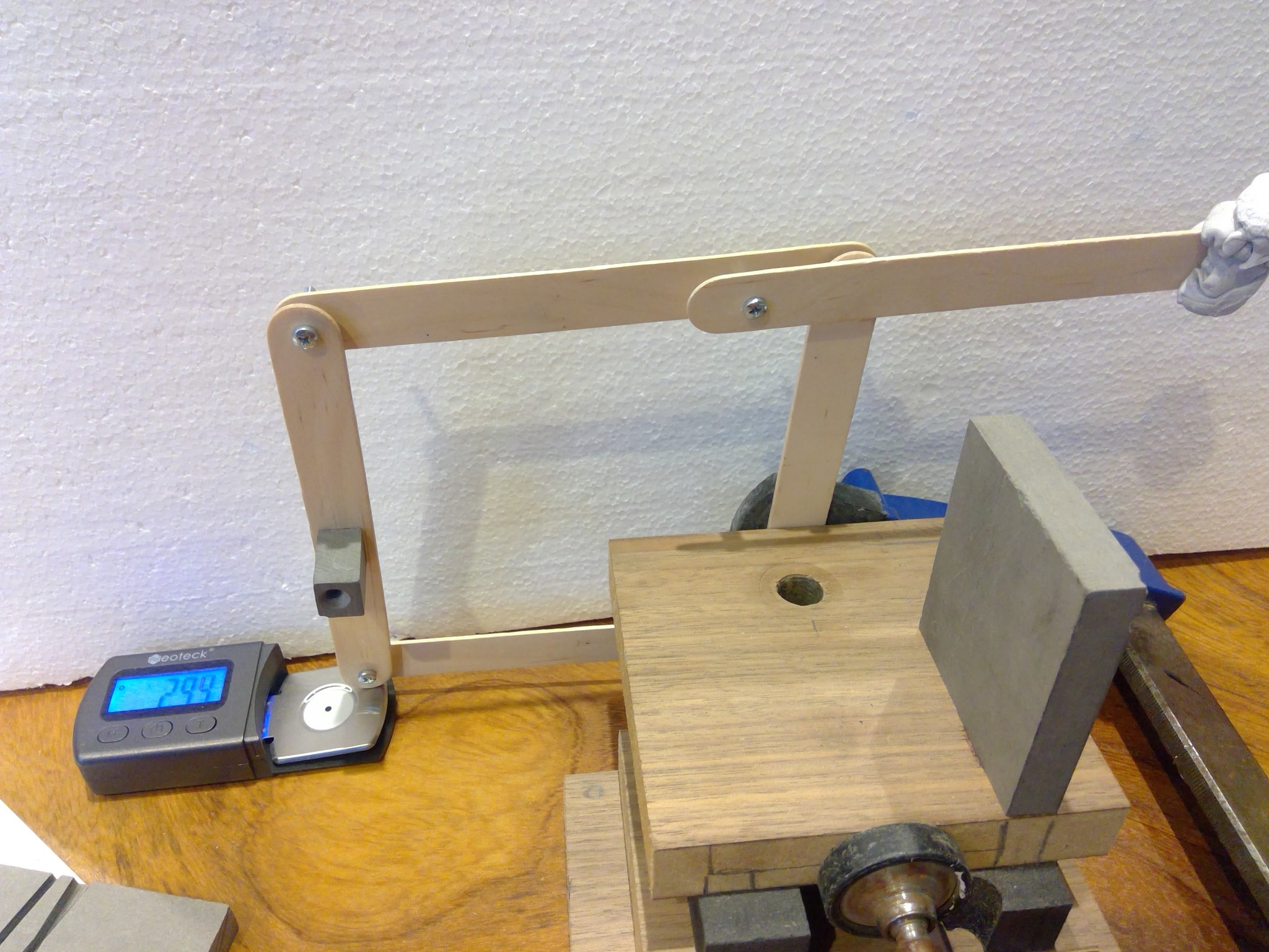

In my arrangement (i believe!) it behaves as shown below by my large scale mock up, and is a result of the lever behaviour on the paralelogram. 10mm warp modelled at around 5 X scale!
What I should have said was;
In warp, with my current construction, as the cartridge rises 5mm the VTF reduces a few tenths. As the cartridge never does that much in real life it may be irrelevant!
However:
Raise the CW lever above horizontal and VTF lowers with rising warp
Lower the CW lever below horizontal and VTF rises with rising warp
Flat lever and it all stays the same………
So I shall aim for the flat lever at some iteration of construction.
Other things may be going on as well, but this is what I am focussing on just now!

What I would aim for is a balanced parallelogram. What I mean is that when it's balanced so it floats there should be NO seesaw affect, the cartridge should stay anywhere it's put in the vertical plane.
This increases stability of the cartridge platform and reduces warp induced shake of the stylus.

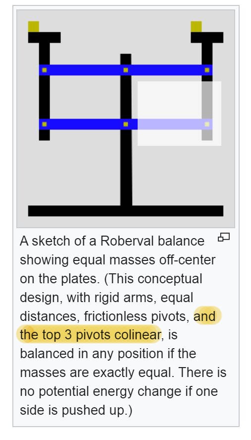

#5309 - great job, Mike: that mockup provides very clear results in a simple and direct way.
It is a topic that has already been partly discussed long ago, starting with #2384 # 3019 mockups, and during all the Lil Casey MK1,2,3 RTA projects - But to spare that trouble I believe that just a look at the usual Wikipedia may be helpful to clear some doubts.
https://en.wikipedia.org/wiki/Roberval_balance + attachment
The main point to note is - and the top 3 points colinear - while removing what is in the white box does not change the situation at all (= letter balance ).
ciao - carlo

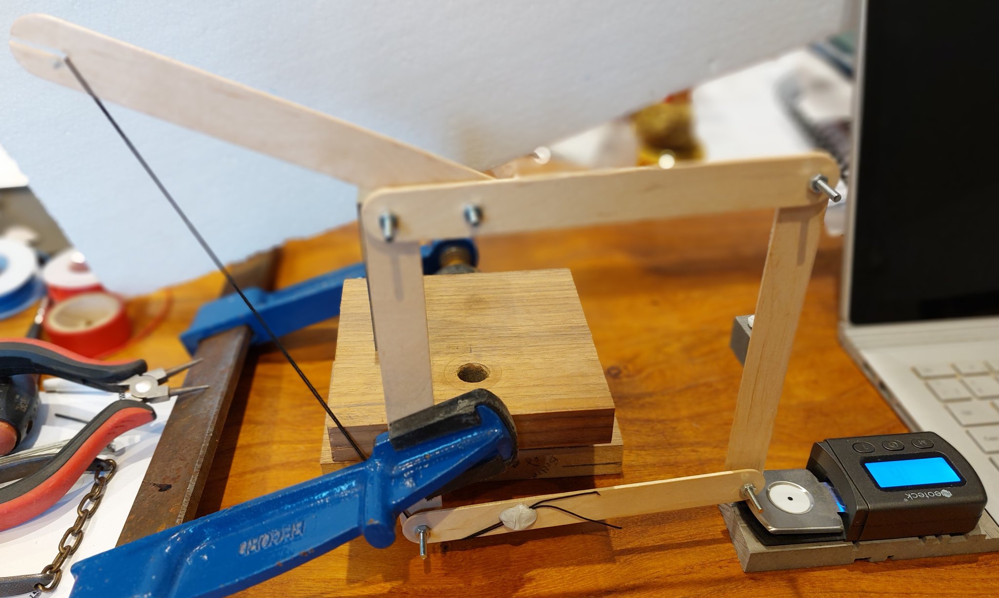

And Carlo, interestingly the changing force from a spring in extension might be used to balance the non linearity of the a non-colinear top line........
Any idea what this old donkey is talking about? - i rarely know myself......!
I will try to set up my mock up to demonstrate!
Here it is in the picture attached, the chord on the left is elastic thread, there is now no CW! - as the stylus rises the spring extension is reduced and so its force but its mechanical advantage on its lever increases and by trial and error i can tell you this device stays within a few hundredths of constant vtf over a 10mm warp height.
Is that of any use to anyone?

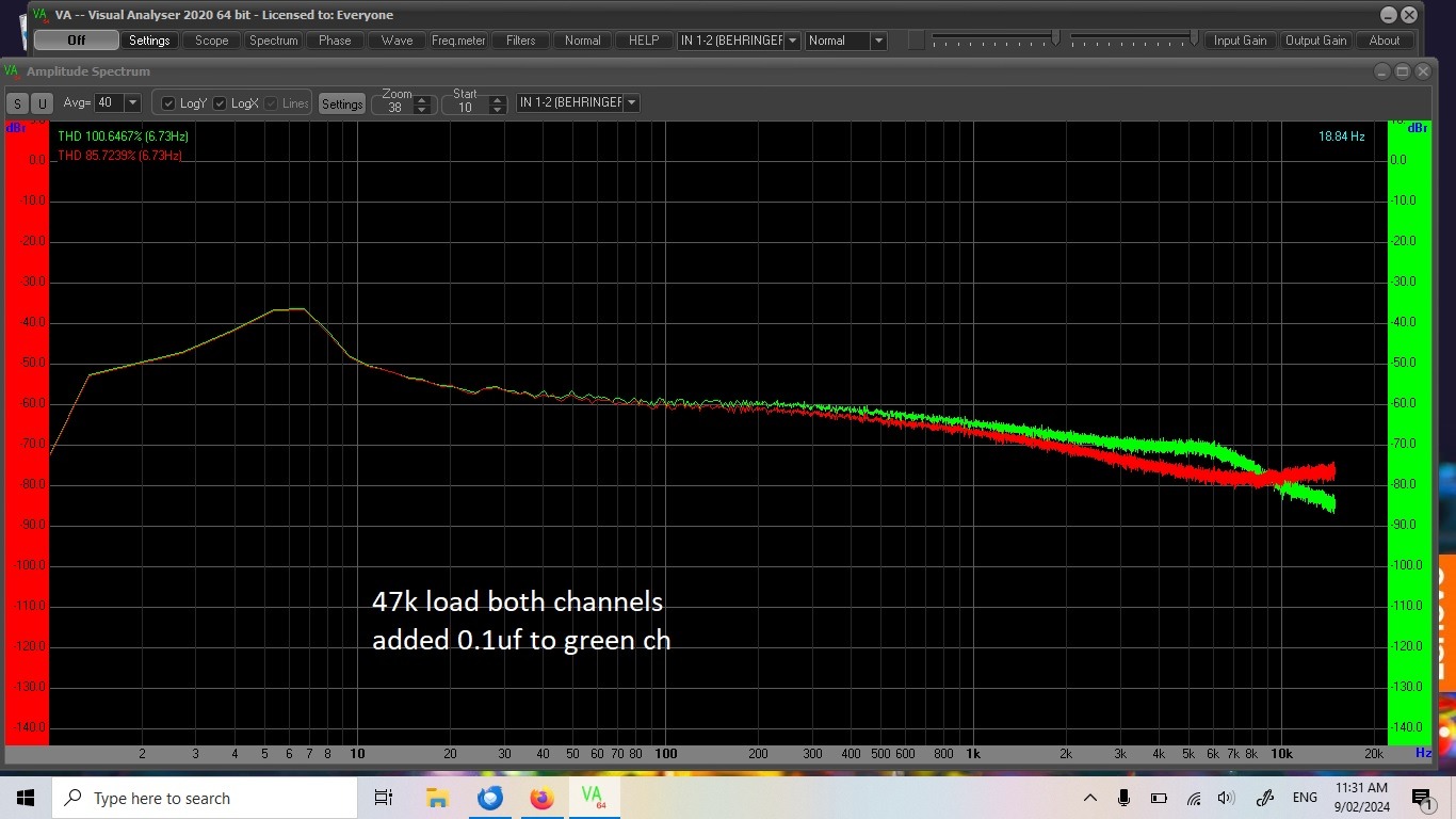

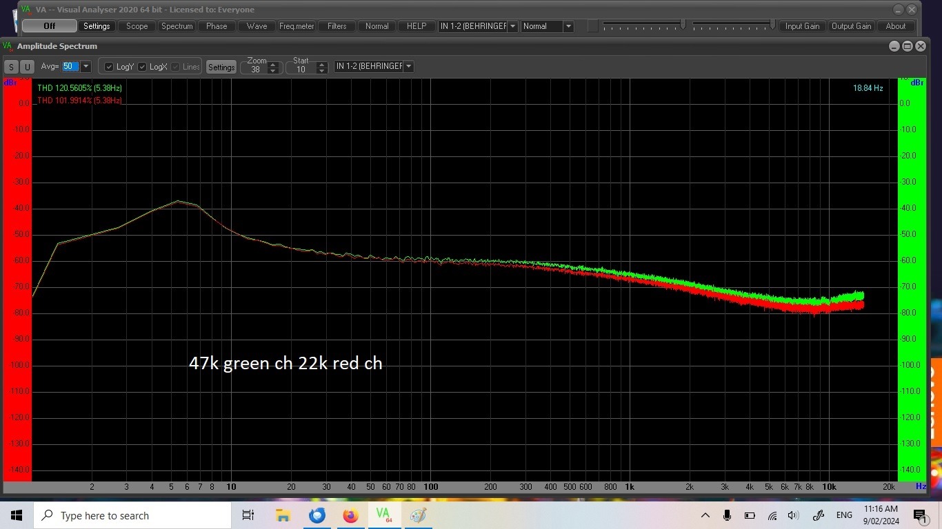

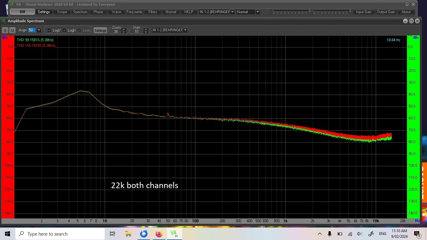

I thought I'd play with cartridge loading and here are a couple of plots of a Grado Opus 3 modified with a Boron CL and Microridge diamond.
This is a plot of pink noise from the Ultimate Analog test LP so the plot is not flat because it's raw with the 3dB/oct fall. You can clearly see the resonant peak in the last plot where I added a 0.1uf cap to that channel and the difference between 22k and 47k loading.
I need to investigate this a little further because it doesn't look like the frequency response is flat.
