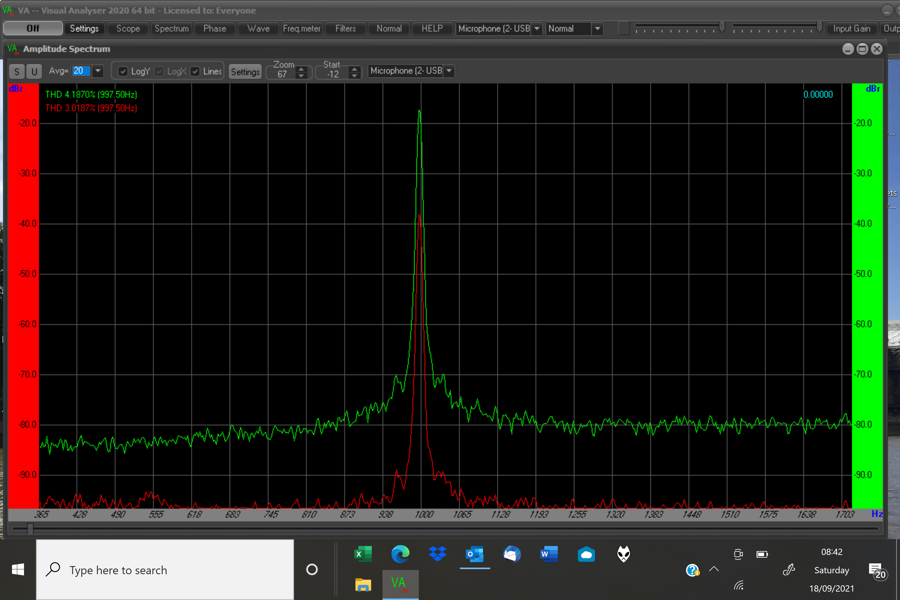

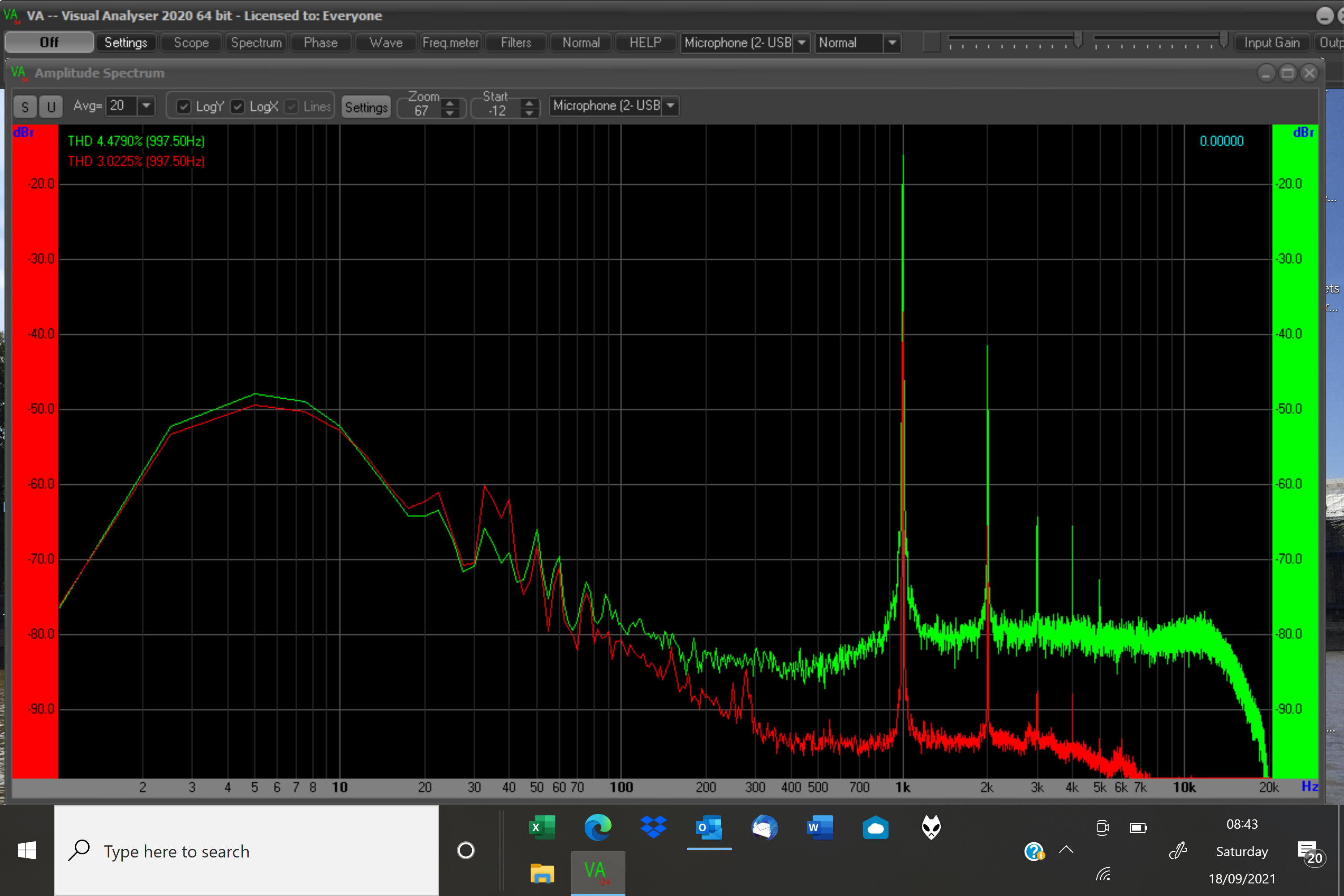

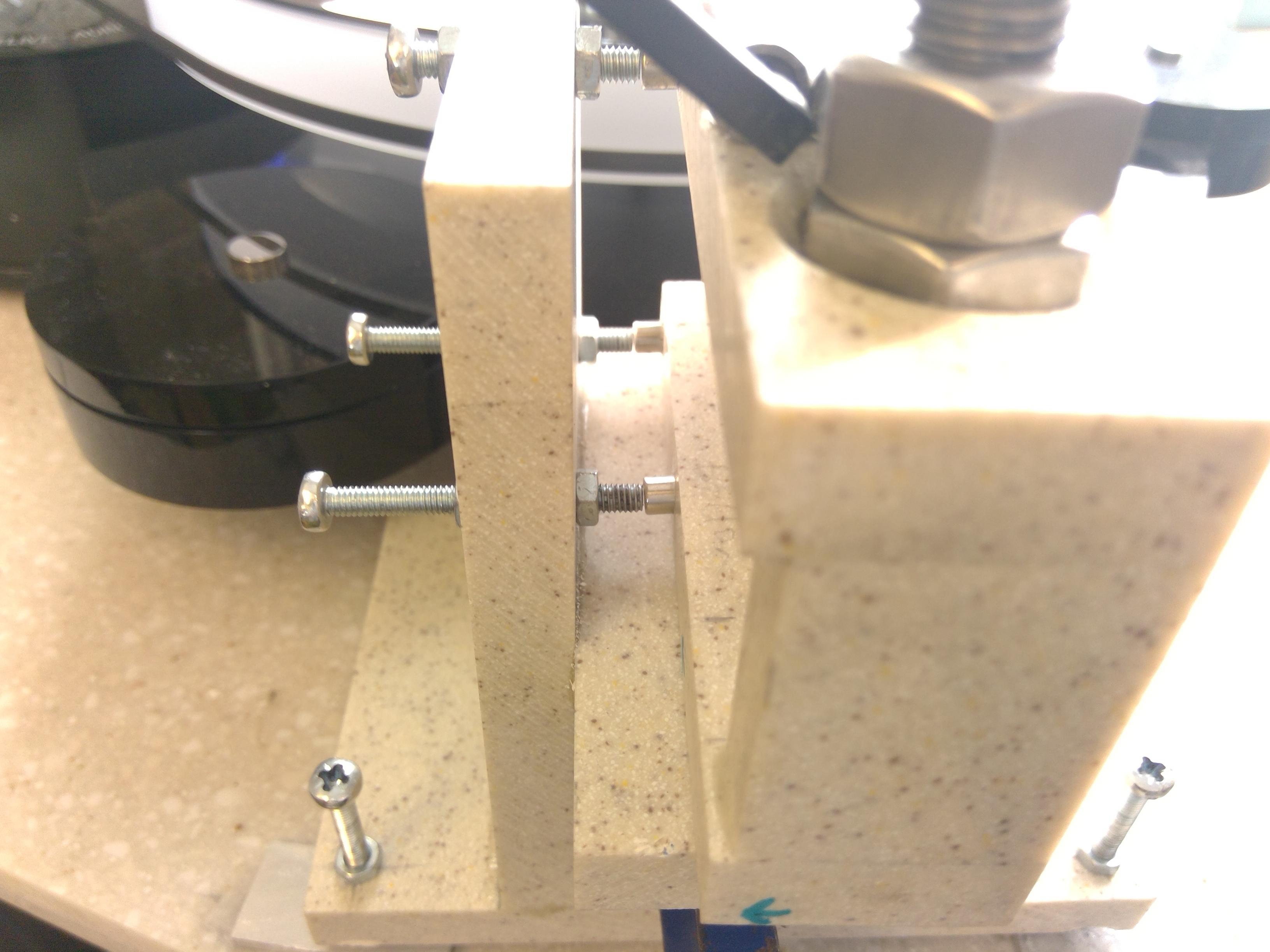

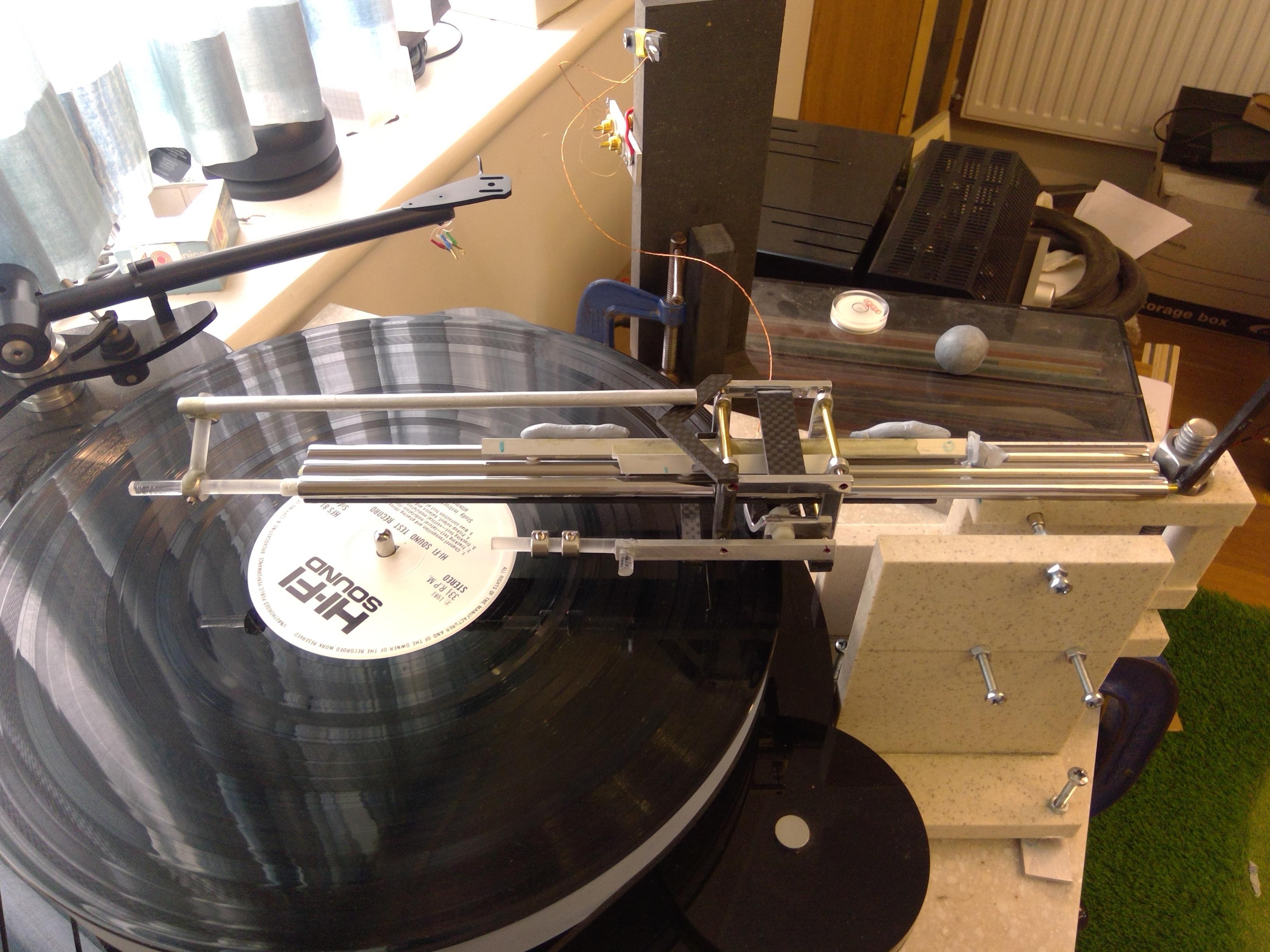

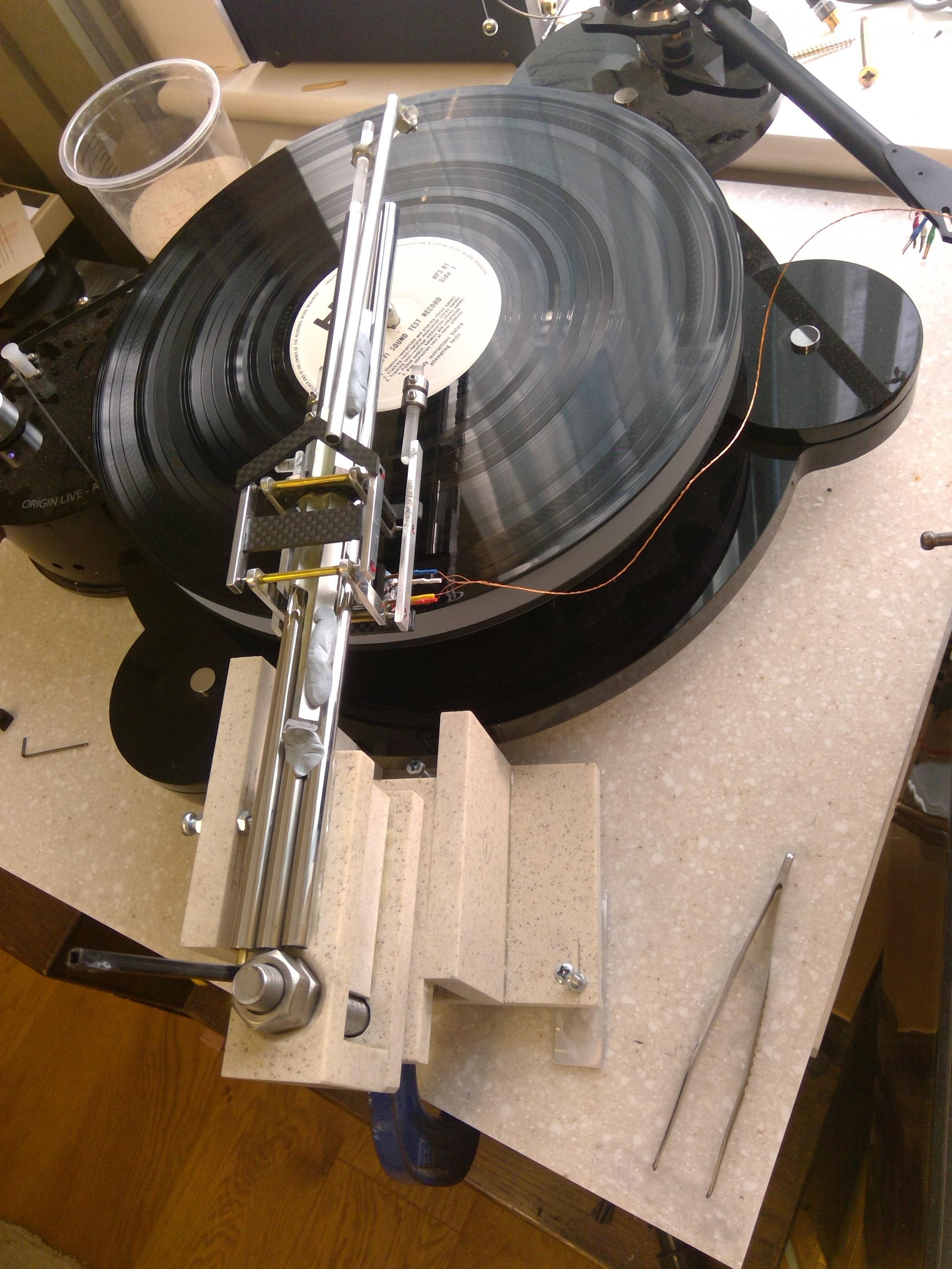

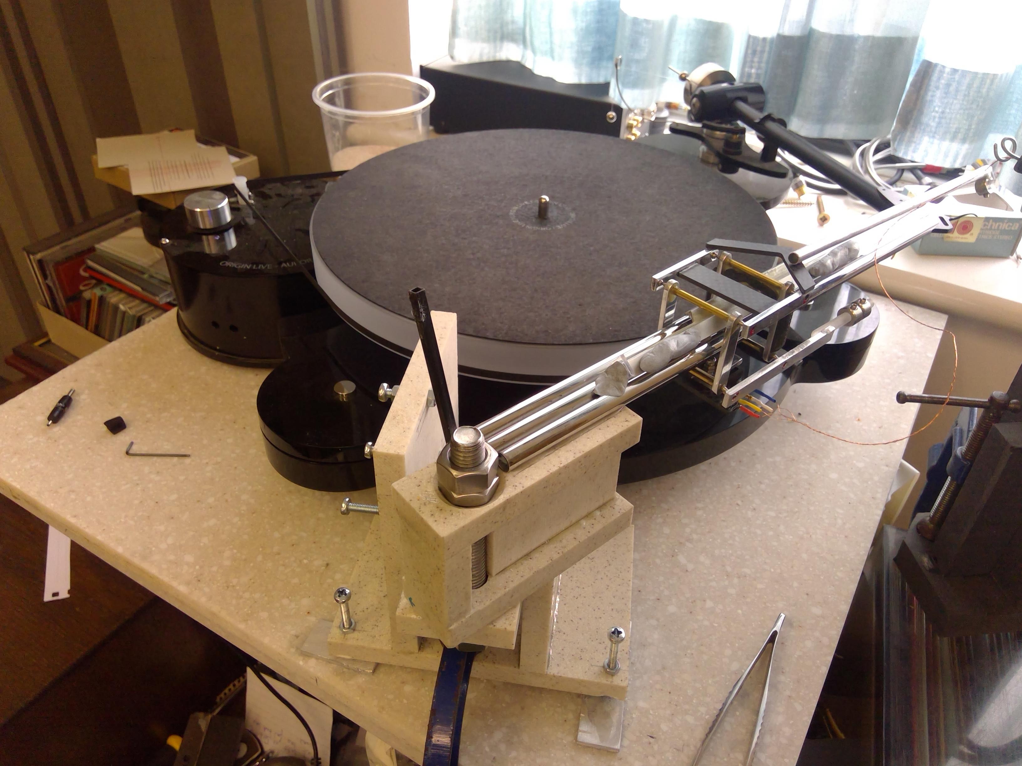

The latest incarnation of my prototype/experimental arm appears in pictures below, now hinges away reliably and lands back on 3 magnets repeatably.
This is an Avonite mount with a 12mm bolt as pivot.
Measured results confirm the best i have achieved with a hinge away mechanism
best,
Mike
best,
Mike
Mike,
Great improvements! How does it sound now?
Jim
Hi Jim, Unfortunately my answers to any questions on sound are less reliable than others because i have not heard any set ups that are reliably quantified as really good and my only comparisons are with my own equipment and set up.
However, lets have a go.
- Many of my LTA experiments give low surface noise, this one included.
- Bass is full, deep, tuneful and precise as opposed to what i feel is over resonant and flabby that some have been.
- High end, cymbals etc open and easily discerned.
- I think the most noticeable thing i find with any improvements i make is when instruments are separated out as opposed to blended in, one can hear the whole but pick out the individual instruments more, a full symphony orchestra is not just a wall of sound, one can hear the individual parts and little intonations in a voice.
- Dynamic range from quiet to loud is significant.
- Enjoyable to listen to, definitely encourages digging out those old discs!
Mike

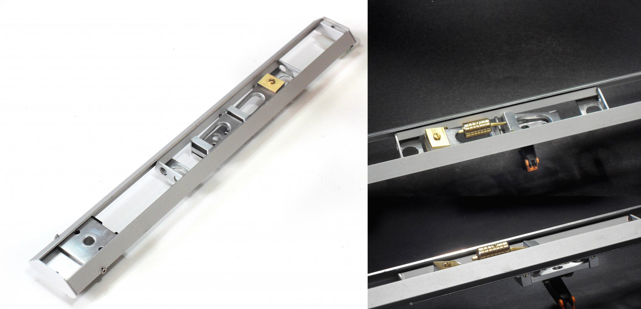

CORKSCREW MK2
Hi all, friends - here again.
Struggling in vain for a decent solution for the MoonTracker (the vertical RTA #4333) I thought back to my corkScrew RTA # 4174 #4219 (starting from # 3762-70 ....... #4084- 4144 - 4150) and it's original sin, which is precisely the central spring blade of the corkscrew joint itself.
Perhaps someone will recall, even from the videos of tracking #4208, that on LPs with small warps the corkScrew performs effortlessly, however my measurement set showed that, over 1.5 mm warp, i.e. beyond the elbow lever effect, the VTF tended to to vary increasingly. Nothing worrying for a correct listening of well stored discs, but from a theoretical point of view, yes. What is inacceptable for me; and others, i know.
The only alternative for a Radial rail TA with true parallel H and V articulation seems therefore just my previous Lil Casey MK 2 - 3 or the new smart moving parallelogram invented by Mike56, now perfected at truly excellent levels, confirmed by incontrovertible measures and signal graphs: but that solution is unfortunately too bulky for present corkScrew structures.
Why not, however, to make a sort 90 ° turn: using the parallelogram the "wrong side", "squeezing" it almost to a flat one seems clearly a desperate fool's solution. However a parallelogram remains a parallelogram at every angle: a rectangle at 90 °, a line at 0 °, but always a parallelogram.
Will it be feasible?
- attachment A simulation
Full of doubts I have made a super quick cardboard mockup, that seemed to work. and made me understand that the horizontal arrangement is a limit condition, better to start from a less uncertain, more stable one.
- attachment B - C simulations
Loads on pentip bearings with angles close to zero may be relevant, so there must be almost no play to maintain parallelism. Fortunately the force is applied from below, but it's behavior must be verified in practice.
There are also problems with miniaturization (levers, pentips seats and tuning screwcups) to use the same previous corkScrew rail and base. Even the distribution of weights would be problematic: for this Mike gave me the clever idea to position one CW moving inside a hole in the first lever. (thanks again, M)
- attachment - drawings
Here are the results for a prototype: small parts require considerable precision and consequent time. Luckily for the cart I had kept the assembly jigs, but the mini parallelogram was really challenging.
The first results seem interesting, and the behavior reliable. My usual set of measures (videos of the crash test - 3mm warp +- 1,5 eccentric; vert + hor friction - VTF variation) will come later. And again no personal listening impressions: i trust mine even less than other's ones
ciao - carlo

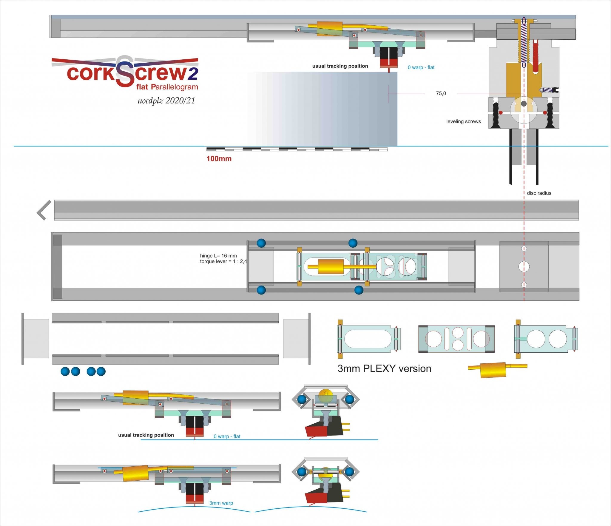

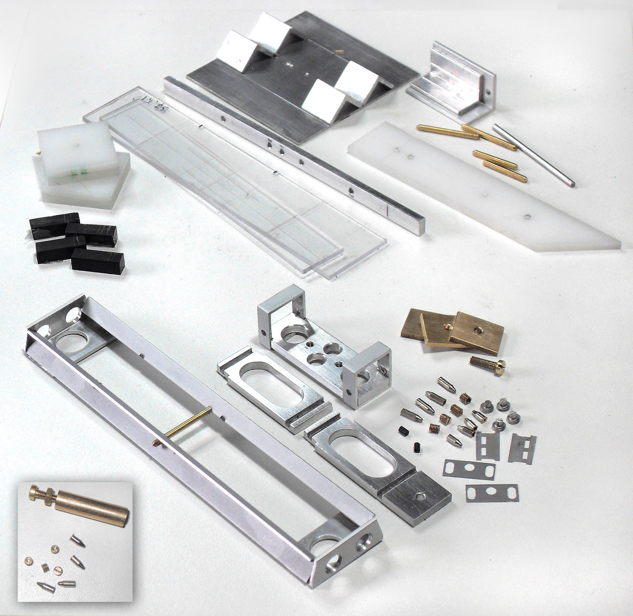

- attachment - photo of parts
- attachment - photo of assemblage
