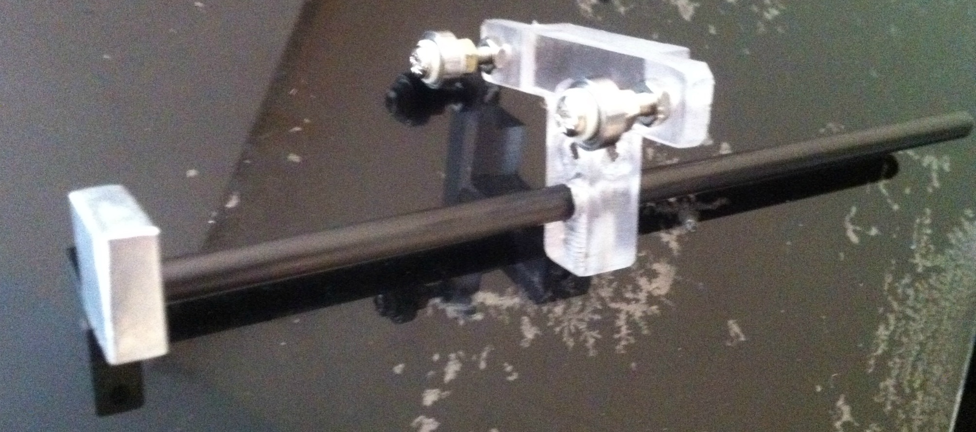

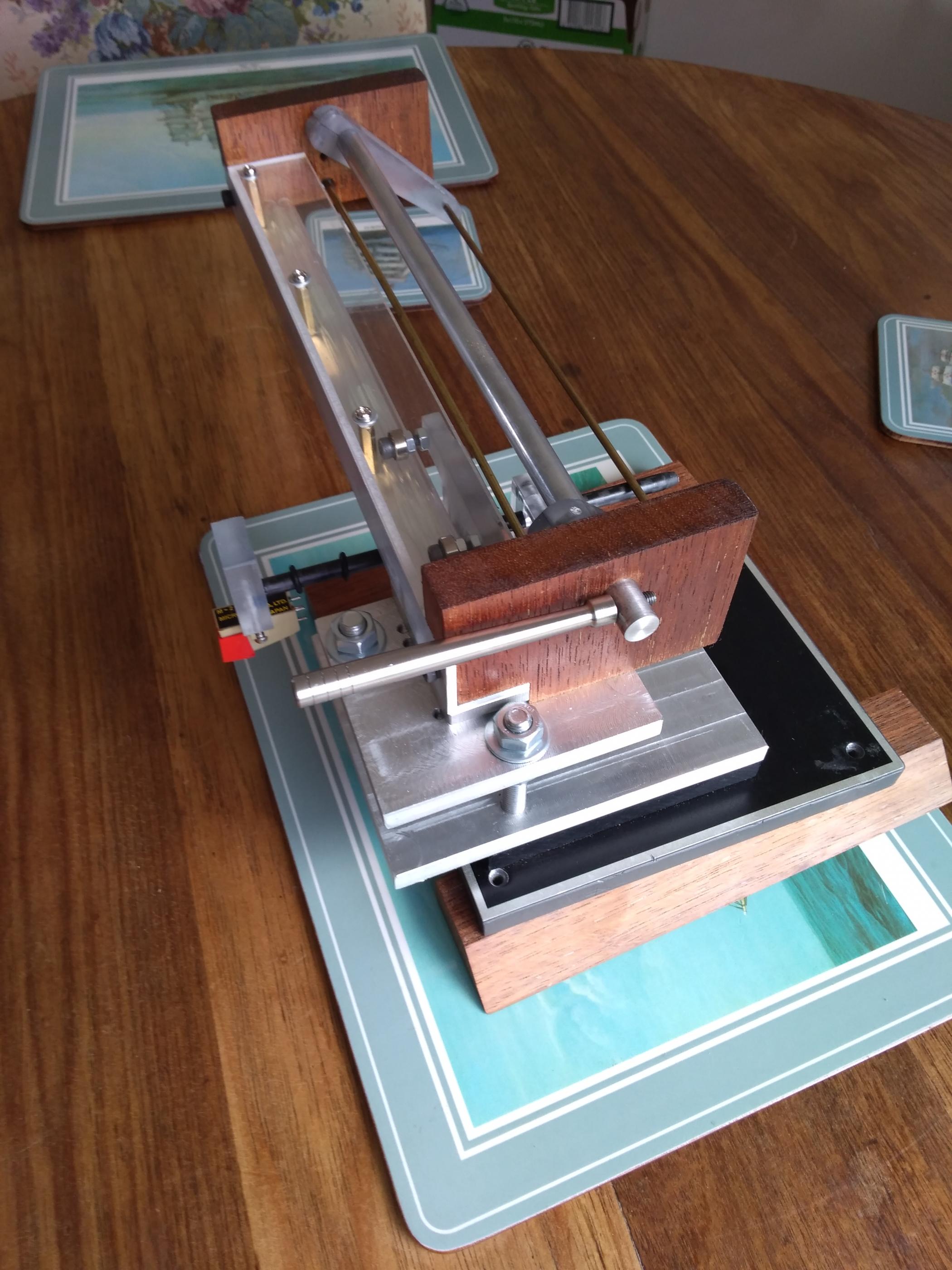

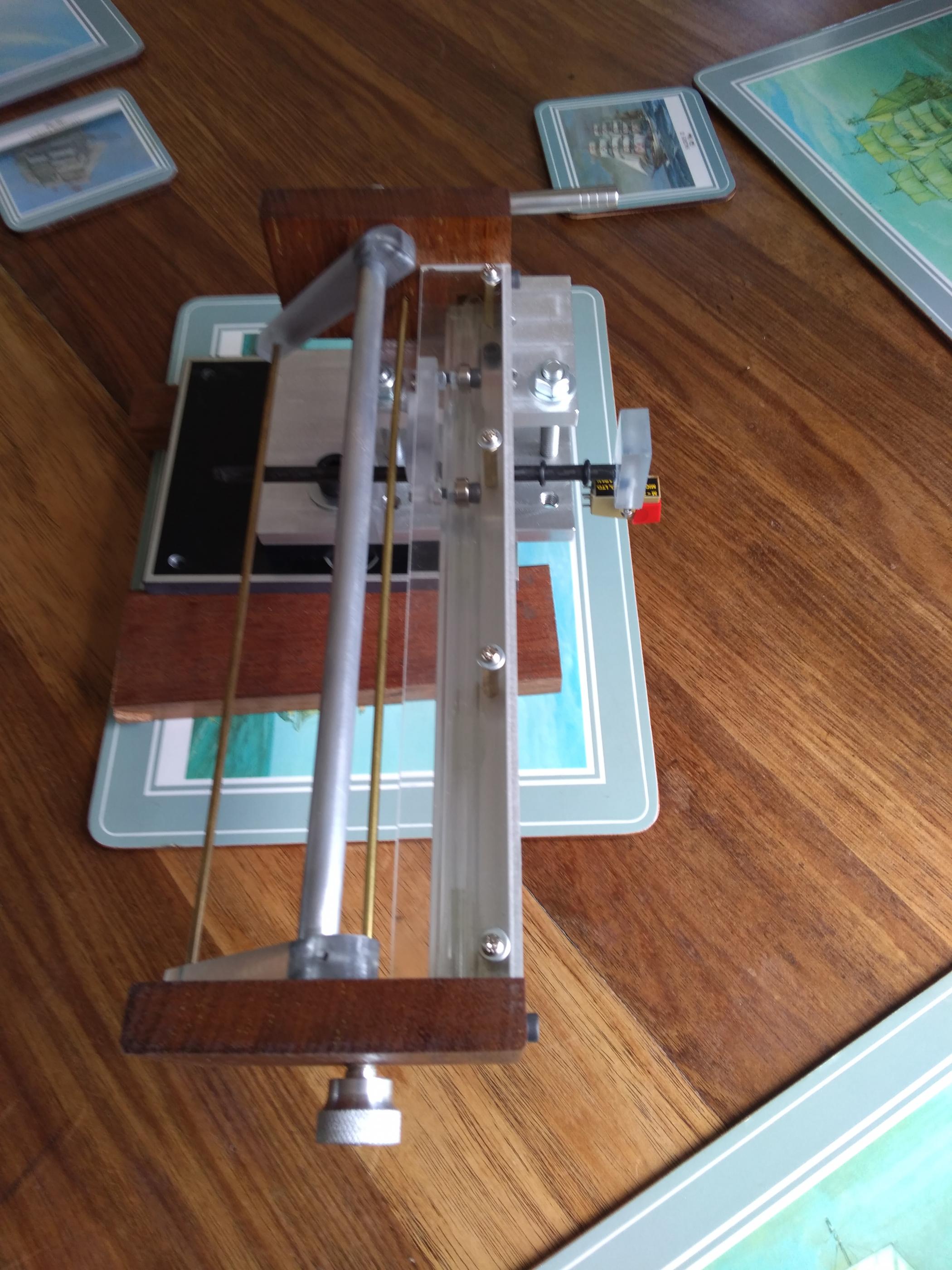

My first LTA was a simple affair, and quite easy to build. This simple arm bettered my Technics EPA100 in bass reproduction with the same cartridge mounted. I was surprised how good an arm made of basically scrap could be.
I don't have drawings of my first arm. I do for my 2nd buy would require access to a lathe and milling machine. These few pics are all I have as I have disassembled the arm now. That lat pic of the arm wand is not mine but mine is the same.
Rail is 25x3mm aluminium angle with 6mm pyres tubes glued with epoxy to inside of the L.
Arm wand is 6mm carbon fibre tube about 120mm long, carriage is 10mm polycarbonate or you could use acrylic, with MR104 bearings, and you will need to clean the grease out of the bearings.
The rail needs to be high enough to change LP's. have the arm wand as close to the underside of the rail as possible so it does not touch. The rail mount I used 3 M8 bolts to enable leveling of the rail. CW was made from an off cut of polycarbonate and secured with an M3 set screw. An M3 set screw was also used to secure the arm wand to the carriage.

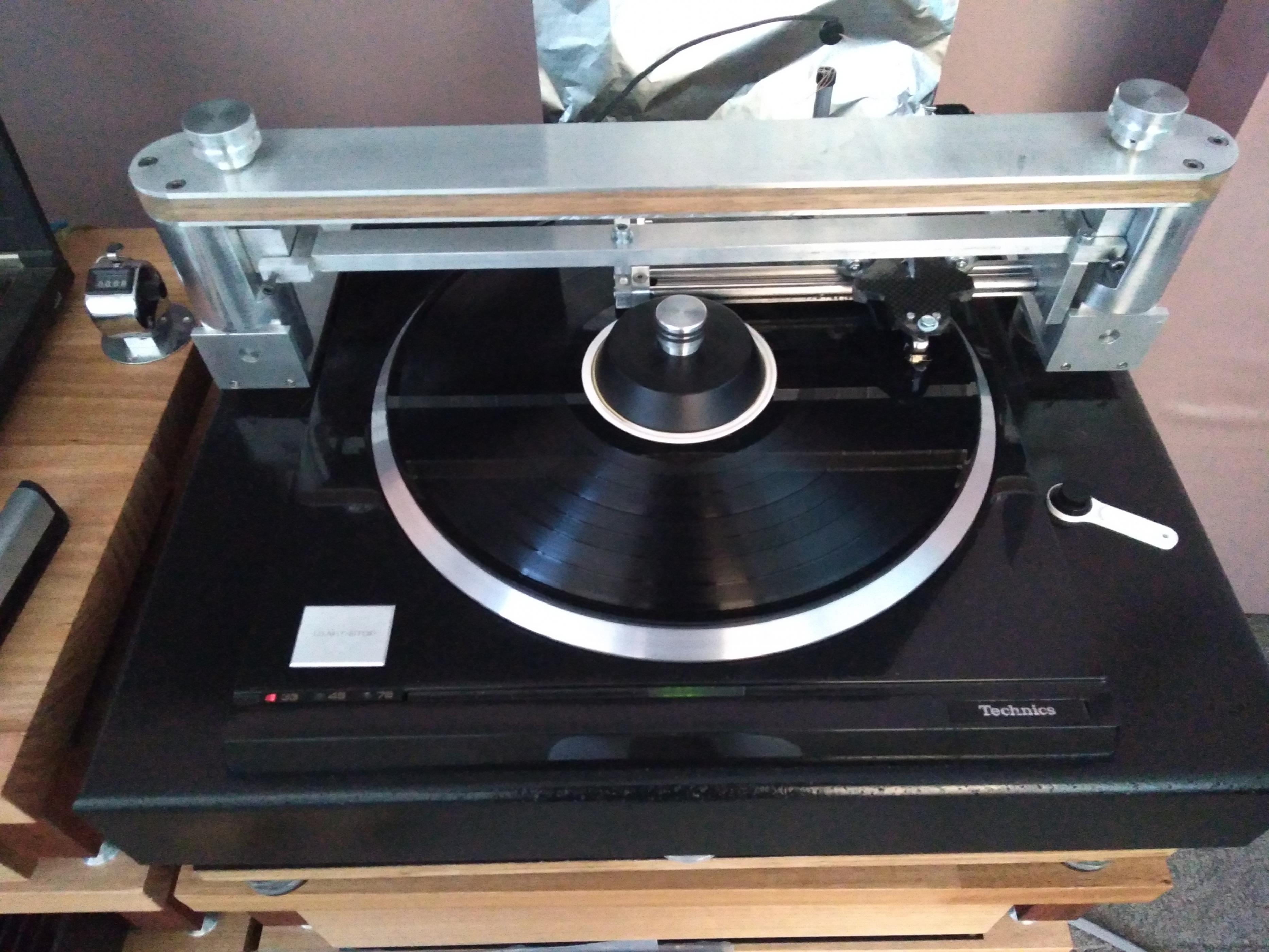

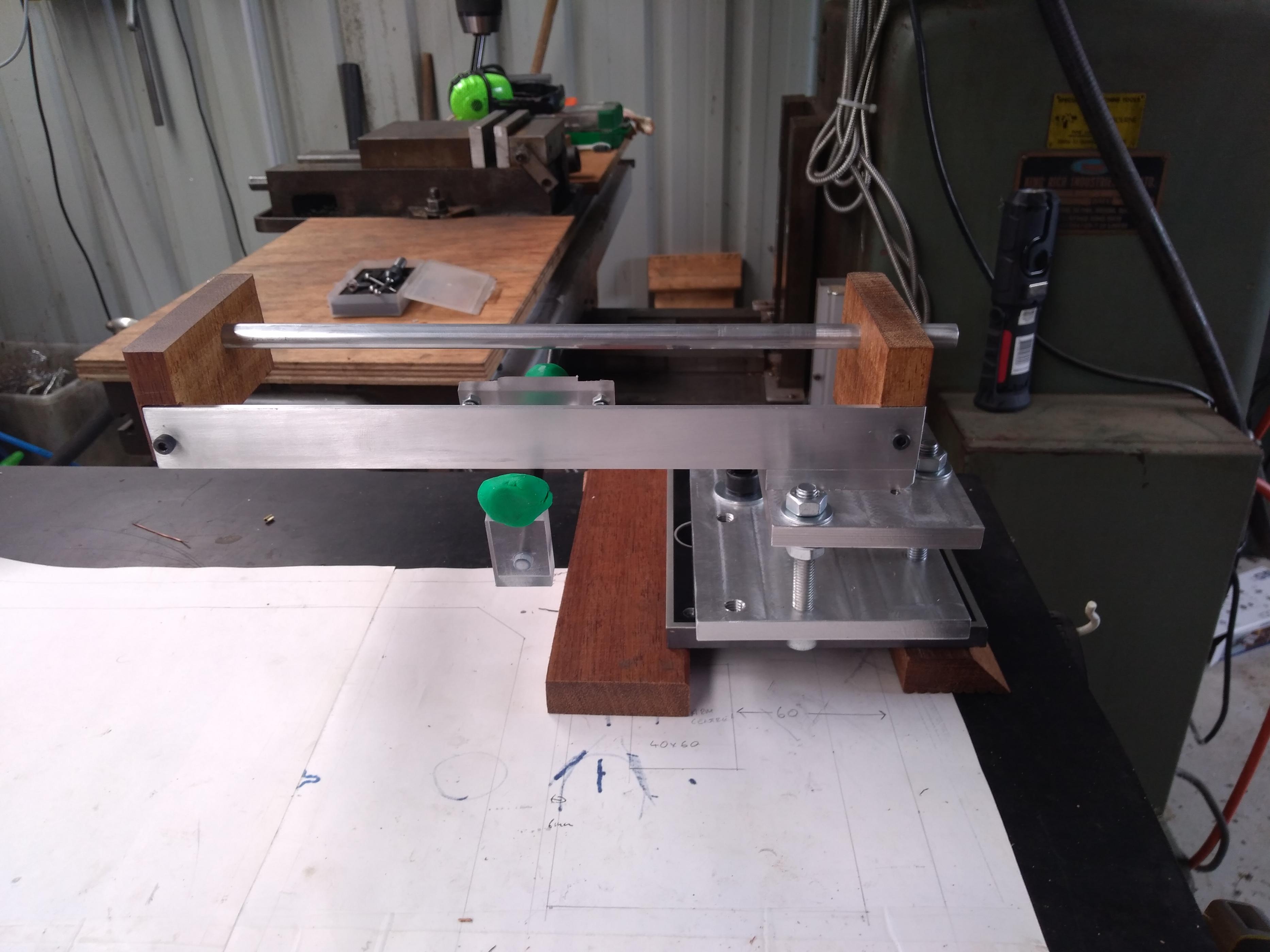

I am using my SP10 with the EPA100 while I rebuild the linear arm on my other SP10.
This is my current LTA.
The LTA will need to be mounted firmly to the plinth so the bearing and arm are held rigid just like a pivoting arm.

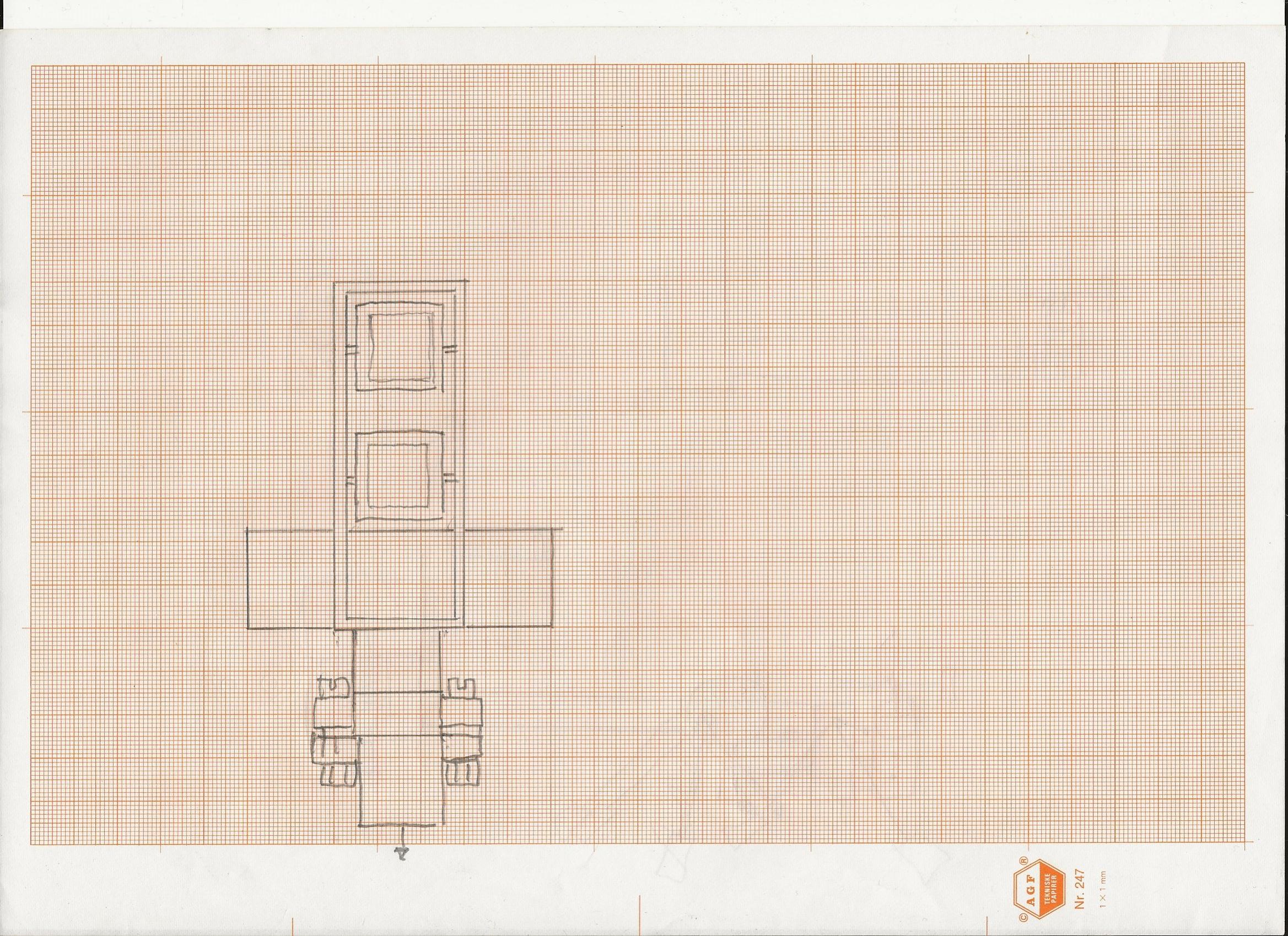

Here are two drawings of the 3-D floating headshell.
Only to show the principle, not to measure.
The linear moving part is shown as a L'il Caisey type, but it could be balls on stel/glas rods or whell on steel rod as well.
The mechanism that caries this over the platter moved by the servo motor, could be hovering over the platter while playing or outside the platter with a very solid arm to carry the 3-D floating headshell.
I have not included in the drawings the position detector, but it could be a hall effect device and a magnet, as in Ralphs arm or a photoelectric detector of some sort.
