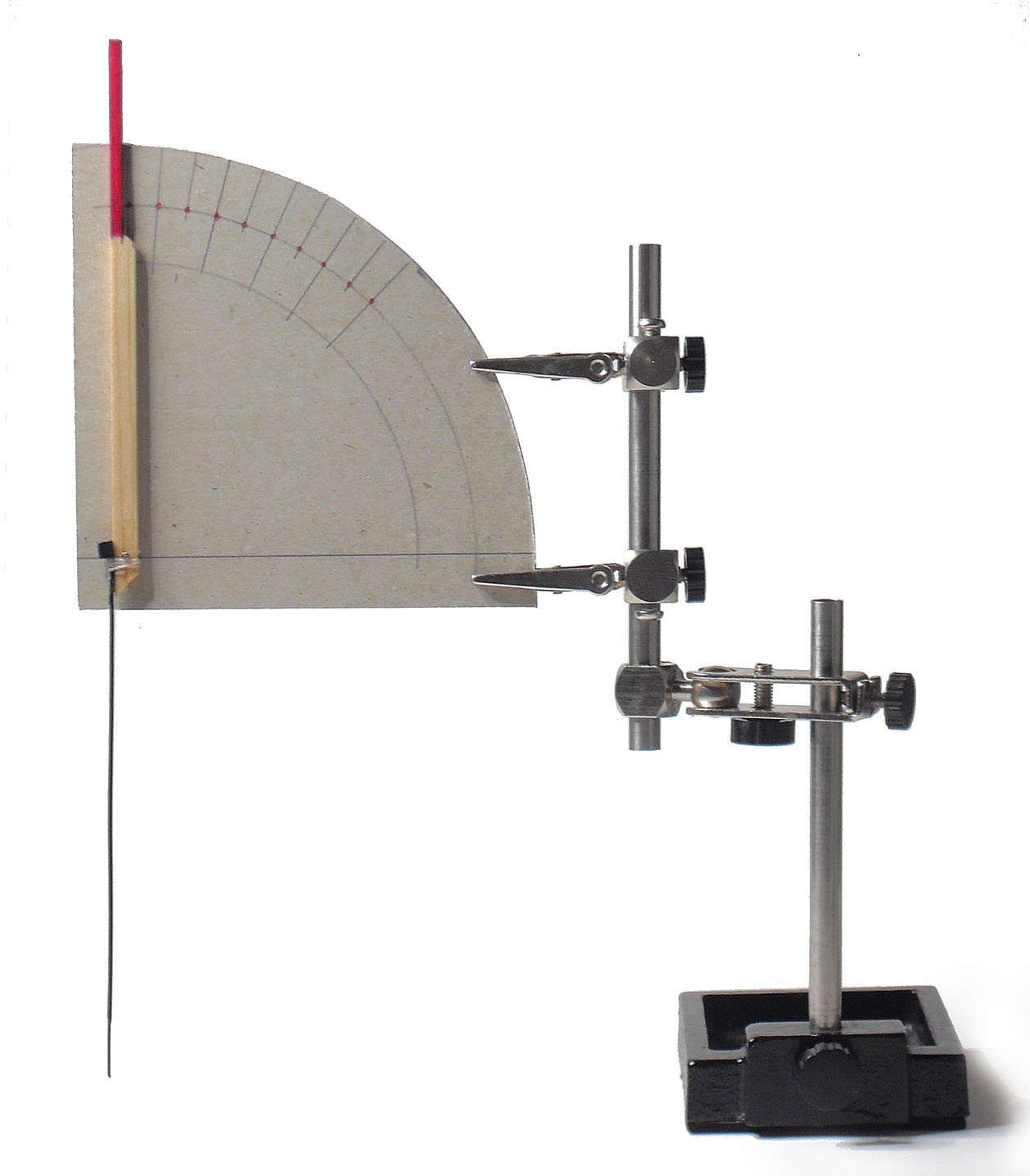

Cat whisker test
Disclaimer -- an extremely trivial test for LT frictions, not even asking for a simple rig like the reverse pendulum, or the rough set for a smartphone video, but unfortunately equally pitiless.
How to
First prepare your LT perfectly leveled, and with VTF = 0, so that the carriage can move at it's best. Now take a small 1x2x125 mm nylon cable tie, grab it vertically at one end and then gently push the other end on the head shell.
-- If the carriage moves almost without apparent bending (<<5°), congratulations, you may leave immediately these stupid toying.
-- if instead the cable tie flexes evidently (>>5°) sorry to inform you that it does with at least 2.0 - 3.0 mN - That cable tie was chosen because - imho- that friction is the maximum tolerable for a decent LT*.
For a better approach, build this "high tech rig" (attachment) and calibrate it on a VTF digital scale. (my test rig data: 5 ° = 2,5 mN -- 10 ° = 5,7 mN -- 15 ° = 9.8 mN -- 20 ° = 12,1 mN -- 25 ° =14,8 mN)
better than nothing - carlo
*to understand what we're dealing with: 200 mg is the weight of a 5x5 cm piece of office paper.
