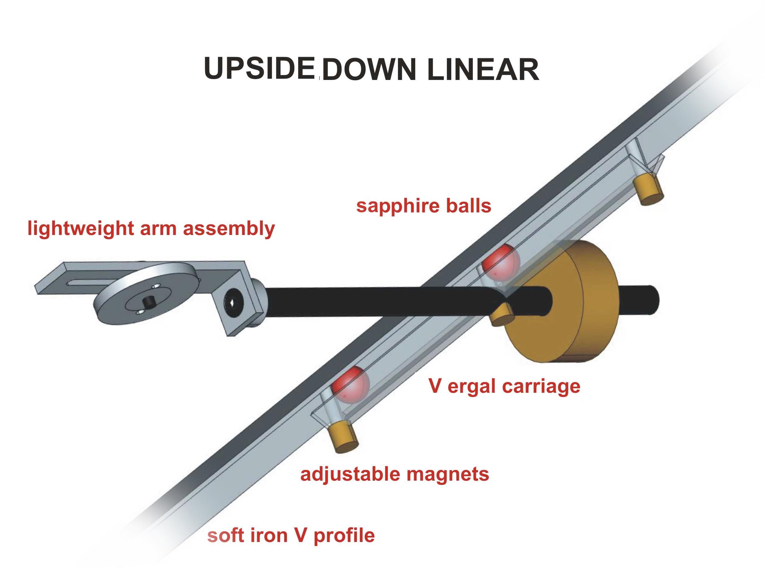

... It only works using magnetic repulsion. (I tried using attraction but this massively overdamped the system and resulted in worse overall friction than without it.)....
Using ball bearings less weight can hinder to win the stiction phase, which is the main problem whit such low speeds.
But attraction may be easier to build: a soft iron (not steel) V profile above and 3 adjustable magnets on a non recirculating balls carriage can achieve a perfectly constant flux along all rail length. We may even think a fully suspended system (upside down: magnetic attraction for mechanical grounding = adjustable negative weight + small carriage mass)

True what you say, even if the case of TTs seems rather different imho: to reduce the bearing noise of super massive platters, and often to get a significant decoupling too.
Anyway the only possible advantages could be:
uniform field: during the travel the magnets attract uniformly the rail (without its own field). An array of magnets can have the necessary uniform flux not to alter the carriage movement?
damping - this time the weight is subtracted from attraction, not added, and the difference may be brought to a minimum.
grounding becomes independent from the effective horizontal mass, and adjustable

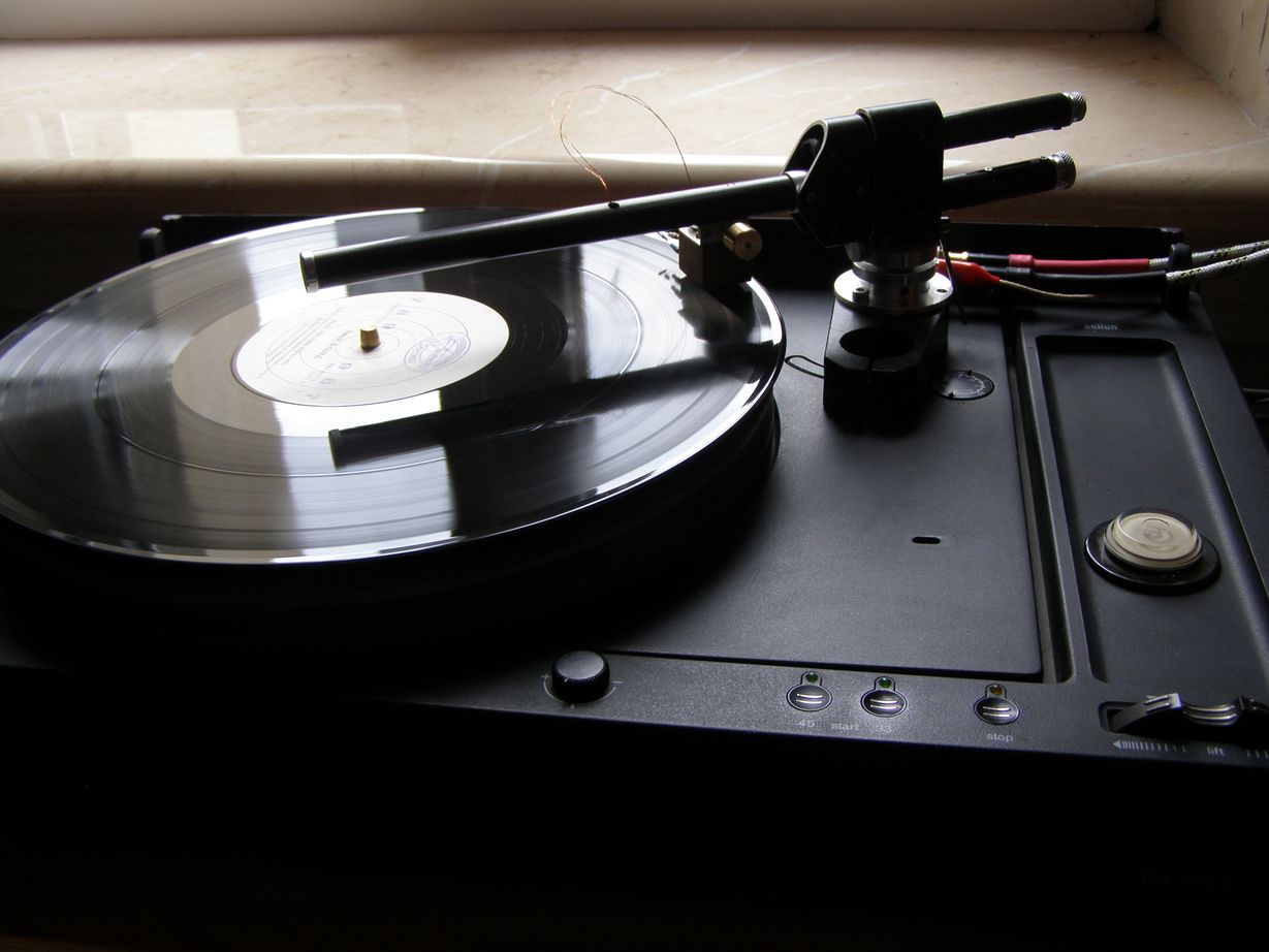

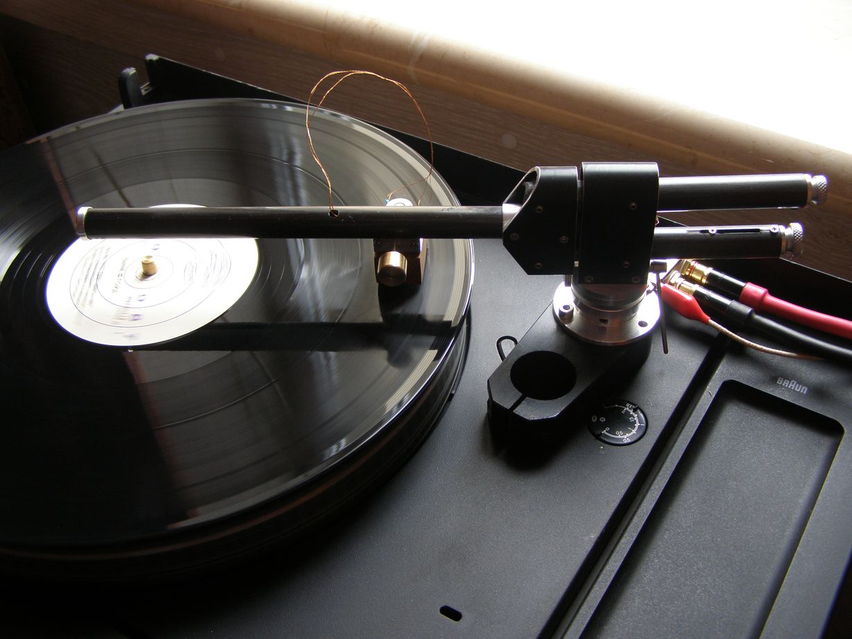

After several listening sessions with expensive MC carts, we tried some decent MMs. Finally I have borrowed the arm to listen it in my own system. After some Kamasutra with installing it on my reserve Braun belt drive turntable (heavily upgraded with 7 kilogramm platter) I tried Ortofon VMS20EO and Empire 888PE carts, and finally coreless MC cartridge of my own design. Surprizingly, Lil Casey sonic performance with high compliance Ortofon was excellent, and with Empire (888 is my favorite among MMs) it was even better. My own MC also sounds better, than on pivot arm (it is a heavy cart with low compliance and 3 gramm tracking weight). My unexpected conclusion: Lil Case works and sounds excellent with high and low compliance carts, and with both MCs and MMs. That is unusual and unexpacted.
Actually, nobody expected to hear VMS20 to perform as close to very expensive MCs, and it is a fact.

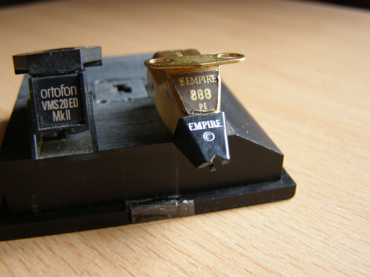

Beautiful version of the Lil Casey carbon - congratulations again E & W. Got some improvement from previous? Have you made some measures for frictions and eff masses? i'm really curios to learn something from-about your experience, plz post further details on building and setting.
Glad to know of your new tests (to hear a new item in our system is the only real way to compare) that confirm mine, and more my intentions (to design a linear for high compliance carts too).
I've tested with some aged mm - stanton - at - shure - and the dl103 on my setup (octal pre + 300b SE+ FE208 E sigma in it's BLH enclosure = not tubey at all, really sharp) and their individual personality was clearly evidenced. So now i'm tempted to buy an AT 120e to see how it tracks with 1,0 Vtf - 35 static compliance.
carlo
hope you'll have appreciated that it does'nt almost suffer the cables syndrome, the infamous linear nightmare, without ever skipping.
Much more than the sound, these are the real diyer satisfactions....
carlo

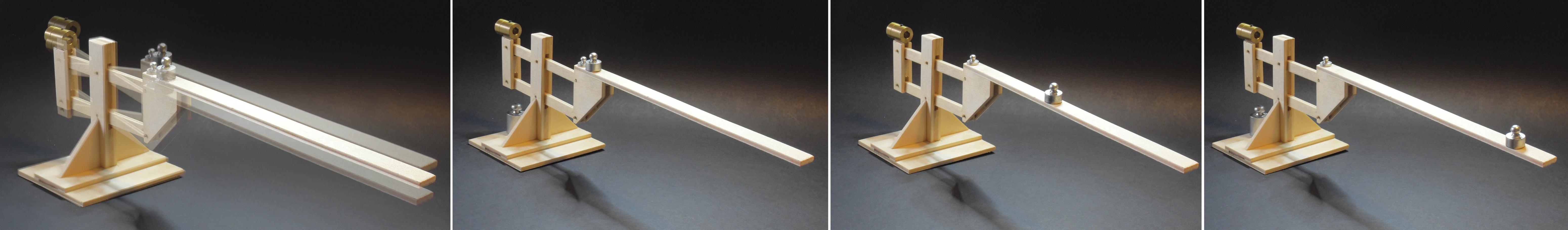

Walter, what you say (tracking on warps) is precisely why the carbon version was made: the first version tracked very well on eccentricities, but badly on steep warps. The second is oK; the lighter the better: a vert. mass near as possible to the horizontal one is the key to.
If you still have problems work carefully on the weight, removing all the possible material, and on the bearings: the pentips work well, but due the rail length must be tightened to get no play, jewels would be better for sure - 8 ball bearings are too many, 4 would be enough. Meanwhile remove all the lubrication.

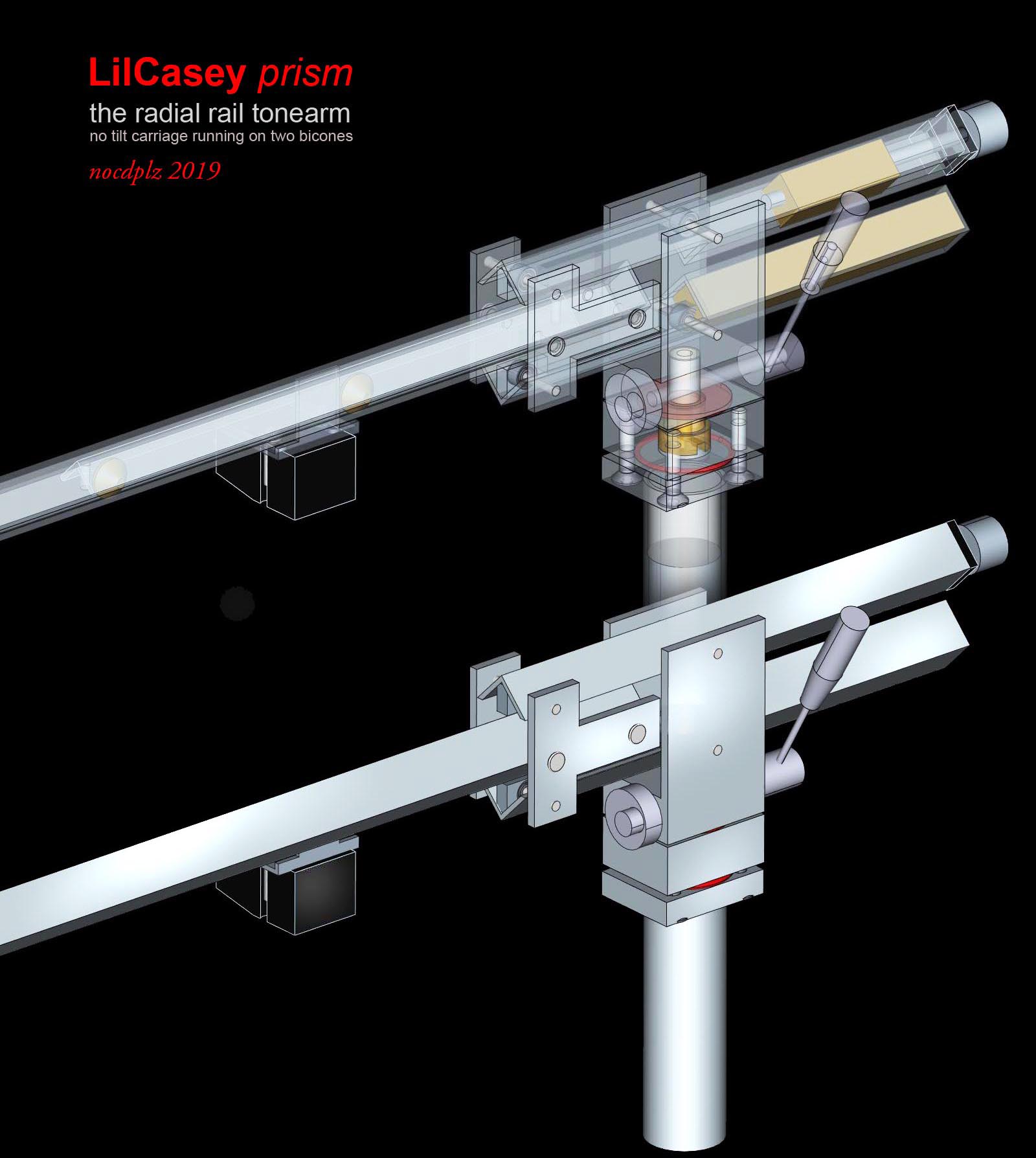

Now I'm working on the last problem, the carriage tilt: once the mini CW is set it doesn't give problems, but if it weren't at all would be even better, and the sound could also gain in focusing.
This solution (attachment) with the carriage on bicones (#2952) could maybe work, but I won't get my hands on it without having a 10x10 carbon profile, otherwise instead of going further it would go back
ciao - carlo
ciao - carlo

Carriage tilting: as I said on a post the dynamic setting must be meticulous (that is, boring), but once in place I had no more problems. As said, for steadier results align the half of the cantilever to the rail center and adjust the rail with respect to the spindle to avoid any overhang.

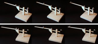

variable VTF
Hi, Carlo. I'm pretty sure that problem is in Roberval balance, and not in leveling or friction. If we compare Lil Casey with wooden model (which has true Roberval balance, and so the balance can not be changed by shifting counterweight, nor by shifting another weight), we may see that right half of Lil Casey is the same, but the left half is mechanically different (it has no vertical bar connected to both horizontal ones), and so it isn't true parallelogramm, despite it looks very similar to it. That is the reason, why we may balance Lil Casey by shifting its counterweight, but from the other hand it causes said problem while cartridge travels horizontally. If we change configuration back to Roberval, VTF will be constant all the way. However, it will require another method to counterbalance the arm. Not a big problem.
Walter, what you say is interesting but in my opinion not correct: at least not for the variation of the VTF during tracing.

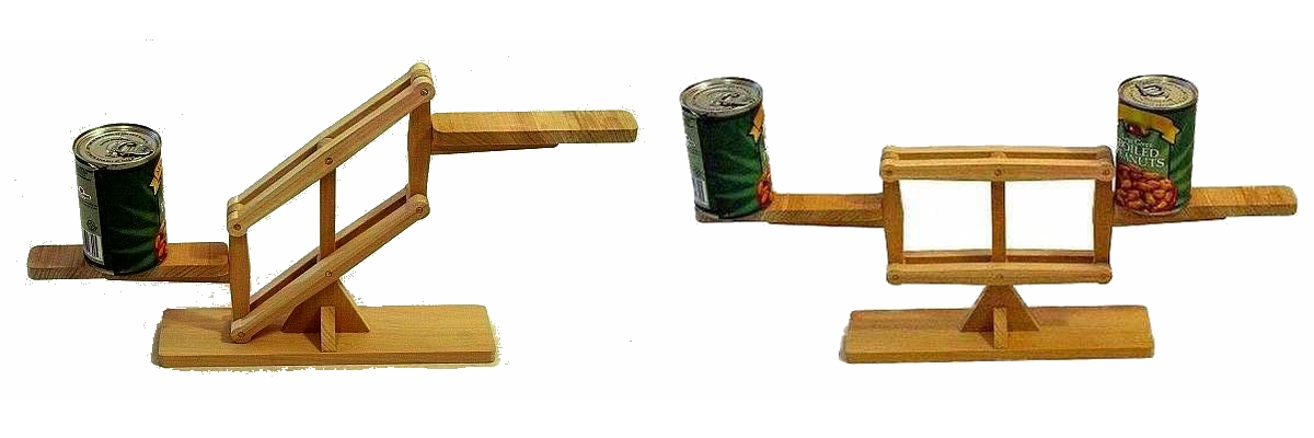

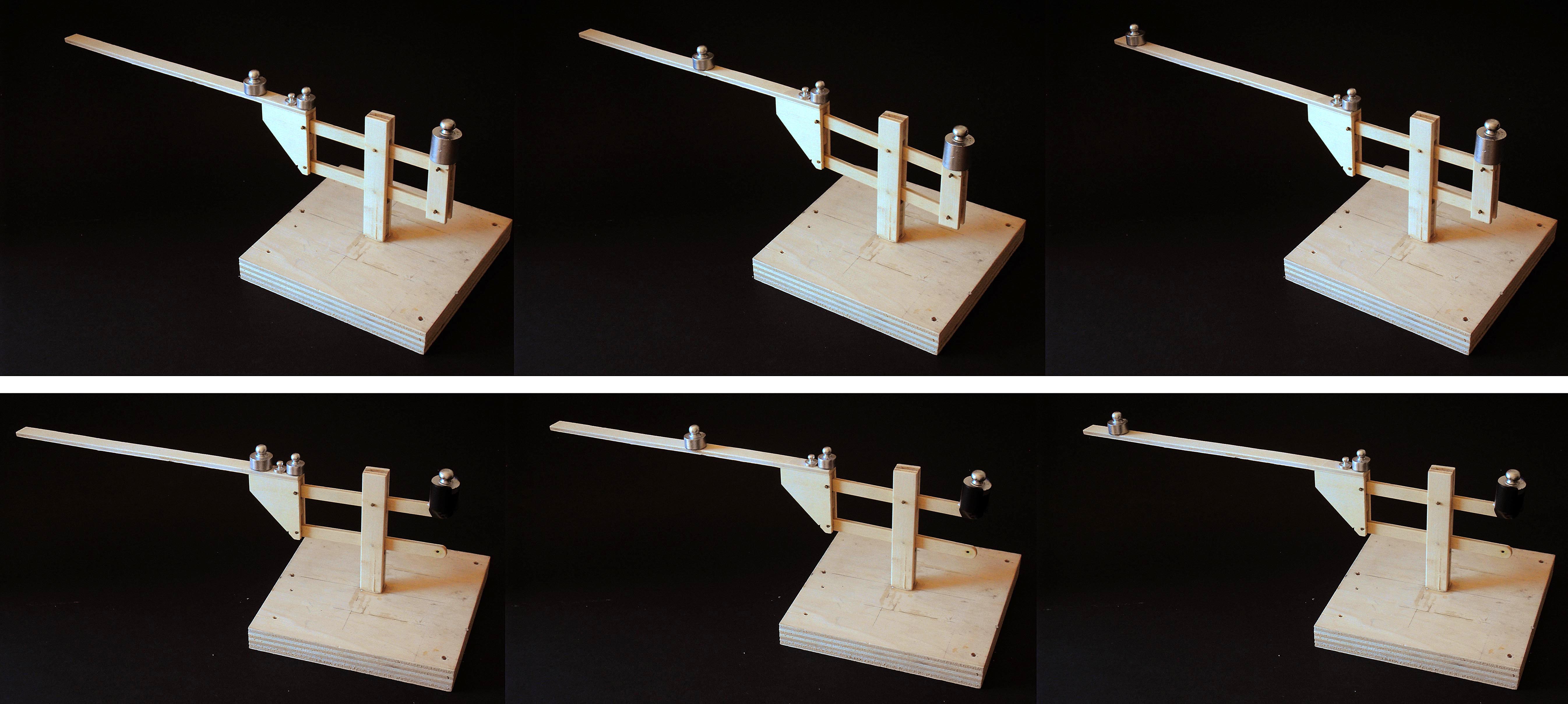

Let's go back to the beginning:
A - we have a rail along which travels the carriage, then a moving center of gravity: a parallelogram scale is insensitive to the shifting of weights on the plates. That's the reason why I used it.
B - On the other "plate" we have instead a fixed Cw, so there is no need for the parallegram. That's the reason why I abolished it (together with its 2 or 4 bearings).
That half behaves like a normal pivoted one: the inclination causes a very slight approach to the fulcrum of the CW center of gravity, with variations of the recall quite negligible for the angles found due to warps or disks of different thicknesses. Using long levers I would have less inclination and therefore less variations, but also a greater weight of the mobile masses, which instead has very harmful effects.
On a leveled rail (constant distance from the disk) during the tracing the carriage slides without weight variations seen from the scale, so the parallelogram remains completely still, as you can see by moving the carriage not touching the disk sirface.
Without inclinations of the parallelogram there can be no variations of the recall of the CW, and therefore of the VTF.
On a slanted rail (variable distance from the disk) the carriage lifts from the rail, increasing his VTF with the part of his weight no more supported by the rail: an ideal parallelogram should restore the distance immediately, but a real one has some stiction that brakes the action: the variations of VTF found on mine are strangely similar to the 200 mg stiction I had previously measured.
In reality I believe that, since perfect discs do not exist, everything moves continuously and acts in a friction regime that is much more favorable, with VTF variations similar to the great majority of TA.
carlo
hoping I was able to explain this in english

I found it (in pieces) for these new photos (attachment): hope convincing - but do the same test with your arm, which is much more accurate.
Briefly it behaves like a hybrid steelyard, on one side there is a plate on which you can move the center of gravity without changing the weight seen by the scale, on the other a rod with a fixed (adjustable)weight to balance it.
Carlo, I've measured VTF with digital scale on an immovable record, I was really surprised to see VTF variations on different diameters.
That's what I did too, finding myself surprising VTF differences. #3015**
But then I adjusted the rail leveling micrometrically, while checking the variations on the digital scale, finally getting a uniform VTF (only 3-4 mg of difference) over the entire carriage displacement. It's now clear that with the level you cannot make a fairly accurate set up. I advise you to do the same.
I believe that by working together (all those willing to try a radial rail) we can bring the Lil Casey to be an everyday tonearm, compact, easy and comfortable to use, and probably better than many others.
carlo
** after those measures do you understand why I don't take particular account of listening tests? I've never heard an audiophile say: "My left channel sounds worse than the right one ..." Although it's practically impossible to get them sounding the same
Walter
Nor do I ! - after having posted the first hypothesis of the parallelogram #2384, I finally found the solution #2435 only after spending a lot of time playing with the mock up.
carlo
Hi Walter, Carlo,
You'll notice in Walters picture of the Roberval balance #3016 that when the load on the two sides is equal the balance is level and when the load is different it isn't. It would seem to follow that if the two sides are made to be at different levels, varying height due to warps, then the load will be different. This could explain why you are getting a variation in tracking force with VTA. I know that the lil casey isn't a true Roberval balance but as long as the counterweight stub is roughly horizontal and the pivot is at the same level as the center of mass of the weight it should operate as if it was.
Niffy
Niffy
