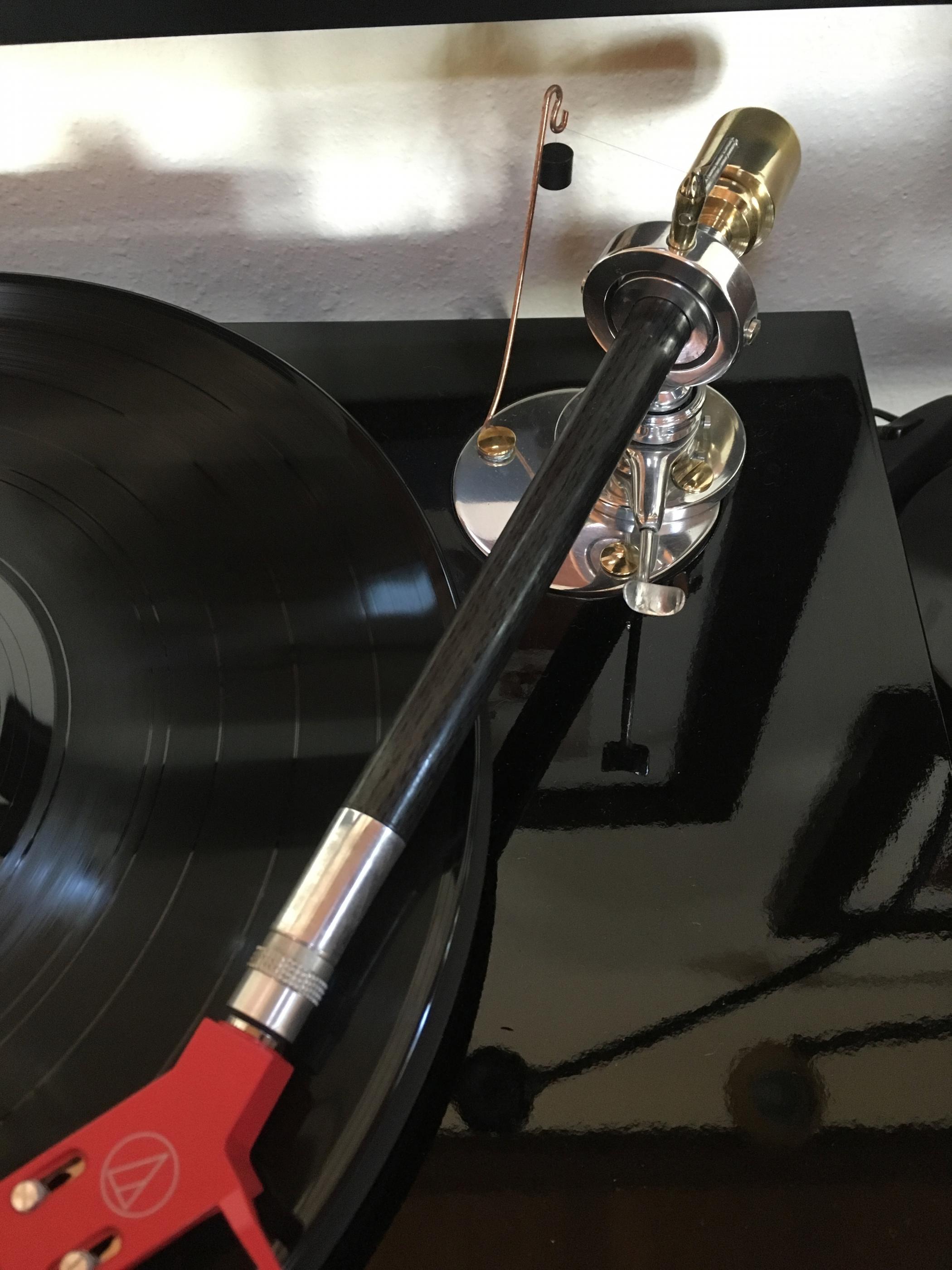

Carbon fiber tonearm made from golf club shaft. SME 3009 main bearing, effective mass 17grams

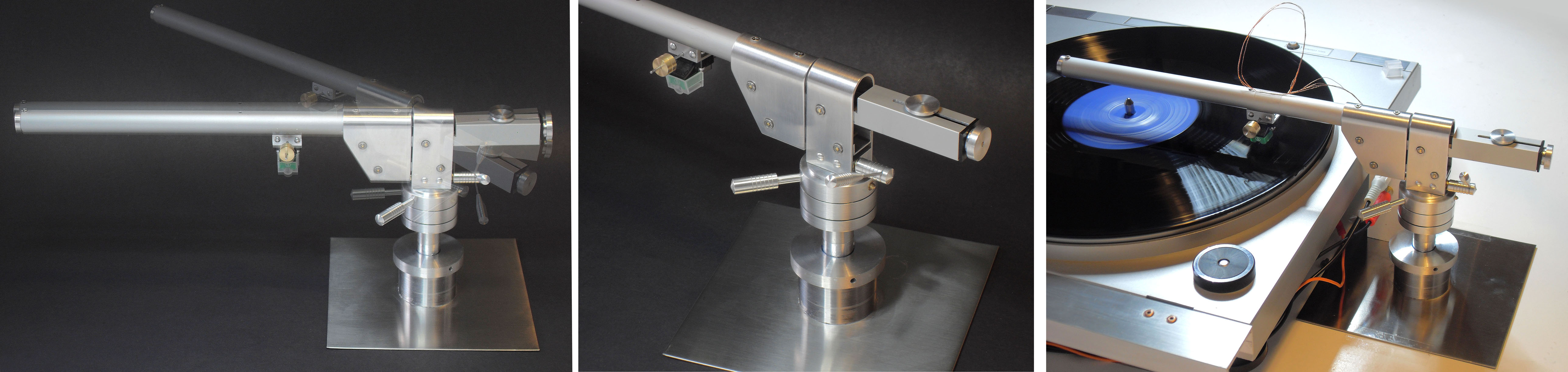

radial rail TA - first impressions

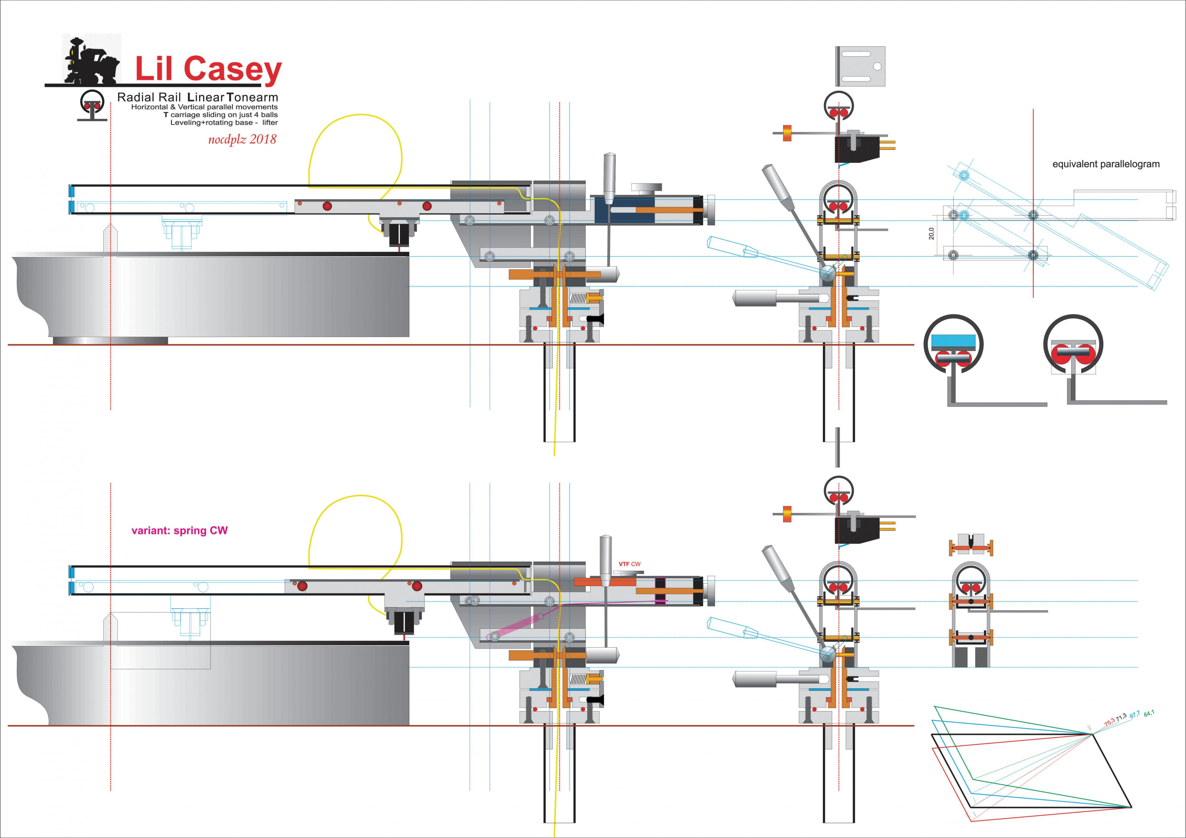

Lil Casey finally ended: a linear tonearm with radial rail and both articulations truly parallel (hor. vert.) . The first? who knows, it would be funny that no one ever tried....
How does it work
first of all it works, and with the linear ones it's not always guaranteed (you know what I mean). The reason for this design (to avoid the frictions due the torque on carriage) works; the side force is applied on axis without dispersions, so its behaviour is really different from what I know, including my # 2360 which used the same principle of non recirculating balls for sliding. Here on eccentricities is the carriage that moves back and forth, not the stylus.
Naturally the frictions must be the minimum possible, here we do not have the great advantageous momentum of a pivoted, only what's enough to track with high compliance cartridges and low VTF without servos, air pumps and so on. The carriage runs so well that the resistance of the cable (even thin as that in the photo) is much greater: I will try to make it softer and longer, with a wider loop.
The problem of carriage tilting exists, but it is enough an accurate setting of the small CW and some attention during the initial insertion: the variations of the stylus drag don't prevail over the self centering carriage.
The vertical articulation of the parallelogram works too, but with 4 + 4 bearings we are really at the limit: on steep warps is the stylus at first to face the work (no good!). Lower weights (carbon fibers?) and better bearings (jewells?) are to try for sure ...
The trad CW is OK, and easy for fine adjustment. The spring CW behaves just as well, but the fine adjustment is really critical, perhaps the spring found is too short
Of course the base must be rotating for disc changing but, more, be adjustable for leveling: here just a slight inclination of the rail does not help at all, rather it damages a correct movement. The designed solution is compact and comfortable and the lifter rotates smoothly which is crucial for this kind of arm.

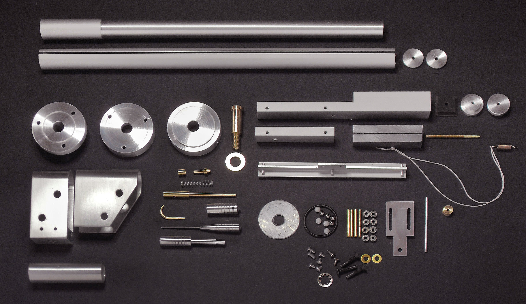

How it's made
I have already mentioned the difficulties of construction without a milling machine: more time lost in cutting and drilling templates than in parts themselves: a lathe for the base and other details is useful, but with patience, maybe assembling existing pieces you can also end the job.
What I had to give up is the lightening of the masses: a 12 gr rail, painstakingly built, was in practice completely useless. With aluminum what you get in lightness you'll pay in harmful resonances too. I've ended with a 37 gr total mass, cartridge included. I have used anodized ergal profiles, with very smooth and hard surface, good for rail and cart, but this limits available sections: a double vee non tilting carriage instead would make the arm more comfortable...
So:
another unbelievable Super Arm? no, just an experiment, a prototype: an open door, a road that deserves to be explored. Simple to conceive, not so to build: the problems foreseen by you all, and me, are partly still there, but can't impede the arm to play pleasantly. Now we can understand their real role, and imagine many possible improvements to work on.

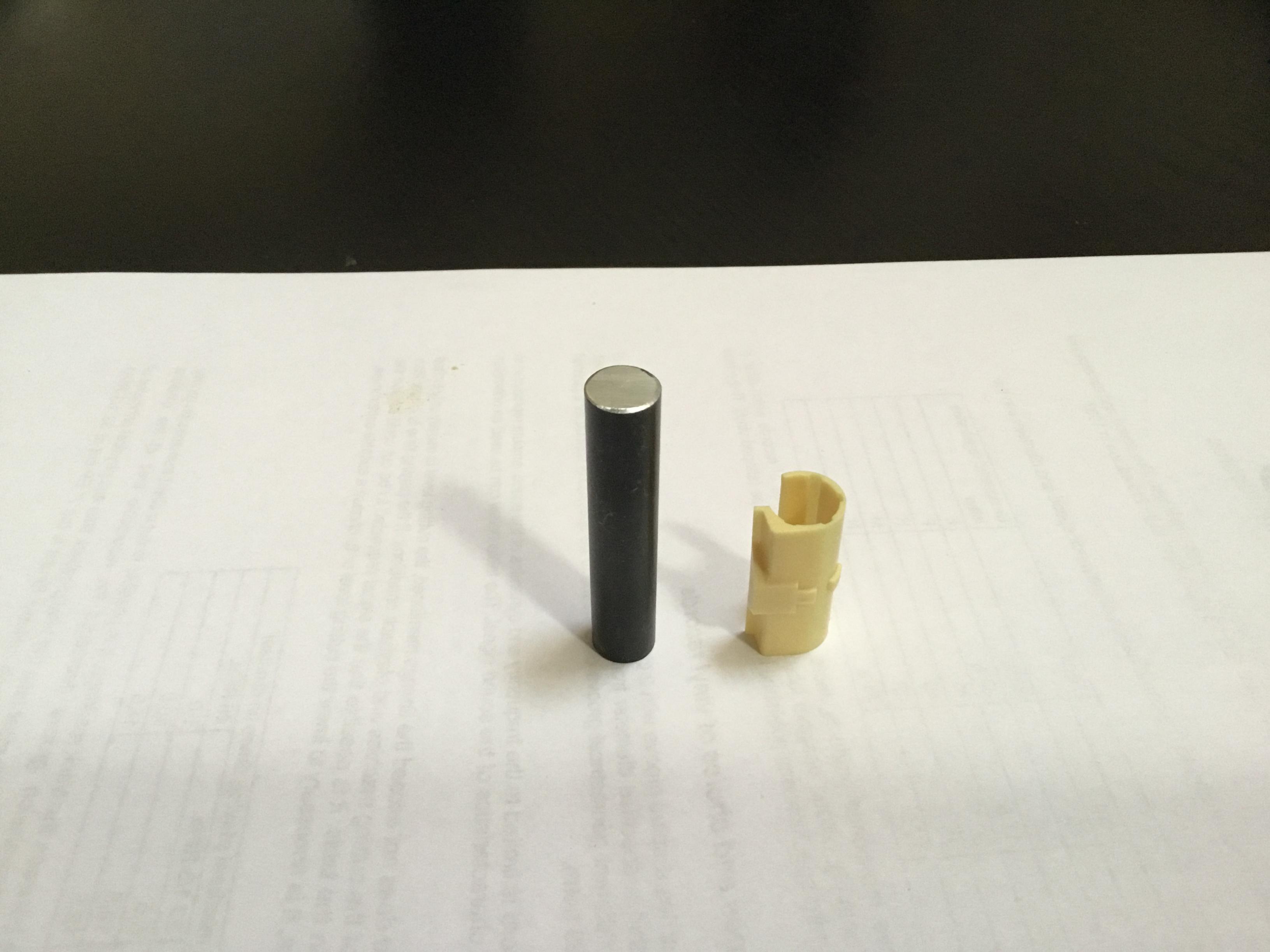

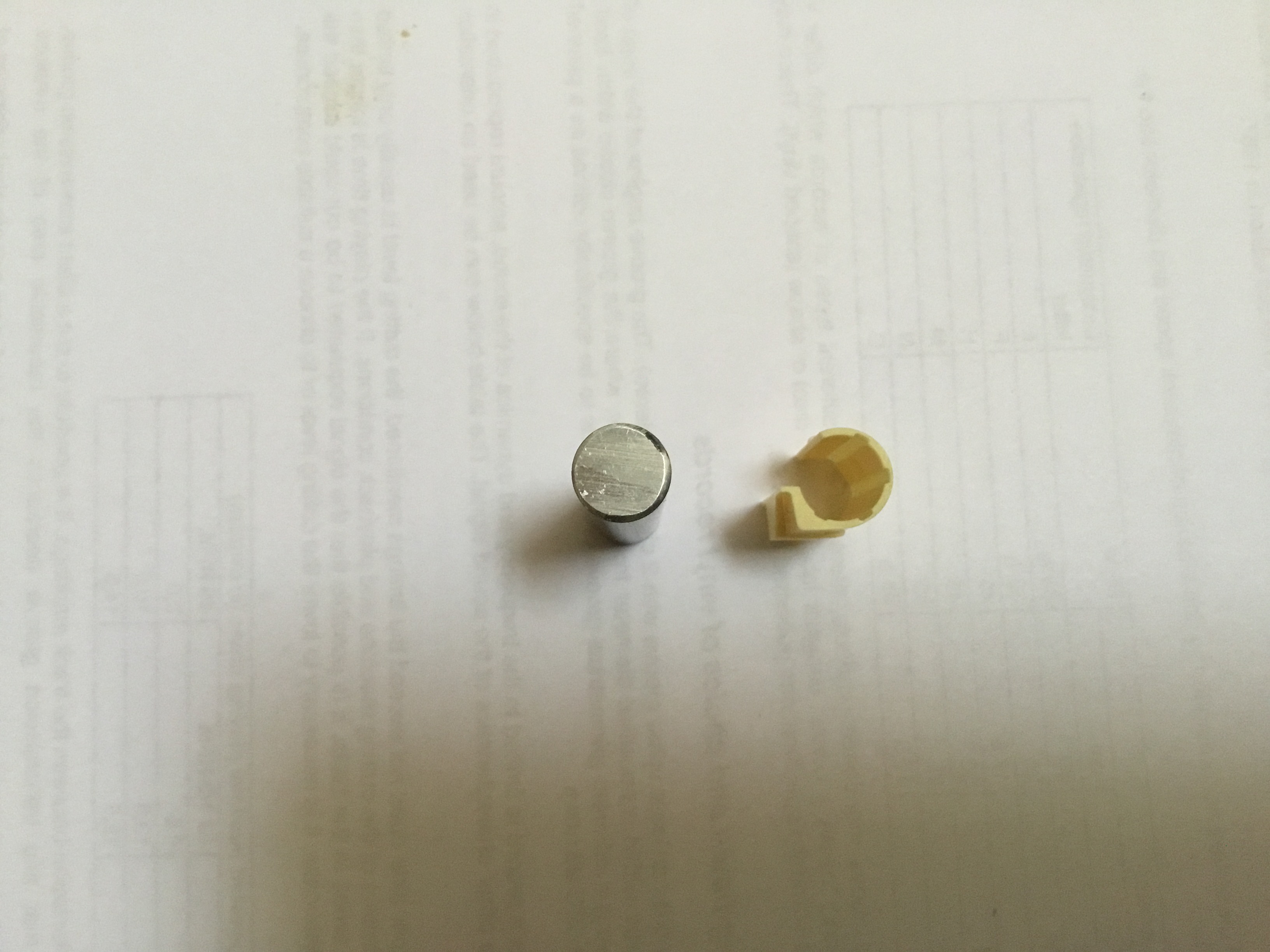

Hi all,
Defining my build:
passive , I want to use a Igus bearling liner “slide foil” as main bearing-without the housing. For both radial and lineair function
https://www.igus.com/product/964
Actually I want to use one for the W- type rails, but is not separately listed
Has a handy square protrusion to hook the arm on
Weight= 1 gram, 32 mm long, 12 mm shaft size
Hard anodized aluminium shaft (glass-not convinced yet)
Arm about 50 mm long, CF, shape don’t know yet

Hello Coolerooney,
I hold Igus bearings in high regard and I am using them successfully in my own tone arm design.
However, I don't think that they will work correctly as carriage bearings in your application although I would be pleased for you if I am wrong! You can't beat air, jewel or ball bearings.
But go ahead and experiment. The Igus bearing is low cost.
