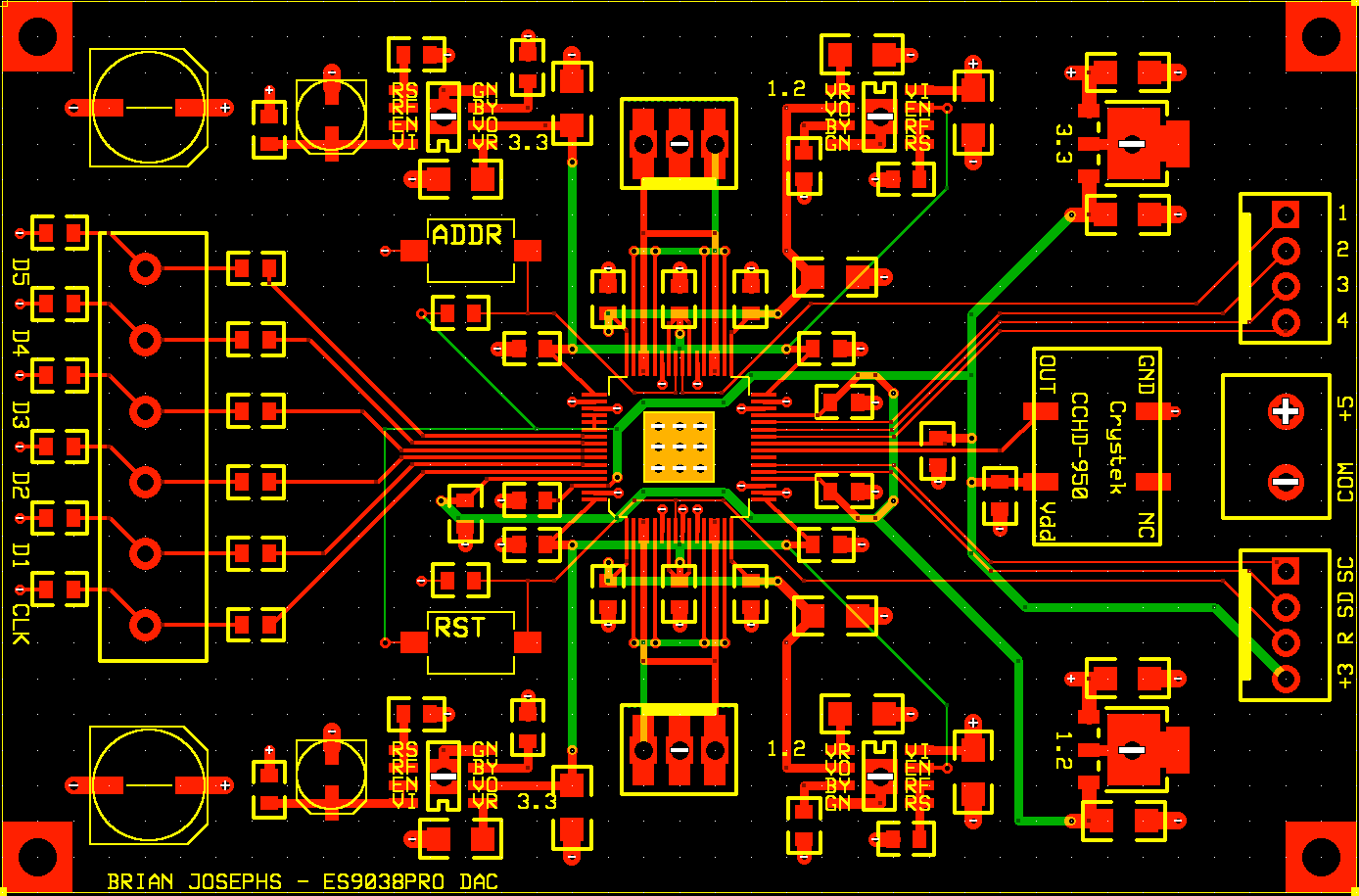

So you'll be running it in master mode but using s/pdif? Are you sure that that is a valid configuration?
Nope, I meant to communicate the opposite. Because I'll be using SPDIF primarily (the inclusion of an I2S and DSD header are a nicety) I don't know if I need any of the clocking functions. As you imply there is no way to back clock SPIDF but I'm not sure if the ES9038 would still need me to set the NCO to match FSR*128 or something.

If all you'll be doing is feeding it s/pdif, the simplest thing you can do is to supply a fixed MCLK of at least 24.576MHz. But since we are living in a real world, just put in a fast oscillator with the lowest phase noise you can find. 80MHz to 100MHz is best. This way the ASRC will do a better job of de-jittering the signal.
You do not need to do anything with the NCO etc. Those settings are for when you are running the 9038 in master mode with an I2S slave.

Thanks!

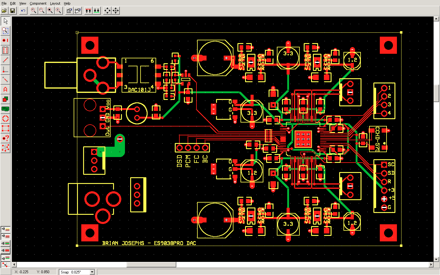

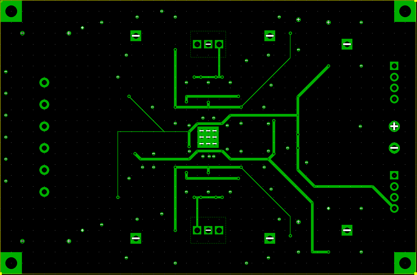

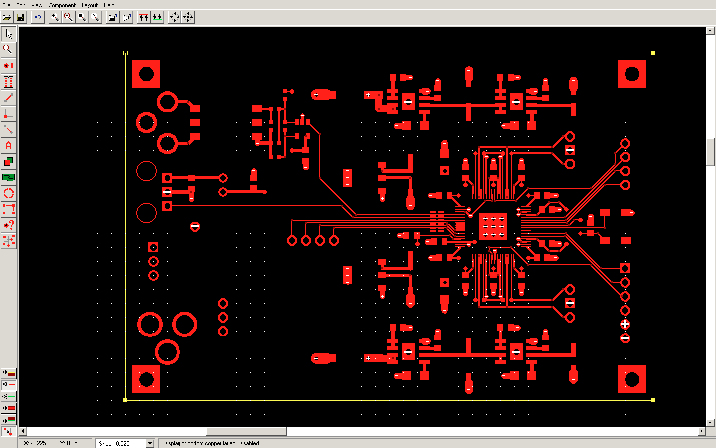

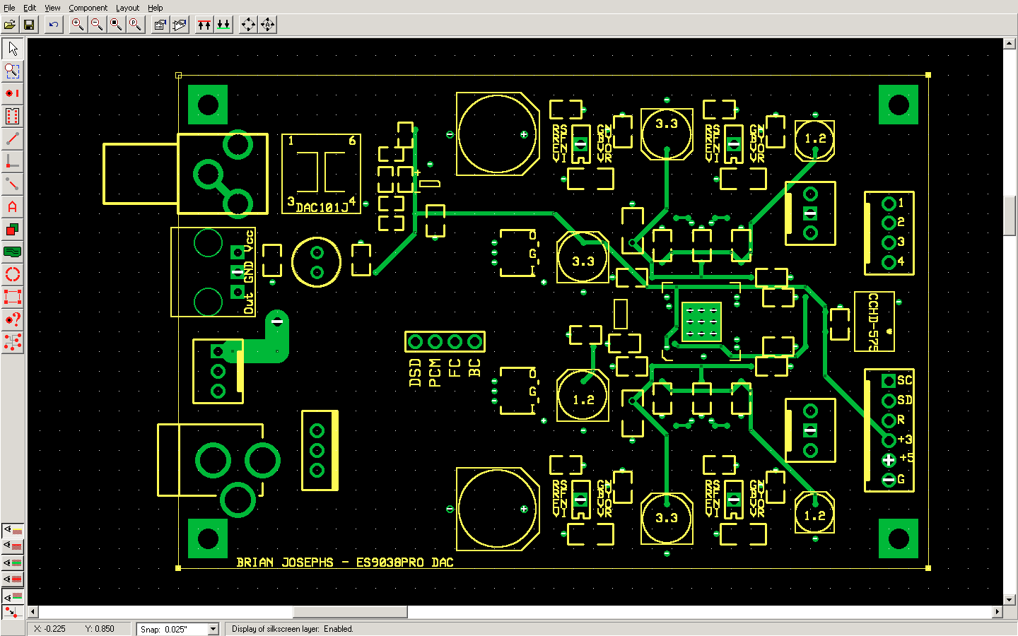

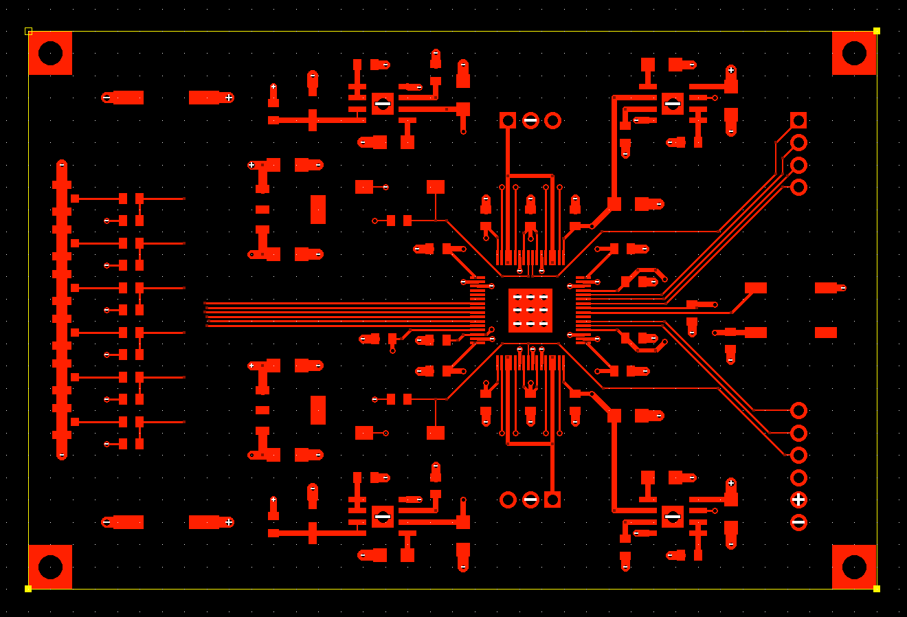

Update:

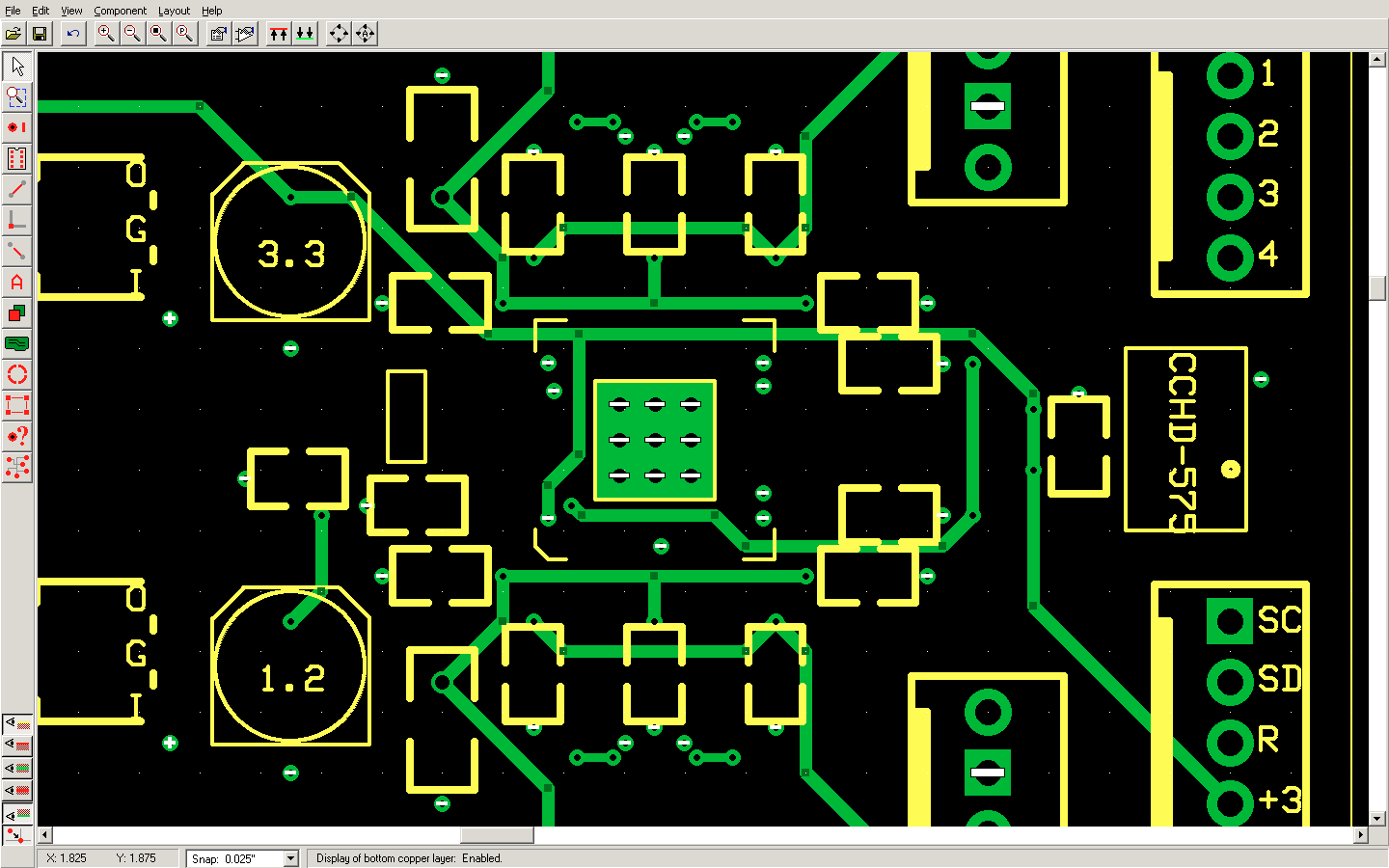

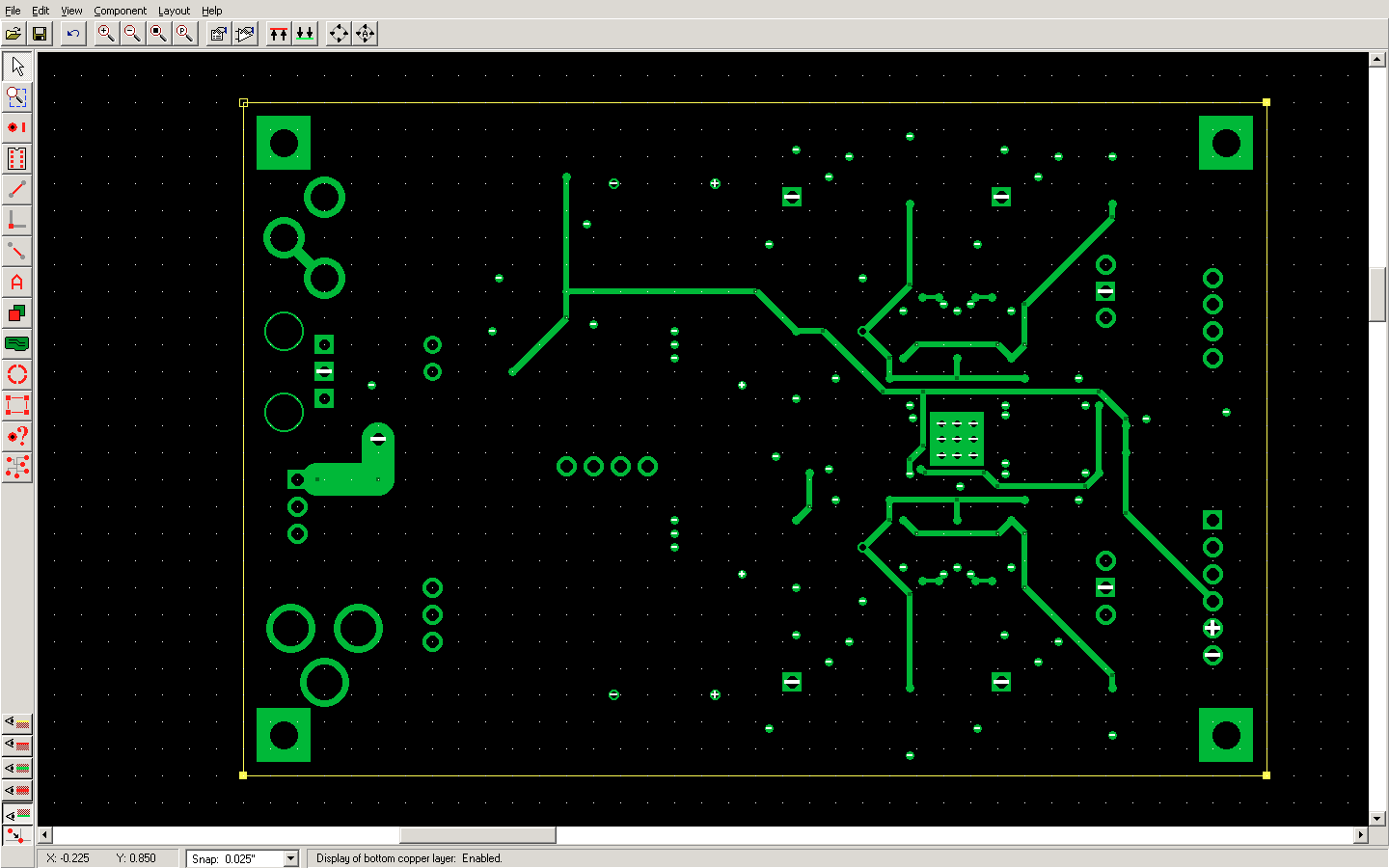

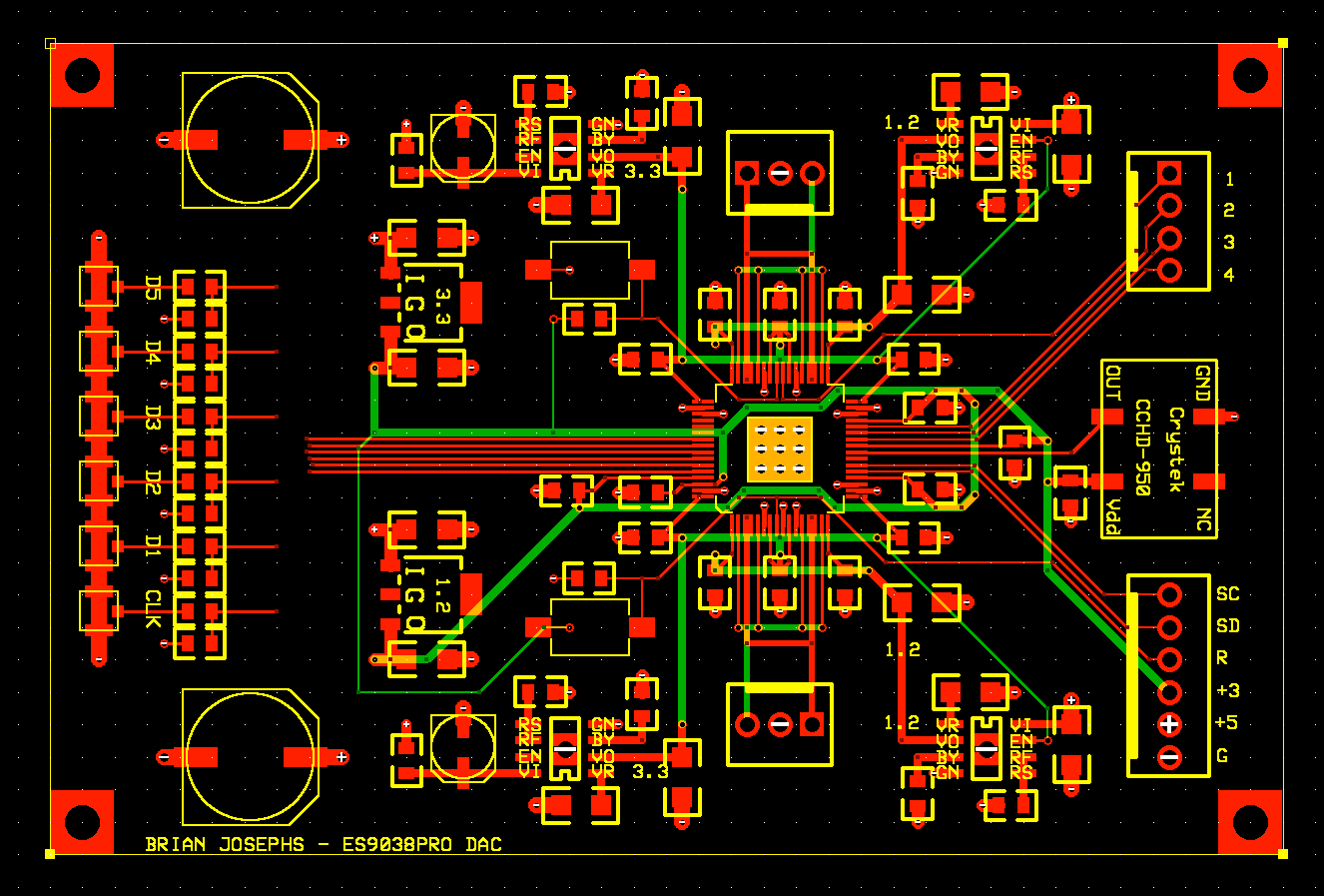

I've tightened up the layout a bit by switching to a smaller oscillator and splitting the digital signals into two headers. The lower left corner is reserved for input power conditioning. I still haven't worked out the power input just yet, whether to bring in a regulated 5V or include a regulator or DC-DC converter on board. Below are screen shots including some close ups of the ES9038 area.

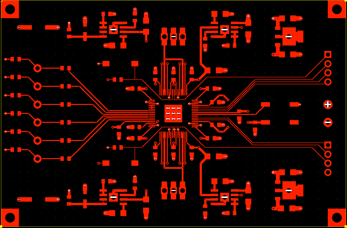

OK. I took a break because I was having trouble making decisions about what input formats and connectors to allow for. The board was packed and I wasn't sure I wanted build in the SPDIF conditioning at this stage since I'll be getting 3 boards and they may get 3 different I/O configurations. This new version is less packed and will have input connectors for (probably) 5 of the input pins so I can experiment with different formats. I'm leaning towards having pads for U.FL connectors and holes for terminal blocks. Still not done yet!

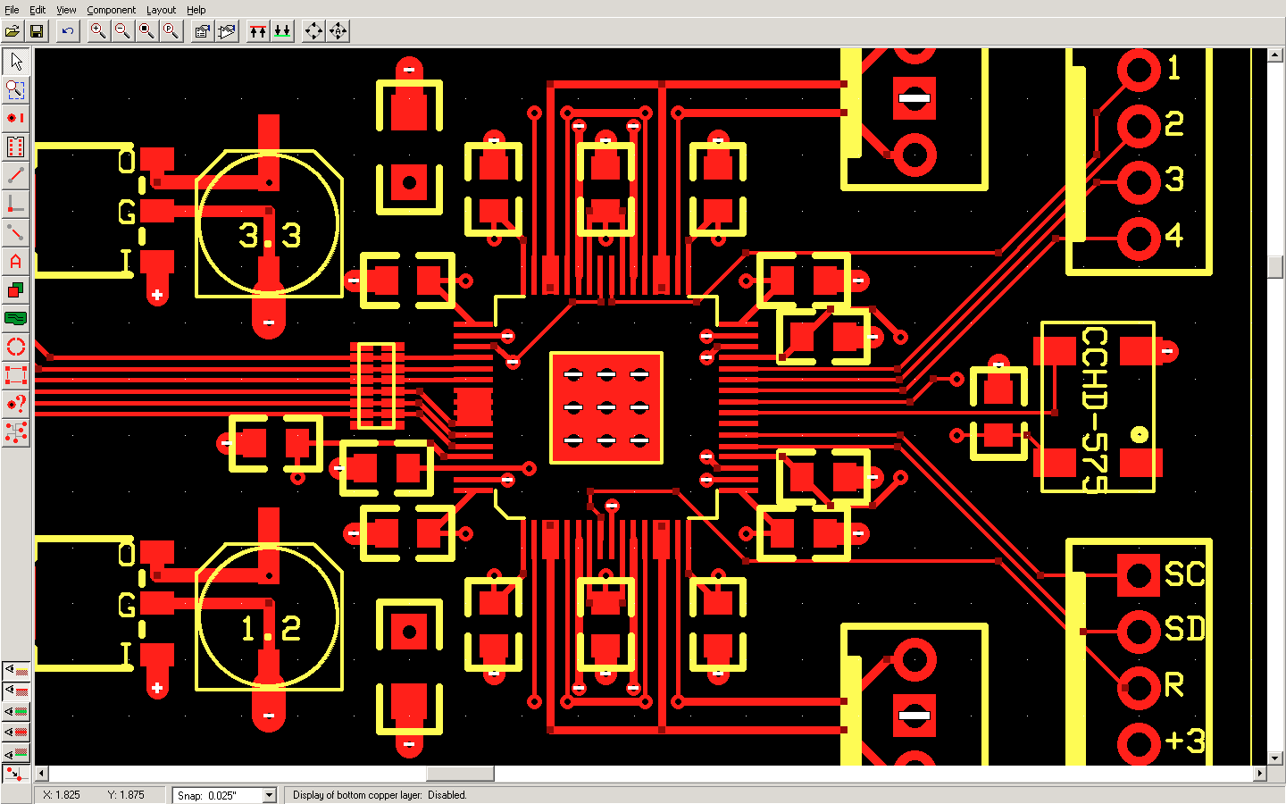

Are normal .1" headers "OK" for clock signals at high sample rates? I see them used on reputable boards.

After doing some reading I've decided to go with a simple .2" pitch screw terminals on the input with enough connections for 3 SPDIF + 2 channels of either DSD or I2S. There will be a bottom plane pour over the whole board to help sink heat off the regulators but I have it hidden for now for clarity.

Unfortunately, I was given some advice that my grounding scheme was not likely to work. I had found som ESS literature that stated using one common ground for all digital and analog paths performed best. It was suggested to me that this applied to older DAC chips from Sabre and that the 9038 pulled so much current that this may not be advisable. I lost my stride after that and haven’t thought once about building a DAC. I still have a pair of chips though - perhaps someone here can post some of their work and re-inspire me?
Maybe making some room for NZ2520SDA cyrstal?
It's smaller, less-expensive and even as good as CCHD-957s.
