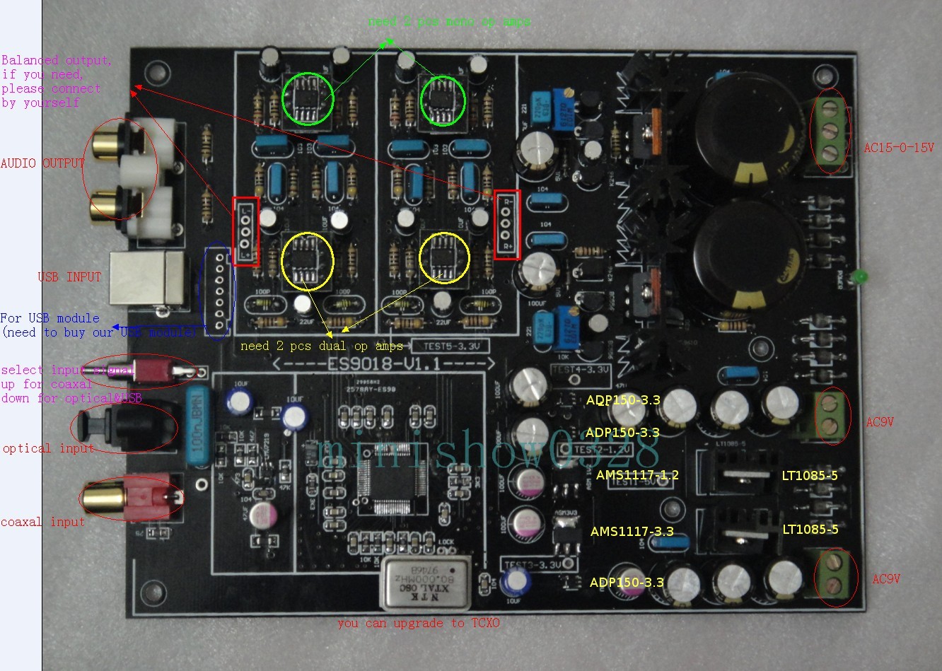

I have one of this boards in a nice case. The DAC sounds fine to me. It is especially good on poor sources, because of the great jitter-reducing properties of the SPDIF receiver. I have used it with good results with a satellite radio receiver, an Apple-TV and a (broken) SONY SCD-C555ES CD changer.
Before talking about my own system, I want to point-out how this board is reasonably well-designed – for the price point. Because the ~100USD price of the basic board in kit form (including the ESS9018 chip,) it was not possible to include amenities like I2S input and a discrete regulator for AVCC. However, this is still a subjectively good-sounding DAC.
Objectively, the SPDIF receiver of the ESS9018 DAC is excellent, with exceptional resistance to jitter. As for the use of monolithic regulators for AVCC, this board uses the ADP150 ultra-low-noise regulators from Analog Devices.
The ADP150 is a new-generation chip with a very low noise figure (something like -111dB, I estimate.) The particular regulators used are the ADP150AUJZ-3.3 3.3V regulators in 5-lead TSOT (tiny) packages - as can be seen from the “LEJ” branding on the packages. (This information is from the Analog Devices application note “ADP150 Ultralow Noise, 150 mA CMOS Linear Regulator.”)
Three AD150s are used. Two are for AVCC (right and left use separate regulators.) One is used for the XTAL (AD explicitly mentions “RF, PLL, VCO, and clock power supplies” as applications for the AD150.) Because the ADP150 can use a maximum 5.5V input voltage, LT1085-5 5V 3A pre-regulators are used. One feeds only the ADP150 for the XTAL. The other feeds two ADP150s (for AVCCL and AVCCR) and two LT1117s (for 3.3V and 1.2V digital.)
I enclose a figure with the regulators labeled (the labels are to the right of the regulators.)
Because the AD application note stresses the need for low-ESR capacitors after the ADP150, a possible area of improvement is substituting the generic 100 uF, 16V electrolytics after the ADP150s for AVCC(L&R) with low-ESR caps, for instance ELNA ROA (cerafine) 220uF 25V or 330uF 16V. I will report on the effects of these upgrades.
As for the op-amps, I will try TI OPA827s for both the single and dual positions, with decoupling capacitors soldered directly to the DIP to SOIC adapters.

including i2s inputs doesnt cost anything at all. making proper layout, also comes cheap, if you claim to be a designer of proper layouts. multilayer would be preferred, but 2 layer could be made to work
ADP150 is not suitable for any of the analogue supplies, despite what the designer might tell you. the ADP150 is a plain vanilla, not particularly low noise LDO with typical pretty slack transient response, that costs $1 singly, buy 100 or more as he would have and its 70c each, is that what you want for the low noise stages?

thanks for this nphil. It took me a couple of days to find the ad150 because the only marking is that bloody LEJ....
in my dac there is one ams1117 aka Linear alternative and an LT1129 (the one nearest to the clock). I think that all regulators will benefit from low esr output caps directly at the pins, they are too far as they are now. The spdif has an lmv7219 and its nicely arranged with caps close to output and input. Let us now of your progress.

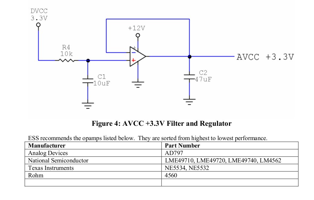

In the ESS application note, a simple circuit is shown that uses an opamp to clean up the AVCC supply (Fig4.) The way the circuit works it that noise on DVCC is filtered by R4 and C1, while noise on the 12V supply is reduced by the PSRR of the opamp.
It should be easy to implement such a circuit on a perfboard, using an AD797. Using this circuit would leverage the decent 15V supply to produce a clean AVCC. Main problem in actual use is grounding.
This would be a more worthwhile improvement to this system than trying to implement I2S (I think.) It is also in the spirit of DIY audio, no?

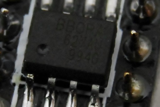

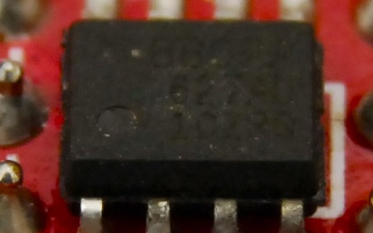

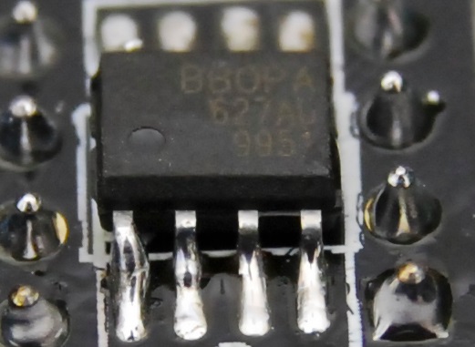

Do you really think that the OPA627 could be real for that prize? I have noticed that what is supposed to be a date and plant code does not remotely look like the date codes on the verified genuine ones. It is also identical between all opams including the ones received from another ebay seller. I have taken some pictures of the assumed fake opamps i have. The first one is what came with the dac. The second one is what came with my 'Lovely Cube'. The third is what came with another project. They are all post order from China. If they are genuine, you are correct about the age, they are from 1999 and 2001. Do the look like a real opa627? I have nothing to compare with. Is the a way to measure and verify them? A realize that the best way is to listen, but once again i have nothing to compare with.

Well, they look authentic to me. Basically, if they are fake why did they use such ancient dates on them? I think they are probably real old stock.
On Digikey, a single 627AU (SOIC) costs $25.7 or so. An OPA827 costs $10.13. From my supplier (hifiic) an OPA627 costs about $4, mounted on a SOIC to DIP adapter. An OPA827 costs about $10, mounted on an adapter. This is a reliable supplier: the big difference in price is due to the fact that the 627s are ancient.
TI bought BB in 2000. They are trying to obsolete the 627, hence the high price. The 827 is their preferred replacement. They fired all the designers of the 627 and anybody who still remembers the secrets of how to make them. I think that today they are only made in a plant in Thailand. However, so many 627s were made in so many different countries that lots of old ones are available at low prices. And even at $3 each is still profitable for people in China to recover them from old boards.
