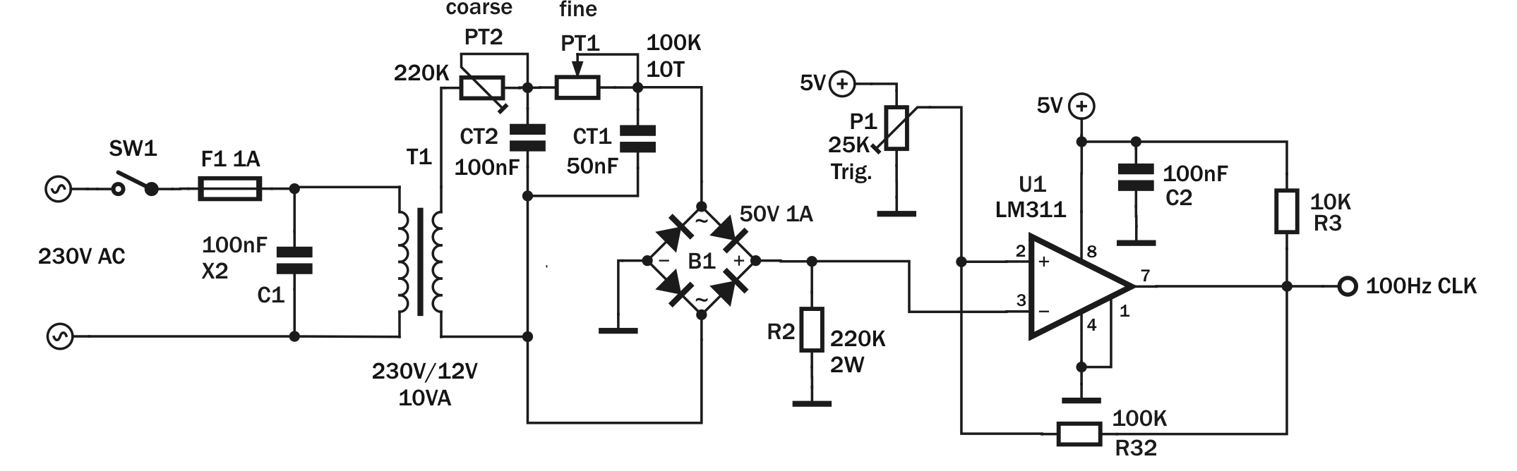

Something like this you suggest?
Yes, hope it works.
Wouldn't be safer to add a resistor between +5V rail and the bridge to limit dc current flow?
Ale
I think that during normal operating conditions the only current drained from the bridge is via the 220k to ground. This current is much less than the 25k you already have from 5 to ground at the other input of the opamp. The current thru the 220k should be roughly similar(gestimate) as if you used a 12v transformer. Is the concern the 5V supply? That one will have many more ways to short out, maybe the current protection should be on the supply itself.

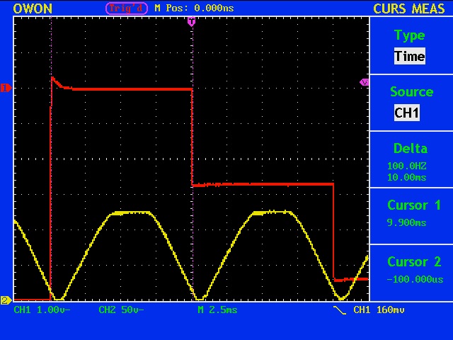

Ale, I am a bit confused as to how the circuit is working now. It seems you have two phase correction circuits. What does the 25K pot do? When you say it is all the way to one side. Are you setting the reference to the non inverting input to 5V or to 0V? When you move the 25K pot does it change the duty cycle of the 100hz clock out?

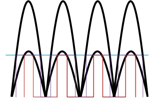

I think the comparator may be working as the picture attached. The pll and subsequent timing circuit is edge triggered. There is a large difference (picture not to scale, just as visual reference) in phase between the derived clock from a larger sine wave than a smaller one.

Very strange indeed.
Is the winding truly isolated? No common center tap. If you temporarily hook the 12V back, does it work?I stole one 6V winding of my 6V+6V for one of the LCD meters as need to be floating.
Well, I turned out that the transformer had a leak. Replaced it with another 6V+6V I had at hand and got it working again. Tried all combinations as discussed, but got stable clock signal out of the PLL with the original circuit.
In order to solve the sync adjustment issue, I added an additional RC stage to the existing one. With the original 100K/50nF I managed to get only about 3ms of phase delay which wasn't sufficient to adjust the image sync for a crystal clear set of curves.
Drawback of adding the 220K pot / 100nF RC stage for coarse adjustment is that this added additional signal drop which reduced sync window. So ended up reverting to 12V winding.
I tried many times to switch off and on the tester to see how frequently I needed to adjust the sync. And sadly it needs some minor tweaking here and there once in a while. I guess this circuit and PLL design needs improvement
Any suggestions to tweak RCRC stage? What can I do to maintain the phase shift required without dropping the 50Hz signal too much?

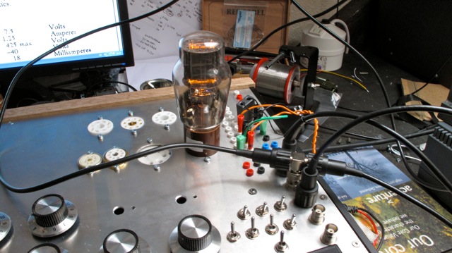

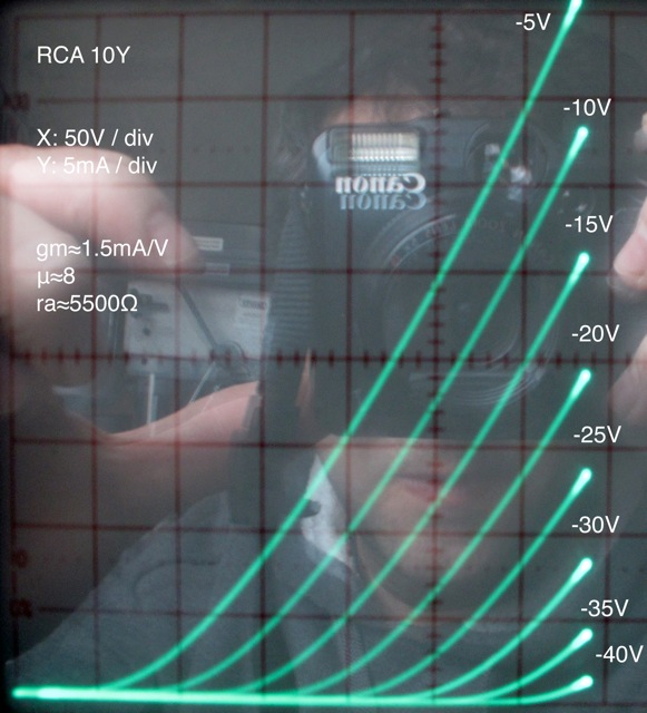

Up and running
Fixed some additional outstanding things and now is running properly.
Attached is a nice 10Y plot.
Re sync adjustment, the PLL drifts very slowly. After 15-30min of operation, the phase delay available on the RCRC stage is not sufficient and retracing goes back again to the end of the curves (i.e. right of the scope). After a while I can resync it.
Anyone expert in the 4046 PLL can please suggest a way of improving the stability of the locking if possible?
Other than that, it works like a charm!
I have spotted a couple of noisy / worn out 46 and CX-245 , so its quite useful tool to look at this in addition to the linearity of curves, etc.

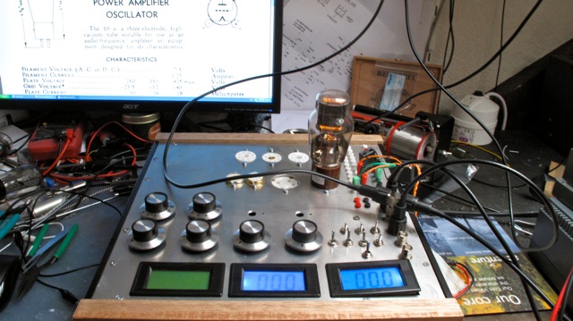

I made a new front plate to hide the original extra holes and to fit the Panel Meters. I also added a switch that toggles between sensing the current with a 10ohm vs a 100ohm resistor. My next step is to reprint labels for the switches and pots.

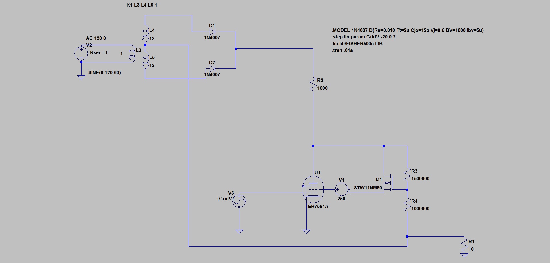

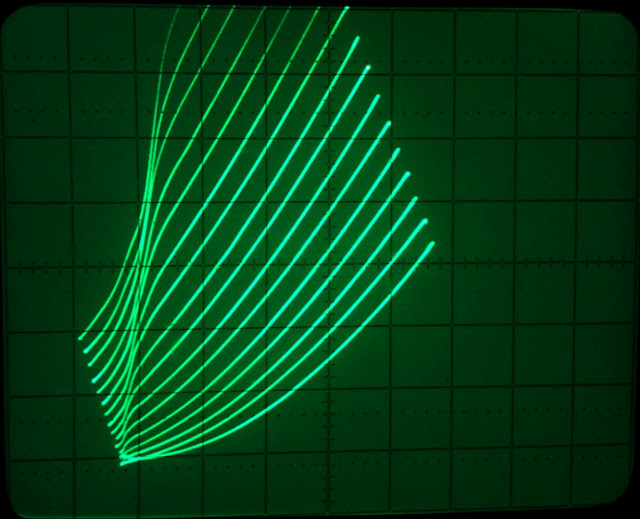

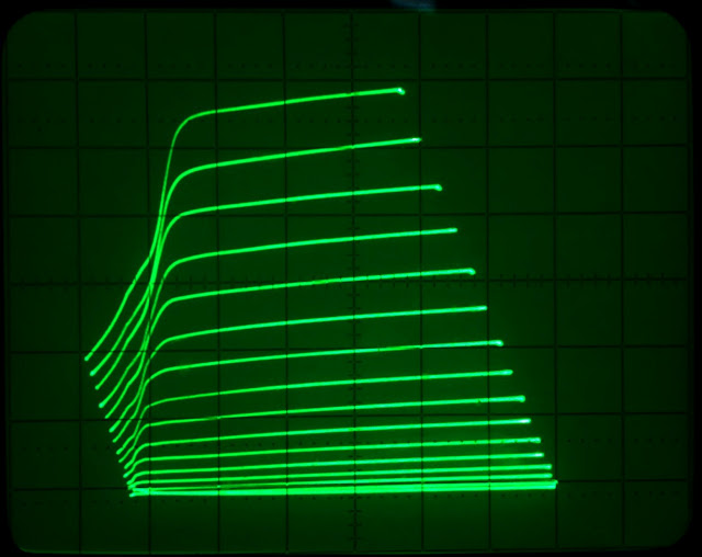

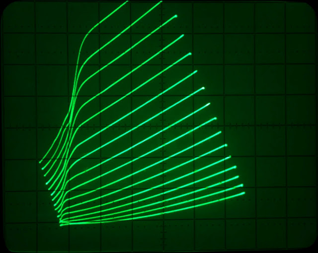

Link to UL thread

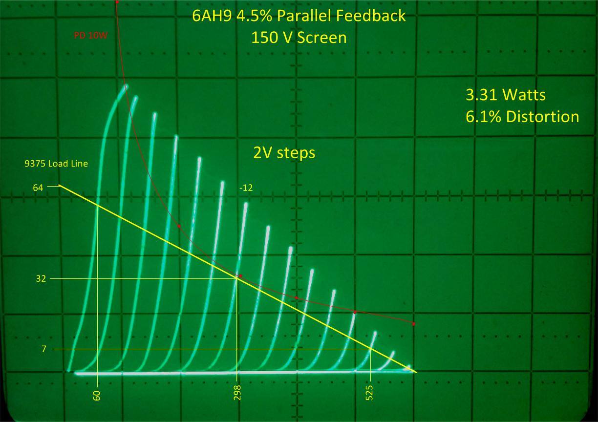

Here is a link to another thread I have been collaborating on to trace UL curves. I was able to follow some of the suggestions and use a Mosfet along with a dividing network to simulate the UL behavior. These curves show Plate Voltage vs (Plate+Screen) current. I am posting some of the pictures here as I feel they are relevant to the whole curve tracer topic.
