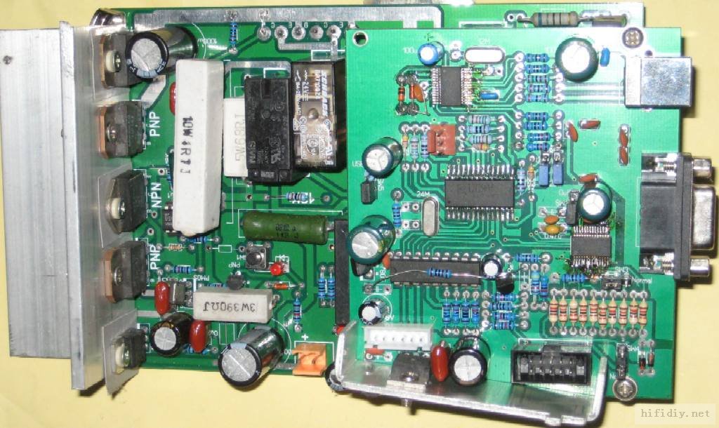

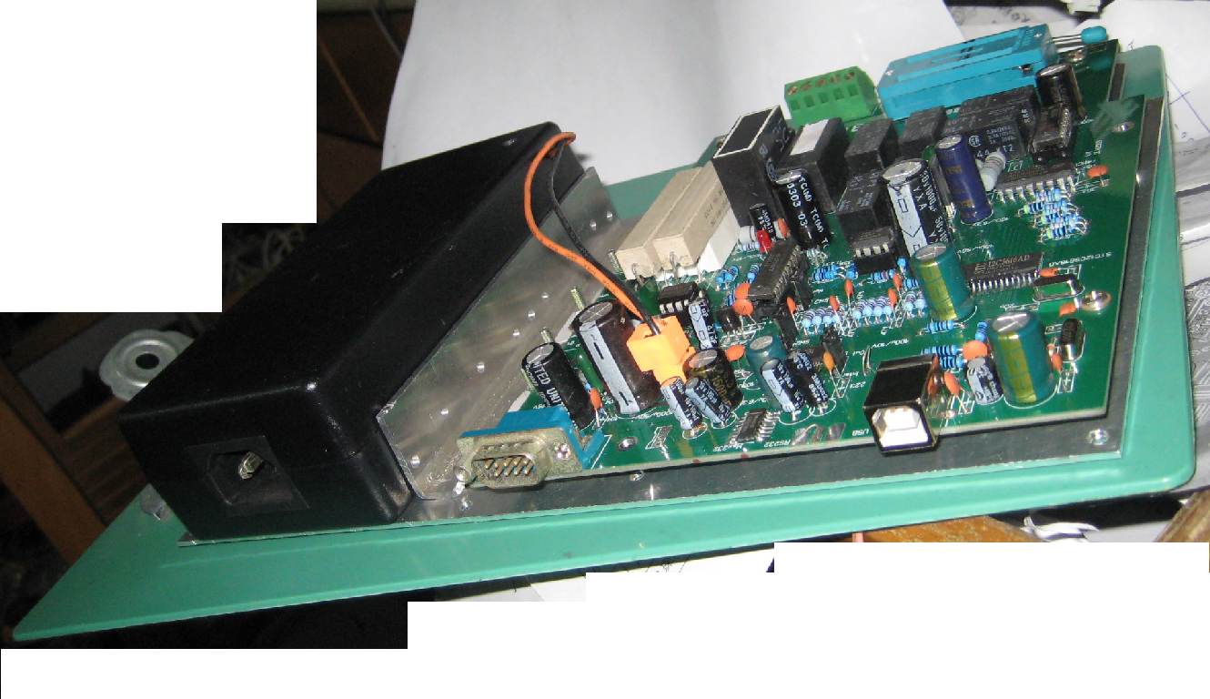

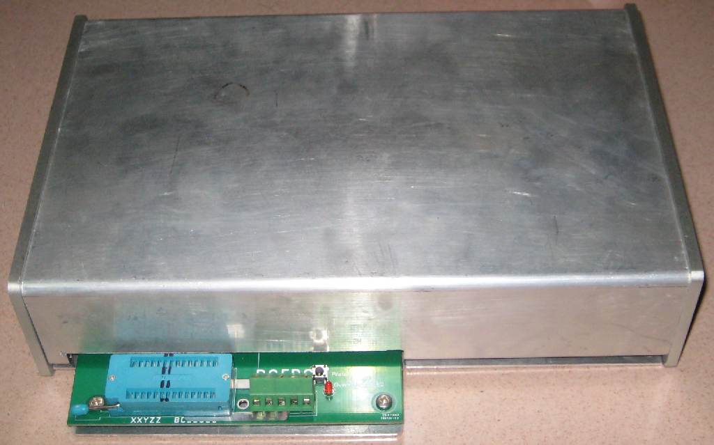

new CT version hardware and software have complete.
the version have two board, one is "mcu board", one is "measure board".
attachment.php
attachment.php
the software not only draw the curve but alse can auto detect DUT's type and pin name.
I will provide the "mcu board",and the "measure board" will not provide.

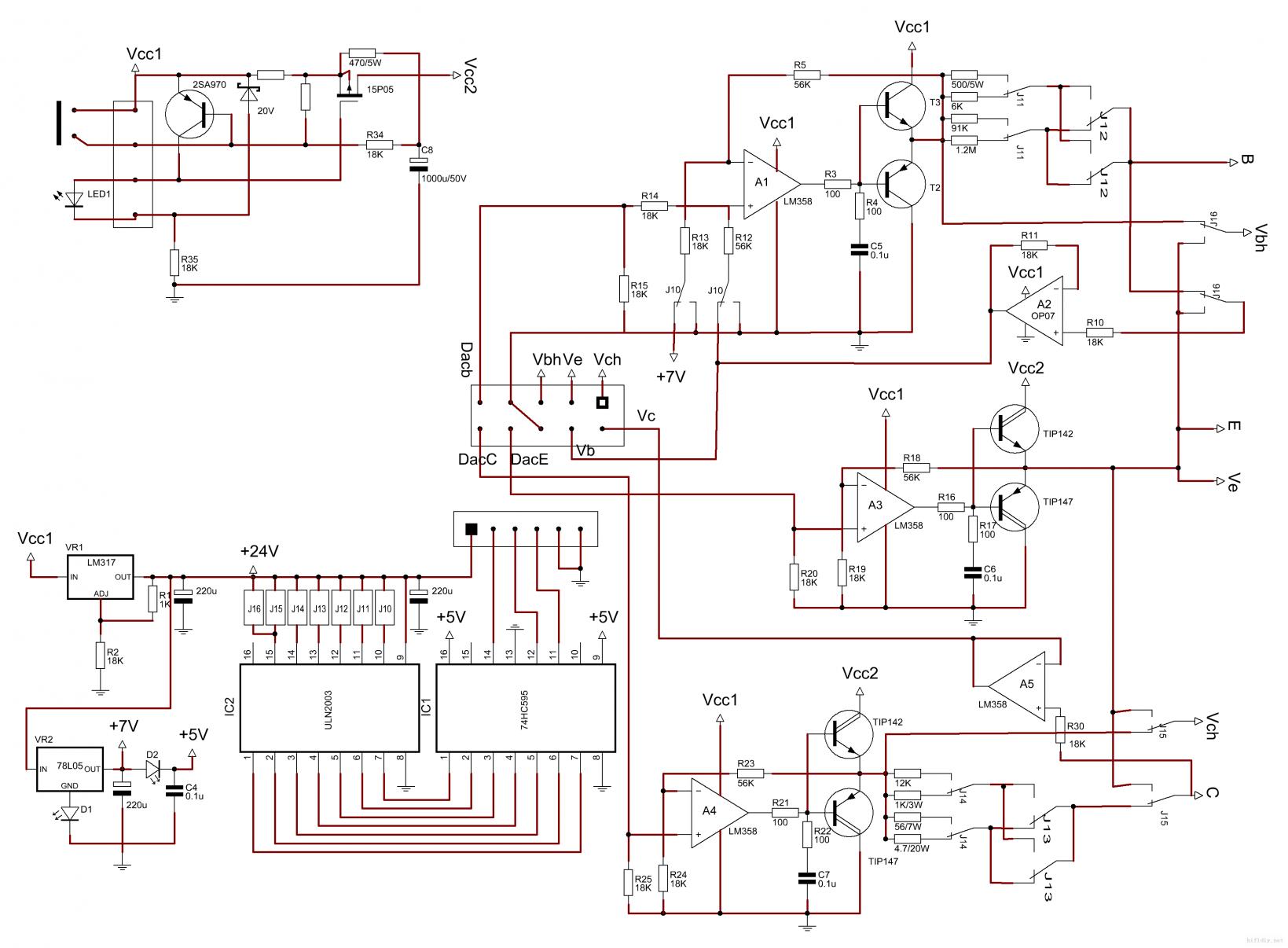

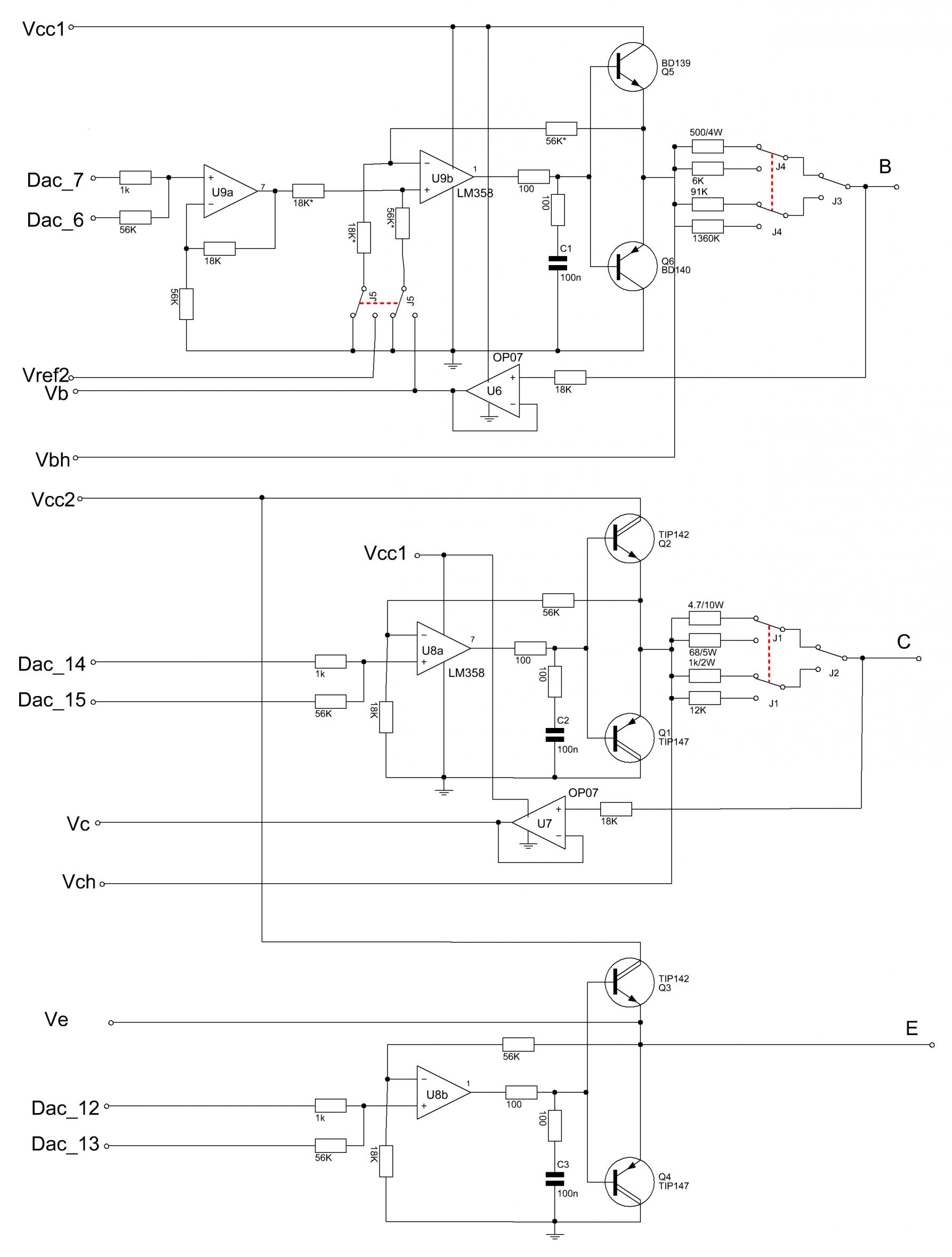

new pcb & new schematic
1.three channel power amp
attachment.php

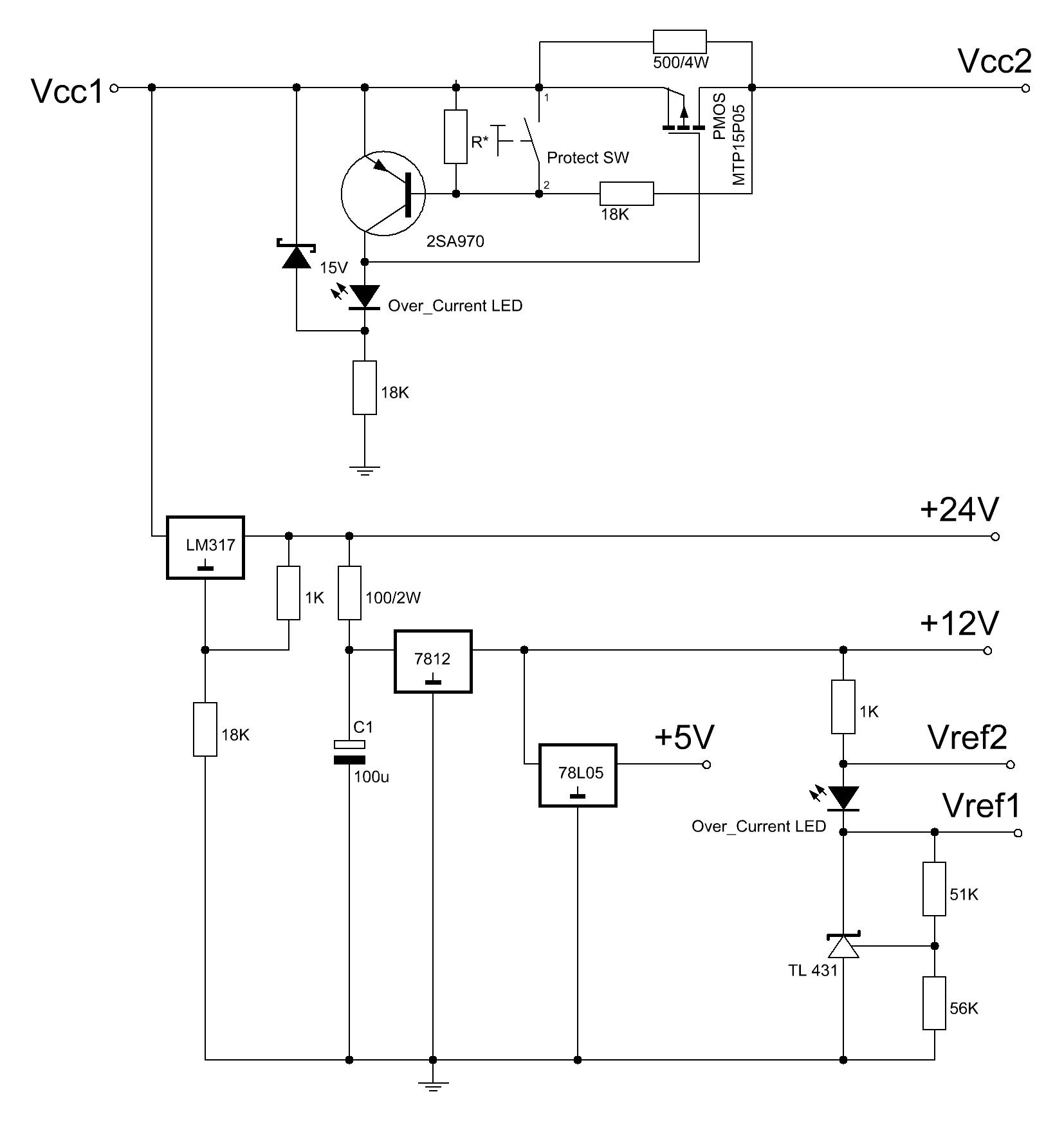

2.power supply and Protection schematic
attachment.php

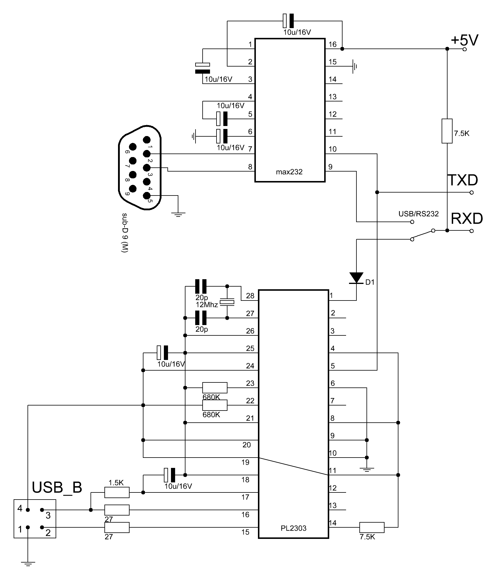

3.USB/RS232 interface
attachment.php

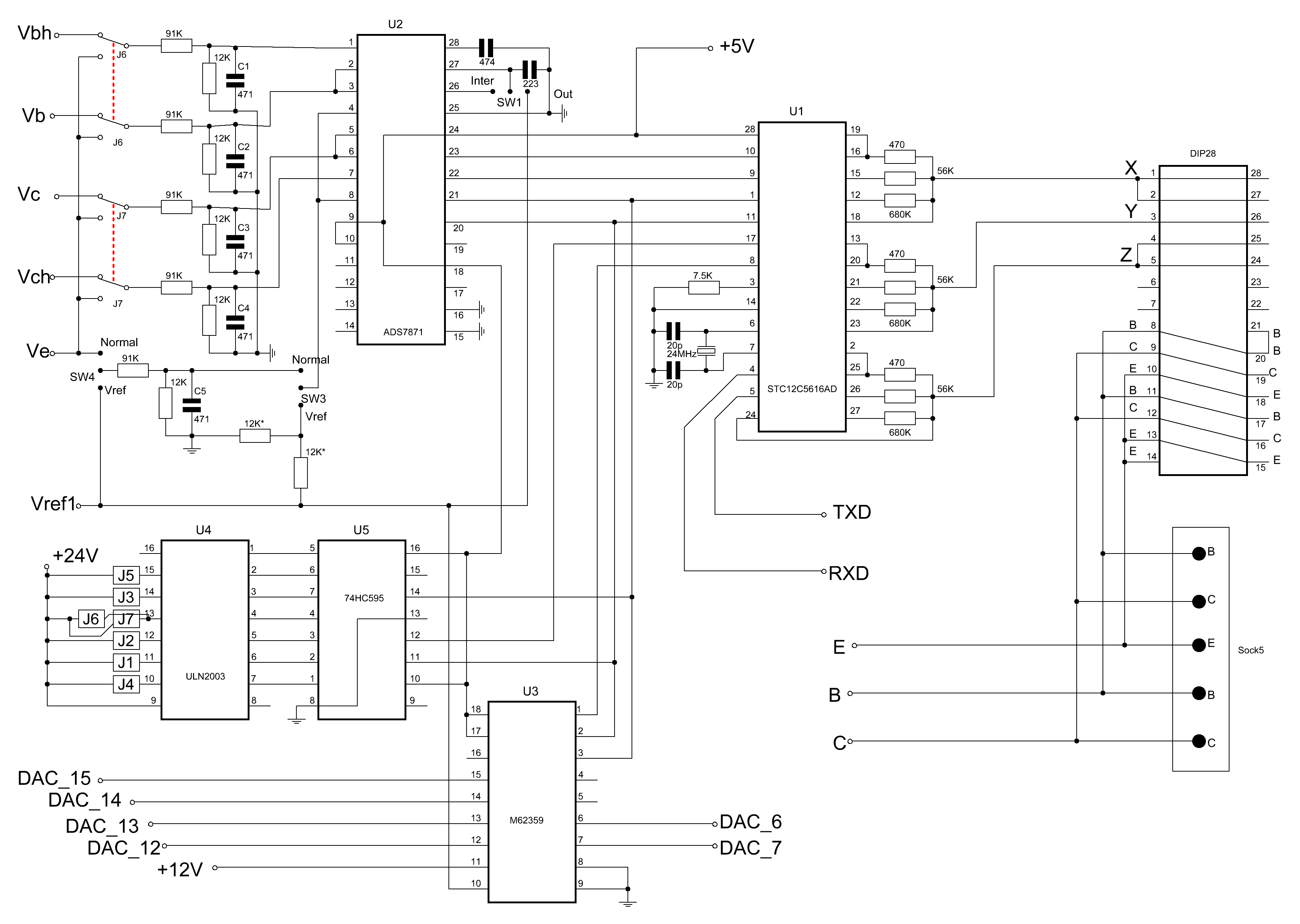

4.mcu conntrol & AD/DA
attachment.php

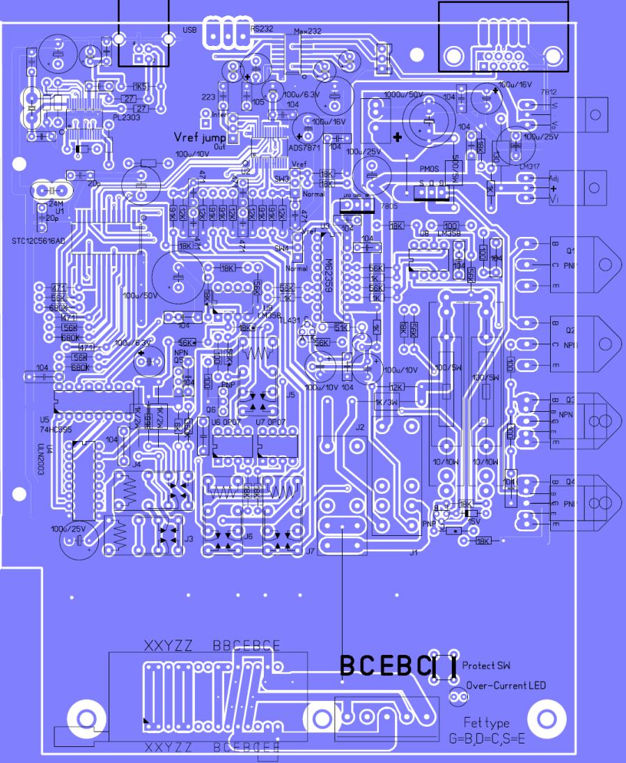

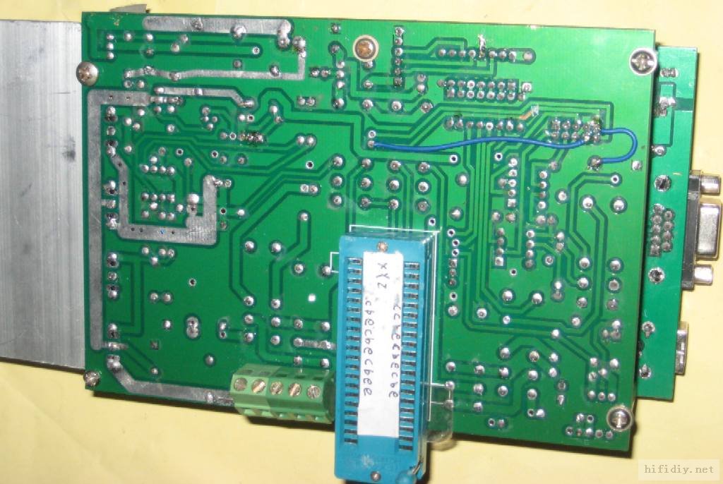

5.PCB
attachment.php

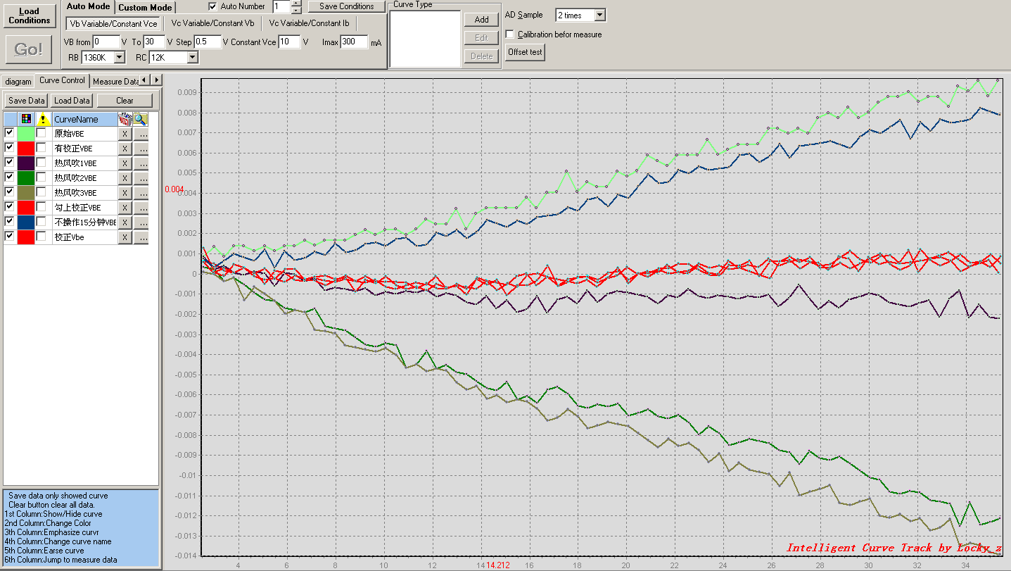

This version,temperature stable very good
I Short socket B and socket E,and use hot wind the pcb,then measure VBE voltage.
below pic is show the result.
The red curve is checked the "Calibration before measure" option,all voltage is less 1mV.
Another color curve not check the "Calibration before measure" option,the voltage is more then 10mV.
So if you want high precision then check the "Calibration before measure" option,system will spend 0.5s to calibration
attachment.php
