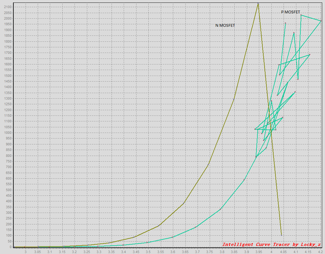

Yup. something hairy going on, looks to be noise, could be bad connections.

Try connect a 100ohm resistor between PMOS gate and socket B.But not without an issue appearing. my N MOSFET curve looks fine but my P MOSFET curve has issues. Any suggestions? Possibly a faulty relay?
