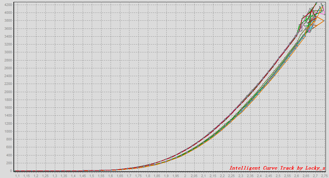

Agreed about the voltage steps. I only showed that to indicate the problem i was having. I use .05 on my N channel test. It seems to be related to available current in the circuit. Yours happens at much higher currents than mine, but you have also bypassed current limiter.
You can use another method to determine the large current oscillations,
Load ‘PNP Vbe-Ic' measure condition,
Change RC=4.55, Imax=4000mA,
Use a large current diode, insert '+' to E , '-' to C, and press 'GO',
It will measure the diode's V-I curve,
From form, observeds the 'Ve' column.
If 'Ve' value also unstable,The E Channel Amplifier is oscillation

I did the test you suggested. Looks fine enough to me.
What next?
I need to read the data on 'Ve' column.
I tried this test using Mur3020WBT and was unable to get it to work
You can set less step voltage,
Save the tabular data(.cuv), and upload them.
I have linked the data here.
There are also P and N channel traces in the file for you to look at.

I have observed these data 2SJ, Ve of the voltage is stable,
I think that the Vce=15V is too large.
When the current is greater than 3.5A,the voltage drop of RC may more than 3.5×4.55=16V,
System may hard to keep Vce=15V, and the curve is confusion.
You can set Vce=12V and try again.

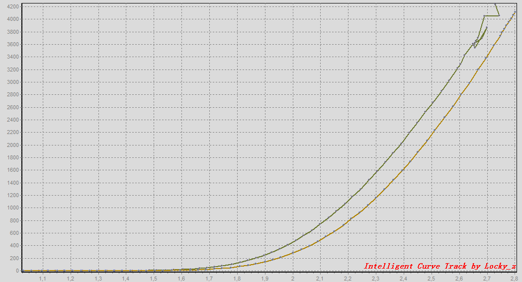

I have tried many different things with the P channel parts. Dropping the Vce has no effect on the outcome of my test. The only thing that allows it to test to 2500ma is to set the Vb steps high at .500mV. It is if the rapid step ups are robbing the bjt of current somehow. I have yet to be able to get the diode test to work either. I have tested the Diode using standard non linear IV curve without any trouble. Replacement parts should be here beginning of week.

Ok. I exchanged both the LM568 op-amps with new branded LT1013 op-amps (LT1013CP from TI - beware that the LT1013 come in different packages!).
The curves now look better, but the tracer still "panic" at currents above 3.2A.

Did reducing Vce affect your mesurements any?

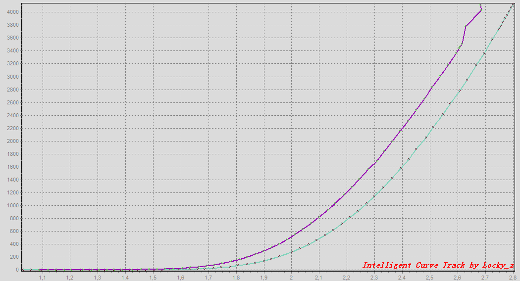

The change of op-amps also seem to improve on the "interval narrowing effect", when measuring N-channel DUT's, but still not good enough.

P.S. N-channel DUT in brown.
No. Here @ 12VNicMac,
