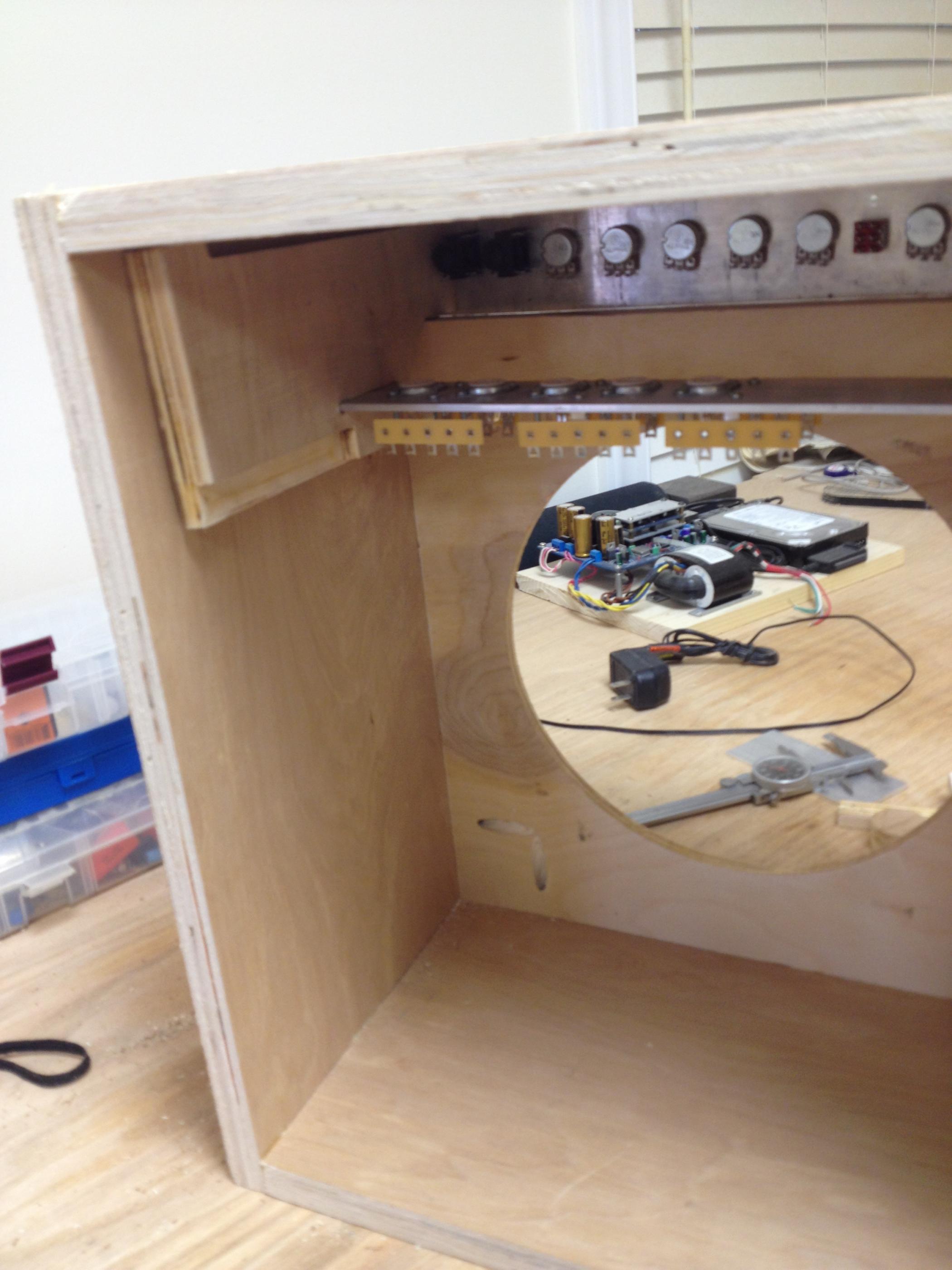

I managed an hour in the shop today so I worked on the enclosure. It's 4 sides held together with pocket screws (from the outside). Screwing from the outside will allow me to round over the corners without hitting the screws. The screws hold everything in place while the glue makes it permanent. Next I'll sand the enclosure, round over the edges, and cover it with tolex.
Wow, I cant believe how quick this came together! Awesome work!
With the live parts unenclosed in a full chassis pointing downwards, wont you risk touching them if you reach inside of the open backed cab?

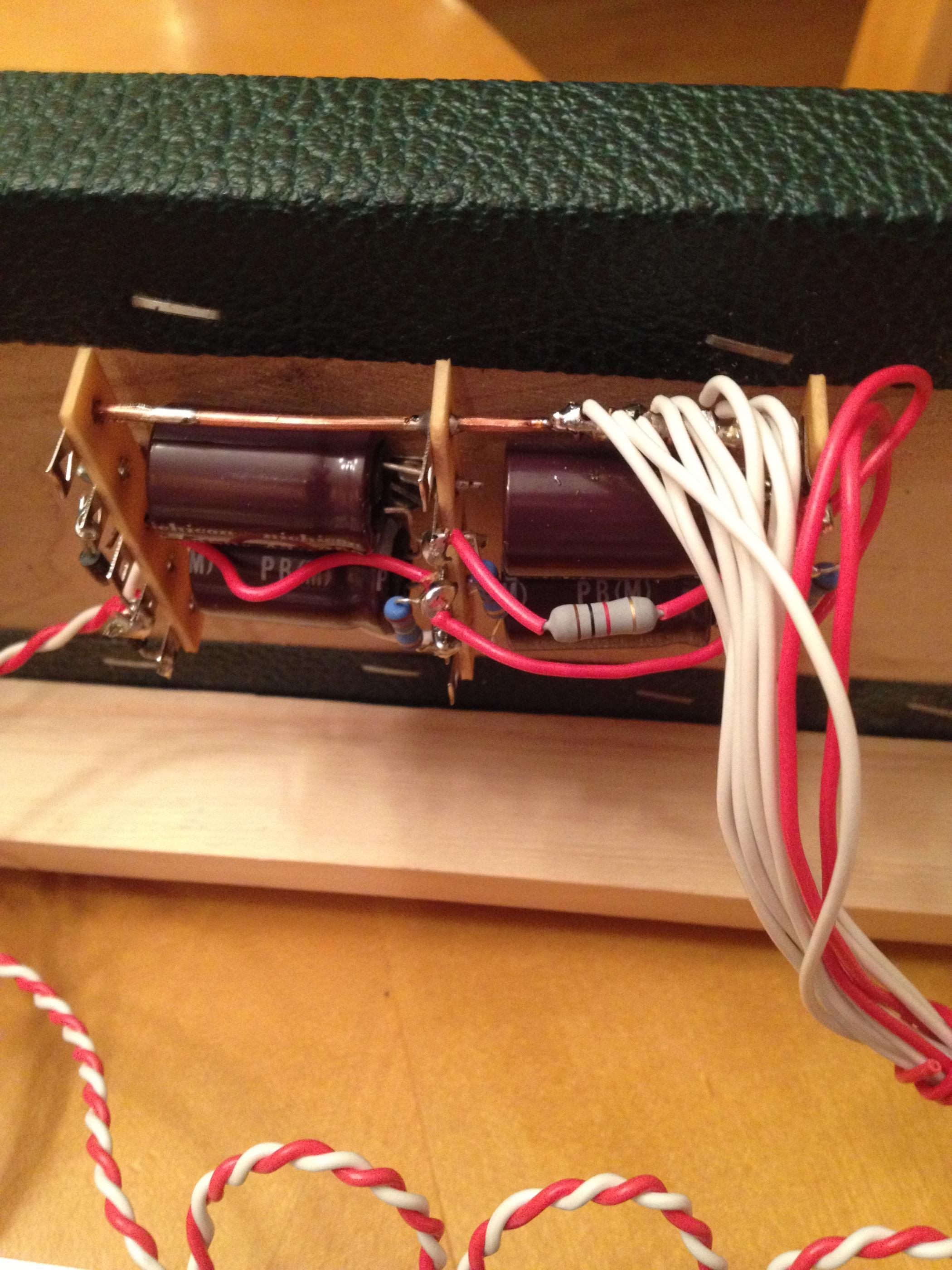

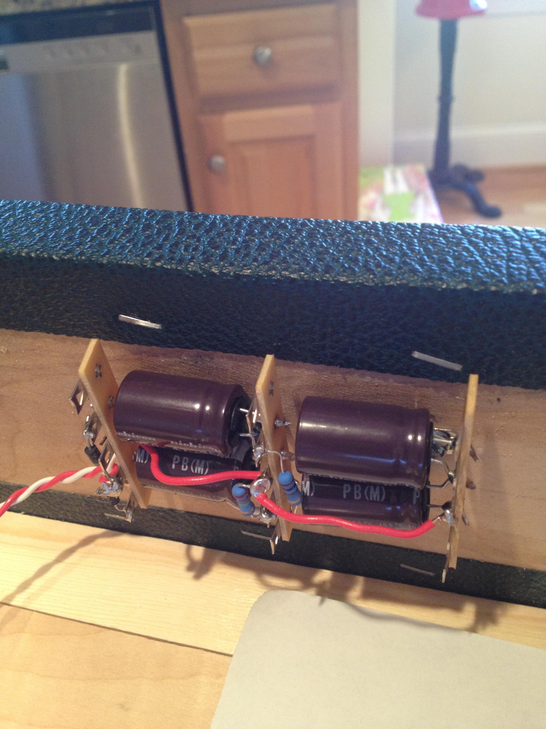

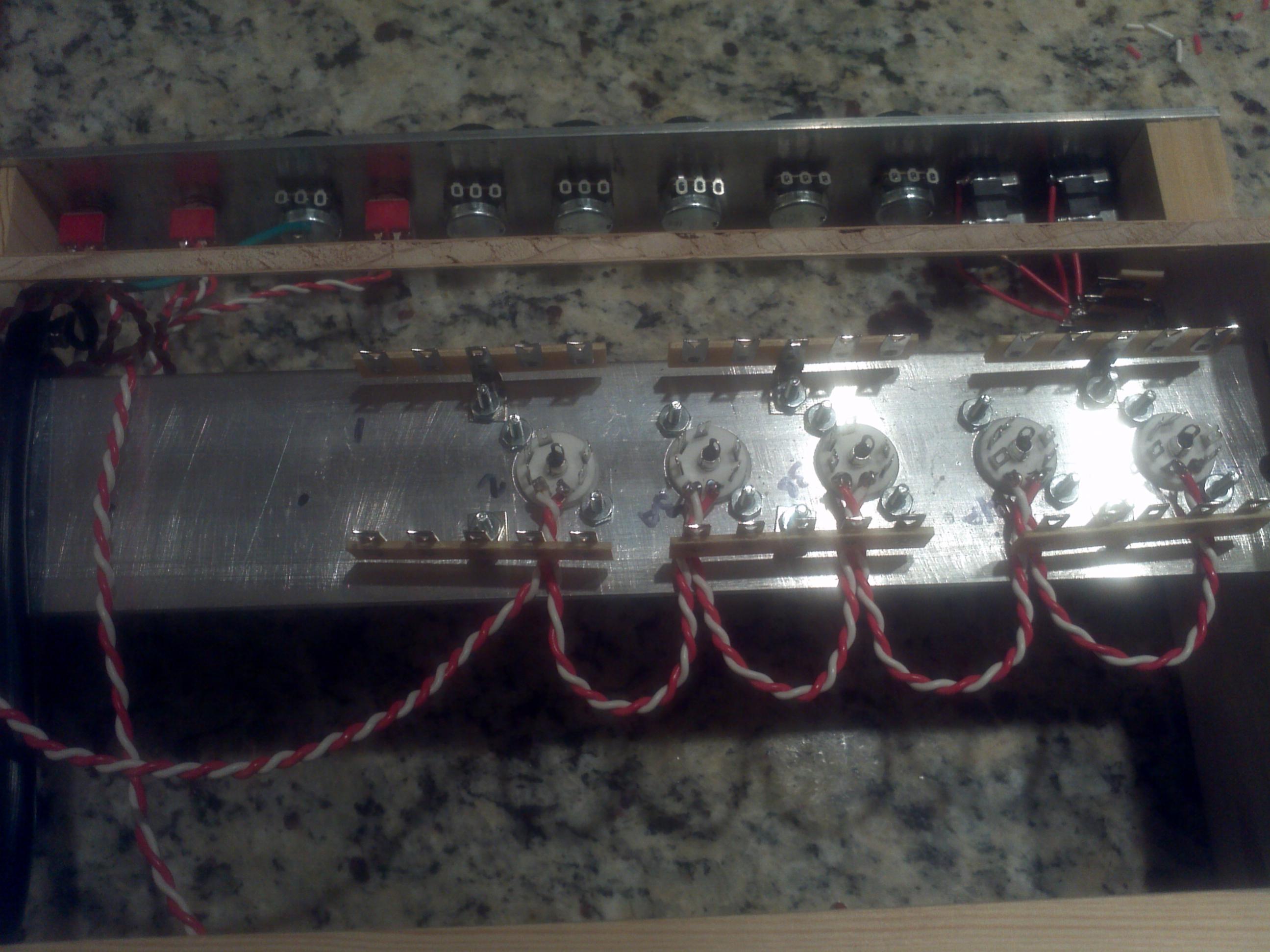

Transformers arrive later this week so I started wiring this amp. Here's the power supply caps and dropping resistors and a picture of the power,standby, and overdrive switch and LEDs. I use spare switch contacts as a terminal point for the LEDs. Power comes in the bottom and out to the LED from the middle. The LED lands on the top and then the return is from the top terminal. This way I don't need to add a terminal strip at the front panel and the wiring remains nice and neat. The LED is on when the switch is in the up position.

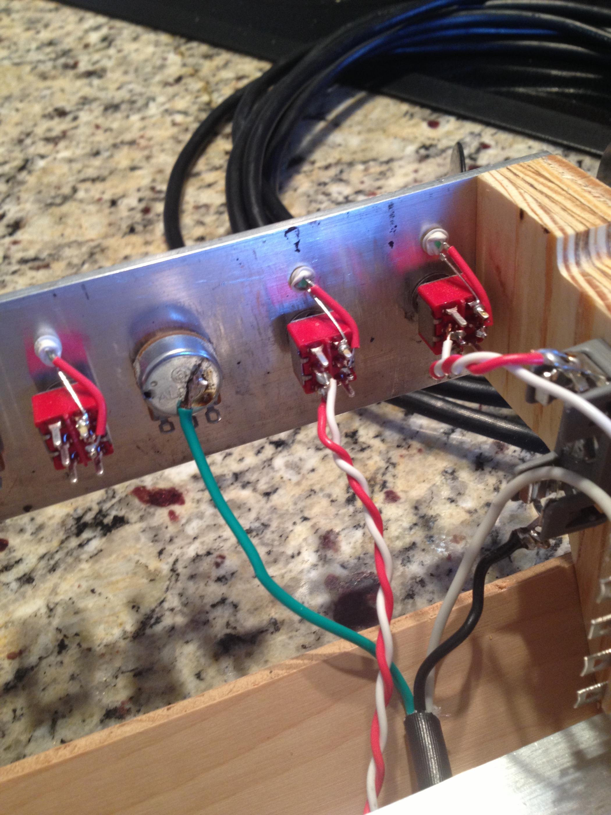

Worked on the LED wiring. A few zip ties will clean it up nicely. Also got the filament wiring done. The terminal strips for the LEDs, filament/pilot lights, fuse block are all on the left side of the amp. This is the "dirty" side and is furthestbfrom the audio amplification/signal.

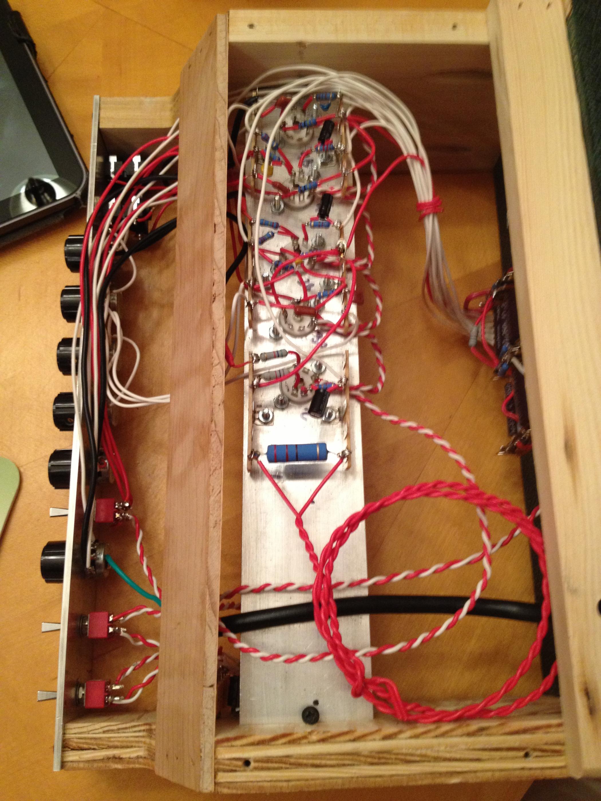

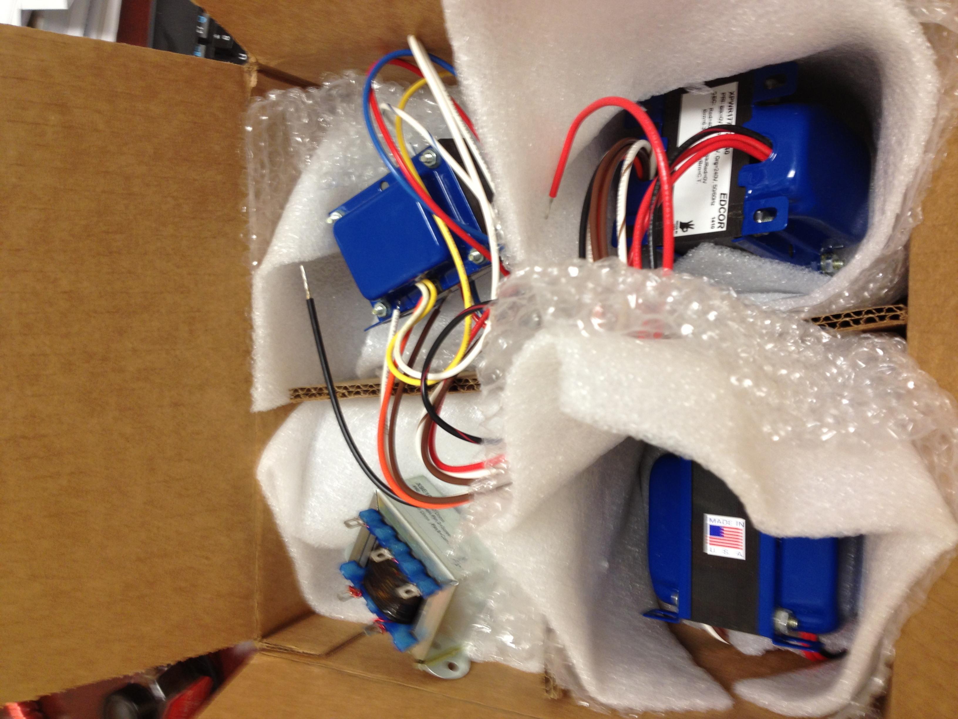

Managed to get it about half way wired in about one and a half hours tonight. Will get the rest wired later this week. Also heard from Edcor today. They're running a little behind and should ship the iron next week. Still, 7 weeks lead time for the significant savings Edcor offers isa great deal any way you look at it.

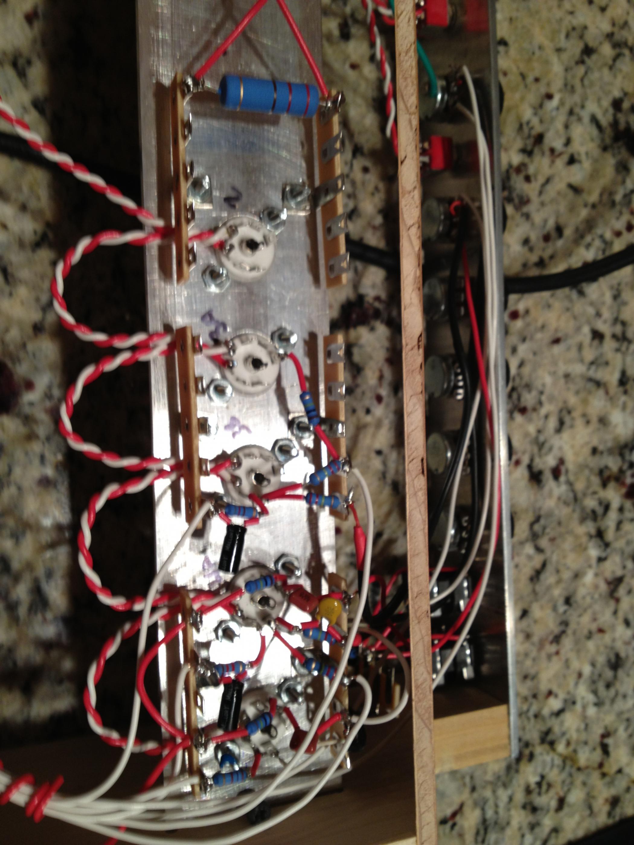

Aside from mounting and wiring the transformers, this amp is done. I expext the transformers to arrive next thursday or friday and I can hardly wait. The first pic shows the overall wiring. The second pic shows the power supply. All those white wires are the various grounds connected to the star ground. hopefully, this amp will be silent until i command it to be crazy loud and distorted.

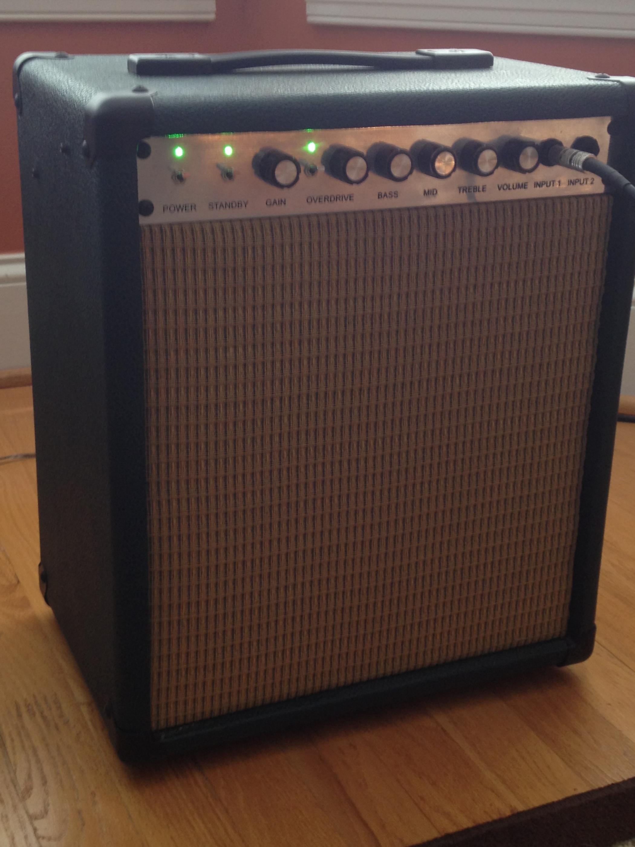

It's alive. 6av6 seems a bit microphonic and this amp squeals from the microphonic feedback with gain and overdrive all the way up when the volume is aboveabout 70%. Not sure what to do about that yet. Suggestions?
