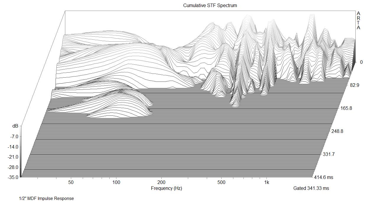

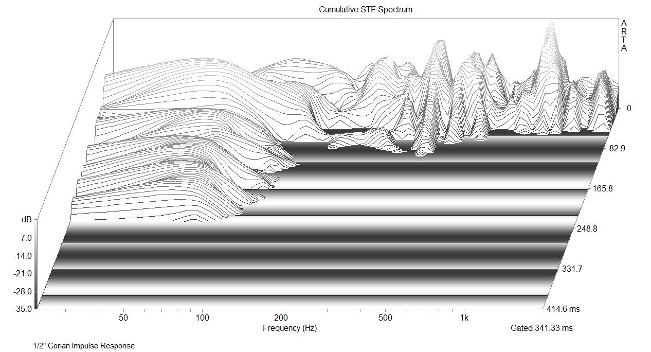

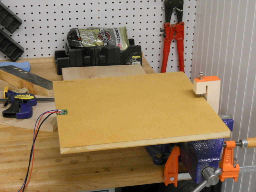

Materials

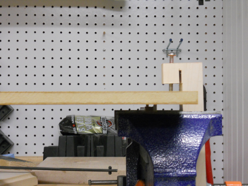

The materials I investigated were MDF, aluminum, granite and Corian. Aluminum and granite are approximately the same density, but granite has higher bending stiffness. MDF is neither dense nor stiff, but is said to have good damping characteristics. Corian is less dense than aluminum or granite, has a lower Young's modulus than the two, but is still quite stiff (but not too stiff) and measured nearly the same as MDF for natural damping.

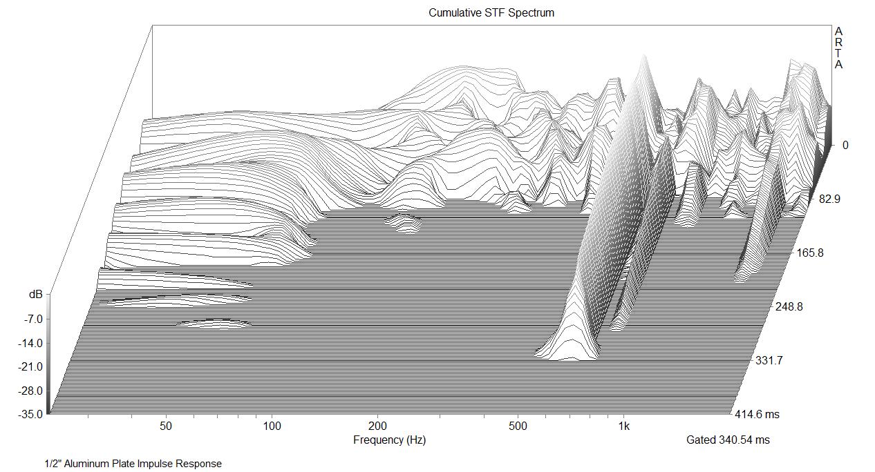

I created a jig to measure the resonant frequency (Fr) of the materials. All of the materials were approximately 1/2" thick and cut into 1 foot square panels. If the material is held tightly or coupled to another object (platform, vise etc.), the natural Fr of the material will be damped, so the jig has 2 points below the panel for support and one adjustable point (to keep the panel level) above the panel. A 3 axis accelerometer is firmly attached to the edge of the panel, the panel is placed in the jig and excited into resonance by dropping a golf ball onto the center of the panel from a height of 30 inches. The output of the accelerometer is connected to my laptop running Arta software which can record and graph the time domain, frequency spectrum and cumulative decay response of each material.
As expected, the aluminum and granite showed the lowest deflection at low frequencies due to their inherent stiffness. They also rang like a bell at the resonant frequency (621 Hz for aluminum, 708Hz for granite) and for sustained periods. The aluminum plate also produced an audible ring at high frequency (I'm guessing higher than 5kHz which is outside the range of the accelerometer) for almost 4-5 seconds after impact. Both 1/2" aluminum and granite panels have similar computed critical frequencies of ~1kHz, so not a lot of separation between Fr and Fc, where mass will have a positive affect.
The MDF and Corian had similar Fr which were much lower than the other two materials. MDF Fr was 398 Hz and Corian was 416Hz. Both resonances produced lower amplitude responses and were much shorter lived than aluminum or granite. Corian has a computed Fc of 2150Hz. I didn't compute the Fc for MDF, as I couldn't find all of the parameters needed for the material and it will be used as a damping layer rather than the stiff outer layer.

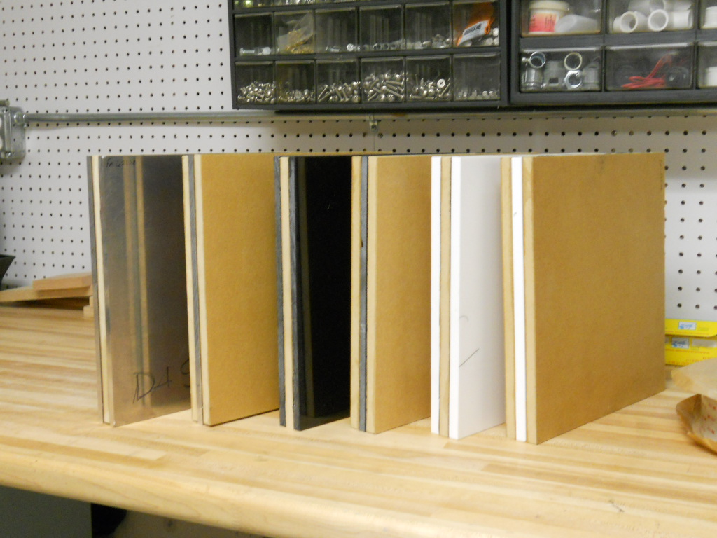

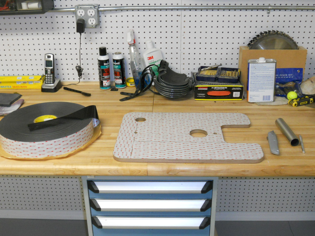

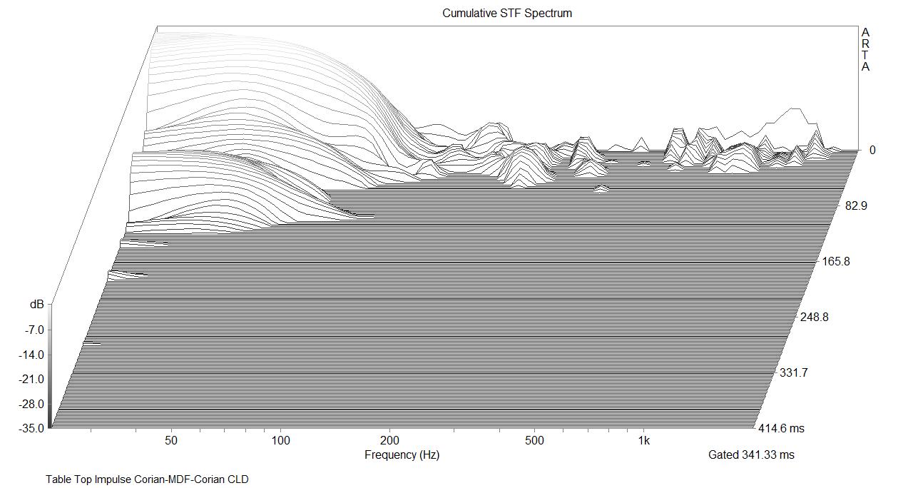

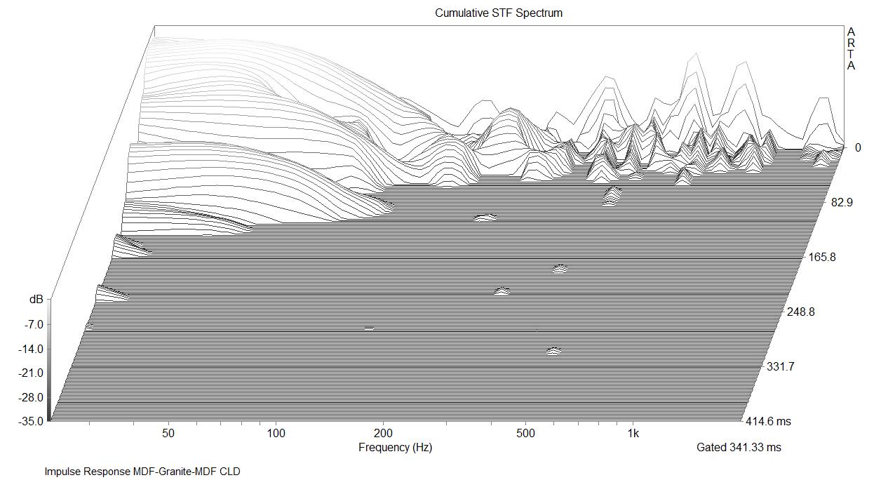

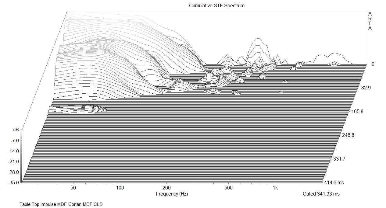

Layers

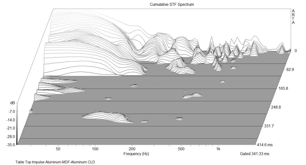

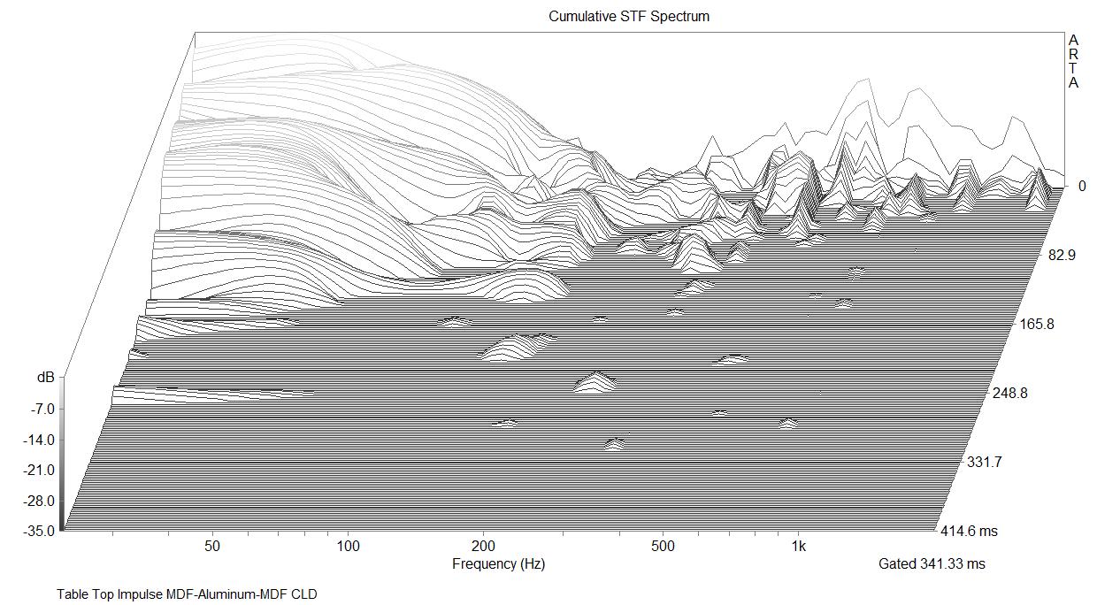

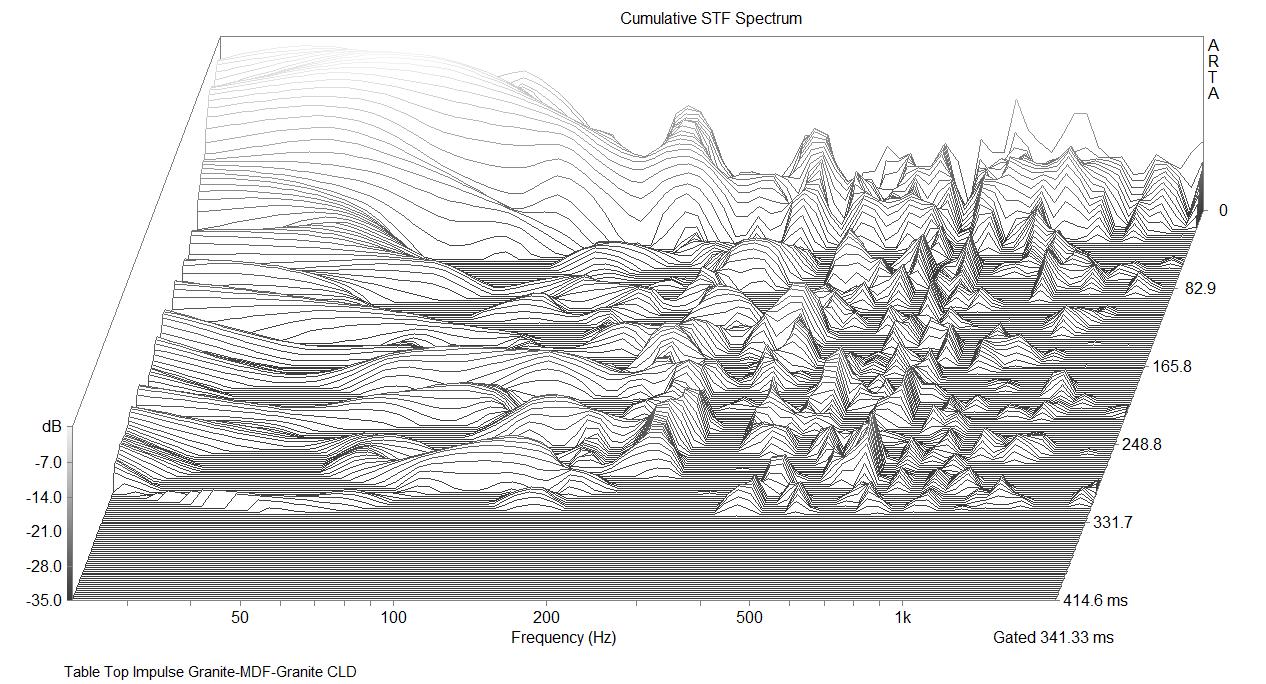

I cut three 1 foot squares from each material and created two constructed layers for each of the stiff materials (aluminum, granite and Corian), layered Stiff-MDF-Stiff and MDF-Stiff-MDF. The visco-elastic layer between the panels is 3M VHB double sided tape. The tape is thin (40 mils), very elastic, high sheer strength and very high bond (VHB) strength (they use these tapes to replace screws on trucks and boats), so it meets all of the requirements for the connecting layer. The tape bonds well to smooth hard surfaces like aluminum, granite and Corian, but not so well to MDF. I sealed the outer skin of the MDF with a 2 part epoxy sealer from Smith Systems (CPES), which bonds extremely well to wood and provides an epoxy like surface for the VHB tape to bond to. The VHB tape achieves better than 90% bonding strength after 24 hours, so I tightly clamped all of the composite layers together between 2 slabs of granite using multiple wood clamps for a day.
I measured the impulse response of the composite layers by supporting them on 4 posts, similar to how they would be used as a plinth. All 6 composite layups measured markedly better than any of the single materials, but the clear winner was Corian-MDF-Corian. The vibrations were lower in amplitude and much better damped than any of the other combinations. Not surprisingly, the aluminum and granite composites were the worse, with the granite-MDF-granite showing some surprising oscillations (low amplitude but poorly damped and with a wider bandwidth than any other combination). Also telling was that MDF-aluminum-MDF was worse than aluminum-MDF-aluminum, although this was predictable as MDF-aluminum-MDF is not a true CLD construction.

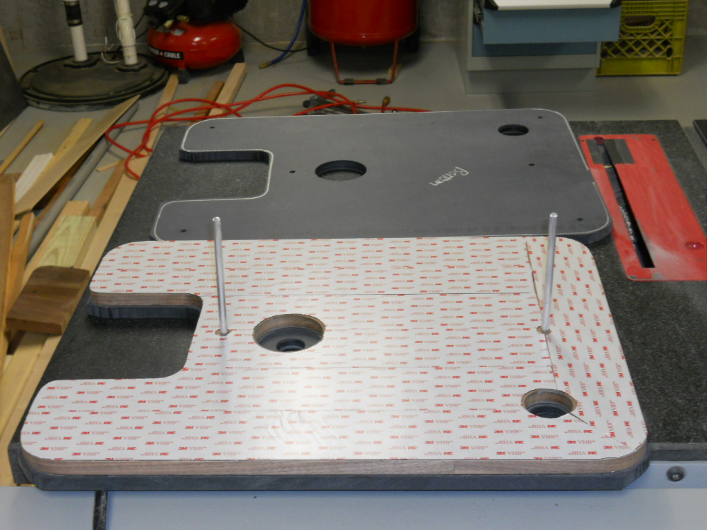

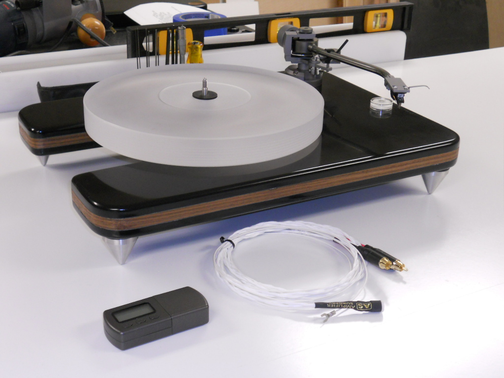

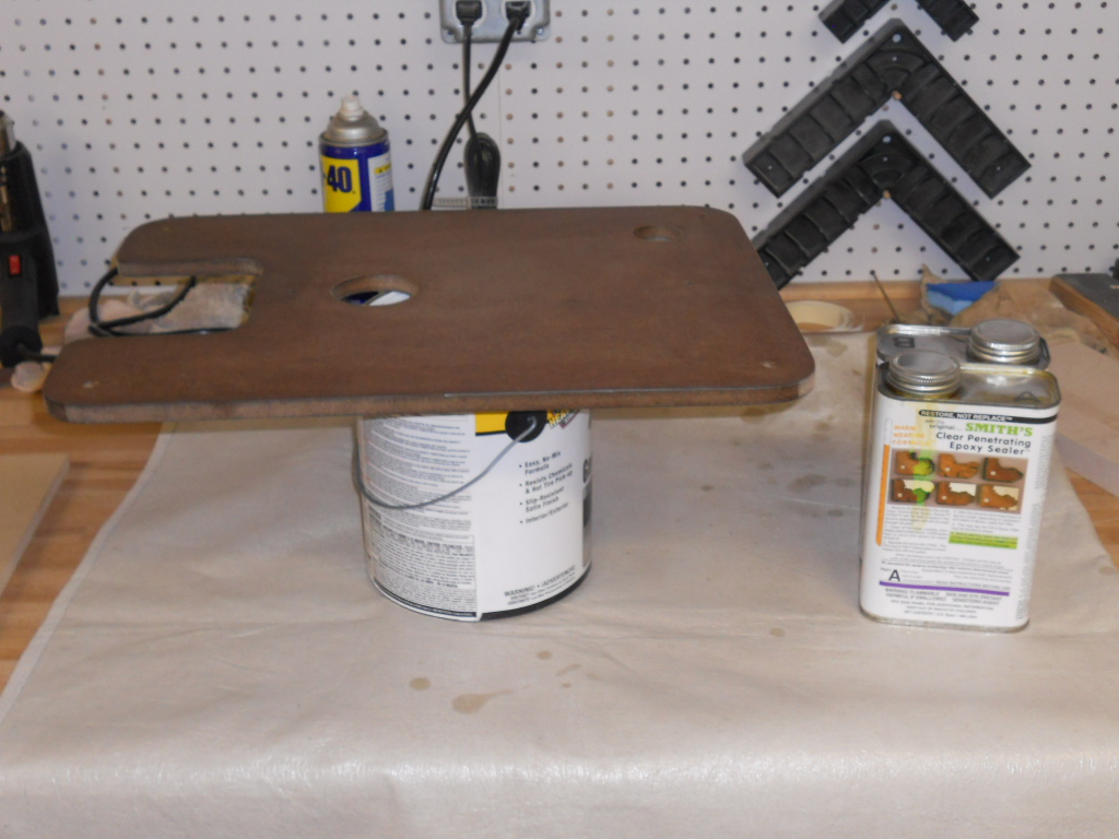

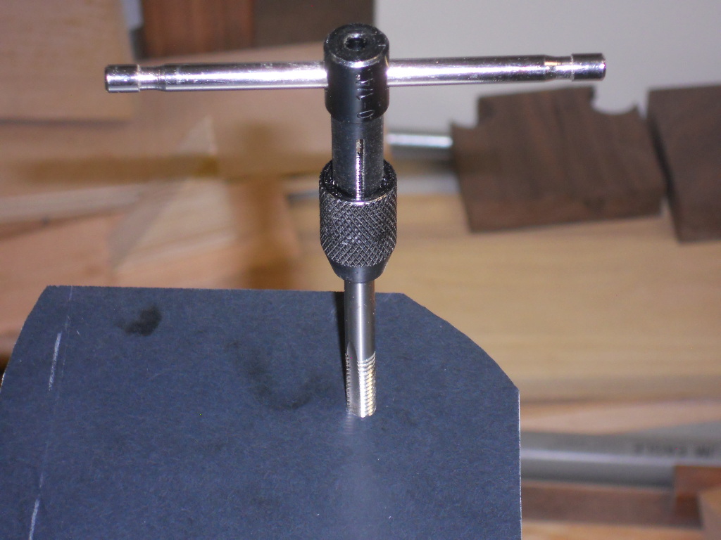

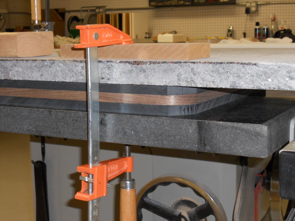

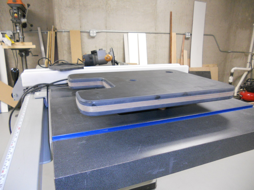

The plinth
I cut the center MDF panel to size first as it is the easiest material to work with. I cut the Corian panels slightly oversized and will trim them flush with the MDF layer using a flush trim router bit after they are bonded to the MDF. All of the holes are cut in the panels and threads tapped for the tonearm mounting screws (Corian machines very well with standard woodworking tools). The platter bearing and tonearm holes in the top layer are properly sized for mounting each, and the holes in the other two layers are oversized to isolate the platter and tone arm hardware from the damping layer and the bottom stiff layer. The threads for the feet are in the bottom layer only and are isolated from the damping layer and top stiff layer. I drilled 2 alignment holes through the bottom and damping layer and only part way into the bottom of the top layer. I will use two 1/4" aluminum rods to align the layers as they are put together with the VHB tape.
The MDF is sealed on all sides using Smith Systems CPES. It take several days for all the VOCs to outgas and for the epoxy to cure properly. I attached a thin walnut veneer to the outside edge of the MDF; the veneer has a hot glue layer attached and is melted in place using a clothes iron. The VHB is attached to both sides of the MDF layer, then the protective layer of the VHB tape is removed from the top side and mated to the top layer of Corian using the alignment rods. The bottom protective layer is removed from the VHB tape and the mating bottom layer of Corian is put into place. With the alignment rods removed, I clamped the composite structure between two layers of granite for 24 hours until the VHB tape achieves maximum bonding strength.
Next, the excess Corian is removed with a flush cut trim bit in a router so the edge of the Corian is flush with the walnut veneer layer of the MDF. The edges of the Corian are eased with an 1/8" round over bit in the router, both top and bottom layers. All of the routed edges are smoothed with 220 grit sandpaper and the plinth is ready for the final polishing. I opted to send the plinth to my local counter top fabricators for polishing and they did an excellent job of it.

Well first off I must say that it looks wonderful, but as Bon said, not convinced its CLD in the academic sense. Having looked at the audio qualia site it does appear that they missed the question that needs answering, which is what needs damping in the first place. Damping is not isolation and I think a lot of the confusion out there is that people are not sure when you are damping and when you are isolating.
Doesn't stop it looking great though which will do more for SQ than anything else

This is excellent work and a marvelous finished result. Congratulations!
Couple questions:
After the walnut veneer was affixed, how was it sealed (oil, polyurethane, etc)?
How was the veneer protected during the corian polishing procedure?
I sealed the veneer with Tung Oil after it came back from the finishers. The veneer is 40mils thick and any additional sanding was very light. I believe they protected the veneer with tape for the final polish which is done with a liquid compound.

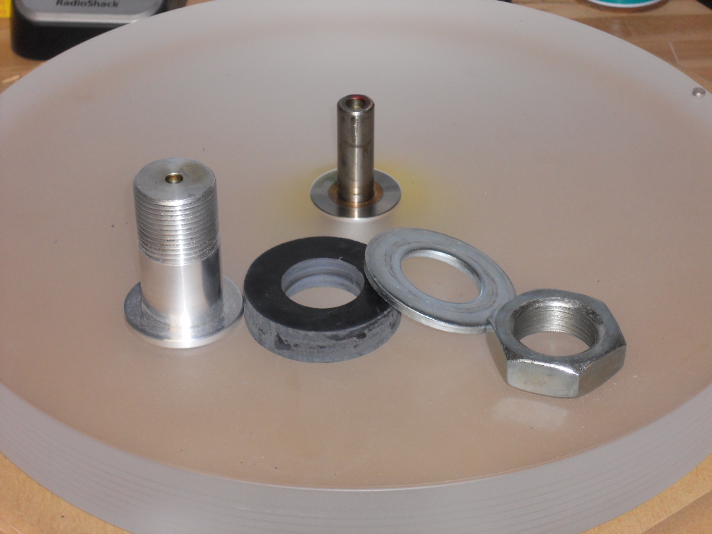

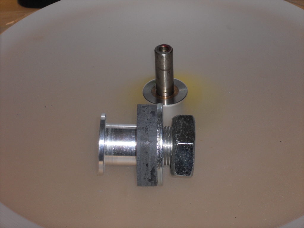

I was getting ready to assemble a my VPI clone, Acrylic, Alum, Acrylic and saw this...just in time? Out goes the Alum and in goes the MFD. Question, I have the VPI large 4" puck/donut that attaches to the bearing body with a cap screw through the center. Are you using that or some kind of sleeve, due to the length of the bearing body?
I did intend on EAR IsoDamp between layers, not through bolted in any way and "donut" attached to the bearing body and top layer only. Maybe I'll try the 3M foam tape instead. It's got to be cheaper than the EAR material.
I made a 1/2" thick doughnut out of Corian for a spacer on the bearing mount. It is the same diameter as the washer.
The 3M tape was ~$110 for the roll (72 yds x 2.5").

Hello pyramid, good work there, just one of the very few who is able and willing to put in some investigative work, rather than leave it to subjective means, or worst still, build and hope.
However, I would point out a few things. Your test rig clamps one edge, and you are measuring with your accelerometer on the opposite edge. If you are dropping your golf ball near to the middle of the test piece, only transverse waves are going to reach your accelerometer (at higher frequencies), which, if it is like some of mine, have a limited bandwidth in the Z direction compared to the X or Y directions. This may be the reason for the higher than expected fundamental resonance frequencies. My calculations give results about an octave lower than yours, although F1,2/F2,1 and F2,2 are in agreement with your loverly waterfall graphs. You may like to use something harder than a golf ball, I use steel balls. The driving point impedance may affect results.
I would agree that the materials tested fall into two groups, (aluminium/granite) and (mdf/Corian), although none have any damping to speak of, on their own.
I must agree with Bon about choice of materials, although one manufacturer of after-market parts for a very well respected turntable design sent a piece of a composite made from two of the materials you tested, and it performed quite well. Also, as Bon has pointed out, your construction is not cld. I think you have fallen into the same maelstrom as the manufacturers you have maligned. Cld is applied to a (thin) vibrating panel, and consists of a thin viscoelastic material, constrained by another thin panel, usually made of the same material as the vibrating panel, but certainly no stiffer than it. Your construction is a glued laminate or glulam, as it is known in the trade. A vibrating panel with a damping layer applied is called extensional damping, and is not as good as cld.
As you point out, suitable materials for plinth duty seem to be very expensive/hard to source or require extensive work. Because of this, I have headed in another direction and I am currently looking at laminates (mainly plastics) and modified wood. The wood I am using is either oak or idigbo, and it is being modified by various liquid preparations, maybe like a poor man's panzerholz! although synthetic resins are not involved.
However, with your glulam construction, losses should be around the 30-35dB range, Fr about 375Hz and Fc about 1122Hz, so a bit of useful mass losses. I'm assuming a damping factor of 0.2, any less, and your loses will not be as good, maybe 5-6dB worse for DF of 0.1
HTH
