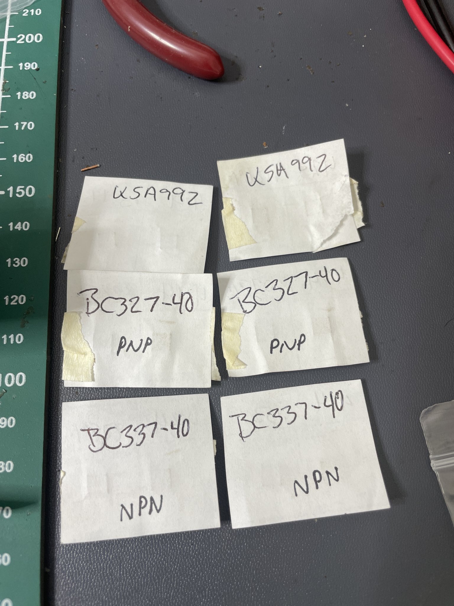

Hey guys,
I needed some help with the build I’m almost done it.
Where must these go I’m very confused. I got the entire component kit.
The build guide says,
Q1&2 - bc559 , (is BC-327 alternative)
Q3,4,12,14 - bc549 (available)(is bc-337 alternative )
Q5&6 - KSA992 (available)
Please refer to the image below (components for pair of boards)

Got them from @fireanimal. They are replacements for bc549 &559. Got it cleared thanks
