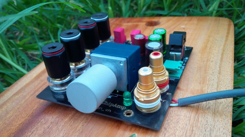

Hi everybody !
I noticed Altmann's Byob Amplifier is really well known, so I made myself an amplifier in my own style.
Sounds really great

Its not going to sound good unless its on plank of wood...and wood has to be treated with special laquer
Can you be more specific? I'm sure it's important.......

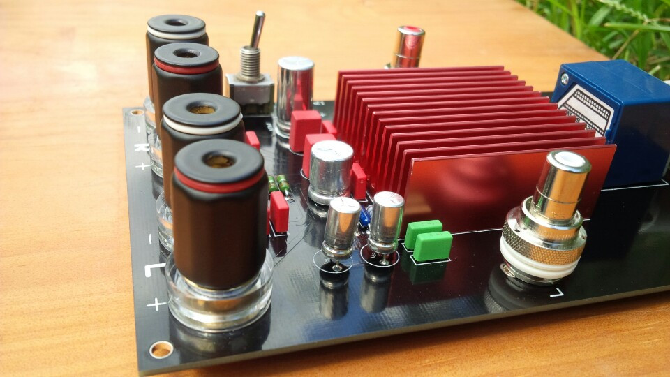

what IC chip?
Toshiba?
Circuit can use KIA6210AH & TA8210AH.....
It's very pretty. I don't know much about special laquer, but I will say I've built a few wood chassis for amp, DAC, preamp, etc.
I like getting birch ply project panels at homedepot. I like the look of a plywood edge that is rounded over with a router, and finished nicely. Matches the 13 ply Baltic Birch that I like to use for speakers too.
Anyhow, point is ive achieved impressive looking results with a high gloss spray clear poly uerothane. It takes me about a week, to prep, spray, dry, (next day) sand, prep, spray, dry (repeat next day.). Super important to have a low dust environment, and use tack cloth just before spraying. Several thin coats, elbow grease, patience and time. Certainly not difficult, but takes a while.

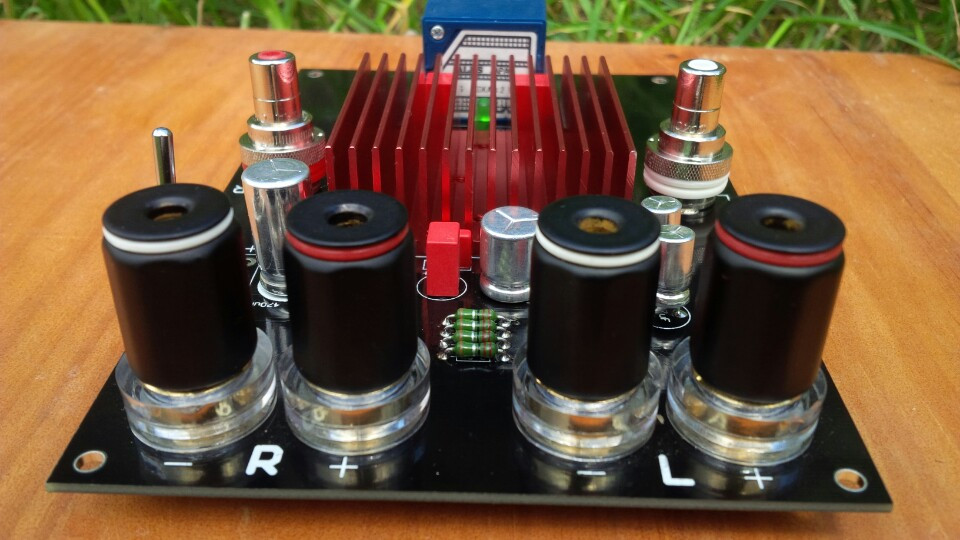

That is beautiful. What kind of power supply are you using?
I use a battery supply, Voltage 12-17VDC.
