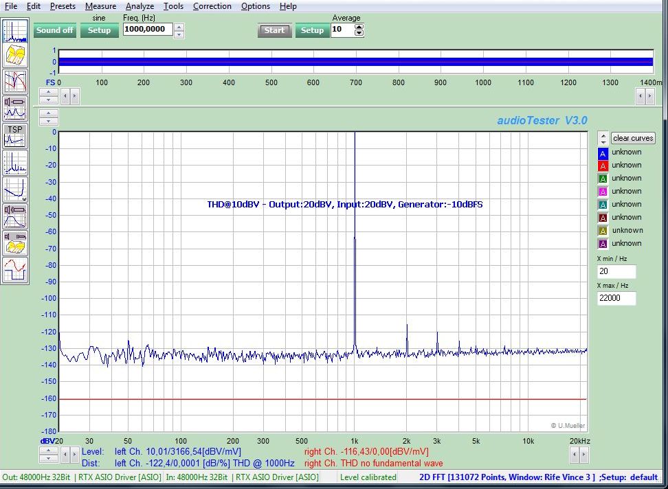

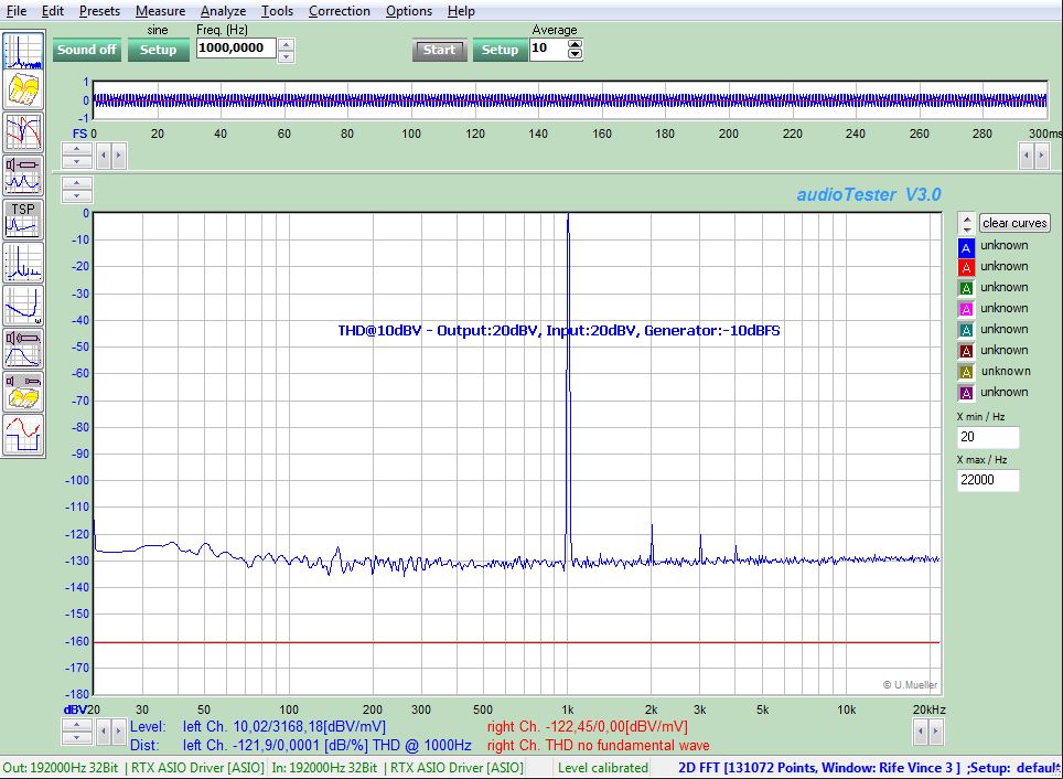

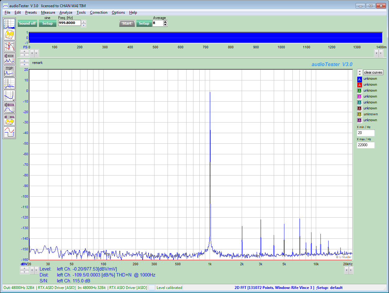

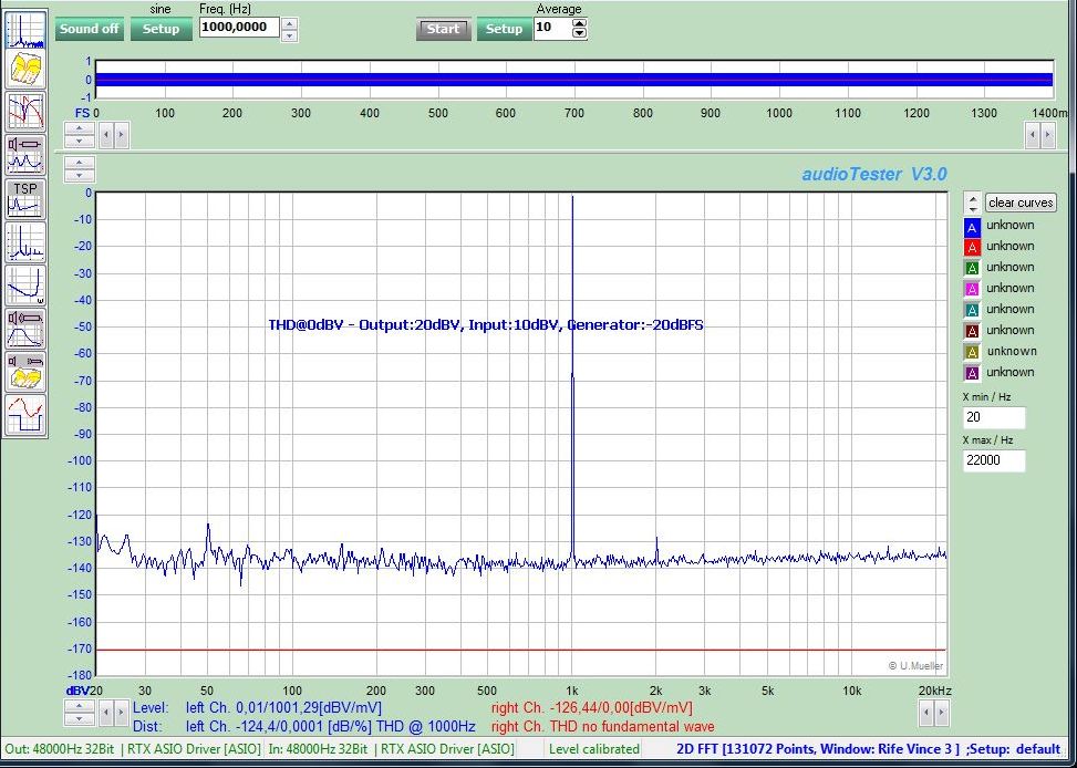

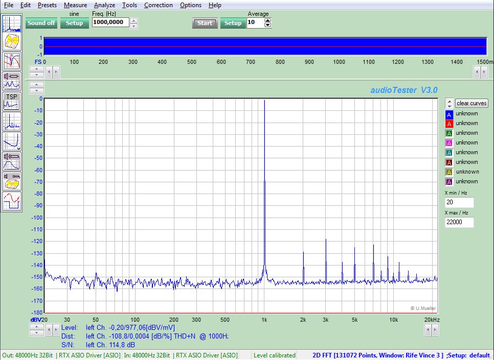

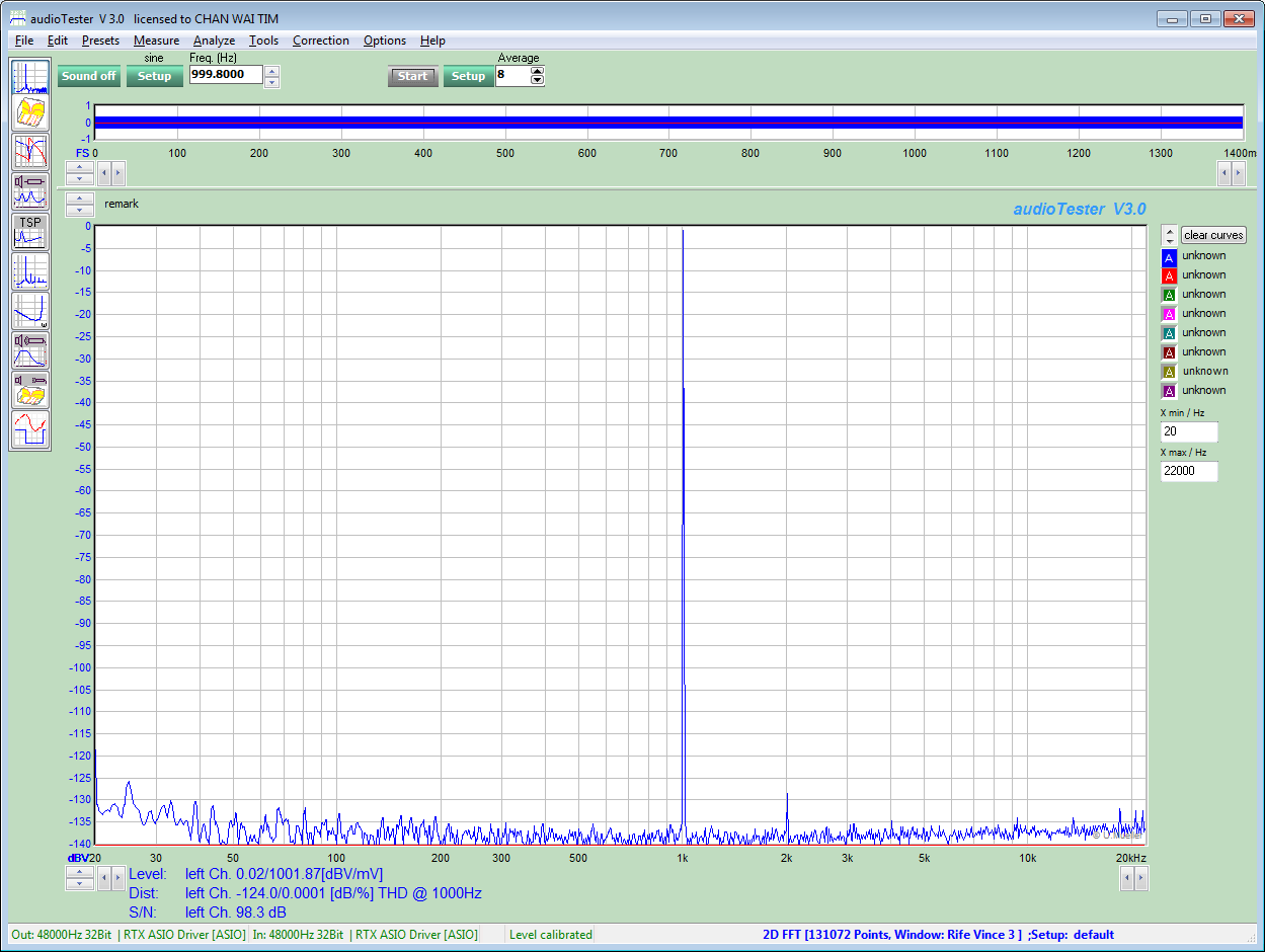

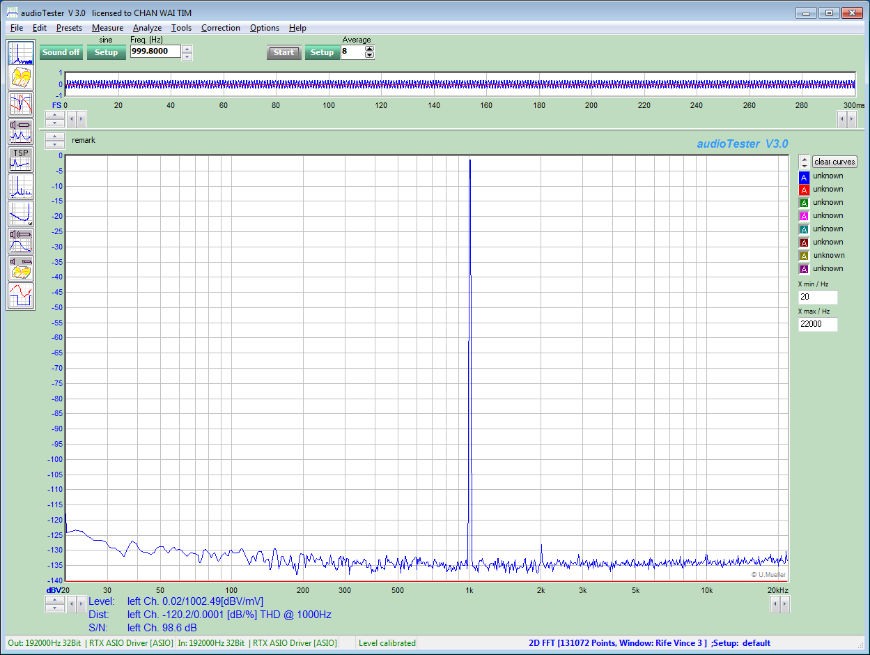

On the specification page of the RTX6001 unit there were mentioned figures of THD, THD+N, seen on the attached jpg. I assume that these measurements have been taken using audio-Tester V3. Would you please define the full setup applied to the SW and the unit of receiving these results?

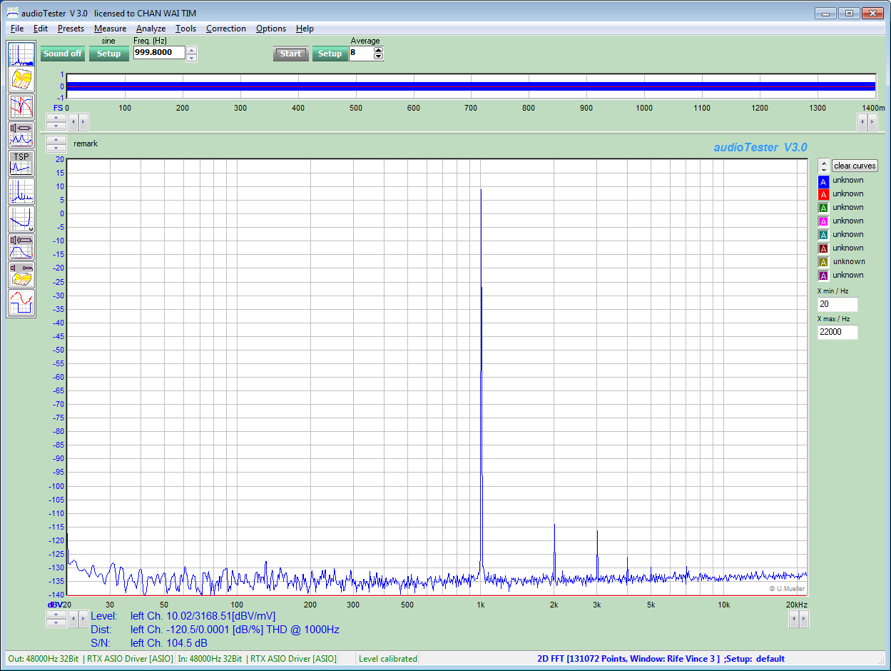

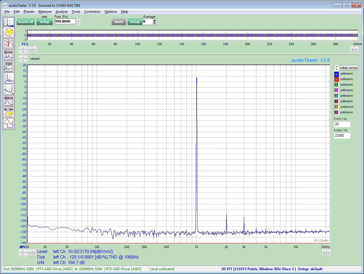

Try the following (make sure your calibration is correct for each Input position):
- THD@0dBV - Output:20dBV, Input:10dBV, Generator:-20dBFS. I get -124dB@48k and -120dB@192k (left channel)
- THD@10dBV - Output:20dBV, Input:20dBV, Generator:-10dBFS. I get -120dB@48k and -120dB@192k (left channel)

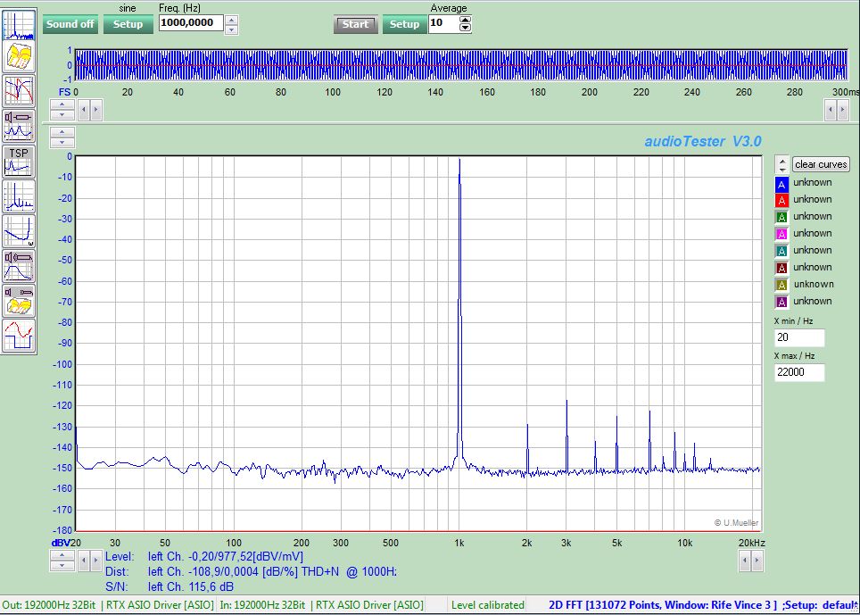

- THD+N@0dBFS - I find it strange the THD+N is specified for 0dBFS, cause 0dBFS will have high distortion whatever the attenuator position. But the THD+N spec of -107dB is easily reachable with Output:0dBV, Input:0dBV, Generator:-0.2dBFS. I get -109dB@48k and -109dB@192k (left channel)

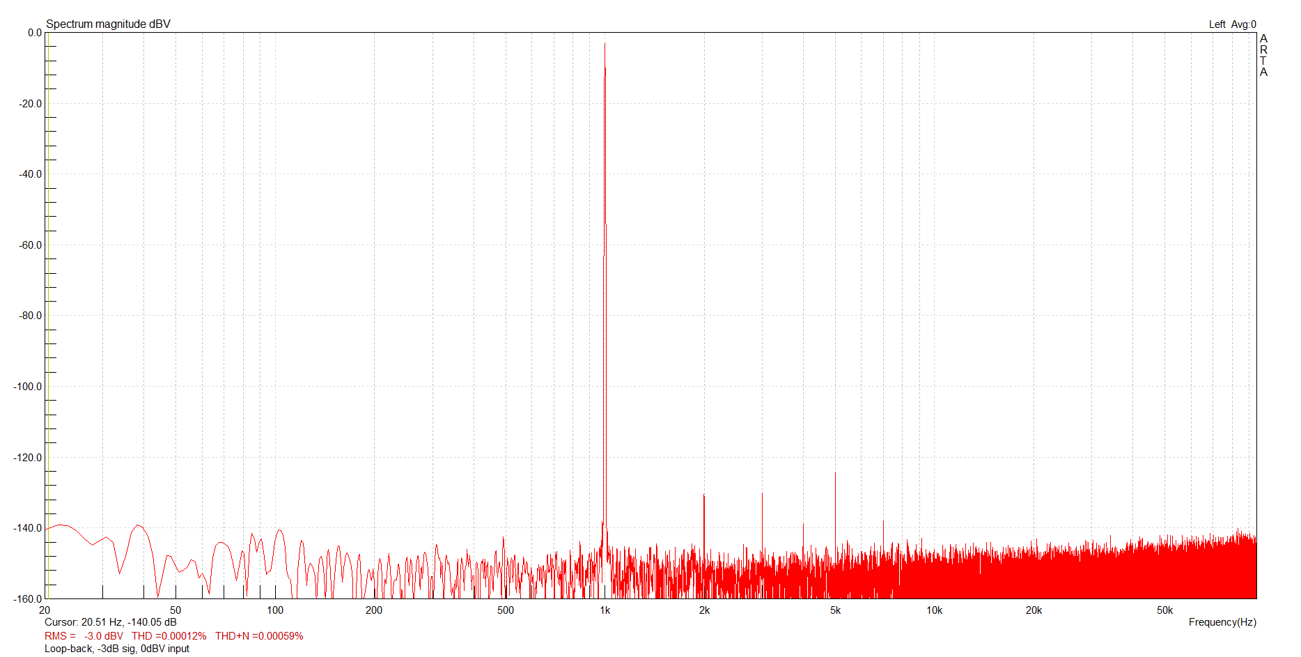

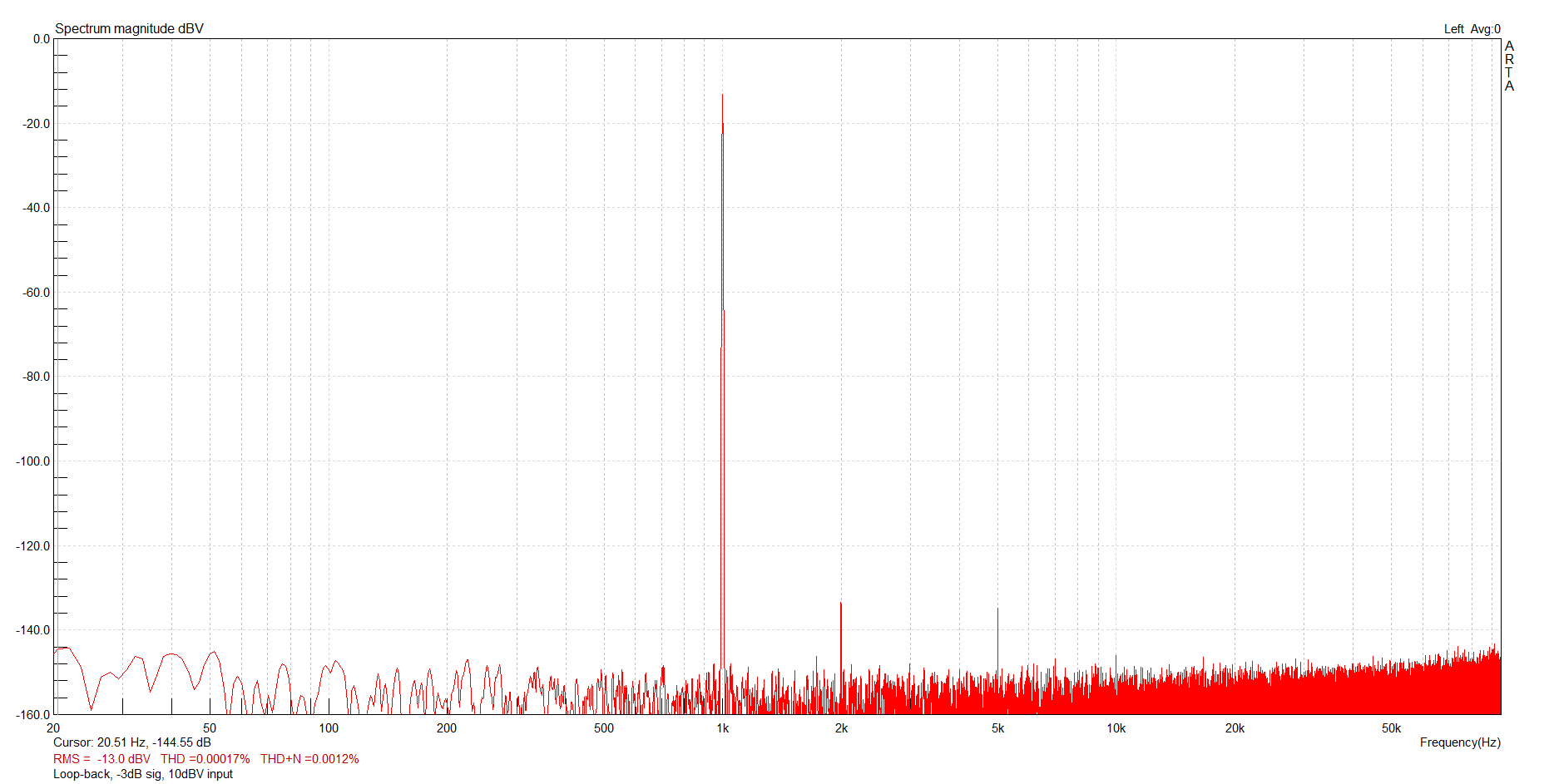

If you only display the vertical scale in dBFS, there is no need to calibrate at all, dBFS is by definition relative.
Calibration is required, when you display the vertical scale in dBV (or dBU, ... etc.), and a different calibration value is required for each attenuate position, or else you'll get wrong values.
OK, I accepted it but the same happens and with dBV scale!
For example, I feed the left 0dBV input with -3dB signal at 1dBV output. This signal is 707mVrms.
If I calibrate the ARTA input with this value (707mV) and press the "Estimate" of input, then I will have a capture with the level threshold of -3dBV. I think this is OK, because the feed signal was -3dB.
If I returned the input knob to the 10dBV I will have -13dBV, that it is right...and so on with other scales.
Am I right or something has gone to my head?
My right channel is always 2-3dB worse than the left channel.
I have nothing to add to your suggestions. The graphs speak for themselves.
My channel difference is at them most 1-2 dB.

... because the feed signal was -3dB ... If I returned the input knob to the 10dBV I will have -13dBV, that it is right...
If you use a DMM to measure a known 707mVrms (-3dBV) signal, and the DMM reads 0.223mVrms (-13dBV), what would you think?
And it seems you're OK when RTX+ARTA does exactly that.
... something has gone to my head?
Apparently despite changing the vertical scale to dBV (which is absolute), your mind is still thinking in dBFS (which is relative).

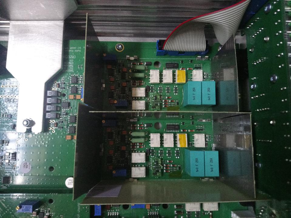

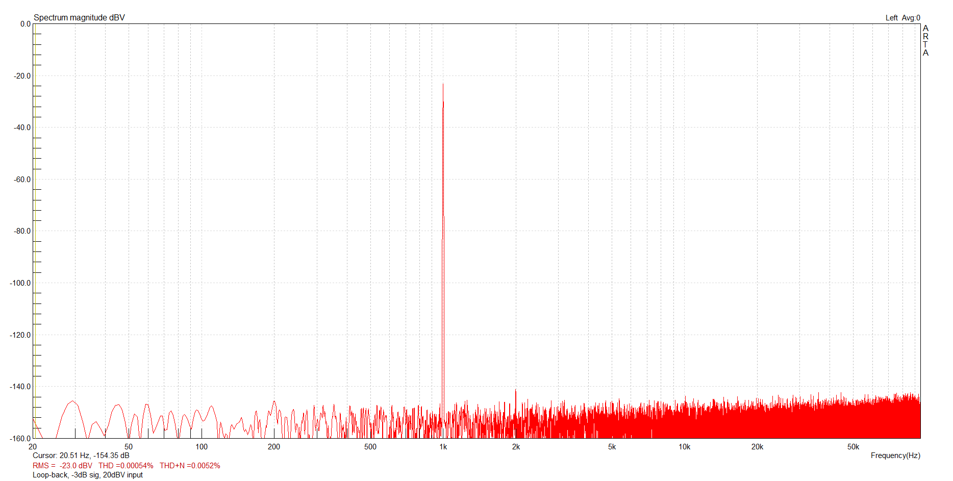

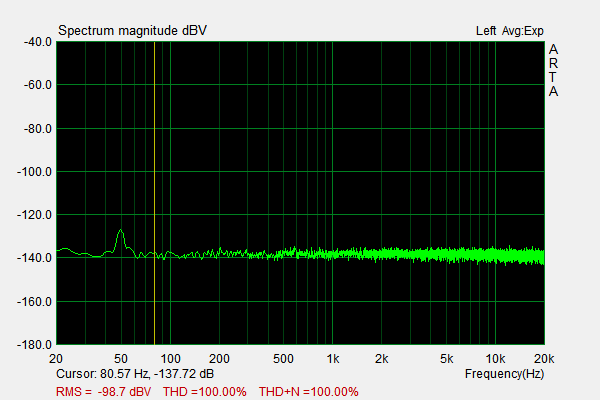

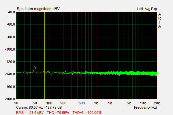

Hello peeps, like you guys, I was somewhat frustrated with crosstalk issues despite Jensh's really great work. Excellent for single channel measurements. Used some 3M Ultraperm tape I had lying around.
Heres a measurement, sadly I forgot to screenshot the before measurements but you guys can measure that. I guess the next work is to try to reducing power supply harmonics somehow but I ran out of tape.
1st pic Setup is
Left input no input set to 0dbV
Right input connected to Right Output
Both Outputs putting out -3dbV signal
2nd pic Setup is
Both Outputs putting out 17dbV signal
Both are measuring the Left channel(worse case) inputs
Theres still some crosstalk which would be from the chip as Jensh has covered but its worth trying as others have done.

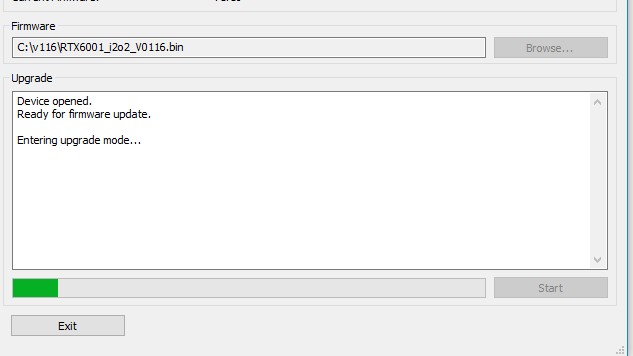

A new Firmware V1.16 is now available at the RTX download center:
Download Center - RTX
Download the zip file to a local folder. Unpack the zip file to the folder and run the rtxusbaudioDfu.exe. In the update program window browse and select the RTX6001_i2o2_V0116.bin and press the "Start" button. The firmware update should be finished within a few seconds after pressing "Start".
You need a Windows PC for this.
There is also an attenuator control program in the package, but you don't necessarily need to update that.
The generator audio signals now have the correct polarity.
It should also fix the issue described in post #1859, where sometimes the unit will not be recognized by the PC.

About 2-3"? Update, I think I need more time to ascertain the effects of shielding, since the crosstalk is back after warmup but it is still 10db improvement.
Thanks!
I have made a shield design, which I hope to be able to offer as an upgrade soon.

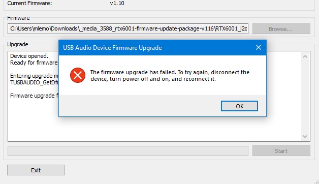

JensH, I can't to upgrade.
The procedure hangs almost at the beginning and the final I have an error message.
"TUSBAUDIO_GetDfuStatus: Function failed with error code 0xEE000003"
I tried it with 2 PC.
