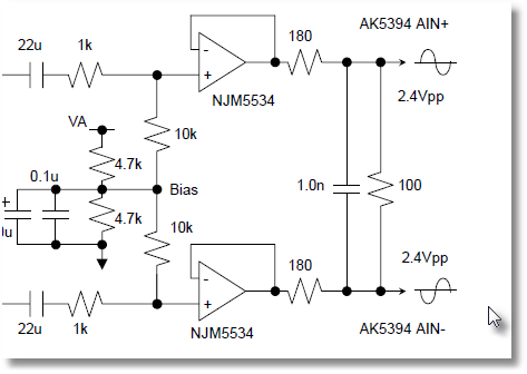

Your given graph from the AK5397 looks like as from AK9394A datasheet (blue line Figure10) on page 21 figure 11 ....
In other words: Is this a question of the used input circuit???

I think that the difference between figure 9 and figure 10 is the common mode distortion of the 5534 in figure 10. The noise level of that circuit is lower than the noise in figure 9 though, which probably explains why the lines are crossing at approximately -13.5dBr.

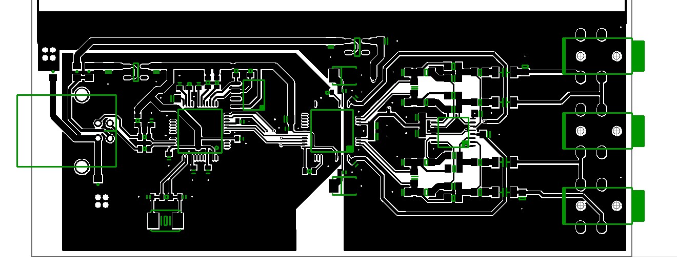

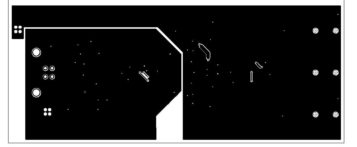

A have designed a small PCB with the AK5394A + discretes, a couple of voltage regulators and a divide by two circuit for the clock (to get 12.288MHz instead of 24.576MHz). I expect to receive it in around two weeks from now. I plan to disconnect the AK5397 on the main board and connect the AK5394A board instead.

Reading the latest AK5394AVS.pdf
Just compare the measurement for figure 9 & 10 (page 19/20) and also compare the used ADC driver circuit..
they are not equal :D and still using the old 5534 :eek:
On Page 21 are the measurement figures regarding figure 9 & 10

of course they are not equal, but to me the question remains how and why they are unequal.
As I wrote earlier:
If we assume that the NJM5534 is equal to e.g. the NE5534, then this could be the explanation.
The common mode distortion of the OP275 is not impressive either. But since I don't know the schematics of the Lynx it is difficult to say whether this is of any importance in this case.
See Samuel Groners excellent paper "Operational Amplifier Distortion".
Unfortunately the LME49990 is not included in his paper.

The AK5394A add-on boards are on their way from the far east PCB manufacturer. They should be here in a week from now.

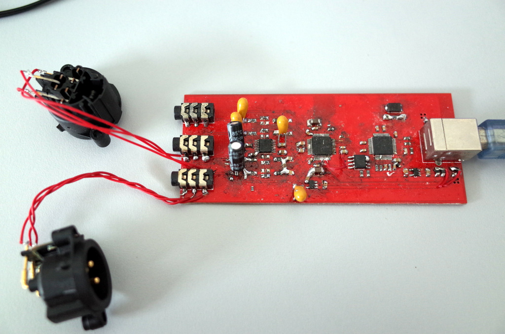

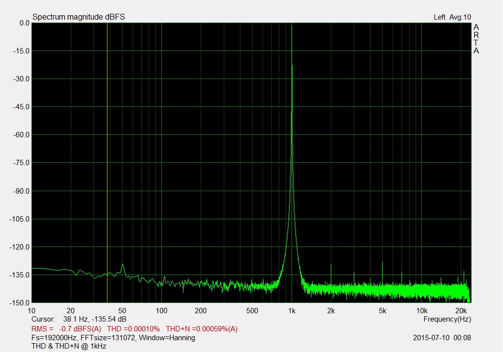

Here is a ugly little adc from me to measure my daily task.
THS4532 1 x
PCM4222 fixed 48khz
SA9027 UAC1.0 fixed 48khz
No isolation
1.2Vrms input at 0dBFS.
Zin a bit low (considering the source signal meet the INres-FBres-opamp output) :eek:
No another opamp to drive Vcom
Down side
Reading fluctuate every few tenth seconds, no idea why :bomb:
Reading take from
FW Compensated ES9018AQ2M, OPA1632 I/V, OPA1632 Buffer.
P/S, i am waiting QA405 to replace my test bed too.

Here is little things i realized during prototypes.
Separated ground plane returns to one starground yield better results, better than pouring one whole even undisturbed ground plane for a board.
Ferrite beads for terminating digital ground plane & Vbus
Inductor for terminating analog ground plane & Vbus.
Might be helpful might be not, I have no proof in this, but at least doing all this make my ADC measure better. :shy:
