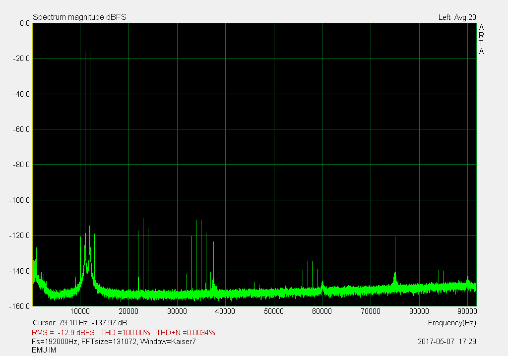

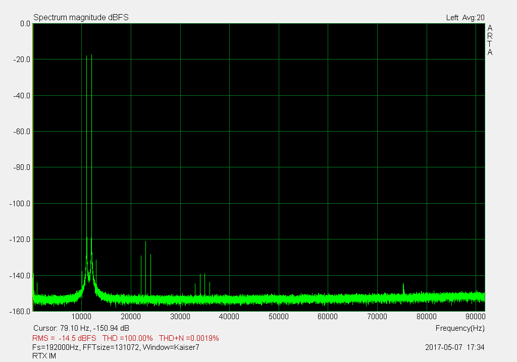

Here is a plot showing the IM performance of the RTX. I'm using my set of Victor oscillators. They are all separately battery powered. This is 11.2 KHz + 12 KHz. First is an EMU 1212M with opamp upgrades, second is the RTX. Both use the same ADC. Clearly the analog circuitry on the EMU is not giving the AK5394A its best. The RTX performance is exceptional.
