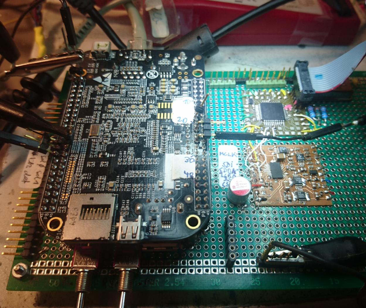

I'm just playing with the LT2500-32, connected to a Beagle Bone Black.
Had lots of problems to make the BBB work with the SPI interface; The CPLD
that creates the sampling clock from 100 MHz then had just enough resources
to make a 32 bit USART + mux , so I now read 4 bytes via the parallel register
interface. The SPI of the BBB would not have supported the full 1 MSPS anyway.
The register interface is taken care of by one of the 2 PRUs, extraneous 32 bit RISCs
with predictable latency and 5 nsec per instruction. They talk to the 1 GHz ARM
processor via shared ram. The ARM runs Debian linux, one can ssh into it and
compile all the programs locally on the ARM with the standard Linux tools.
The interface to the rest of the world is the LAN.
My PC can simply open port 5025 on 192.168.178.111 and write/read GPIB/
IEEE488/SCPI style commands / data. The BBB should be fast enough to run
FFTW locally; I could compile it already. Not bad for a $55 computer.
The LT2500-32 is the small rectangle on the stamp-sized circuit board in the
foreground. There are also 2 LT3042 as local positive regulators, a -3V regulator,
full differential ADC driver (LT6263???) and a LT6655 as reference. The CPLD is a
$2 Xilinx Coolrunner.
Still quite a long way to go, I'm just getting first samples and can setup the ADC.
regards,
Gerhard

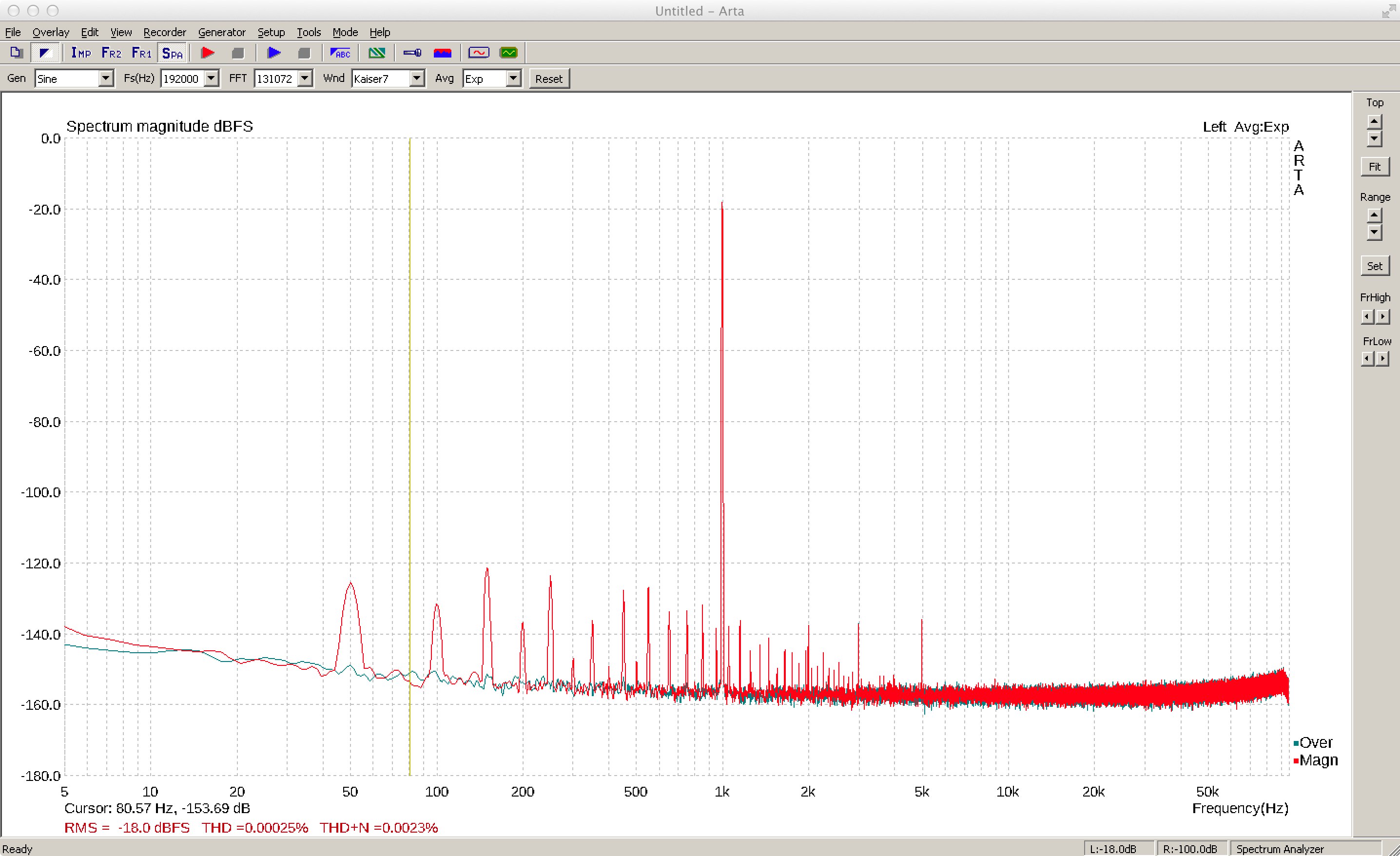

Returning to my line-hum-with-unbalanced-cabling issue :)
To recall the problem arises when the cabling is: BNC-out, BNC cable, BNC-to-XLR-adapter at the input.
I have meanwhile added an battery power option with a switch, so that I can switch between line and battery power without the need touch anything in the measuring setup.
Some loopback measurements:
First, the ilustration of the problem, the line powered measurement (red) over the same measurement with battery power (green). Battery powered the line artefacts are gone.

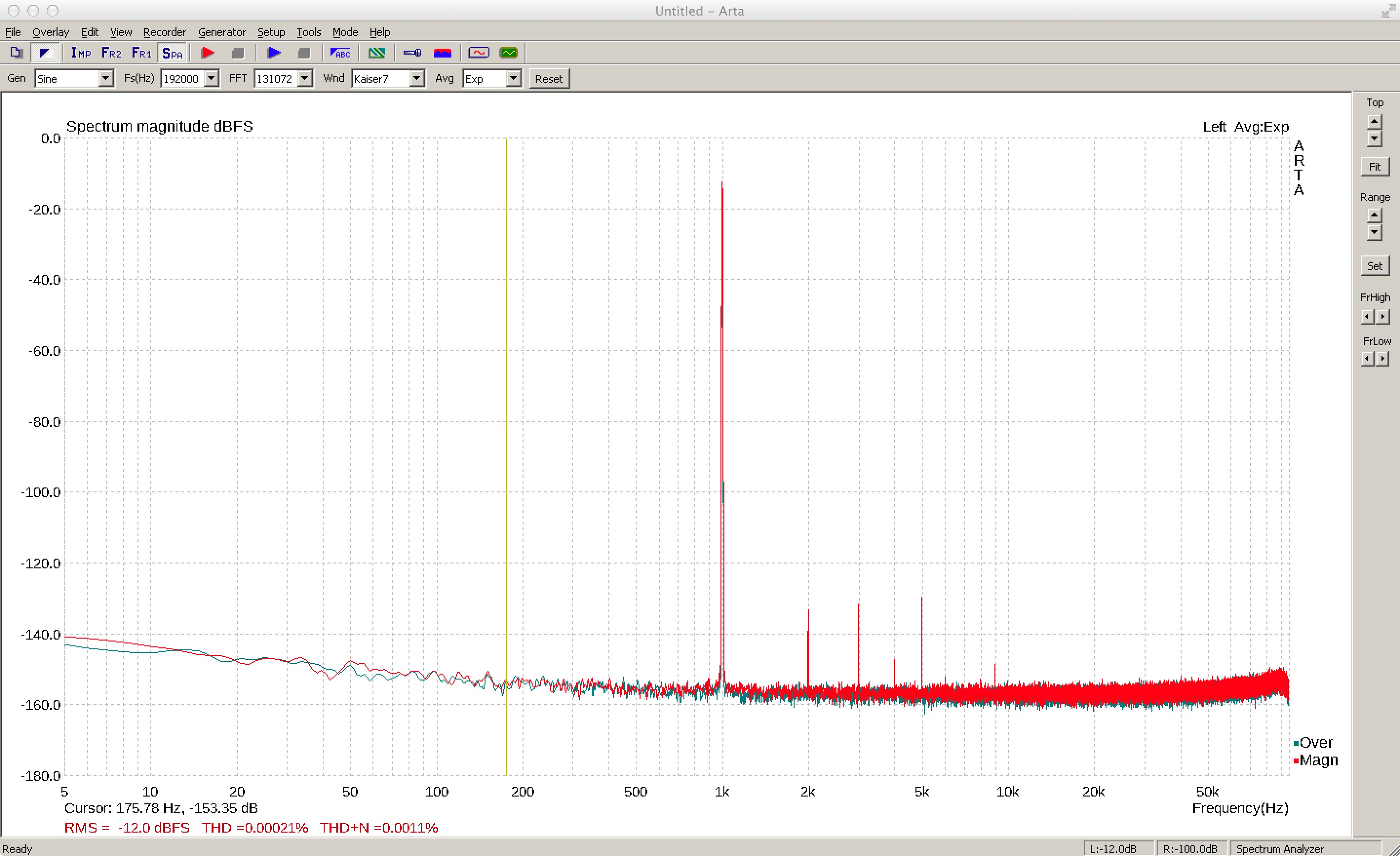

Next the same measurement, both cases battery powered. First (red) the line power connected to the analyser and the transformer is line powered, but not connected to the analyser PCB. Second (green) line power unplugged.
You see, there is no difference. An indication that the transformer stray might not be the problem ... but keep in mind the transformer is driving no load here.

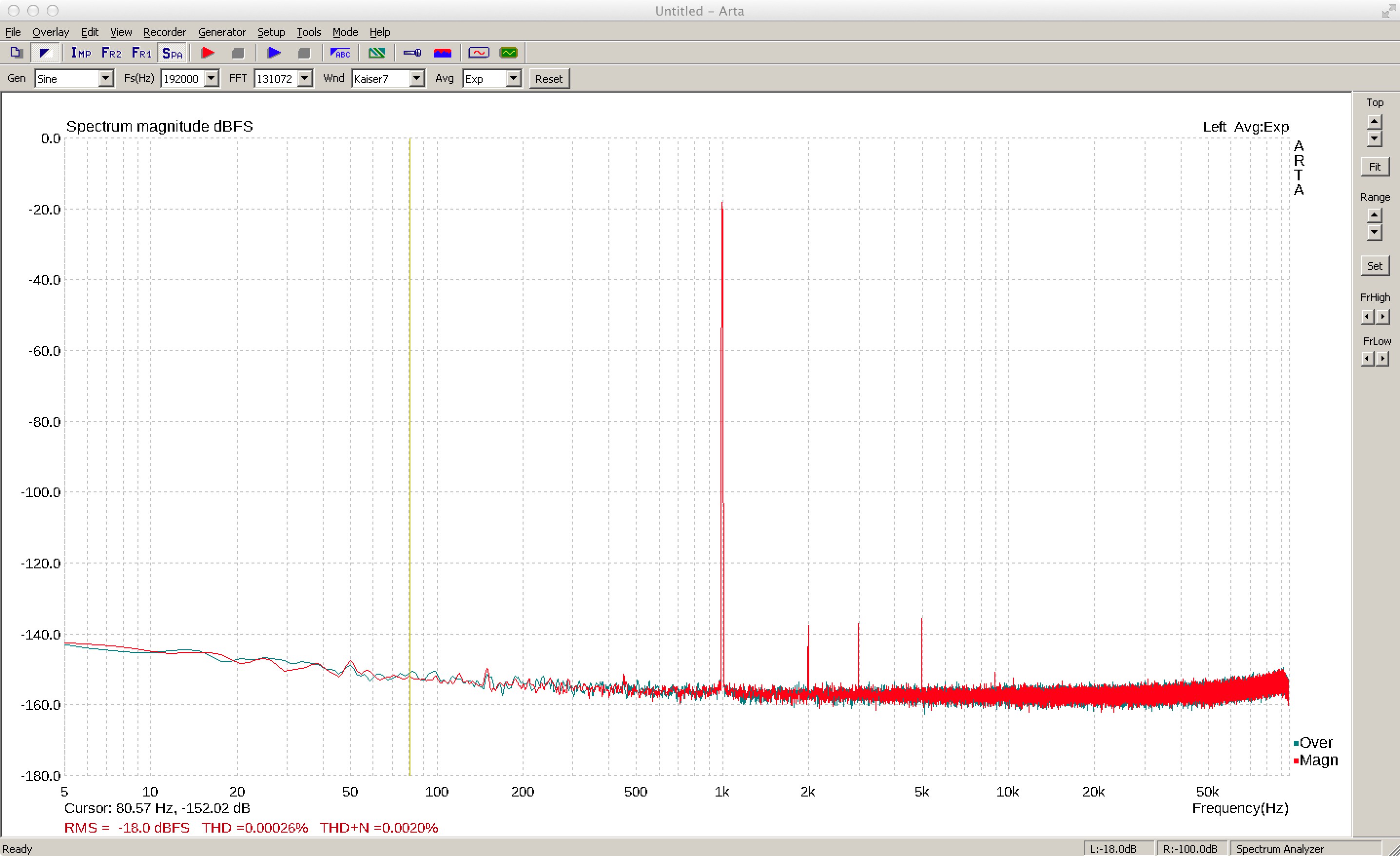

Last I compare line powered balanced (red) to battery powered unbalanced (green) measurement. (I did not alter the generator settings for that the harmonics do not change. Therefore the signal is 6dB stronger in balanced setup.)
Netz Bal over bat unbal (1,10) Pegerl gen unverändert (also bal 6dB höher).jpg
Conclusion: it is possible to get the same performance unbalanced as ballanced, with the not recommended unbalanced cabling topology, at least if you power the analyser from batteries.
