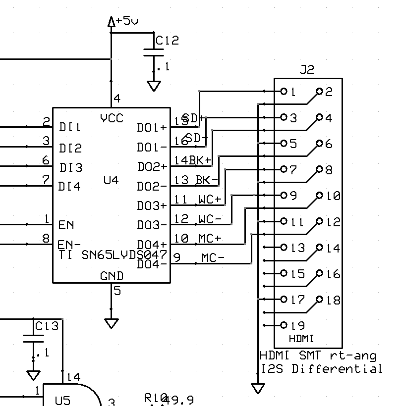

The "HDMI" is really quite easy. Its an I2S format hatched by PS audio. If not lost in my disk crash I have all the details. in any case you use an LVDS driver to drive the TMDS pairs in the cable. For this you don't need to worry about intrapair or interpair skew. However I'm not aware of much use for it. Straight TTL outputs would connect to most demo boards.

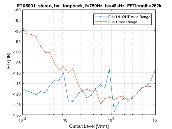

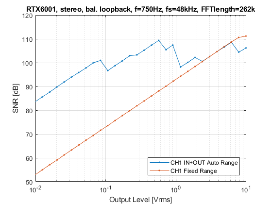

Attached is a "quick" performance comparison of the RTX, fixed range (10Vout -> 10Vin) vs. my current auto ranging implementation.
The stereo balanced loopback test included 30 steps, logarithmically spaced, between 9.9mVrms and 9.9Vrms. 750Hz sinusodial test signal, 262144 pts FFT, 48kHz sample rate. One sweep takes roughly 4.4 minutes, 1.5sec settling time before each FFT-segment included.
Quite impressive
Nice!
In principle, the results are not surprising, but they do show that the auto ranging does the job. It substantially improves the SNR, and also THD is better with auto ranging at low signal levels. The THD curve of the fixed range test looks like it is dominated by noise (SNR) at low levels. However, I wonder why THD was quite a bit better with the fixed setting at 0.5 to 1 V(RMS)?

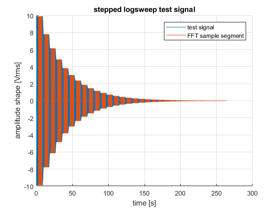

Also, I don't understand the third test ("amplitude shape"). Can you describe this a bit more?

I haven't planned to develop a PCB with all of that. I assume that the HDMI part is the most complicated to make.
I have developed a PCB with SPDIF, AES and Toslink I/O, but not HDMI or I2S. This may - or may not - find its way to an upgraded product. Still TBD.
Are you looking for output only? An SPDIF output is easy to make. The XMOS board has been prepared for that
I need to coordinate things with RTX, but perhaps we could work together on the HDMI etc.?
The third plot is the described test-signal in a graphical representation. The highlighted parts of the stepped sweep are the segments used for the post-processing. In this case: rms-amplitude, thd and snr analysis. Instead of a set of bursts, I wanted a smooth continuous signal in order to avoid step response issues and auto-ranging issues (range-choosing is better without huge steps, therefor linear ramps between steps). I will implement the burst-version as well, maybe the thermal load is to high for a power amplifier.
You are pointing at some interesting details of this measurement. First of all: At this time I still rely on the inbuilt functions "thd()" and "snr()". So, this is plain THD, not THD+N. I was also surprised of the fixed range performance around ~1Vrms. Further one can clearly see, that the autoranging algorithm is choosing a higher input attenuation at levels above 7.75Vrms leading to a compromised SNR (comparing to the fixed range approach).
The plot also reveals, that the output attenuator is the performance bottleneck. The transition-points are obvious. Though, I think Jens found a perfect cost/effort/performance ratio. Chapeau!
To conclude:
(1) auto-ranging is not always better, it is a compromise (*). Still, the average performance is better.
(2) there is room for refinement in the auto-ranging implementation
(*) one reason is the relatively small amount of attenuation steps provided by the RTX6001.
