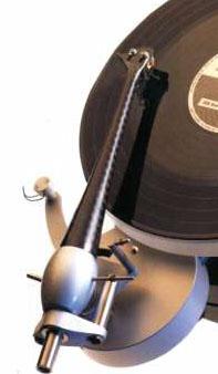

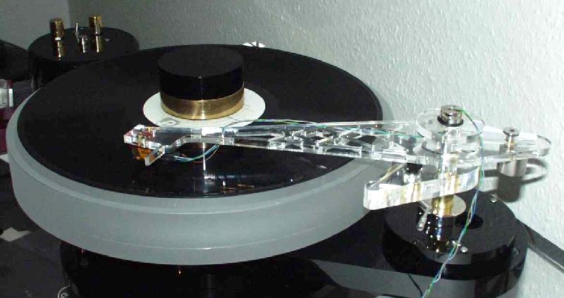

Never really thought the tubular shape had any other purpose than screen and hide the wires. Some of the higher-end Sheu arms, like the Cantus seem to sound good using just a perforated strip of acrylic. No idea how they compare to tubular designs but for diy it certainly seems like a simpler solution.
Jerry T. said:
I suspect a tapered tube has something to do with resonance, but could you elaborate please? I would like to now more about this.
Jerry T.
Simply put the nearer the mass to the headshell the more it
adds to the effective mass off the arm. So a tapered section
will outperform a straight section of equal effective mass.
Or put another way a tapered section will weigh more than
a straight section of the same effective mass, it will be stiffer.
TBH I'm not sure resonances would be spread that much,
depends on the sort of taper you use, but you can ease
the impedance change as you hit the bearing end of the
arm.
If the bearing end is a ball you could run the taper into this.
Bit like this ;

True, they are tapered but being designed for clobbering golf
balls they are probably too strong and thus heavy to be ideal
for a tonearm.

Here's a pic of the Cantus which i still think will make an excellent and easy diy project.
The only arm i've ever tried cloning was the Welltempered and it came out surprisingly well considering the effort involved. If i ever do it again it will most likely be a Schroeder.
