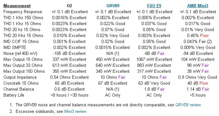

What I do have a problem with is things like the attached chart from the O2 website.
This chart pits the O2 up against a few other random headphone amps and decrees that it is an "excellent" amplifier based on what I'm guessing is relative technical merit. If you added The Wire to this list, I suppose it would be "Super Duper Excellent", or perhaps it starts sliding down the other side of the mountain into the "A little too excellent" domain.
Where do you draw the line though? I would argue (and I took part in an actual test involving more than a handful of people) that your average person cannot reliably discern crosstalk as long as it's better than 35dB separation. Based on that, all the amplifiers on the list should get a score of "excellent" since they all exceed the limit by a significant margin.
I was never told what my score was on the test, but I can tell you that there was very significant deviation from person to person. That leaves a lot of questions unanswered.
So... what it boils down to is this:
I will continue to strive for the best possible objective performance in everything I design, because for me, that is the best we've got. I will never strive for a "good enough" final product because "good enough" is still a moving target.
The attached list is actually very useful, but the qualifying words after each measurement have no place in an objective evaluation, because they have no objective scientific merit. How can you scientifically show that 40dB of crosstalk is "poor" but 63db is "excellent"? What are the intermediate levels of "fair", "good", and "very good"? How do they relate to audibility?
If I were to publish a list like this, it would just have the numbers on it. It's up to the end user to determine what they feel is important, and just how much of it they want
