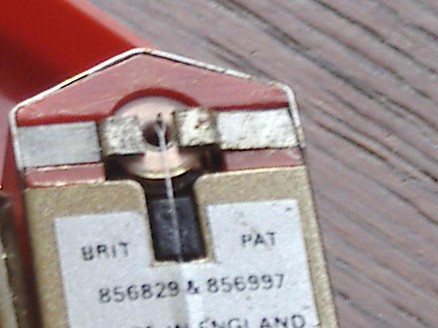

AudioOrigami said:its at this point i think back to my old decca gold garrot micro scanner...it had the cantiler coming straight down ...like the cutting head that cut the grove
Vertical cantilever? I cant imagine that to track warps very well. Do you have any pictures?

the old decca was a great cartridge

Looks like the Decca has a normal pivoting cantilever with some sort of plunging magnet. Is this a mono cart, designed for vertically cut grooves? I suppose it would be very linear, so to speak, acting pistonically, like a speaker driver.

no the decca has nothing similar to normal cantilever
the white string holding the vertical cantilever is what u see
the cantilevr comes straight thro the middel of the coils
its not the clearest picture....the decca resembles the cutting head arangement
the decca has much writing about it...maybe try vinyl engine for more info on it
