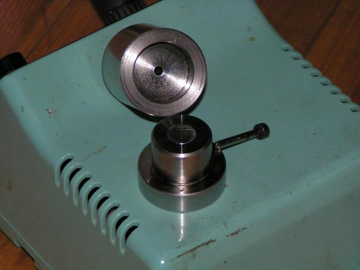

I finally got my first digi cam this friday, so a couple of pics is now an option.
The first part to be made is the die for cold forging the silver contact pins. The first photo is the die closed, the second is the die opened and the ejector pin laying next to.
The die is to be used in a press, or in the lack of such in a vise.
Magura:)
