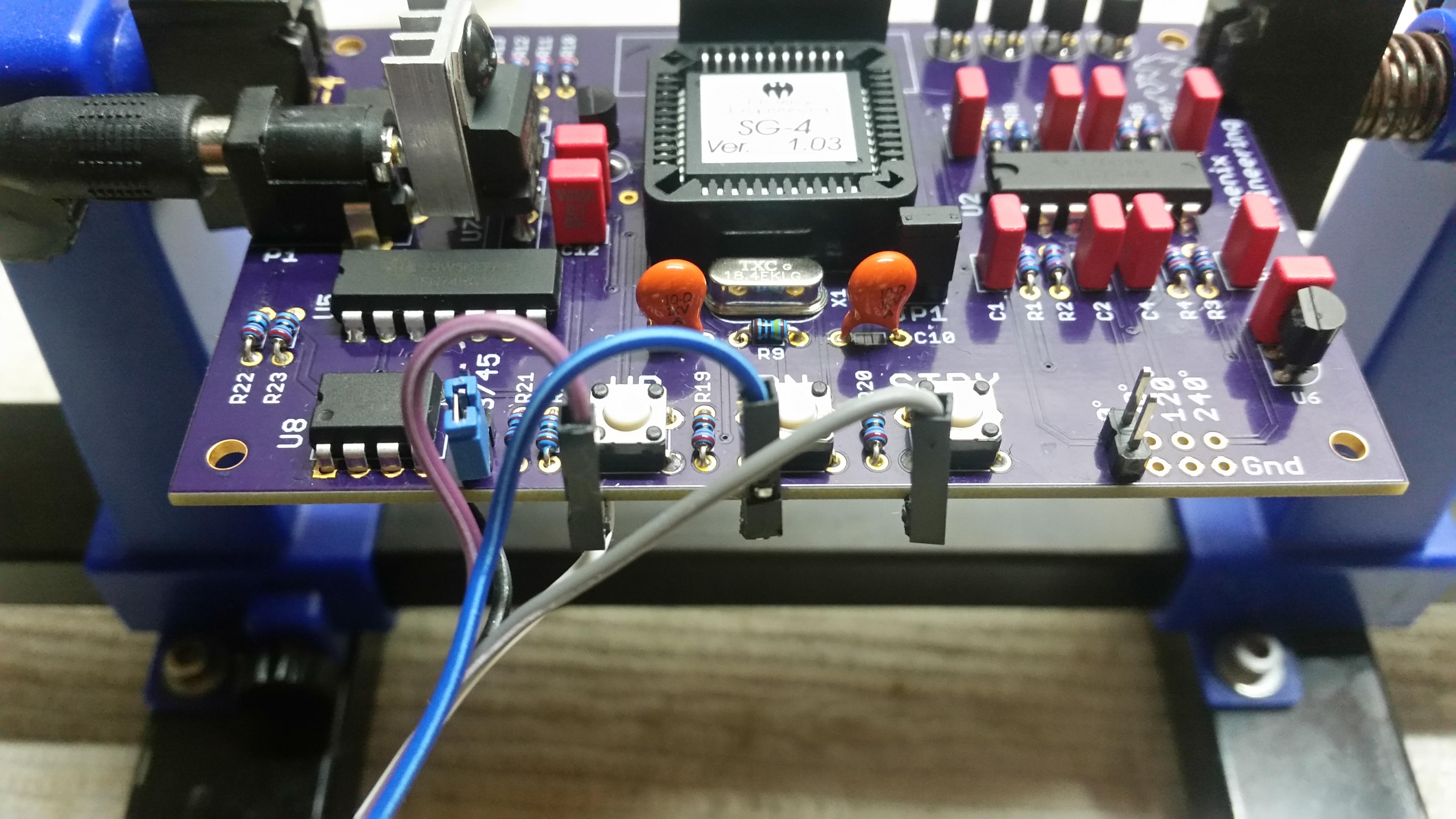

My SG-4 fired up nicely initially standalone, thereon with Arduino encoder added on later.
My observations were:
1) Arduino encoder rotational direction isn't correct, Turning Clockwise was freq down and vice versa. I swapped the wires. I'm guessing the encoder board wire designation marking is an error. Can't be anything else.
Someone else reported the same problem, most likely due to a different switch than I used originally; no problem to just swap wires.
2) 3 tact switches must be installed to engage voltage, factory and phase settings.
Yes, this is important.
3) With 3rd party 12VDC wall wart (from some defunct modem) peak voltage at around 16-17VDC, the LM7805 regulator feels finger hot with a little heat sink since I have these little thingys as spares.
The wall adapters that I call out in the BOM are SMPS types and are regulated at the rated voltage. If you use an unregulated type, the no load (or light load) voltage will be higher. If you use a higher voltage wall wart (or an unregulated one), it may be necessary to add a heat sink to the SG4 regulator.
4) I used an unbranded China made 7 segment and had to carefully wire it up to its own pin assignment. I learned different makes of 7 segment displays are with different pinout (reckon there's no set standard), its imperative to check and plot display pinout on its own datasheet to match the original Liteon display pin assignment. I'm not sure, but the display I'm experimenting with now seems a little glaring or brighter. I thought I'd like it a little dimmer, guess I may have to replace all those 330ohm dropper resistors later on. Toying in my mind for a larger 10mm display. I can't easily buy any Lite-on display where I live. Mouser or Digikey impose minimum quantity for any free shipping at my region.
Almost none of the displays will have the same pin out, even from the same mfr. I found it easiest to make a chart and list each pin of the display and the PCB pins for the Liteon part in the BOM and another column for the new display that you must "translate".
Also, be aware the wires in a ribbon cable with an IDC connector do not go to pins 1-2-3..etc. They connect to pins 1-16-2-15-3-14...etc., so if you solder the wires to the display (or socket) directly, you must take this into consideration.
Regarding brightness, changing the resistors will have little to no effect. LEDs are dimmed by changing the duty cycle to them at normal voltage. The easiest way to reduce brightness is with the use of a neutral density window of plexiglass. They make them in a number of shades of darkness and they are very effective (the RR/Eagle use this, otherwise they would be very bright).
5) I'm hoping Bill would take note of a future option to include through hole solder pads for 5 encoder wires to SG-4 pcb.
If I had thought of this in the beginning, it would have been easy to add, but there is no room on the SG4 to include another thru-hole IC without making it larger.

Looking at Chromenuts' SG4, it is not necessary to have 4 wires for each momentary switch (up/dn/stby). The switches have 4 pins, but each switch has 2 grounds in parallel and 2 outputs in parallel.
You can do the connections for all three switches with 4 wires:
Common Ground for all switches (1) [same as power ground]
Up (1)
Dn (1)
Stby (1)

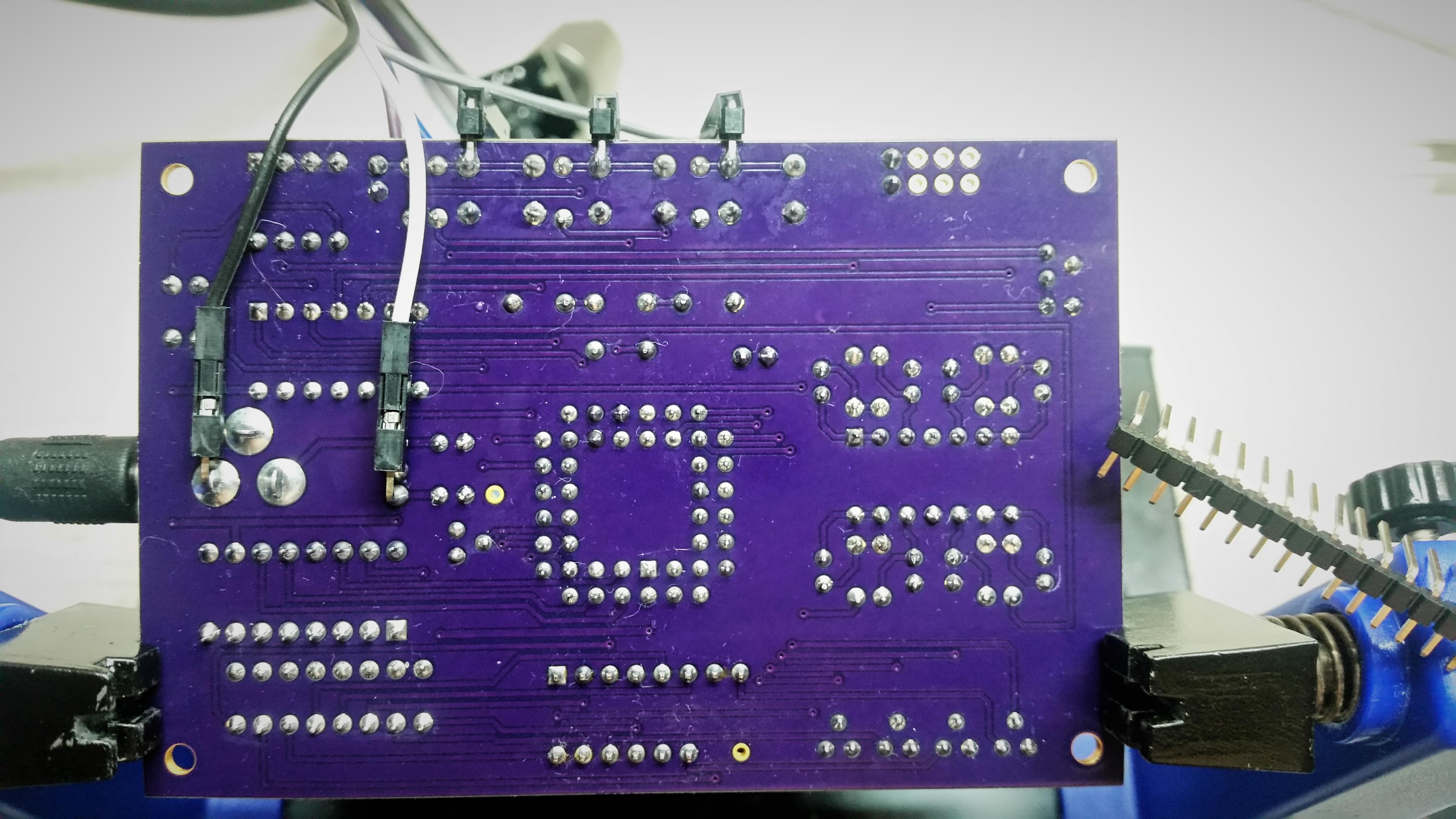

I found a practical solution, may not be the very best but good for bench test and further experimentation. I soldered some right angled pin headers for plug in connection to the rotary encoder. Much earlier I soldered wires direct to the board but not having the best wires on hand till now, they could break off easily. I shopped for these quick connect ribbon cables from local Arduino hobby shop which have all sorts of these hardware for the DIY'er. I was very careful soldering the pins and ensuring they're quite secure and no short circuit anywhere.
Just to satisfy my curiosity, I bought another alternative Arduino Keyes encoder to try out (actually needing it for another SG-4). I still had to swap the up, down wires to match. No problem at all, I'll leave it at that.
Meanwhile I powered the SG-4 with a proper LM317 PSU adjusted for exactly 12VDC, the onboard 7805 with heatsink is normal, that's the best. Lesson learnt, don't use those 12VDC wall warts which are 15VDC or more P-P.

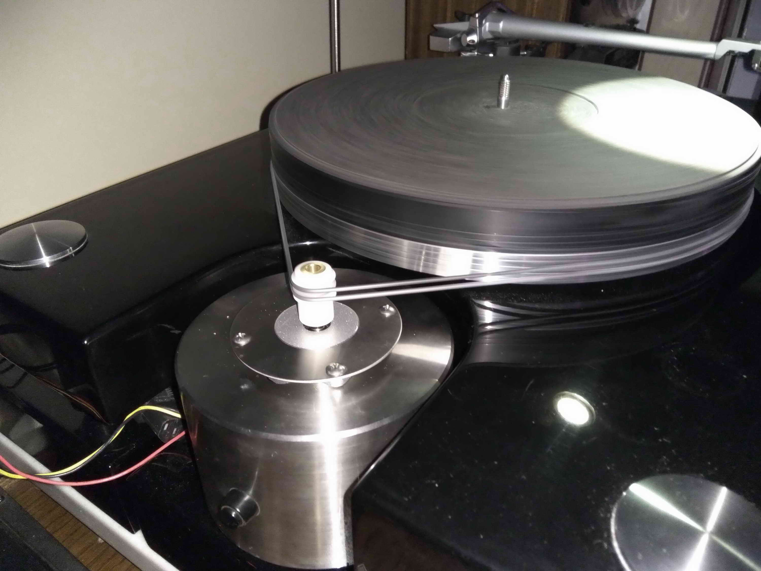

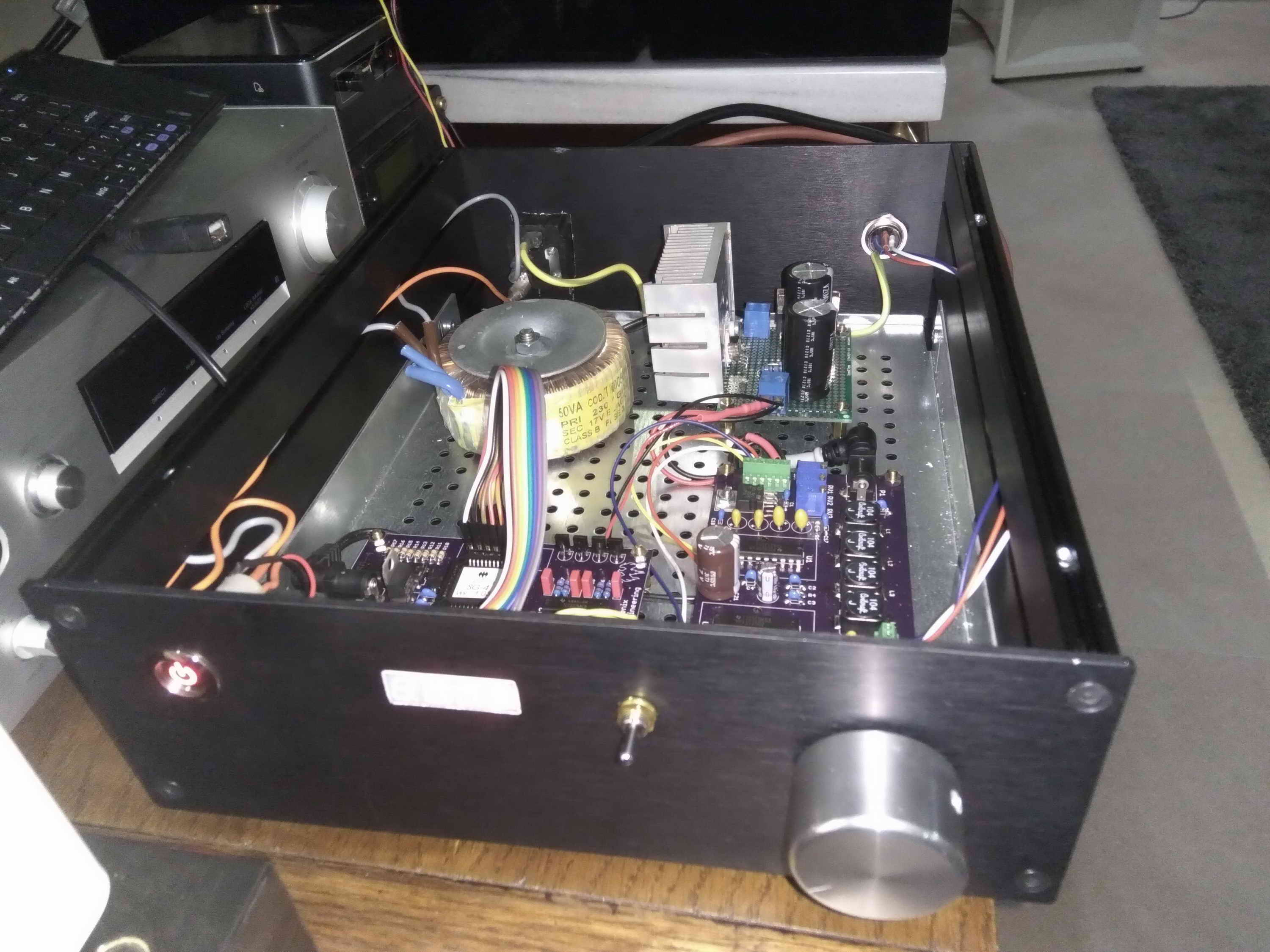

Just finished the SG4 and MA-3D combo. For power supply i used LT1084 for regulation. The BLWS231S-24-2000 motor fitted nicely into my VPI Aries housing and managed to glue the two pulleys together, in order to have dual belts. Everything works fine and it is a nice upgrade from the Hurst motor.
I would prefer a little less bearing noise and I have order some ceramic ABEC7 bearings to replace the stock motor ones, as another member did already here.
Thank you again Bill for the excellent project!
