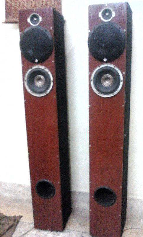

Another question.
Can I use a full range 3 way car speaker as mid range ( adjusting level ofcourse) along with a midbass and tweeter in a 3 way system?
Is this a pragmatic implementation?
For the time being I added two Car Speakers in the middle for experiment . (The black ones in the photo)
So sorry.
1. The full range is from Rockford ( Model R1653)
3 Way, 48-22kHz,
Voice coil diameter= 1.25(3.23)
Free Air Resonance = 67
Qts = 0.78
Vas-cu.ft.= 0.53
SPL ( db@1w/1m)89
Power Handling Watts ( RMS) 40, peak = 80
2. No specific data available about the midbass except its a 8 Ohm , 6.5 inches midbass
3. Tweeters 4 Ohms paper cone
Earlier I used the car speakers with my discrete Mosfet Amp. I noticed one thing in my small listening room.
They are good in a very near field listening environment but they tend to lose focus or their sound doesn't spread well . ( trying desperately, using my layman's term, hehe)
I will experiment more and post my observation.
Thank you again sreten.
