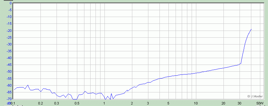

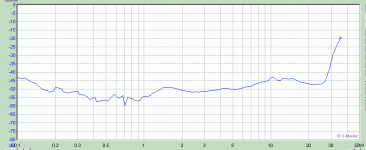

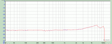

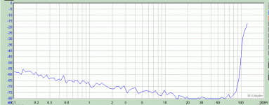

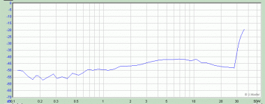

I have run harmonic-distortion vs frequency and distortion vs output-power tests on the three switching amplifier boards I have bought in the last couple of months.

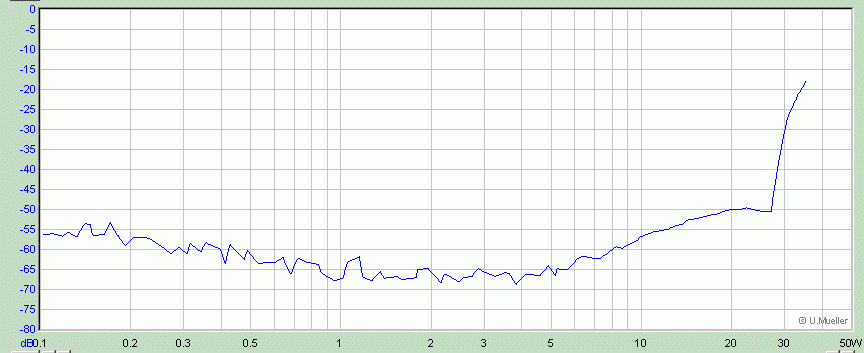

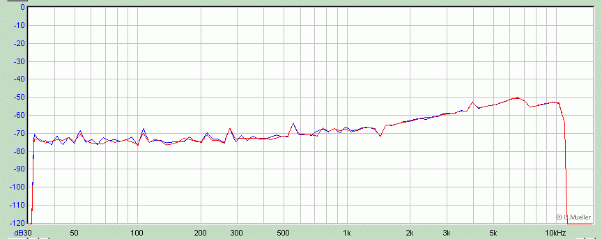

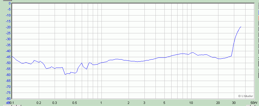

For the HifimeDIY T2, I connected a Meanwell (clone) 27V 5A supply, and a dummy load which is configurable to both 4 and 8 ohms.
I measured Harmonic Distortion vs Frequency at about 4 watts output power into 8 ohms. Excellent results -- with distortion over most of the spectrum ranging between 0.1% (-60dB) and 0.3% (-50dB). I repeated this at 35 watts power level, and a respectable half a percent (approx) of distortion was maintained nicely over the usable audio range. Using a 1KHz tone, I then ran Distortion vs Output Power with an 8 ohm load (attachment 3) and also with a 4 ohm load. Very good results, even with the 4 ohm load (remember that -40dB = 1% distortion). The T2 is a nice, clean, little amplifier, especially at 8 ohms.

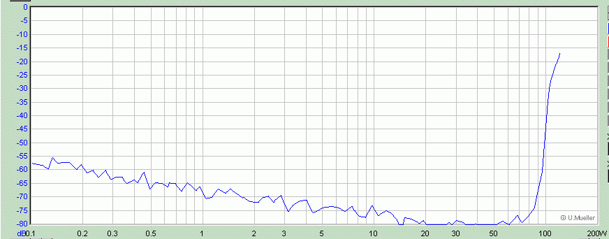

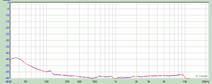

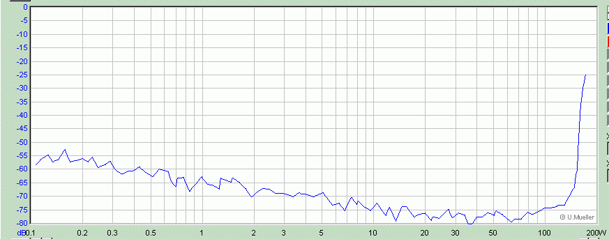

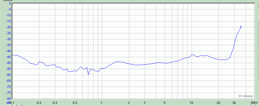

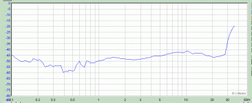

I then tested ljm_ljm's new L20D amplifier, which uses the IRS2092 delta-sigma modulation chip for PWM conversion. For a power supply I used a toroidal transfomer rated at 28VAC 100watts, with 88,000 uF of filter capacitors. The results with the L20D were nothing short of superb. Many linear amplifiers would be struggling to achieve such a high linearity, especially at the high power levels the L20D can handle. Attachment 5 is distortion vs frequency into 8 ohms, at 35 watts output level. There is no point in showing lower output powers, the L20D is exceptional throughout its whole power range. I repeated that sweep for a 4 ohms load. Attachment 7 shows distortion vs output power into an 8 ohm load. Even putting out over 100W into a 4 ohm load (attachment 8), the L20D generated virtually no harmonic distortion. Everything was right at the lower limit of my test setup, less than 0.1% over every reasonable operating condition. I can see why ljm_ljm was so excited when he finished his L20D board

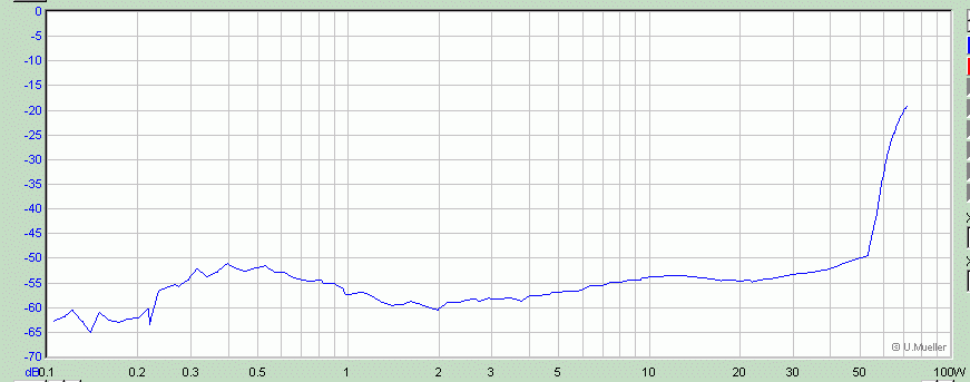

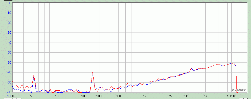

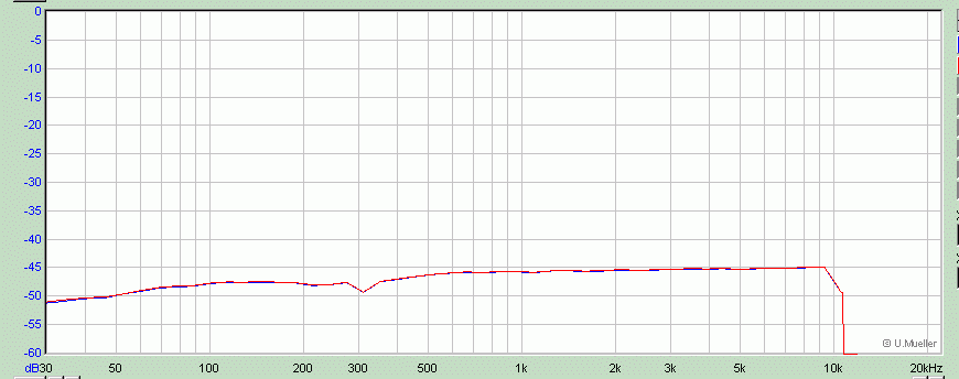

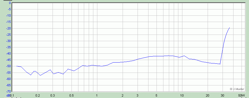

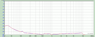

So now to the new SURE 100W+100W board using the new(ish) TDA7498 chip. This board was unstable when it arrived, and I had to add Zobel damping to the output network (described in another thread). Attachment 9 shows that the harmonic distortion, even at 4W into 8 ohms, is unacceptably high, hovering just below 1%. Similarly, the distortion vs power curve was not even close to that of the T2 or the L20D.
What you see is very typical. Tripath based amps typically have higher average THD than many other comparable amps (though much lower than many other designs) but because of it's sigma-delta comparator technique it's completely flat unlike what you see from the I-R based which shows a rising tendency with higher frequencies.

The Tripath is indeed flat with frequency, but at a relatively high level of -45dB, or about 0.3%, and while the I-R based L20D is indeed rising, the I-R is just much, much lower distortion. never going above -70dB (0.03%) (both systems measured into 8 ohms at 17Vrms). It is important to look at the magnitudes, not just the shape The I-R leaves the Tripath behind in every distortion comparison, it's just that the Tripath is arguably adequate in its performance, remaining below half a percent at all (audible) frequencies, especially when you don't drive it near its power ratings.
With newer loudspeakers, some would argue whether 0.3% is indeed enough. I have measured my Peerless 830983 at about -60dB THD throughout the midrange, for example, and they may be capable of outperforming a 0.3% amplifier in overall distortion if you don't drive them too hard. Who knows? For quality, I would choose the I-R if I could. But the Tripath is more convenient for smaller systems, working with a single-rail power supply (or power brick)...

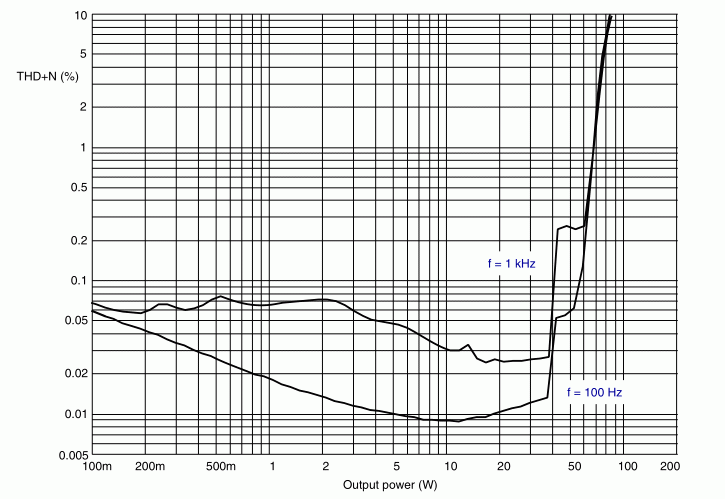

Oh - with respect to the TDA7498, the data sheet shows distortion in the -60dB region (see below), why do you say it's not even in the same league?

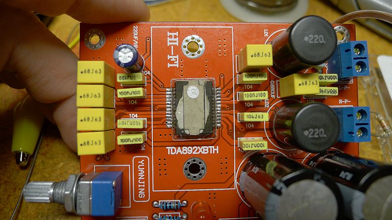

Meanwhile, I did measure the distortion curves for one of the low-cost YuanJing TDA8920B boards that I bought so cheaply on Ebay, and you can find the data in the attachments below. The performance is not bad, which is probably why it didn't sound so bad, either Distortion vs frequency is shown at a 5 watt power level, followed by distortion vs output power at 1KHz into 8 ohms, on a 25-0-25 volt DC power supply.

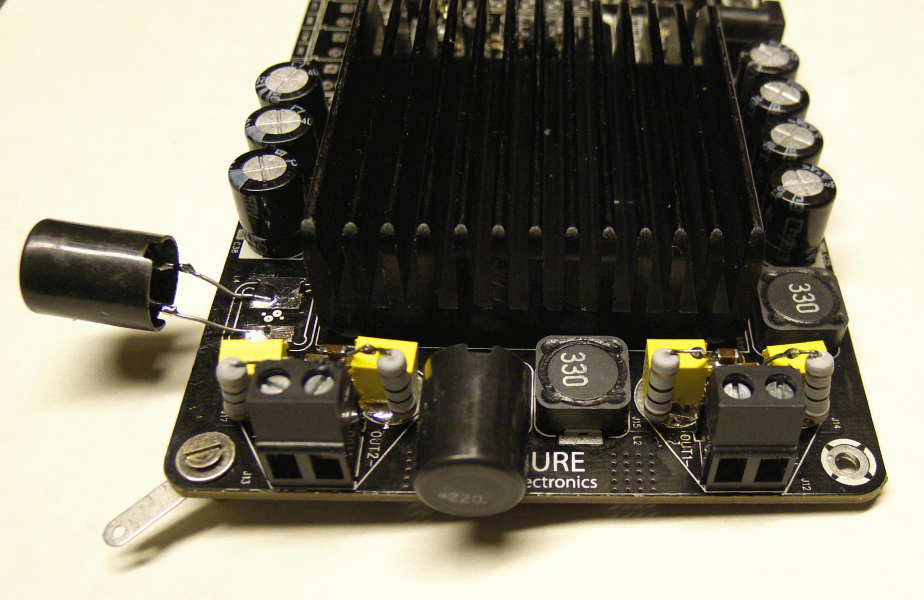

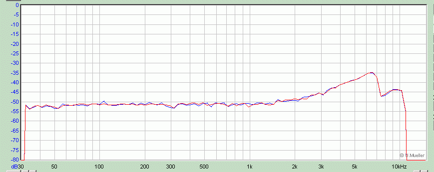

I have retested the amplifier I received from SURE Electronics which was labelled as: "2 X 25Watt Class D Audio Amplifier Board - TDA7492" and which came with a chip whose top was laser-embossed as 'TDA7498'.
This amplifier seems to be using a chip which does not conform to the distortion specifications in the data sheet for either TDA7492 or the newer TDA7498. My best guess is that is a "seconds" chip, which, eg, 'fell off the back of a truck'. I have tested the TDA7920B chips from ST microelectronics, which largely perform to their data sheet. But the SURE amplifier has harmonic distortion which is unacceptable, and way above the ST data sheet values of either chip. I cannot believe that SURE could mess up their implementation so completely, although that was my first reaction, and have come to conclude it must be a second-rate chip.
Today I removed the tiny 33uH output inductors used on the SURE board and replaced them with the larger 22uH inductors which work well on the TDA7920B board. The distortion was still high, although a little better, certainly not as good as the same inductors produced on the TDA8920B Yuanjing board.
Below please find attachments in support of my conclusion. First I have a photo of my board modified with the two larger output inductors on the left channel of the board, and with the original small 330 inductors on the right. Second is distortion vs power into 8 ohms with a 24V supply and the original 330 inductors, third is with the larger 220 inductors. Then the distortion vs frequency into 8 ohms with a 24V supply at an output power of 6 watts is shown with the unmodified board. Finally, to show that the larger inductors can handle the power levels without distortion, I attach the distortion vs power curve of the TDA8920B YuanJing board which I 'borrowed' them from.

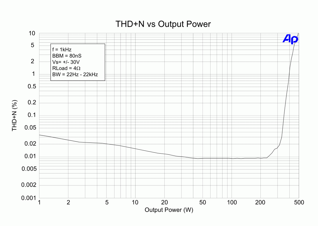

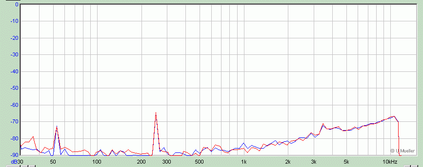

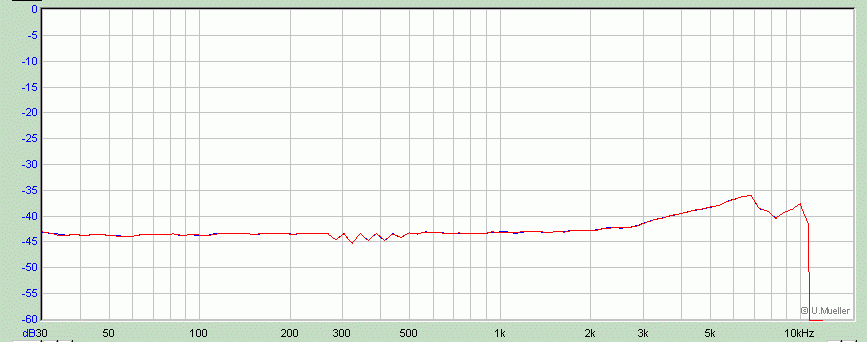

I found the curve attached below on Page 8 of the Tripath application note for the TA3020, titled "Class T Digital Audio Amplifier Evaluation Board," part number Bridged RB-TA3020-1-3 – MC/1.0/06-01, EAD003.
It seems remarkably similar to the curve I measured on the L20D (also attached below), not to the curve the manufacturer gave you for its AMP15 performance. Here is an explanation of why such differences are frequently seen in power electronics, and why they are unimportant.
My test equipment actually goes down to the noise floor of the 16bit input A-D converter. There are problems involved in measuring a distortion vs power curve such as you have shown, the input level at 1W (vs 100W) is already 40dB below the peak threshold, requiring a 120dB total dynamic range in the measuring circuitry. That sweep you are showing for the AMP15 must have been very carefully measured indeed.
I didn't worry about the rising noise floor in my L20D measurements (caused by my test input's 'limited' dynamic range) because the THD+noise values were already so low as to be negligible. No listening room on this planet can achieve a 120dB ratio between background noise and peak loudspeaker level. A typical noise room level rarely falls below 20dBA and most listeners don't want sound levels above about 120dBA, a total dynamic range of 100dBA. The situation is more complex than that, of course, but that is a good rule of thumb.
If you are going to directly compare my L20D data to that AMP15 curve, however, it looks like I need to make a better effort at identifying the actual L20D noise level below 10W, rather than have readers assume that the AMP15 is actually better than the L20D.
The IR amp did hit -80dB at higher signal levels, and may well have maintained it down to 1W, just as the AMP15 curve says it does. Who knows? I certainly paid little attention to any THD below -60dB, which is lower than any available speaker can reproduce Although it is always nice to publish great specs on an amplifier, they usually turn out to be meaningless.

I also have a TDA7498L winging its way from Mouser to me right now, so I can check whether the SURE board works better with a (presumed) full-spec chip
I have a YuanJing board with the chip desoldered right now, so I could mount a TDA8950 on that one, I guess. In any case, I will post a complete set of graphs for the YuanJing TDA8920B boards, and I might also look and see if I can see any differences between the two fully assembled boards which I have working now. One has a chip I bought from Mouser, one has the original Chinese-sourced TDA8920B on it It will take me a day or two to run the tests, I will post them here when they are ready
