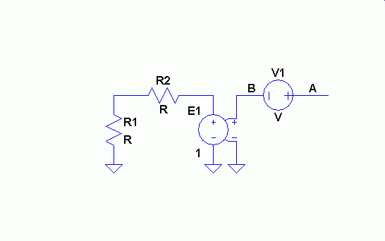

Hi Sam,
There are two examples dealing with this that come with LTSpice. They use two variants of the so-called "Middlebrook technique" for looking at the loop gain, which gives you the gain and phase margins. The simplified Middlebrook technique is shown in the audioamp.asc file in the examples\educational folder. The simplified technique is very easy to use, but is approximate. It's exact in the case where the current in the voltage source V4 is zero. You can enforce the condition with the circuit I've shown below. The injection point must be inside the innermost loop. Since there is only one loop in the audioamp.asc, you're fine.
But what about cases where you have, say, a capacitor from the VAS collector back to the inverting input of the amp to compensate for capacitive loads? You have two feedback loops now. What do you do? In this case, you must use the "full-up" Middlebrook technique, breaking the loop inside the amp itself, in the innermost loop. The full-up technique is described in the loopgain.asc file in the examples folder. It's significantly more complicated than the simplified technique. You can see in this example that the schematic must be drawn twice. You can get around this using subcircuit replication as I've described here http://www.diyaudio.com/forums/showthread.php?postid=333970#post333970 . You draw the circuit with the loop broken, and two named nodes. Then you make a .asy file with the same file name as the .asc file containing the schematic, with pins having the same name as the node names you supplied in the schematic (LG1 and LG2 in the picture). Then you make a third file for computing the loop gain. The three files must all be in the same folder. When you make the third file and you want to add the two replicated subcircuits, begin by pressing F2 to add a component. Then instead of choosing the components in the normal way, go to the drop-down combo box at the top that says "Top Directory". Choose the current working directory containing your .asc file and .asy file you previously created. You'll see the added .asy file in the list. This is your subcircuit for replication. Do this a second time and you're ready to add the voltage and current sources like the loopgain.asc file has. Also, add the "middlebrook" formula to your plot.defs file per my referenced post. When you do your first plot, do a Plot Settings, save plot settings and save to a file. Later, when you want to do this again, you can do a plot settings, open plot settings file and get your middlebrook expression into your plot instantly (like the plot in my third post in the reference above). You can see in that plot that the CFP has a phase margin of about 60 degrees.
Finally, I've found that by using tricks such as the cap from VAS collector to inverting input, you can get excellent phase margin, yet strange quirks in transient with a square wave. These quirks usually show up when you have a square wave having a baseline of zero volts, and the output voltage is near the zero volt level. In this case, the open-loop output impedance is highest (lowest output current), so the transient oddities seem to show up at this level worse than at the peak of the square wave. So the frequency domain stuff only tells part of the story.

Andy_c,
I remember you advocating the Middlebrook technique in some
of our earlier discussions. Although I don't doubt it migh be a
better way to do the analysis, it has so far seemed overly
complex to me to be worth the trouble, especially considering
the accurace limitations of a simulations. However, in your recent
post you gave a good argument why it may be useful or even
necessary for certain feedback topologies. Thanks for this added
understanding of this technique.
the accurace limitations of a simulations.(...)
Hi Christer,
As far as I know, both the simple technique of audioamp.asc and the complex technique of loopgain.asc are referred to as the Middlebrook technique. Hopefully I didn't encourage anyone to use the full technique when the much easier one would do. If I did, that's my error for using imprecise terminology. The simplified Middlebrook technique is no more difficult than a simple frequency response simulation, while the full technique is really a pain to set up. That said, it does help to understand the derivation of the full technique in order to understand the limitations of the approximate technique. If anybody's interested in the derivation of the full technique, Jim Thompson does this at his site in the file http://www.analog-innovations.com/LoopGain.zip. There's a similar analysis at http://www.spectrum-soft.com/news/spring97/loopgain.shtm, but they pull some results out of a hat, while Thompson starts from scratch. For the case of the CFP I referenced in my earlier post, I don't think that circuit can be done with the simple technique, as the internal impedance levels don't allow for it.
