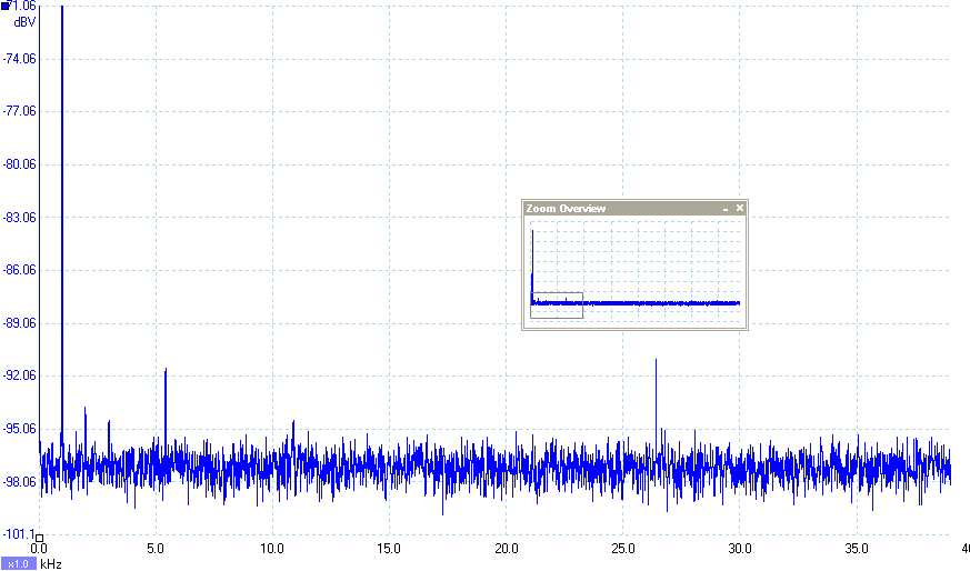

This is the performance of an ordinary power amplifier of 170Wrms/8Ohms per channel, captured from an Asus Xonar Essence STX. Settings are 24bit at 48Ks/s. No matters the sampling rate. You can see that the RMS dot line points, almost, at -98dB. How can you obtain this measurement with a Pico of 16bit?
eliminate the test signal peak and then examine the low level remains.

Andrew, the dot line it shows that the 1KHz fundamental frequency is not included in the measurement. That is indicated by numbers on the top of spectrogram: THD=-88.1dB. Is the second harmonic that, mainly, determines the result of calculation. The issue is that, old fashioned instruments are inadequate according to the possibilities of modern audio electronics. A good example - BTW - are sound cards: you can't find some with THD greater than -105dB. We are not fool to spend our money in useless things.
