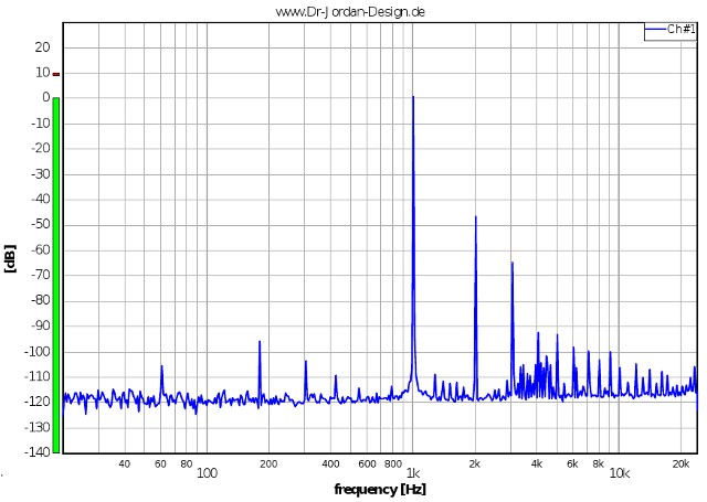

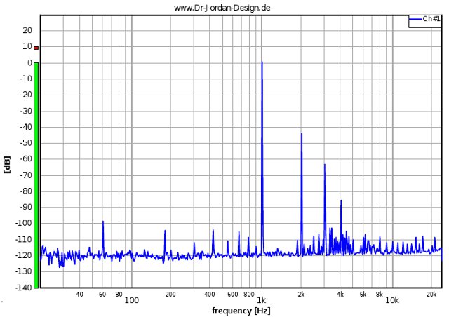

Funny you should mention the 4th harmonic. It's often conspicuously absent or at a relatively low level in the distortion spectrum of the tube amps I build. Not sure why that is, but I have recently played with MOSFETS in a tube circuit and got a significant amount of f4.
In fact, this may be of interest. I was going to make a silly quiz out of it but here it is. The first trace, Schadeode, is the circuit using a 6L6. The second trace, SSSchadeode, is the same circuit and op points but using a MOSFET or more precisely an IGBT, in place of the 6L6. The IGBT was degenerated to approximately the same gm as the 6L6.
The 6L6 version has a series of higher-order distortions going to f9 and perhaps beyond. The IGBT version has a big f4 peak and almost no higher order "grass". The sonic differences were hard to detect but I'd say the IGBT one was at least as pleasant to listen to as the 6L6 one; both sounded really nice. The reference level is one watt.
Now I'm interested in exploring this further but I suspect it has to do with the interaction of the driver nonlinearity with the output device nonlinearity and so-called distortion cancellation.
Oh yeah, I'd count f4 in with the low order because of it's tendency to mimic more common natural partials.

I'm only aware of the mathematics of FFTs on a high level. Could the unequal sidebands be errors due to this just being a single FFT, as opposed to multiple FFTs averaged like the earlier post? The amp in question doesn't work at the moment or I would just fire it up.
The only thing I can think of that would produce PIM would be the FQPF2N90 source followers, but at 1W output from this amp there are still always a couple of hundred volts Vds at all times.
Something to look at in the future.
Do you have schematic to post?
Could be instrumental error, but could be PIM as well. And indeed PIM sounds very nasty.
