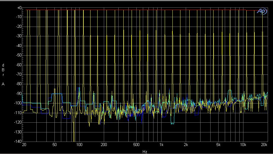

GRollins said:--If you can come up with a good test using real music, then we will all be indebted to you. It's not as though the concept is new. Many have tried, some have claimed success (Hafler had a cancellation test that they pushed for a while), then faded away when it was realized that they weren't really advancing our understanding of what's going on.
That is your opinion. I know there are a lots of people that uses null tests and bypass test with success. So no, it has not faded away and yes, it is helping us in understanding what is going on.
--There are really very few instruments such as you describe. Flute happens to be one of them, but it is an atypical instrument.

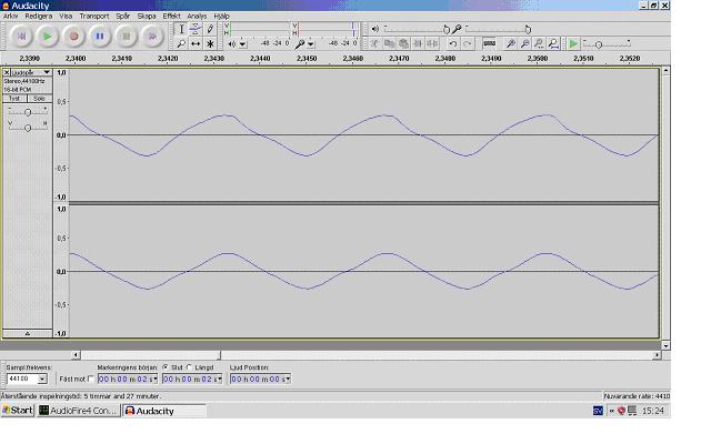

Flute, voice, the ringing notes of a solo string instruments, I'd say most instruments has a relaively basic multiple sinelike waveform during significant periods of time, and static measurements tell us all about the behaviour on such signals.
Sure that doesn't tell us the whole story but a lot.
Organs are frequently cited, but are not a good example, due to the complexity of the waveform.
What makes you feel an organ note is a complex waveform? It's a big flute in my book.
