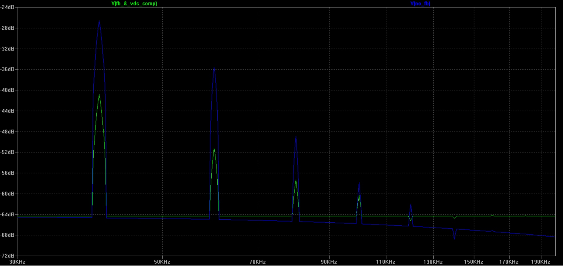

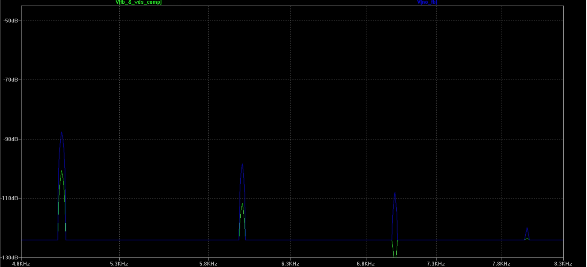

Another circuit was created, where the Vds loss of the gain transistor has now been
compensated for.
Please take a look at the picture below:
Blue trace is still the circuit with No feedback.
Green trace is the circuit still with 15 dB feedback, but now with Vds compensation, roughly
corresponding to the loss of Vds due to the insertion of degenerative resistor element in the
Source circuit.
As can be see, there are no higher order harmonics present, and the feedback
factor is still 15 dB, roughly corresponding to approximately 15 dB of lower
amplitude on the 2nd, 3rd, 4th and so on.
This can be seen on the second, zoomed-in graph.

Simulation II - reflections on the results
The results of the above-mentioned simulations obviously contradict the claims made by
Pass Labs (and the late Mr Baxandall - RIP).
The higher order harmonics created in the circuit example featuriing 15 dB of
degenerative feedback seem to be the result of slight signal compression, due to
static and dynamic loss of Vds due to insertion of degenerative feedback element in
the output loop, inevitably causing substantial change in transistor operating point.
NOT because of feedback.
Feedback, when applied properly, will not lead to higher order distortion or complexity.
Remember that these are the results of simulations.
At this point, it would be very beneficial to verify this in real life.

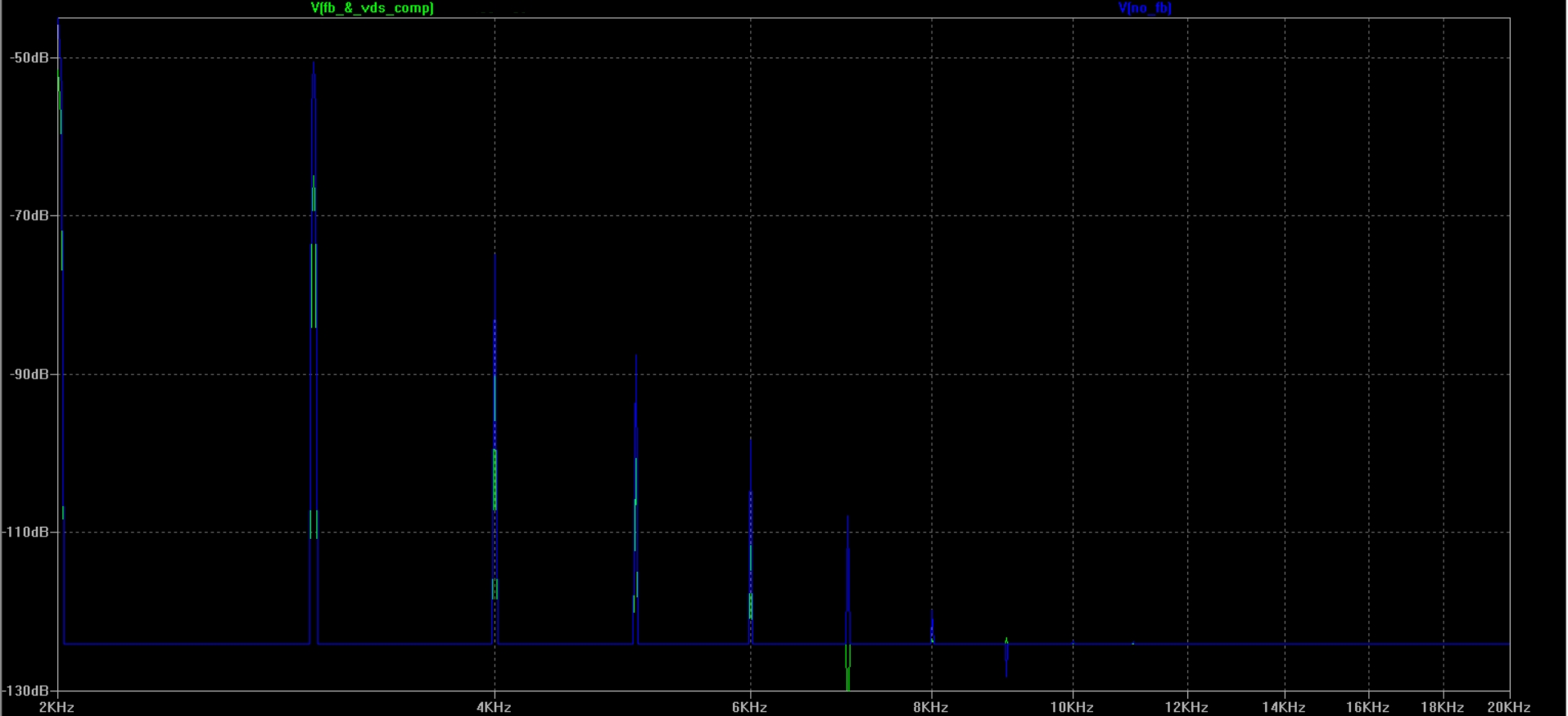

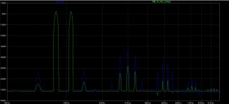

Simulations III - 20 kHz
Here is the simulations of a 20 kHz signal, 1W into 8 ohms resistive load.
Zoomed at harmonics components.
- Blue is the no Feedback amp
- Green is the 15 db feedback circuit with Vds compensation.
The amplifier circuit featuring 15 dB degenerative feedback is more
linear even at 20 kHz.

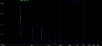

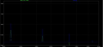

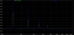

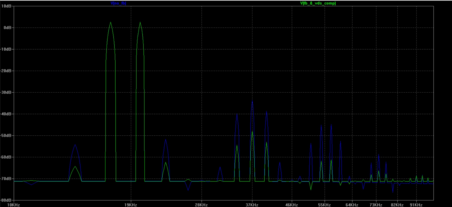

Simulations IV
The high frequency IM test is more revealing than single tone test signals.
They better expose gain irregularities.
So here is the simulation of 1W into resistive 8 ohms of 17 kHz and 20 kHz signals:
As before:
- Blue trace is the non feedback circuit.
- Green trace is the circuit with 15 dB feedback circuit and Vds compensation.
The no feedback circuit has problems reproducing this mixture as evidently
depicted in the graph below.
The highly bent transfer function of the non-feedback circuit more readily
creates sidebands of the input signal, whereas the circuit with 15 dB feedback
is more linear.
As before:
is more linear.
